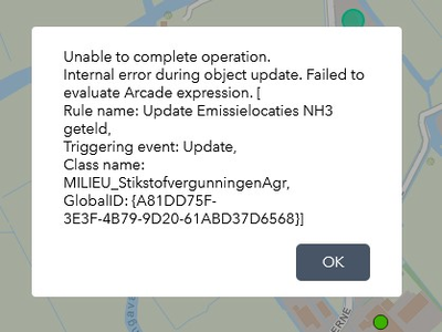

With Oracle, everything worked smoothly. Now with SQL Server however, attribute rules generate the following error message:
I have checked everything and can not find any differences between the old and the new setup. Everything is as it should be, but it refuses to work.
I have no clue what is prohibiting the attribute rules from working properly. Is it a syntax issue? Is it a versioning issue?

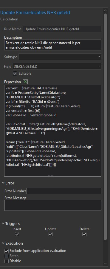

An example of an attribute rule:
Does anyone have an idea what can be causing this failure?
