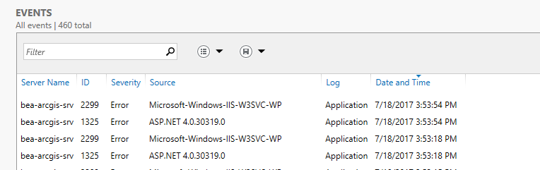

We are trying to configure an ArcGIS Enterprise 10.5.1 on a MS Azure virtual machine. The OS is Win server 2016 with IIS 10. ArcGIS Enterprise was pre-installed on the machine (using the image available at my.esri), and ArcGIS Server and Potal are running properly on ports 6080/6443 and 7443 respectively.
It is a "single-machine" installation (only one GIS server machine/site).
Actually, we are facing the problem that http://localhost is responding with error 500. The same happens after we installed WebAdaptor accessing http://localhost/server/webadaptor.
We have an error regarding ASP.NET (see "aspnetERROR1325) and another on IIS (please see the image below).

thanks for the suggestion. It did not work. Anyway, I solved installing some pending OS updates and reinstalling IIS.
RandallWilliams
I'd try dropping a web.config in the wwwroot, or if there's one already there, add or update this element:
<configuration>
   <startup>
      <supportedRuntime version="v4.0" sku=".NETFramework,Version=v4.5.1" />
   </startup>
</configuration>
Essentially, make sure that the .net sku is pointing to the correct version.
see:
https://forums.asp.net/t/2109026.aspx?ASP+NET+application+initialization+is+failing+on+Server+2016+I...
AlessandroValra
