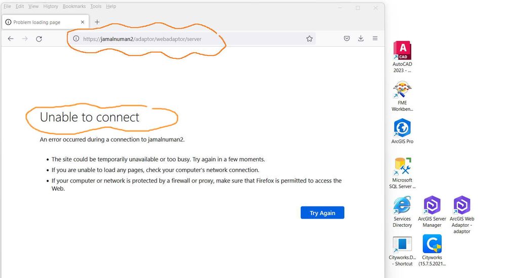

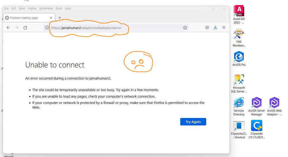

I couldn’t figure out why configuring the Web Adaptor ends up with an “unable to connect” error as per the screenshot below.
What could be the issue here?

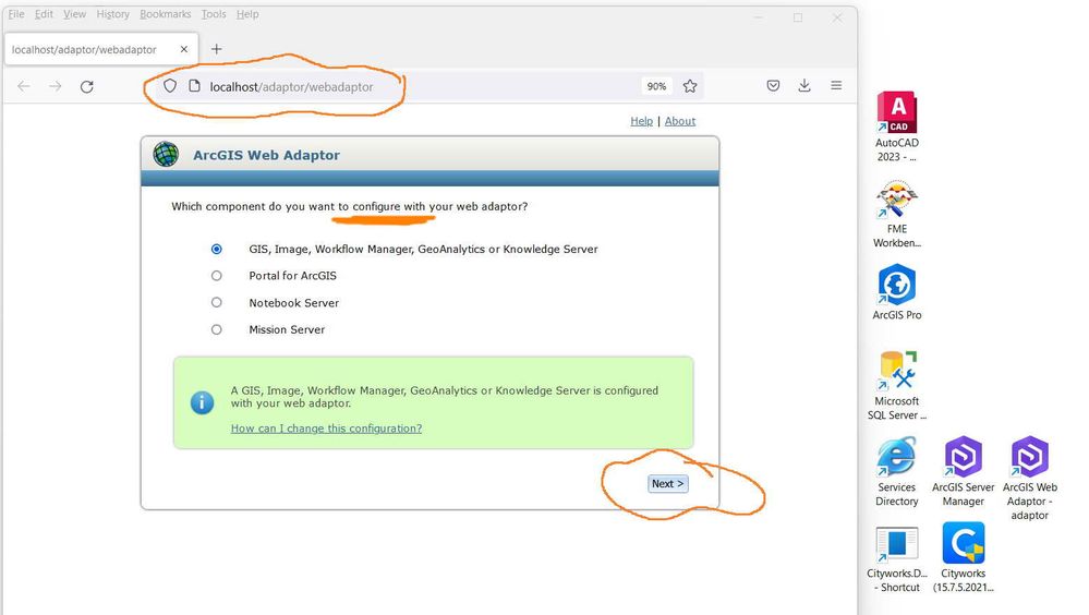

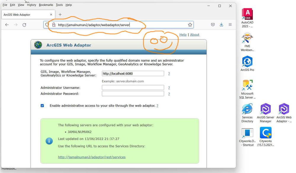

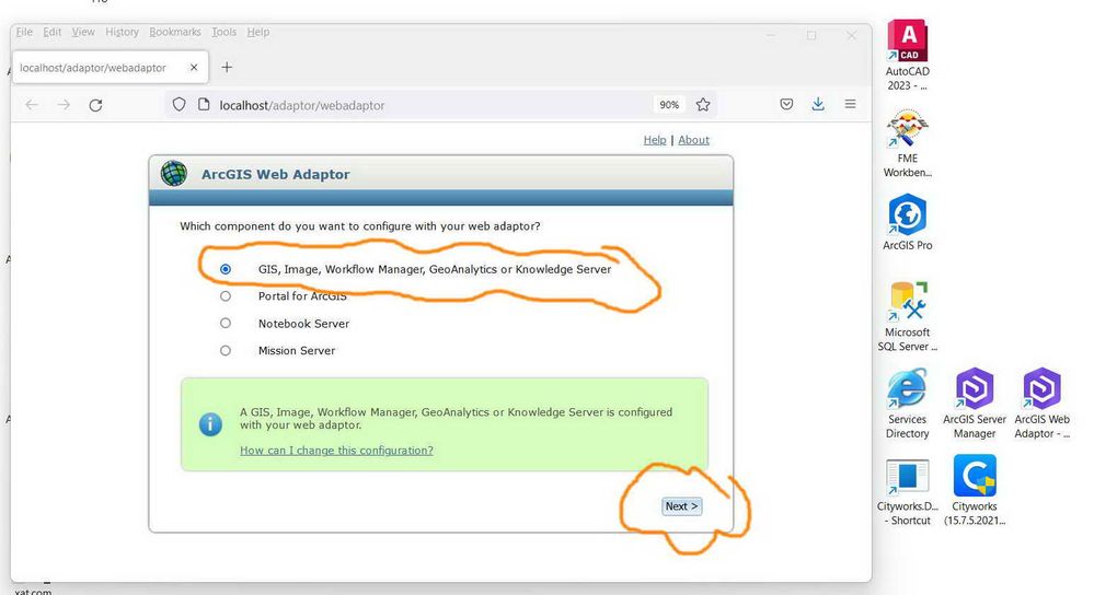

My observation is:
As the ArcGIS Web Adaptor starts, the link is
http://localhost/adaptor/webadaptor
As the “GIS, Image, Workflow Manager, GeoAnalytics or Knowledge Server” option is selected and the “next” button is clicked, the link is redirected to:
https://jamalnuman2/adaptor/webadaptor/server
if the https is replaced by http, then it should work
http://jamalnuman2/adaptor/webadaptor/server

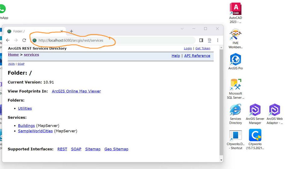

How can the adaptor be accessed with the https even if the https is not configured as this works for the services directory?
http://localhost:6080/arcgis/rest/services
https://localhost:6443/arcgis/rest/services

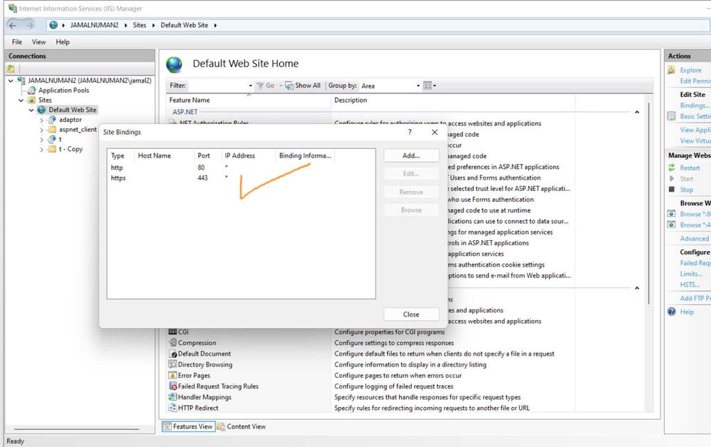

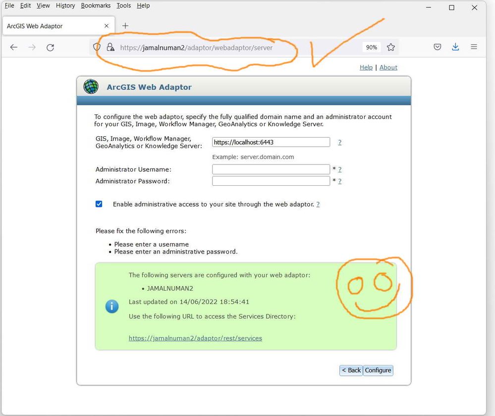

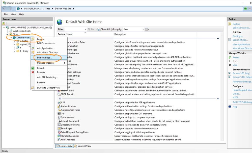

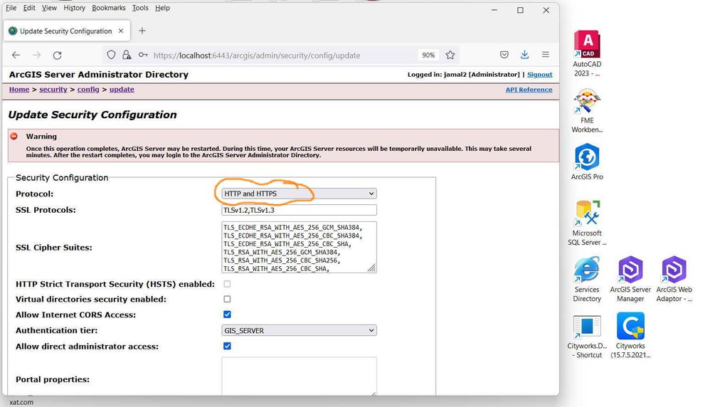

JamalNUMAN
Legendary Contributor

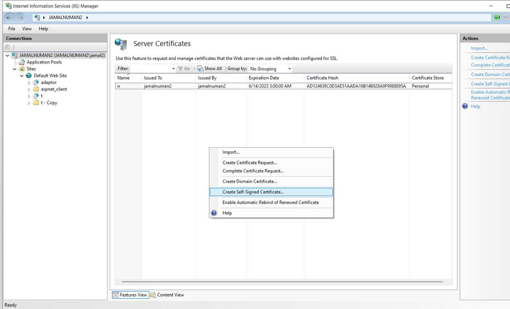

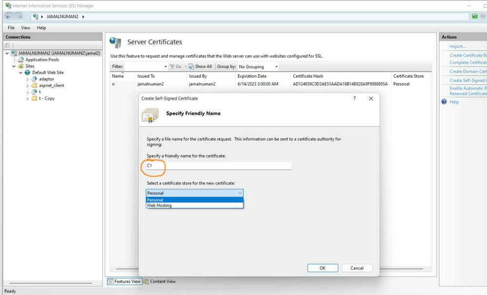

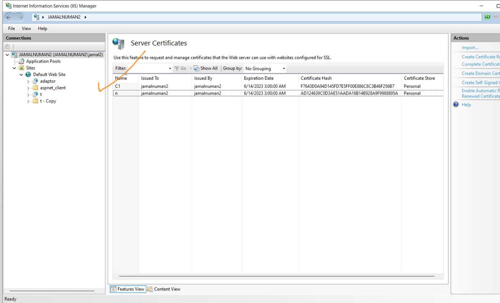

Thank you JonEmch for the help. It works fine as per the screenshots below
