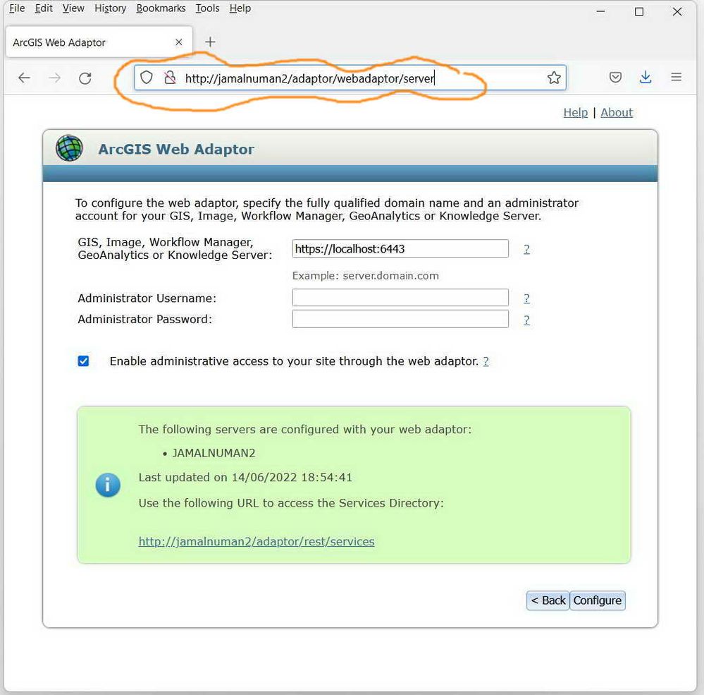

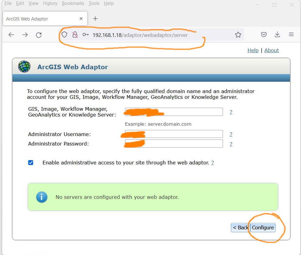

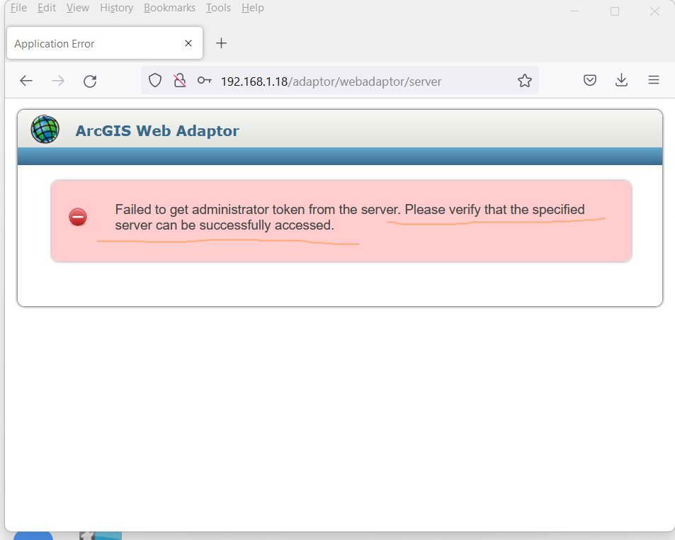

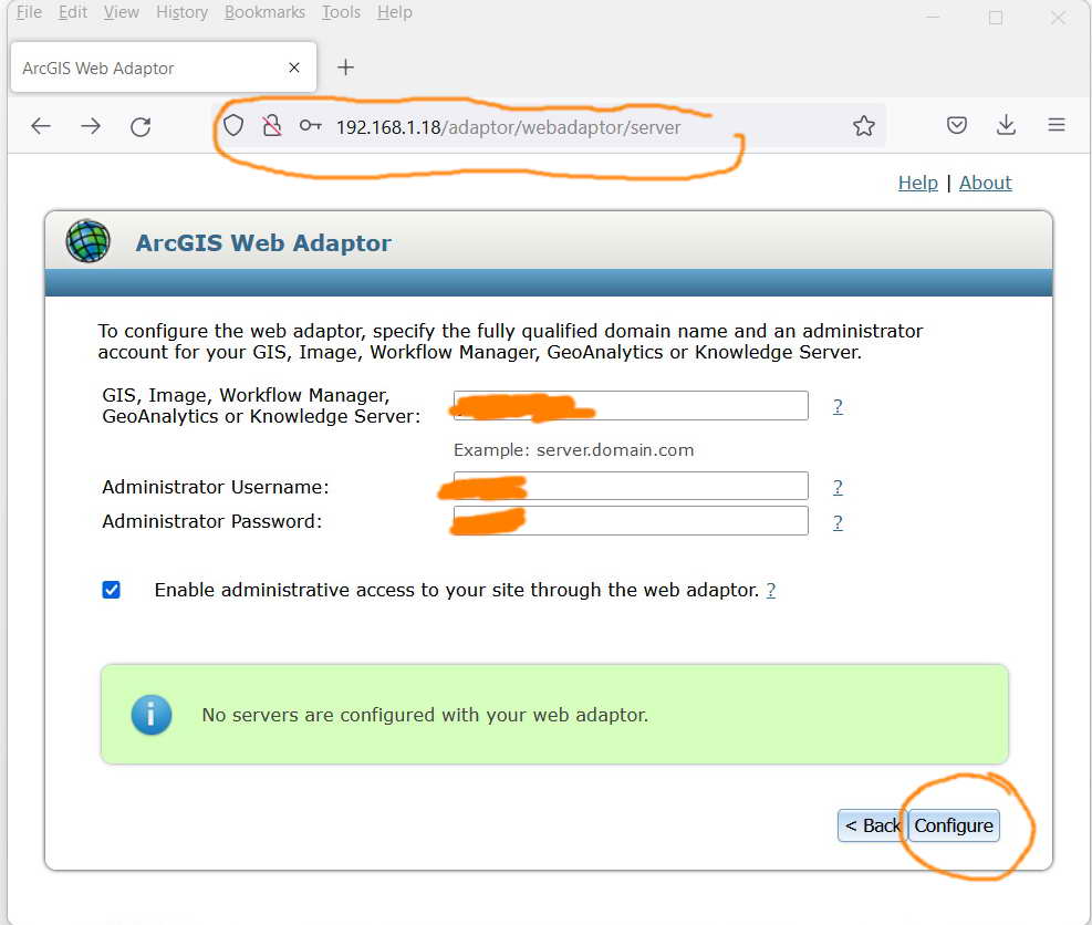

I couldn’t figure out why configuring the Web Adaptor ends up with token and access issue as per the screenshots below
"Failed to get administrator token from the server. Please verify that the specified server can be successfully accessed."

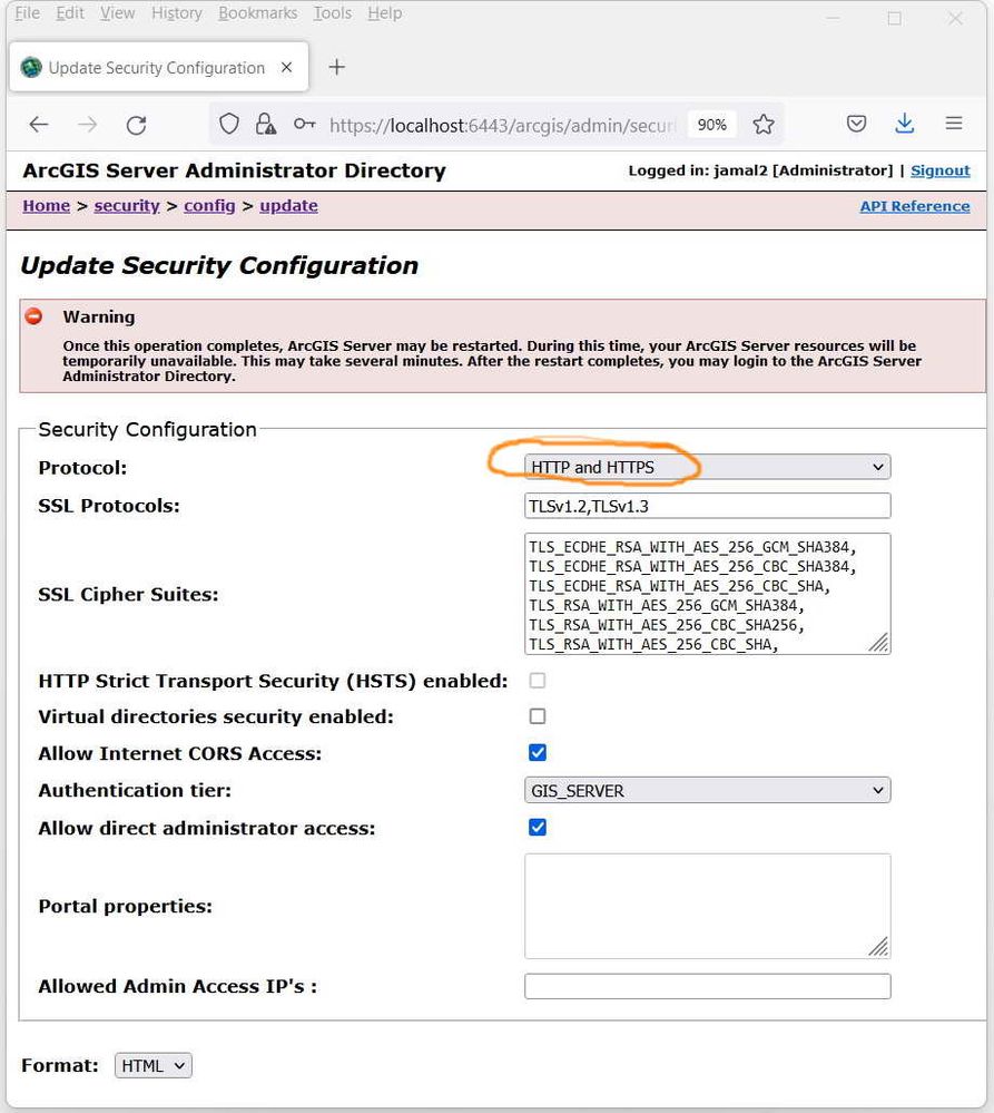

The issue here is not the machine name, localhost or IP. It appears to be related to https\http issues.
It should work with:
http://jamalnuman2/adaptor/webadaptor/server
but not with https:
https://jamalnuman2/adaptor/webadaptor/server

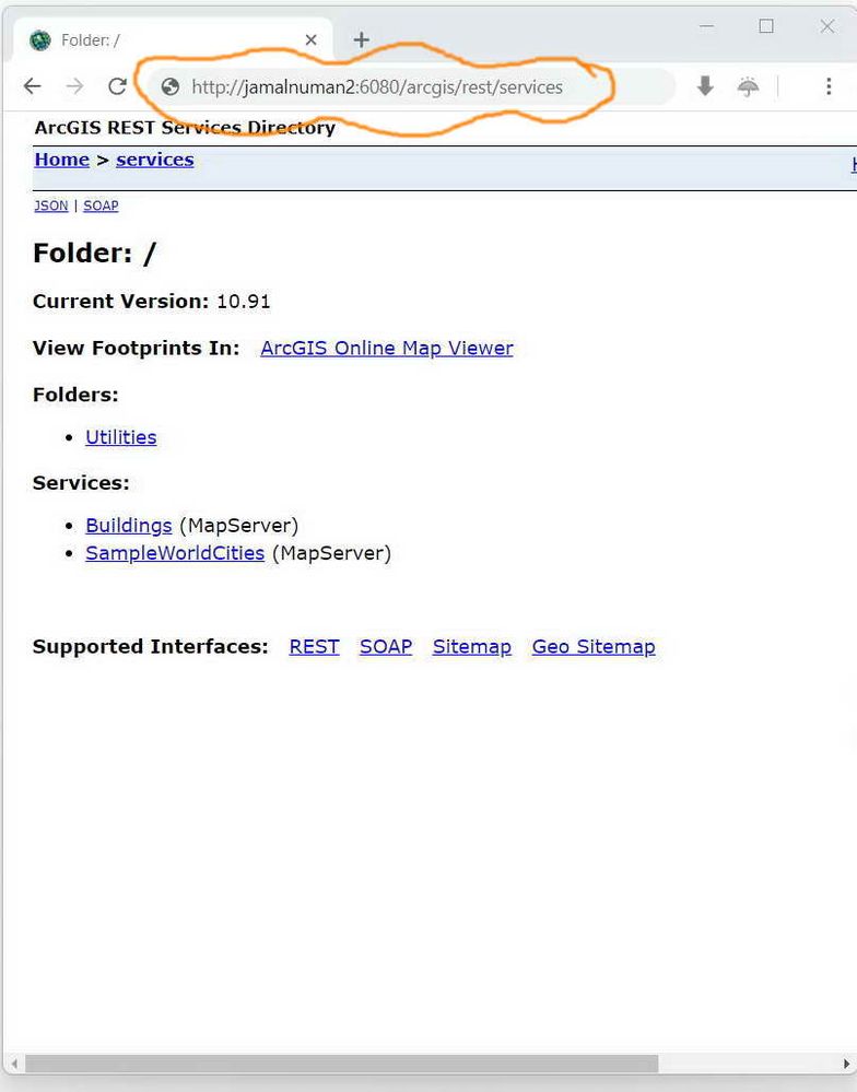

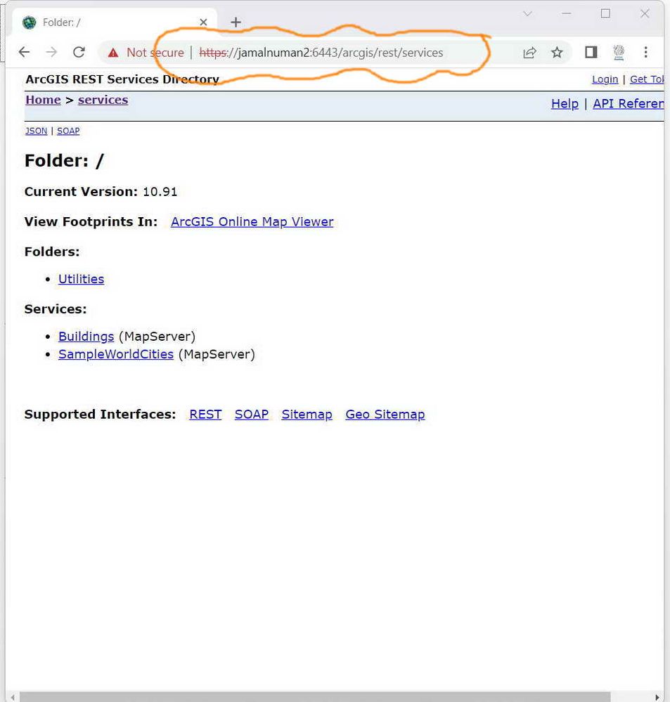

despite the fact that the services directory works with both http and https
http://jamalnuman2:6080/arcgis/rest/services
https://jamalnuman2:6443/arcgis/rest/services
