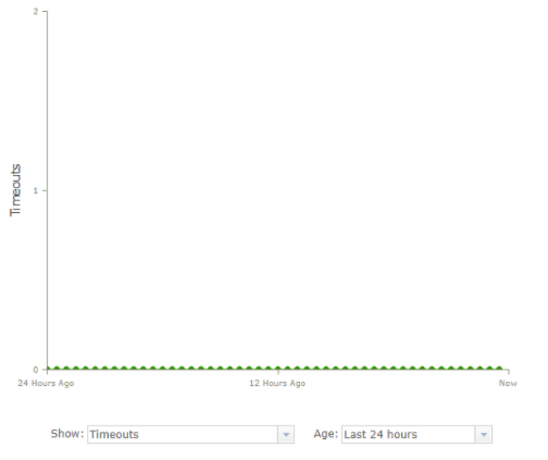

However if I look at the Stats view, ArcGIS Server tells me that:
There are zero incidents of service timeouts:

Mulling it over a bit it makes sense. It seems:
The distinction between the error messages and the stats posted above are indeed related to usage time and wait time. As stated in link: Wait time is the time  before ArcGIS Server is ready to handle a request; Usage time is how long ArcGIS Server takes to process the request.
The Timout stats relates to usage time which in our case is left at default 600 seconds (10min). Since none of our services ever need that much time to process, it correctly reports nothing.
The MaxResponseTime also relates to usage time which we see has gone over 60 seconds in some instances (but not beyond 10mins).
The log messages of course relate to "Wait Time". These are failures of ArcGIS Server to get to starting our job before its own limit of 60 seconds. (It sure would be nice for ArcGIS Server to have a way to view this in the stats view.)
