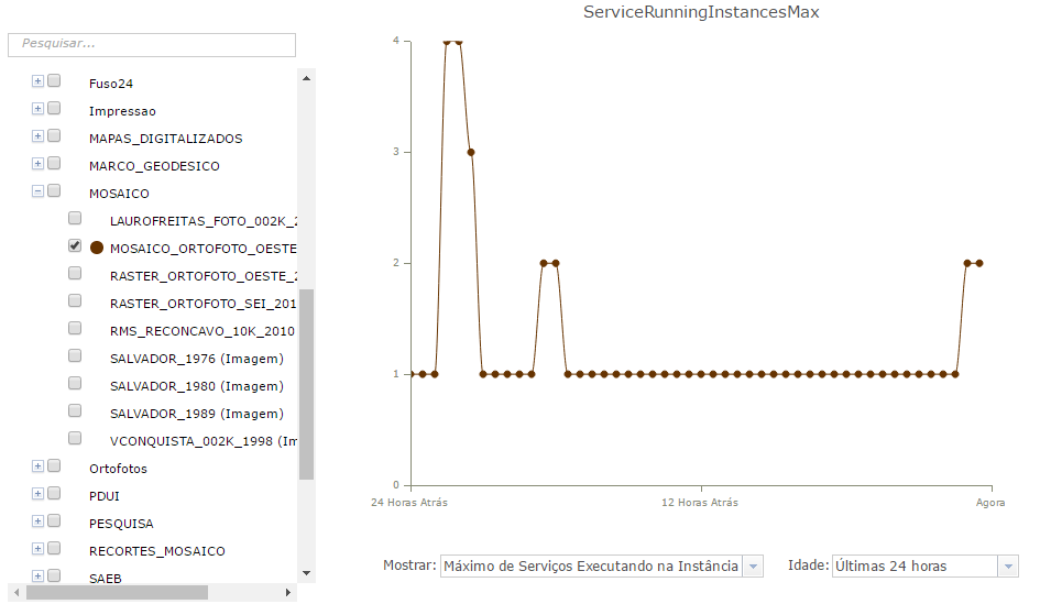

Updates from 2016/10/26
Using the server manager, I could generate the following report:
Despite of the Portuguese stuff, this report is from the same service witch I requested the json at the beginning of this post. In order to learn more about how the web manager do its job, I sniffed the network to capture the json request that generated this manage report and for my surprise I got this json:
 "reportname": 1477487802255,
 "since": "LAST_DAY",
 "queries": [{
 "resourceURIs": ["services/SISGEOPOLIS/LinhaTrecho23.MapServer"],
 "metrics": ["ServiceRunningInstancesMax"]
 "metadata": {
 "temp": true,
 "tempTimer": 1477488074129
A strange thing here. Please take attention to the metrics array: I don't even know about the ServiceRunningInstancesMax. This official esri doc page was supposed to mention that but it does not.
Question 1: since there were service usage, why is ServiceActiveInstances not supported ?
Question 2: Where can I find an up to date documentation about admin usage reports which mentions all metrics, including ServiceRunningInstancesMax ?

The documentation  seems wrong. The metrics is 'ServiceRunningInstancesMax' and not
'ServiceActiveInstances'
The help link is http://resources.arcgis.com/en/help/arcgis-rest-api/02r3/02r30000027n000000.htm
I noticed another problem: if there is only this metric the result is correct, but if it is with other metrics the result of ServiceRunningInstancesMax is incorrect
I have made a console (c#) that you can schedulate that create excel file from usagereport https://github.com/nicogis/UsageReports/releases
