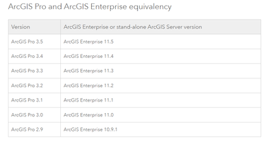

That is correct. Either you need to upgrade to Enterprise 11.0 or above or use ArcGIS Pro 2.9 or older.
ArcGIS Enterprise 10.9 has ArcGIS Pro 2.x runtime. As you know Pro 3.0 is a major upgrade and any project or project item such as mapx, pagx, aprx etc. that you create in 3.0 can't be opened directly in ArcGIS Pro 2x.
That is why when you create layout templates (.pagx files) in 3.0 and share them as part of a print service in 10.9.1 or older, it can't open because it only knows how to open pagx files created in 2.x not in 3.x.

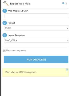

I published a printing service from ArcMap, but when trying to use it, I received the error:
"Web map as JSON is required."
What could be causing this issue?
Arne_Gelfert
@becyr Sorry to hear about your troubles there. I fell for you. I can relate. Currently rebuilding a bunch of old WAB app that have GP services associated in JSAPI 4.x. Total waste of my time, it feels like, when I could be focusing on value-add type work.
While I have had ESRI folks on the phone telling me that Desktop/Server (Enterprise) compatibility is more of a recommendation than a strict rule, my experience is that you want to match what they "recommend". In fact, the my main reason for going to 11 is so that I can continue upgrading Pro.
https://pro.arcgis.com/en/pro-app/latest/help/analysis/geoprocessing/share-analysis/web-tool-compati...
Try to stick with this. Otherwise, you'll have to work with some hacks. You using any Layout templates? I posted a while back on how you can force them to work using a "hack".
Stop publishing in ArcMap. I still use it all the time for viewing data. But consider it "verboten" when working with Enterprise. My two cents.
