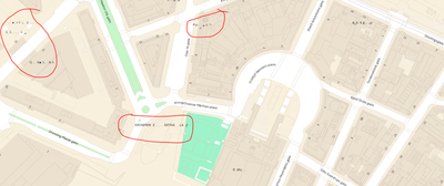

Hi there!
I discoved when I cahe a mapservice there is some strange with my text in some levels.
Does anyone have som idea how to fix this?
thx for help!

@Antonio_Dang Thank for reaching out, this is definitely a weird one! I've seen this before when working in ArcGIS Server 10.7.1. We release a patch for it: ArcGIS Server 10.7.1 Text Drawing Patch and it was fixed in Enterprise 10.8.1 Could you confirm if you are working in this version of ArcGIS Server?

Antonio_Dang
Hi!
we have version 10.81.
our server is stardalone, also without portal.
