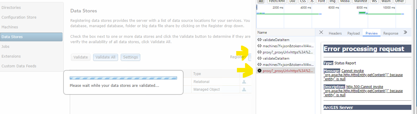

Hello,
Testing 11.4 environment on Windows Server 2022, I noticed that when validating the objectStore 2 times in a row, it fails the second time with a 500 error: "Cannot invoke "org.apache.http.HttpEntity.getContent()" because "entity" is null"
So it keeps loading for ever... But the first validation worked...
Anybody else can reproduced ?
Thanks
