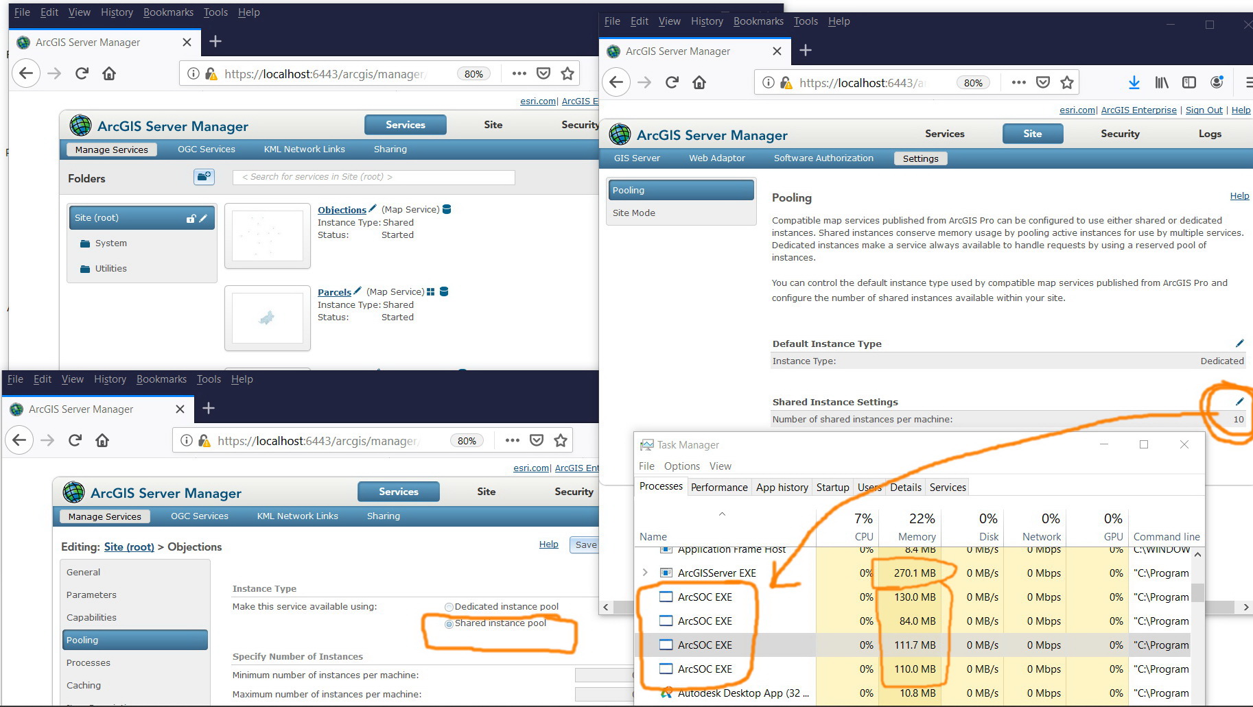

For example, in the screenshot below, the “Number of shared instances per machine” is set to be 10. However, at particular time, as I checked the number of active ArcSoc, I found that they are 4 but NOT 10. Does this mean that the “Number of shared instances per machine” will never consume machine resources (RAM and CPU) unless requests (traffic) on services require using all the number of shared instances (10 in this case)?

Hi Jamal NUMAN‌ That does not sound right and should not be the case. This setting basically controls a special System service in ArcGIS Server. Can you pls navigate to https://<YourServerURL>/admin/services/System/DynamicMappingHost.MapServer?f=pjson and check the values for "minInstancesPerNode" and "maxInstancesPerNode". The values should be 10 and 10 in your case. One possibility is that it was updated from the administrative endpoint and has different values for min and max. If they are the same, try stopping and restarting this specific service(DynamicMappingHost.MapServer).

The shared instances should always be running on each machine in your site. It's possible if you checked right away you might night not see the ArcSOC.exe immediately. As ArcGIS Server would take sometime to spin up the additional ArcSOC.exe after you update the shared instance pool settings.
You can run this follow command to count the number of ArcSOC.exe running on a machine.
tasklist | find "ArcSOC.exe" /c

In the screenshot below, the count of shared instances is 10 while the count of ArcSoc is 3
What could be the issue here?

Right.... stop\start the service below resolves the issue
https://localhost:6443/arcgis/admin/services/System/DynamicMappingHost.MapServer
