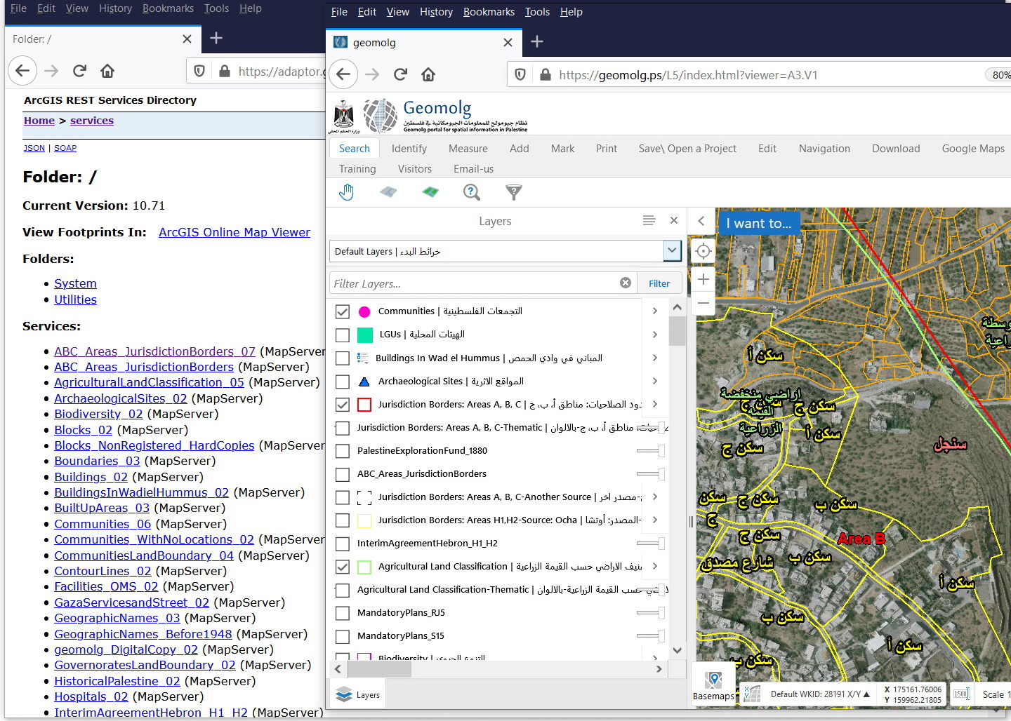

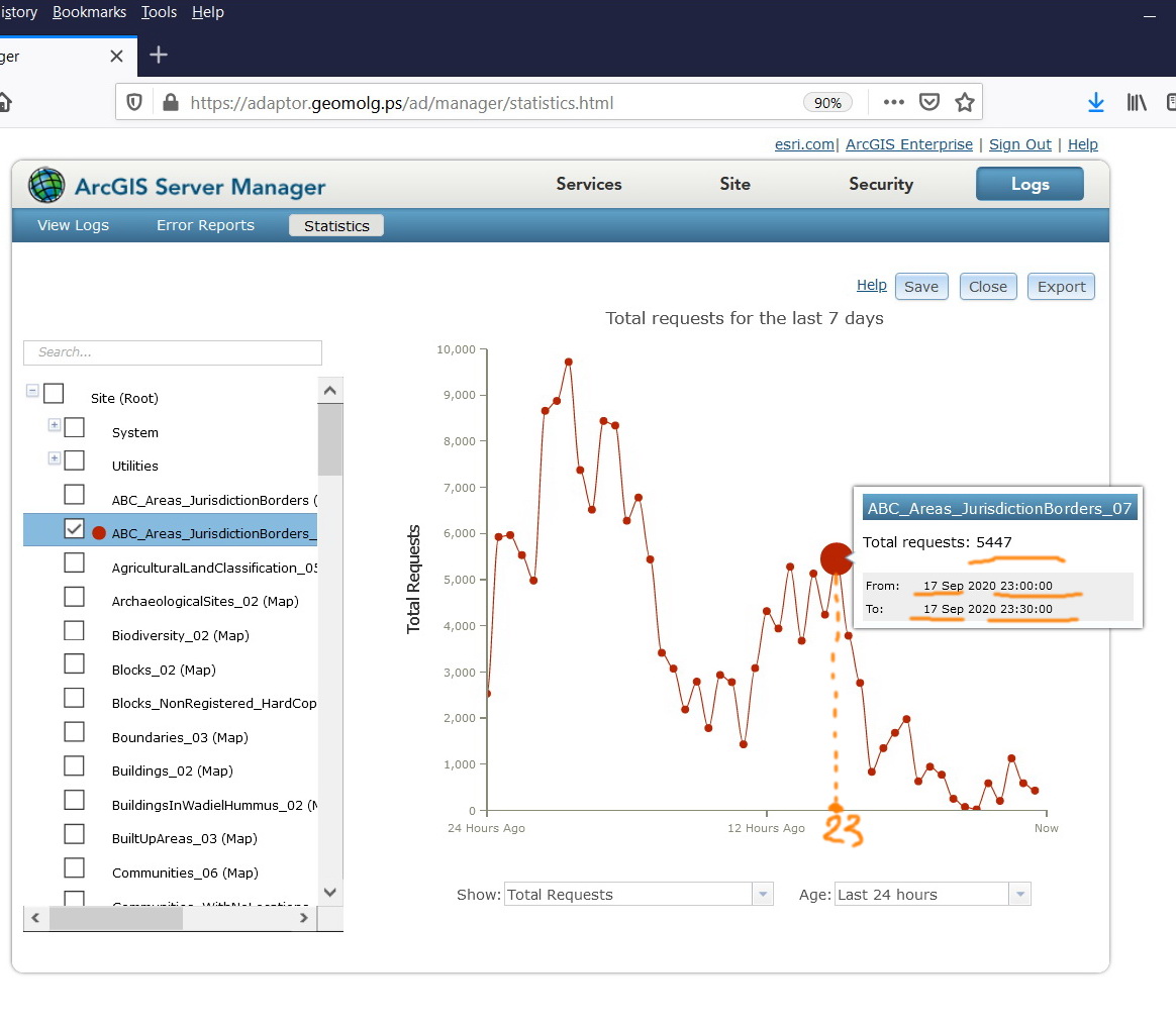

I couldn’t figure out how the number of requests is calculated. For example, how the following actions are translated in terms of request:
A user who is panning the map
A user who is downloading a service
A user who is editing a service

As per my understanding, It shows "Total requests" i.e. "Total number of requests made by a client to a service for a given time frame.". Which means it will include all the information which you have mentioned above:
  • A user who is panning the map
  • A user who is downloading a service
  • A user who is editing a service
Any transaction which is being performed between Server and Client. For more details you can go through the following document:
