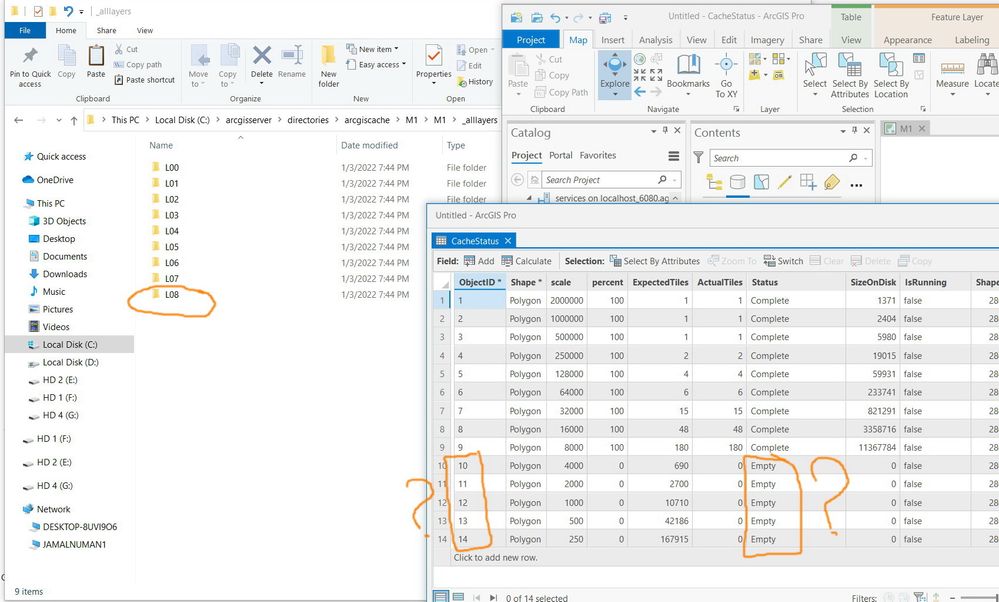

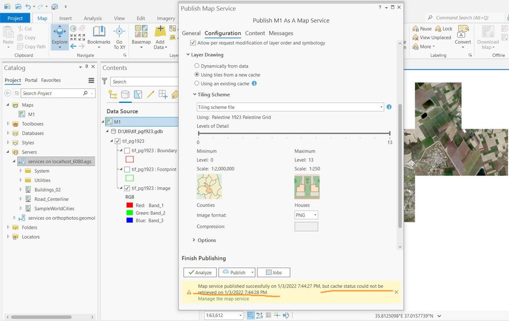

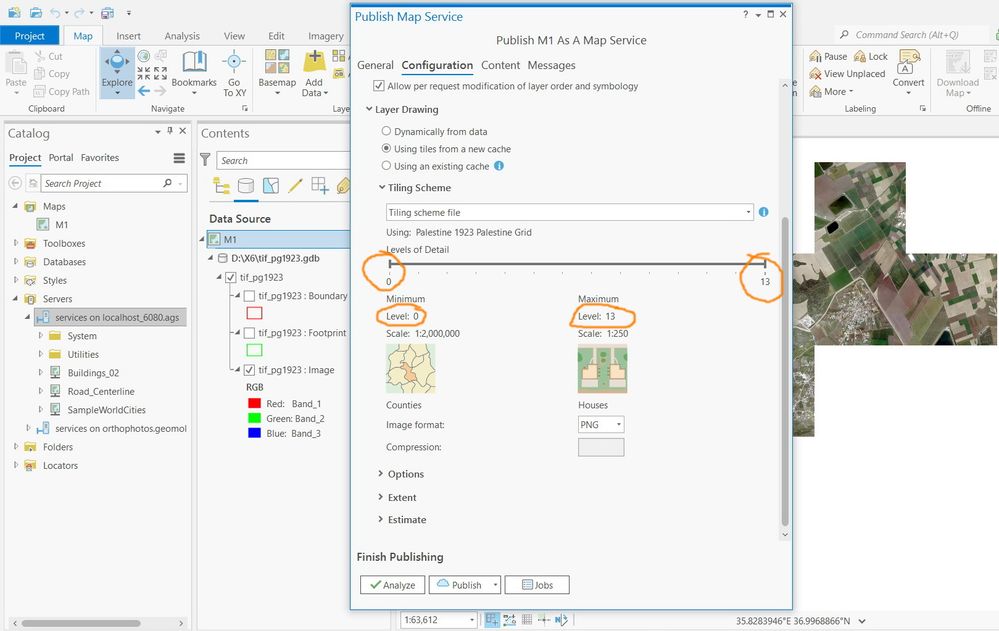

In the screenshot below, the cache configuration is set to produce 13 levels. The caching stops at L08.
What could be the issue here?

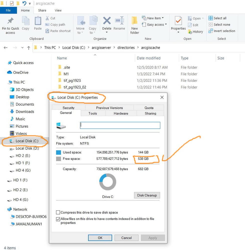

Is it possible you're out of space on the C: drive?
JamalNUMAN
Legendary Contributor
The area of the imagery that’s needed to be cached is really small while there is plenty of space in drive C as per the screenshots below
What other settings\issues I might need to consider here?
