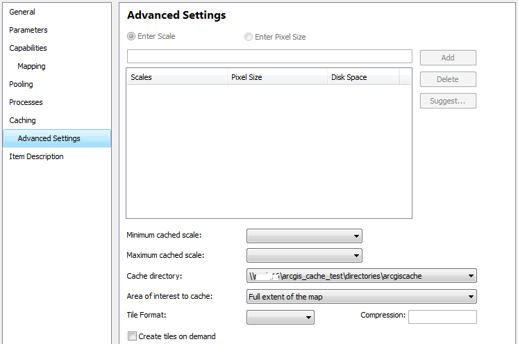

After dismissing the error window, I went into the service properties and saw the Adv cache tab is shown but with empty scale values. No folder was created in the cache folder on the server.

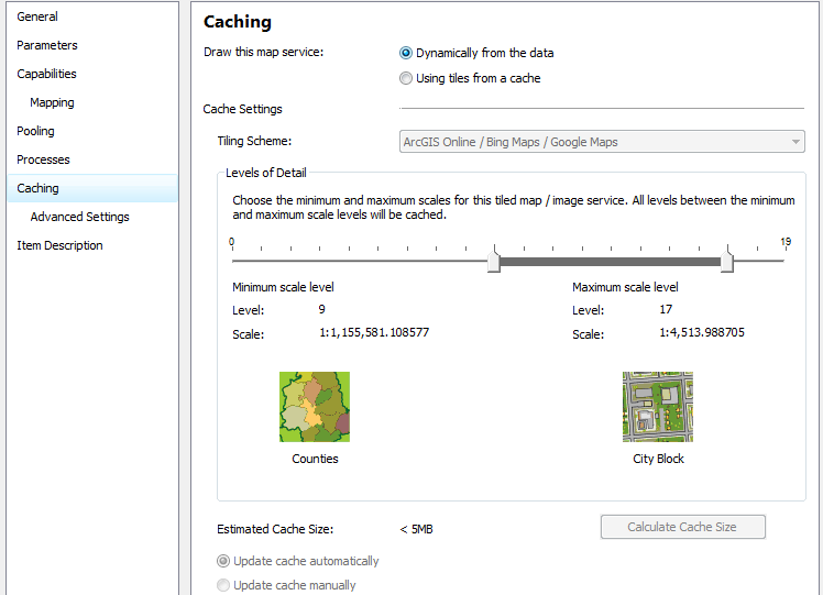

This may not be the issue, but in the first graphic/clip in you original message, ithe Dynamic layer option is checked, not the cache option.  That may be why no scales are showing.  (it may be you just grabbed the clip at the wrong time)​
ChenLiang
That is what I saw when the cache creation failed. When the Dynamic layer option is enabled, the Adv Cache tab is not supposed to show. So there is a definitely a problem.
