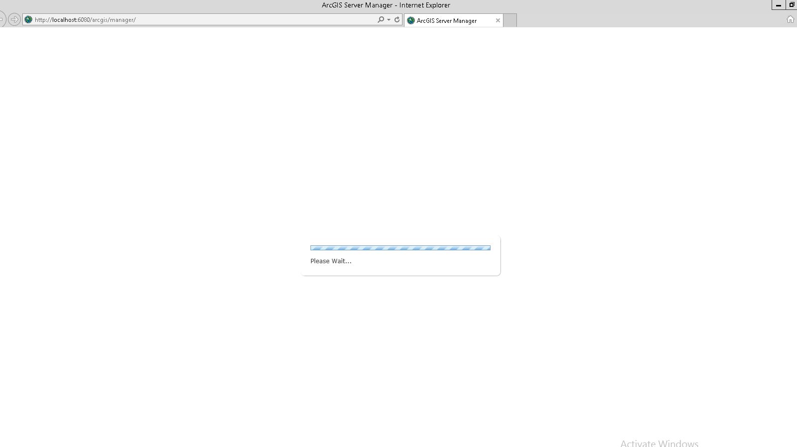

All,
   i just installed ArcGIS for server and for some reason the page that pops up to configure our site isnt loading!
    seems like im stuck on the page that loads in internet explorer saying "please wait..."  see below
anyone else run into this?
thanks

DaveTenney
ALL,
   well this was interesting...
after looking at a few things, the problem was resolved by accessing the server site config via: http://localhost:6080/arcgis/admin which prompts the same steps to configure your site, just not in the pretty way youre used to when installing server.
     you will also have to go in and configure your directories accordingly once you sign into manager.
thanks all for the help and hints!

DaveTenney
i am very curious why the site config wouldnt just load automatically like it normally does after you authorize your server install? im curious as to why it was able to set up and config in this alternate route?
  i actually had esri support stumped with this one on the phone for about 30min, supposed to talk to them again so i will have to fill them in and see if maybe they have an explanation.
thank you all again for your help!
