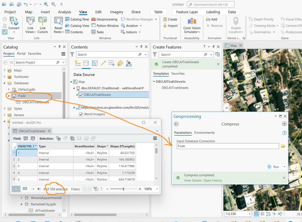

Correct. I wanted to compress the geodatabase to state 0

I went through several documents related to compressing but didn’t find what I’m encountered in.

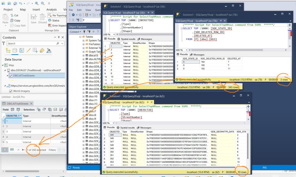

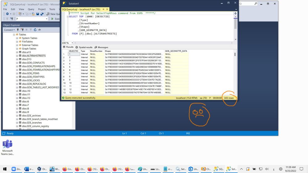

In the screenshots of my first post, there is a difference between the number of records of the attribute table of the feature class and its corresponding the base table despite the fact that the compress tool is performed.
How to get them (the attribute table of the feature class and its corresponding base table) identical in terms of number of records?

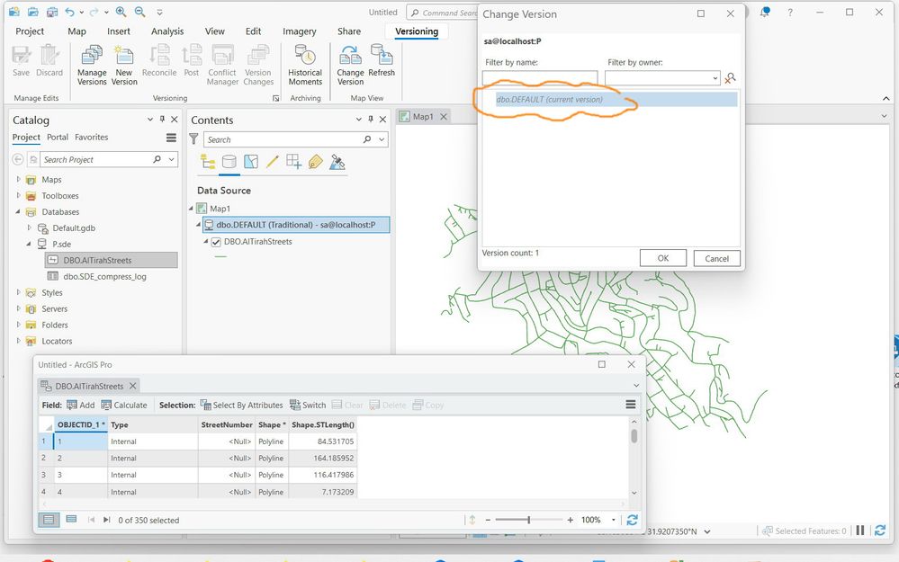

Ne versions are there as per the second screenshot

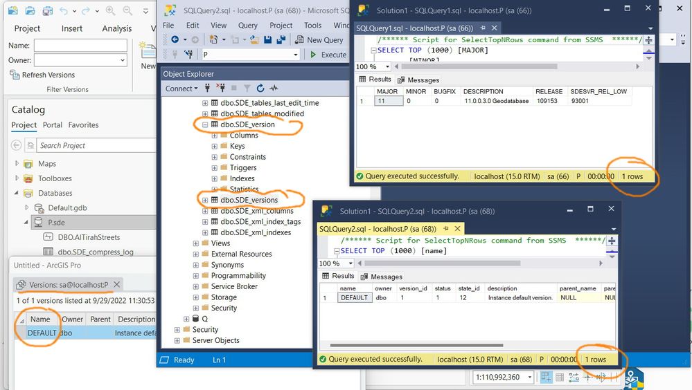

What does your dbo.versions table look like?
There must be something pinning the state. Have you run the reconcile / post tool yet?
Are you only editing in dbo.DEFAULT version?
Are there any locks on the tables?
--- George T.

What is in the dbo.versions table in SSMS?
Something is blocking the full compress.
--- George T.

Here you go a screenshot for the version
