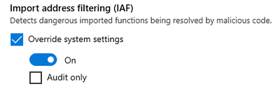

One more small information.
Only the "Import address filtering (IAF)" rule in Exploit Protection is causing the crash.
It has to be disabled for the moment
