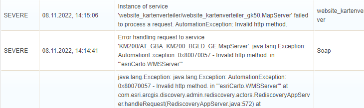

We use ArcGIS for Server 10.9 on Windows Server 2016. Address: http://gisgba.geologie.ac.at. The services are running very well, performance is okay. Nevertheless, the logs show numerous error messages that all contain the same message "AutomationException: Invalid http method":
For example:
<Msg time="2022-11-01T08:53:54,583" type="SEVERE" code="8001" source="WISA/AT_GBA_TIEFENGRUNDWAESSER500.MapServer" process="17808" thread="25" methodName="" machine="***.GEOLOGIE.AC.AT" user="" elapsed="" requestID="">Instance of service 'WISA/AT_GBA_TIEFENGRUNDWAESSER500.MapServer' failed to process a request. AutomationException: Invalid http method.</Msg>
<Msg time="2022-11-01T08:54:02,5" type="SEVERE" code="8001" source="G1000/AT_GBA_G1000_PLATTEN_DECKEN.MapServer" process="11960" thread="25" methodName="" machine="***.GEOLOGIE.AC.AT" user="" elapsed="" requestID="">Instance of service 'G1000/AT_GBA_G1000_PLATTEN_DECKEN.MapServer' failed to process a request. AutomationException: Invalid http method.</Msg>
Error handling request to service 'website_kartenverteiler/website_kartenverteiler_gk50.MapServer'. java.lang.Exception: AutomationException: 0x80070057 - Invalid http method. in '"esriCarto.WMSServer"'

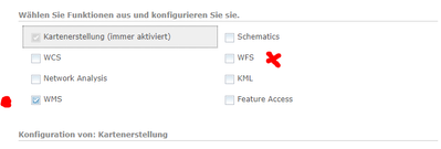

Have you published the service with the WMS capability?
Yes, we have enabled WMS, but not WFS.

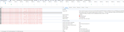

In my case, I have isolated the issue to the client app sending HTTP OPTIONS requests to the server, as well as the HTTP GET requests.
The HTTP GET requests are successful and receiving tiles, and so the WMS layer works as expected in the client app.
However each of the HTTP OPTIONS requests fail with HTTP code 400. The requests lead to the SEVERE level logs in ArcGIS server, as seen in the original post.
screenshot shows the failing OPTIONS requests in the browser network tools:
