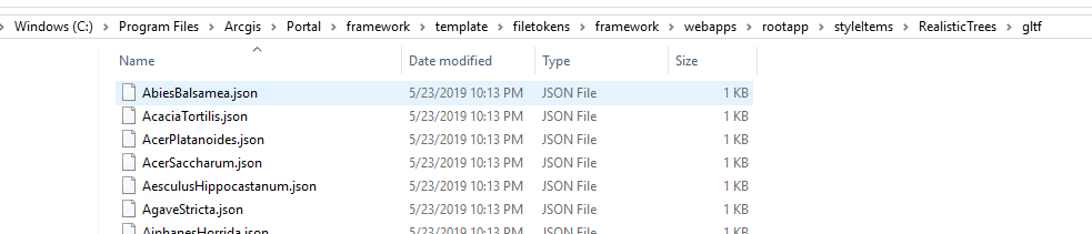

I checked in ArcGIS Setup directory to check if the files had been properly installed and they are:

I set up an 10.7 ArcGIS Enterprise again and found out that those files are also in the folder:
C:\Program Files\Arcgis\Portal\framework\webapps\rootapp\styleItems
in addition to:
C:\Program Files\Arcgis\Portal\framework\template\filetokens\framework\webapps\rootapp\styleItems
So I compared the 10.7 folder with 10.7.1 and indeed some folders are missing in 10.7.1 deployment:

I then upgraded my 10.7 deployment to 10.7.1 and at the end, I only had "Icons" and "ThematicShapes" folders. All the others were gone.
So it is the 3rd upgrade from 10.7 to 10.7.1 and everytime the missing folders are not deployed so I believe there is an issue somewhere.
Also, I tried to "repair" the 10.7.1 installation but at the end, the files were still missing.
