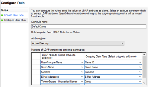

Thanks for reaching out. While the internal attributes (the ones provided by your Active Directory) cannot be edited, Portal for ArcGIS expects to receive group membership claims in the formats you listed below. However, any attribute from your AD that contains group information can be mapped to one of the "group" claims the Portal expects. Here's an illustration from our SAML (ADFS) configuration document that illustrates this well:
You'll see that entries in the left-hand column (from your Active Directory) are associated with outgoing claims that are sent to Portal for ArcGIS, on the right. In the example, "Token-Groups - Unqualified Names" is mapped to the "Group" value. However, you could easily replace "Token-Groups - Unqualified Names" with any group attribute that exists in your Active Directory.
