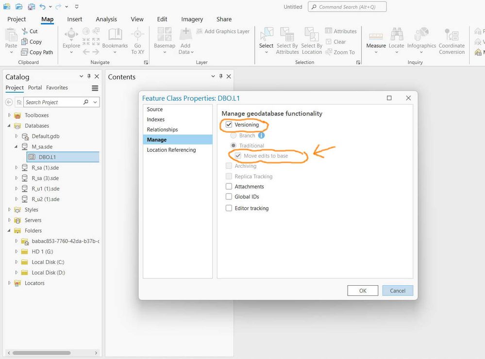

For example, in the screenshot below, the versioning is set to be traditional with enabling “move edits to base” option. How the “move edits to base” option can be unchecked that’s already set for a particular feature class?

I am thinking you are testing scenarios here. I suggest use the GP  Unregister As Versioned first.  Reference this documentation to review the Versioning Type that best meets your business requirements.
Thereafter, redo Register As Versioned  with appropriate options.

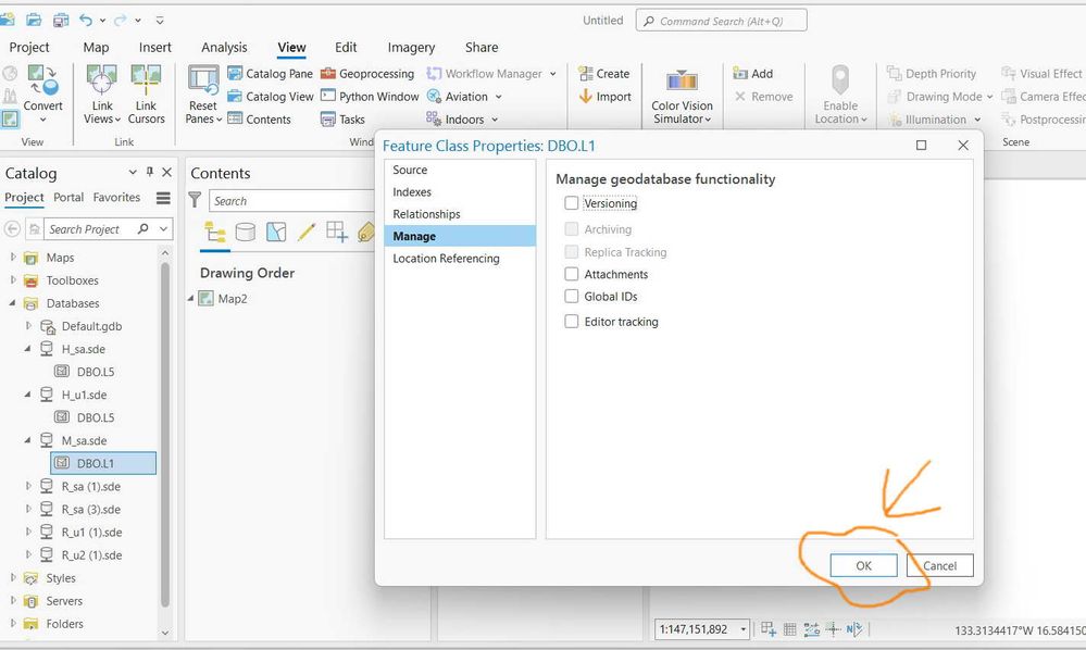

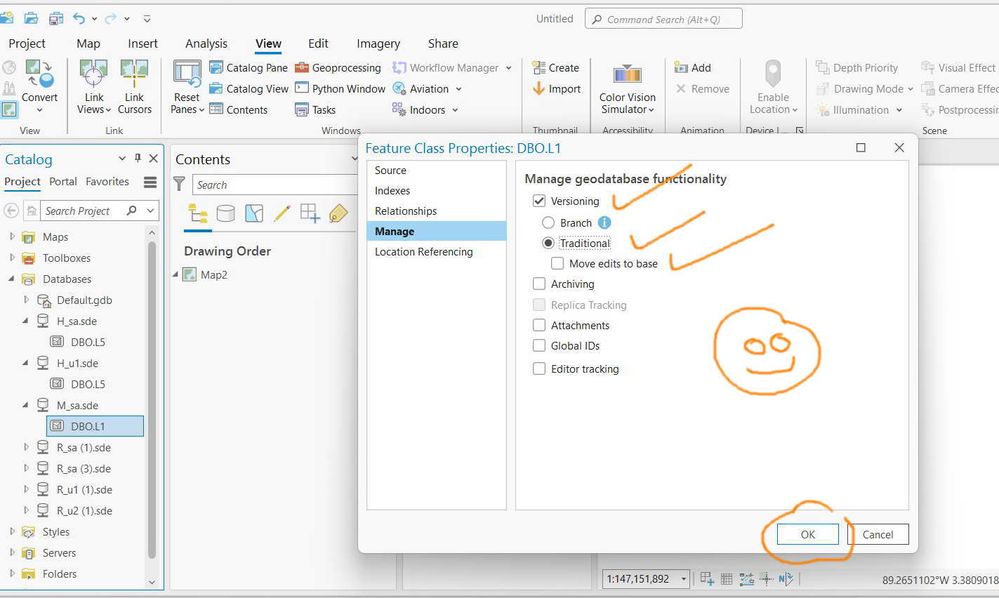

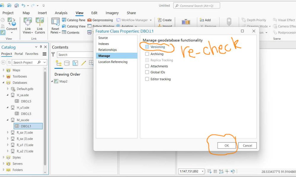

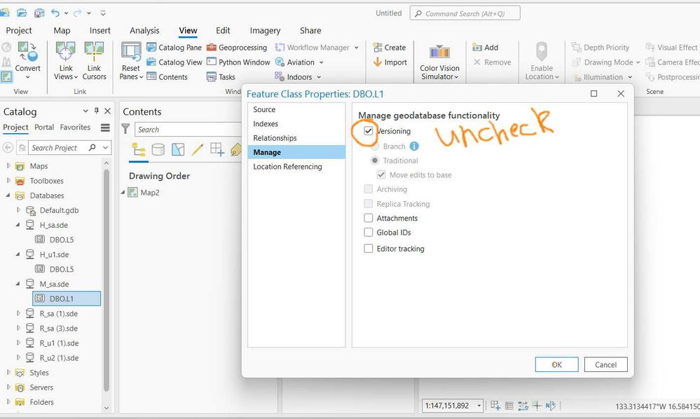

Great. It works fine. By unchecking\rechecking the versioning option one can disable\enable the “move edits to base” option
