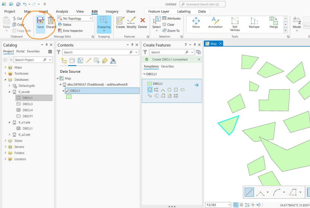

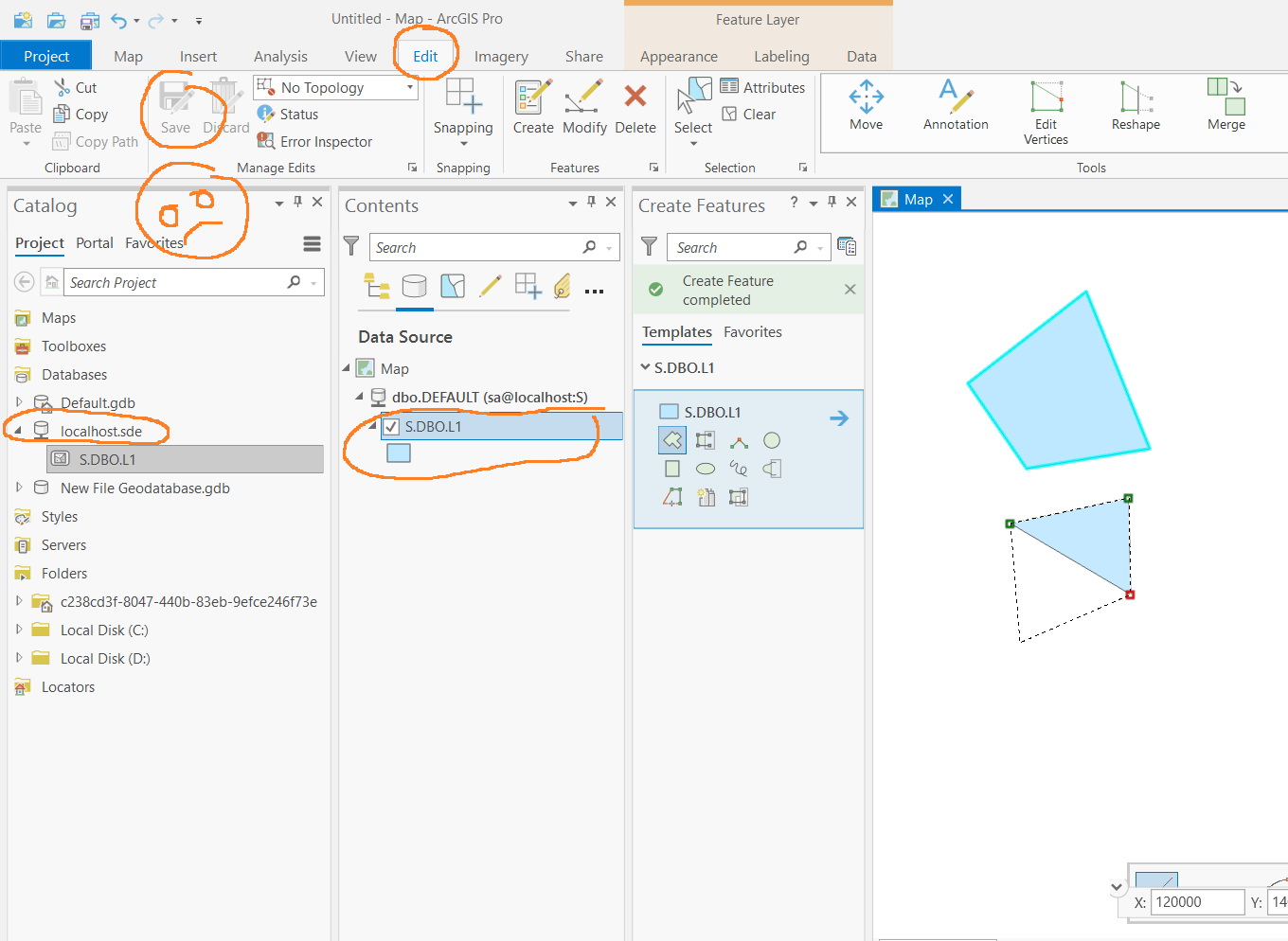

I couldn’t figure out how to disable the automatic saving of edits on enterprise geodatabase feature class.
Is this by design?

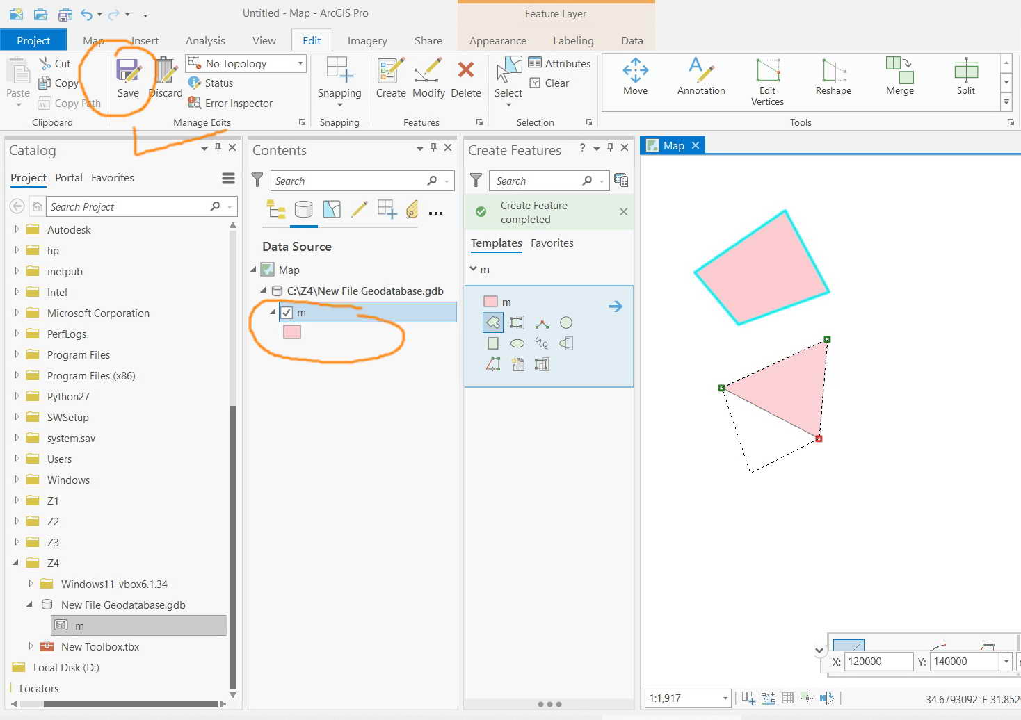

In case of file geodatabase feature class, edits are not saved automatically and requires pressing on the “save” icon.
Jamal Numan
StevenBell2

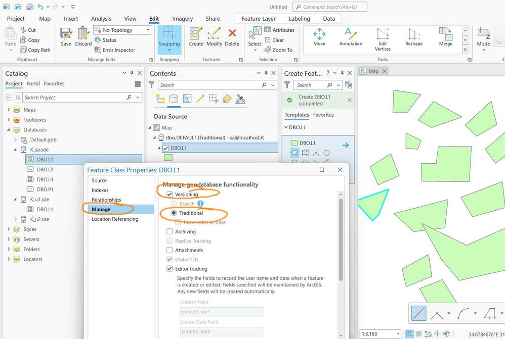

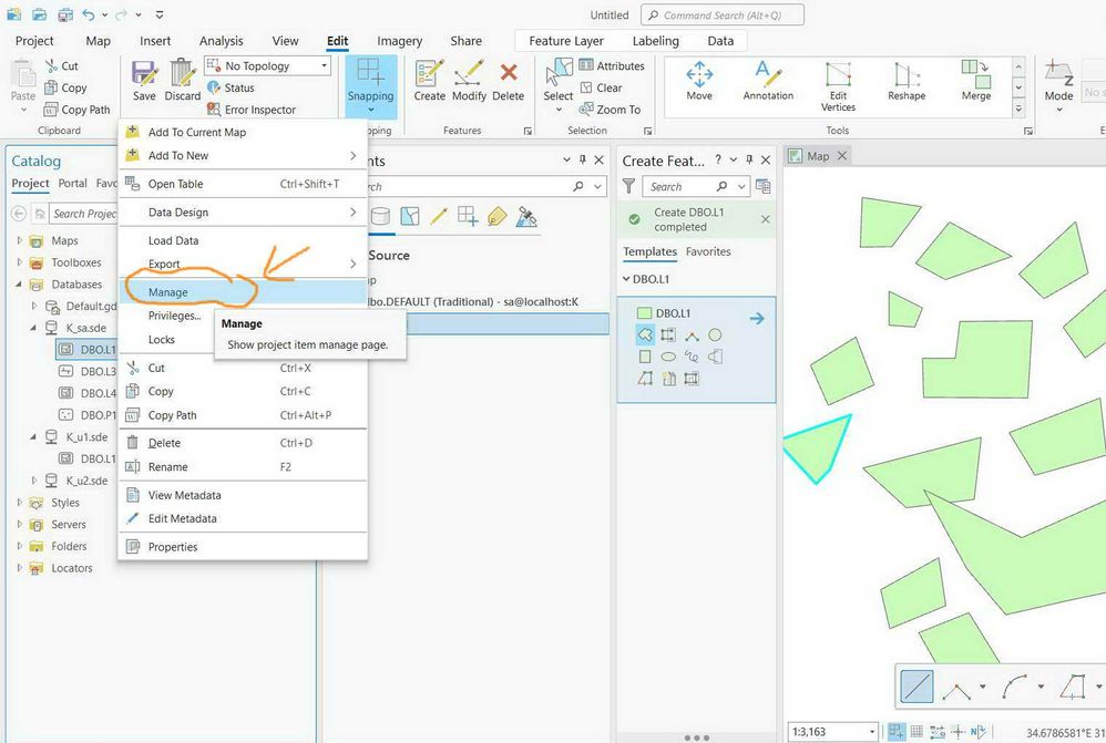

You would need to register your data as versioned.
StevenBell2
JamalNUMAN
Legendary Contributor
Enabling the versioning option for the feature class gets the “save” tool active when edits are made
