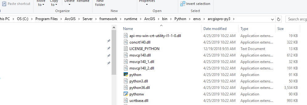

Quick question regarding the python 3 requirement we are running twin 10.6.1 servers I can see the directory specified for python 3 in the article do we need to actually run the executable to install python or is it already installed? When we do the CMD I can tell we call the exe just wanting to making sure we didn't need to run it separately beforehand.
Sorry if this seems a silly question
Thanks
Tom
RexRobichaux
Hey Tom,

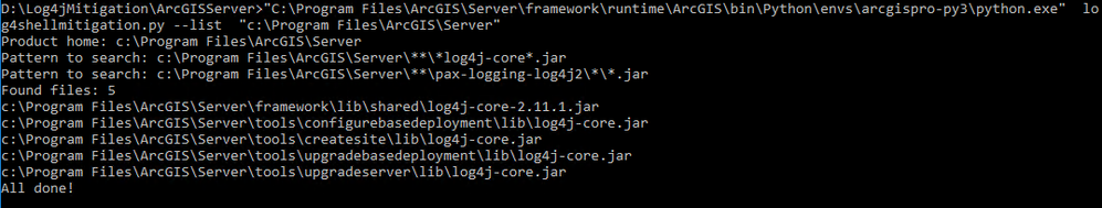

 Python 3.x is already installed with ArcGIS Server and the executable resides in that directory. So, all you are doing in command prompt is pointing the python executable in that location, to the python script file you downloaded, and providing a command for the script(--list or --delete) for example (assuming you have CD'd to the same folder/directory where Esri's log4shellmitigation.py script resides):
List the .jar files:
"C:\Program Files\ArcGIS\Server\framework\runtime\ArcGIS\bin\Python\envs\arcgispro-py3\python.exe"  log4shellmitigation.py  --list  "c:\Program Files\ArcGIS\Server"
Delete the offending code in the identified .jar files:
"C:\Program Files\ArcGIS\Server\framework\runtime\ArcGIS\bin\Python\envs\arcgispro-py3\python.exe" log4shellmitigation.py  --delete "C:\Program Files\ArcGIS\Server"
I hope this helps!
Example of the list command being run via the script:
