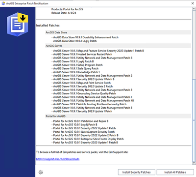

NaveedAhmed2
Thanks, @ArchitSrivastava for your response.
Please see the screenshots attached. Is there anything you notice below that is causing the issue. I appreciate your help.
ArchitSrivastava
Hello @NaveedAhmed2 ,
Thanks for sharing these. I agree with @CodyPatterson that there is nothing suspicious which is visible in these screenshot. However, I would also request if you can share a copy of the ArcGIS Data Store logs perhaps something may show up there.
