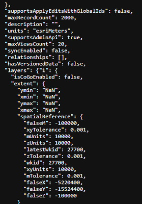

We have several File Geodatabases with custom XY Resolution and XY Tolerance settings that differ from the Esri defaults. For example, one dataset has an XY Resolution of 0.00005 m and an XY Tolerance of 0.0004 m.
Our long-term goal is to migrate all of our data to Esri's standard XY Resolution and XY Tolerance values. However, due to the size of our existing data holdings and dependent applications, this migration will take time. During this transition period, we need to be able to publish hosted feature services that preserve the legacy XY Resolution and XY Tolerance settings.
However, when we publish this data as a hosted feature service to an ArcGIS Enterprise data store, these settings appear to revert to the Esri default values (XY Resolution = 0.0001 m, XY Tolerance = 0.001 m).
We do not understand the technical background behind this behavior. When we inspect the File Geodatabase contained in the service definition (.sd) file, the custom resolution and tolerance values are still present. Nevertheless, the resulting hosted feature service operates with the Esri default values.

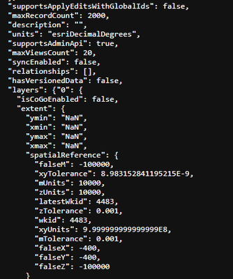

Hi @Adrian,
What version of ArcGIS Enterprise are you on?
I just tested quickly on ArcGIS Enterprise 12.1 and I was able to see different values on the Services for the XY Resolution and XY Tolerance

Adrian
Hi Glen
Thank you for your answer.
I tested this with ArcGIS Enterprise 11.5.0. We're planning to migrate to 12.1 in the next few months and I'm glad to see that the behavior appears to be different and that custom resolution and tolerance settings may be supported.
I'll let you know once I've had a chance to test it again on the latest version.
