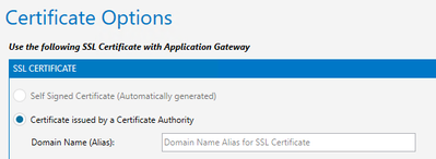

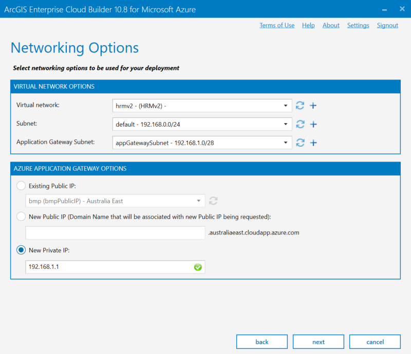

Hi. Hector,
I am encountering a similar issue.  I select a new private IP.  and in the next screen for the certificate options, self-signed certificate option is gray out.  Please see below.  I cannot go to the next step.
