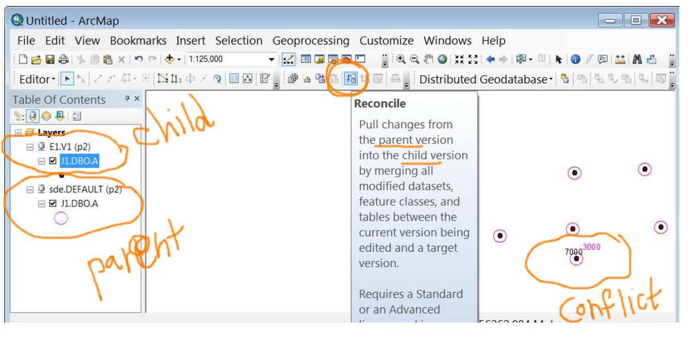

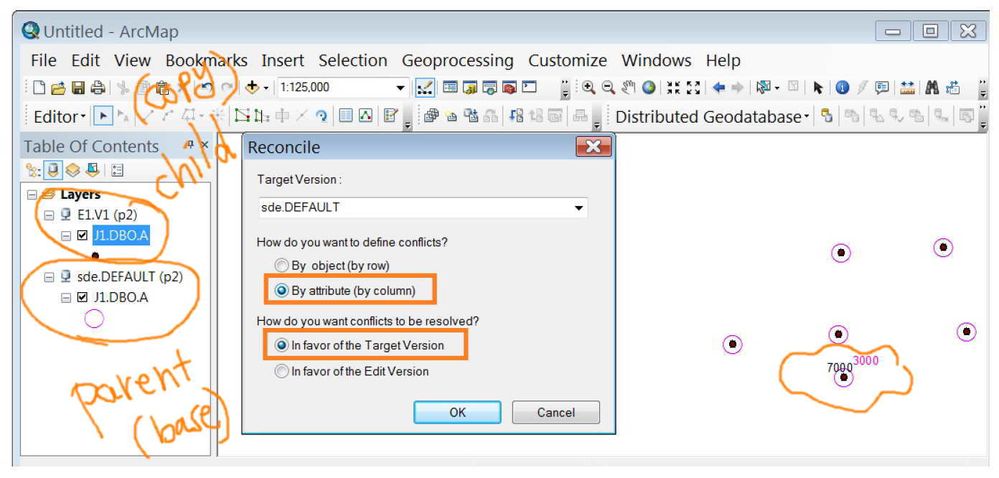

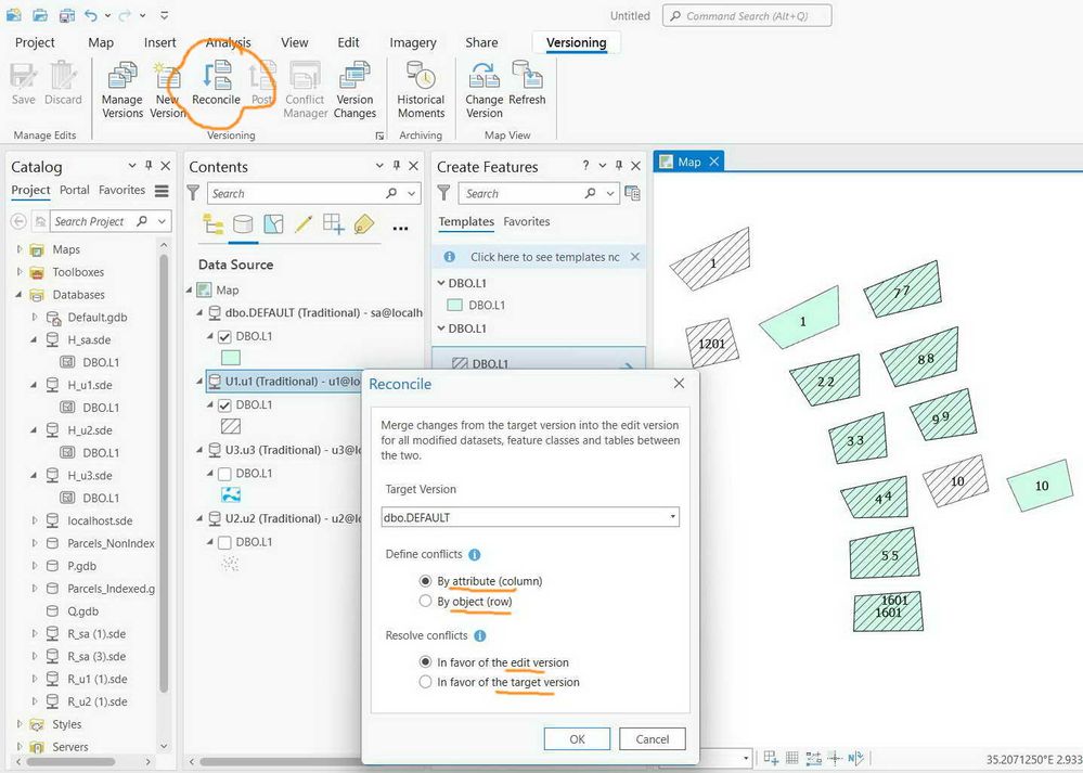

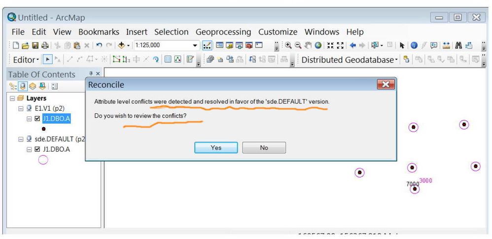

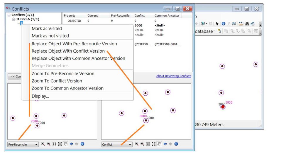

ArcGIS Enterprise (ArcGIS Pro 3.0.1): The “reconcile” tool appears not to detect conflicts nor to offer reviewing and resolving them as used to be in ArcMap,
I observed that the “reconcile” tool doesn’t detect conflicts and doesn’t offer reviewing and resolving (through drop down options) them as used to be in ArcMap
Is this by design?
