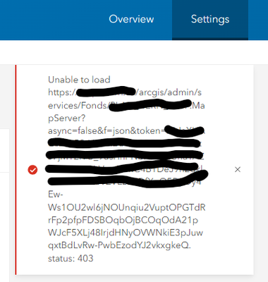

But whenever I access the settings of an item of a MapService, a pop up shows up:
The error is coming from the fact the ArcGIS Server web adaptor has the Admin access disabled so it should use the proxy I guess ?
Anyone facing the same issue ?

For information, it's been logged:
BUG-000163220: Accessing service settings runs into status error 403 when ArcGIS Server WebAdaptor is disabled for administrative usage
