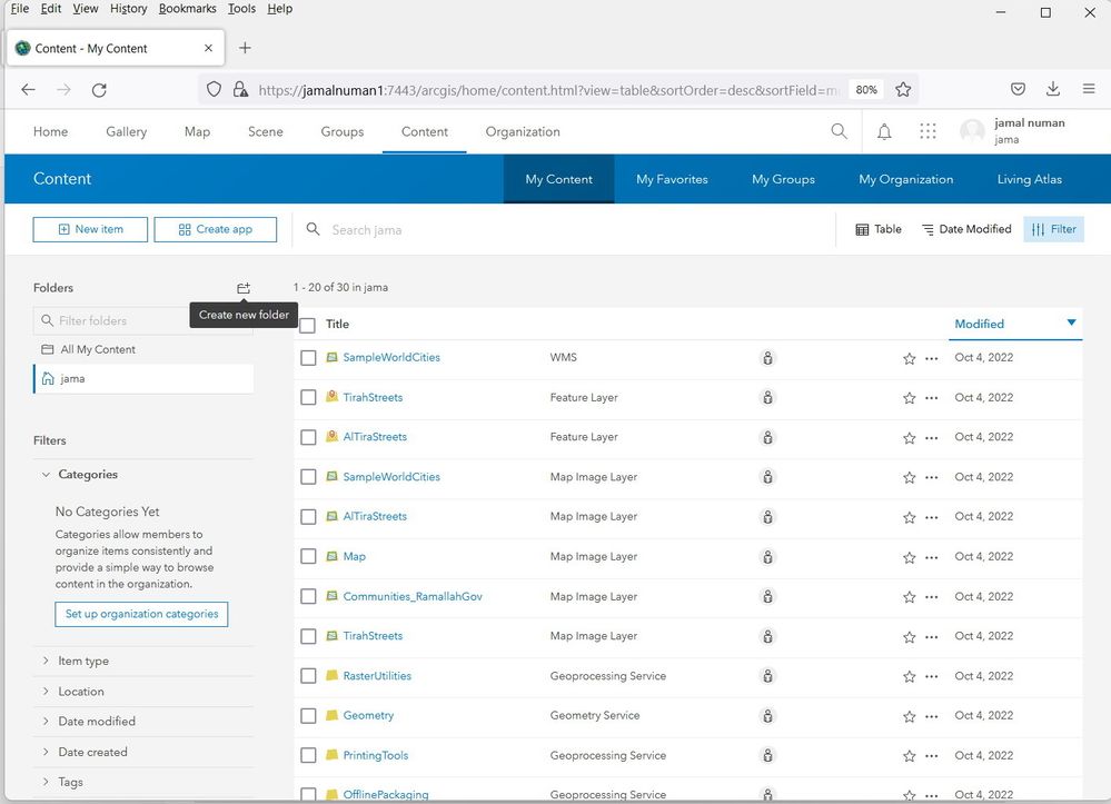

I couldn’t find the “create layer” button as per the screenshot below

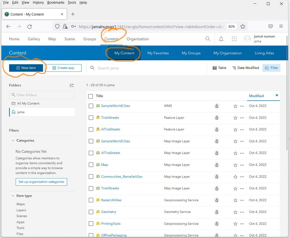

ChristopherCounsell
MVP Frequent Contributor
Click "New Item" and then "Feature Layer"
You can also check the Portal organization settings under servers, to see the hosting server configuration.

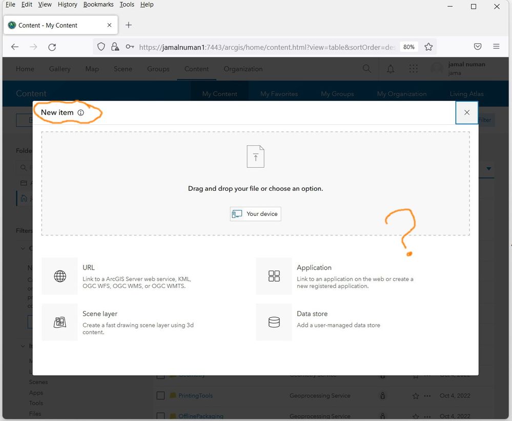

JamalNUMAN
Legendary Contributor

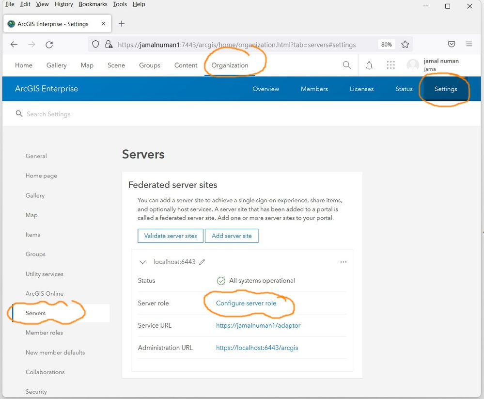

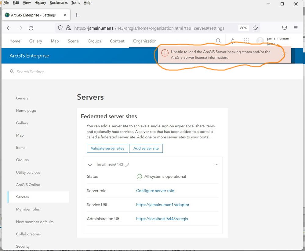

As per the screenshots below, there is no “feature layer” option while clicking the “configure server role” option ends up with “Unable to load the ArcGIS Server backing stores and/or the ArcGIS Server license information” error
Jamal Numan

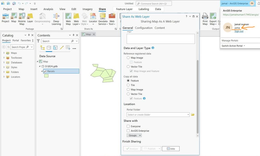

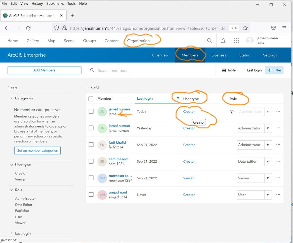

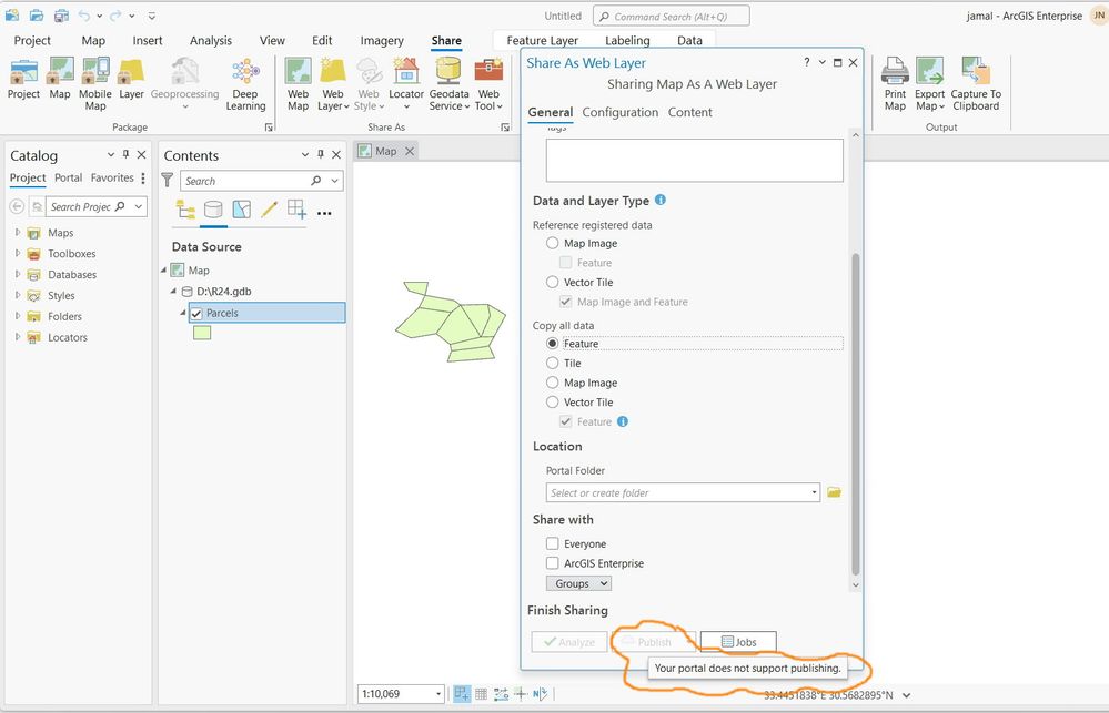

As per the screenshots below:
  • The grayed out “publish” button says that the “your portal doesn’t support publishing”.
  • The “jama” member is with “creator” user type
What might be the issue here?
Jamal Numan

@JamalNUMAN this was a quick test to see if you could create hosted feature layers.
From your response it appears that you have not completed the ArcGIS Enterprise deployment or there is something wrong with your hosting server.
You should have a federated ArcGIS Server with an ArcGIS Data Store, relational + tile cache data store, and then set this server as your Hosting server in Portal for ArcGIS. This is considered a minimum for a 'base deployment' of ArcGIS Enterprise. It is necessary for hosted feature layers and apps that would create them (e.g. survey123)

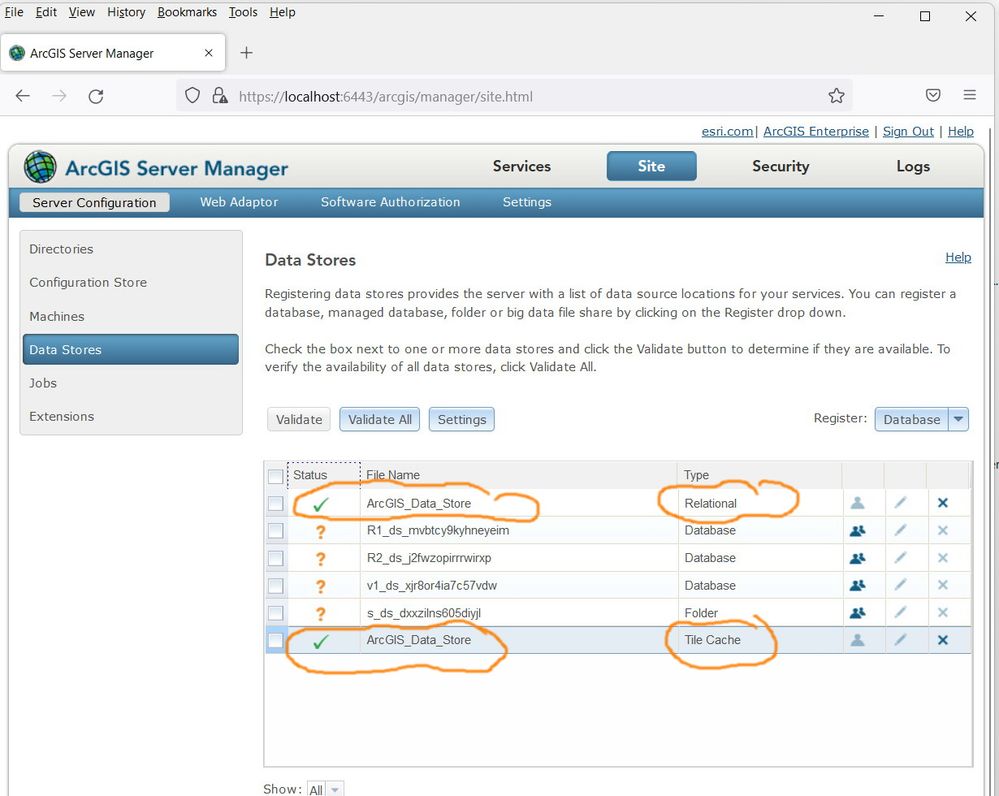

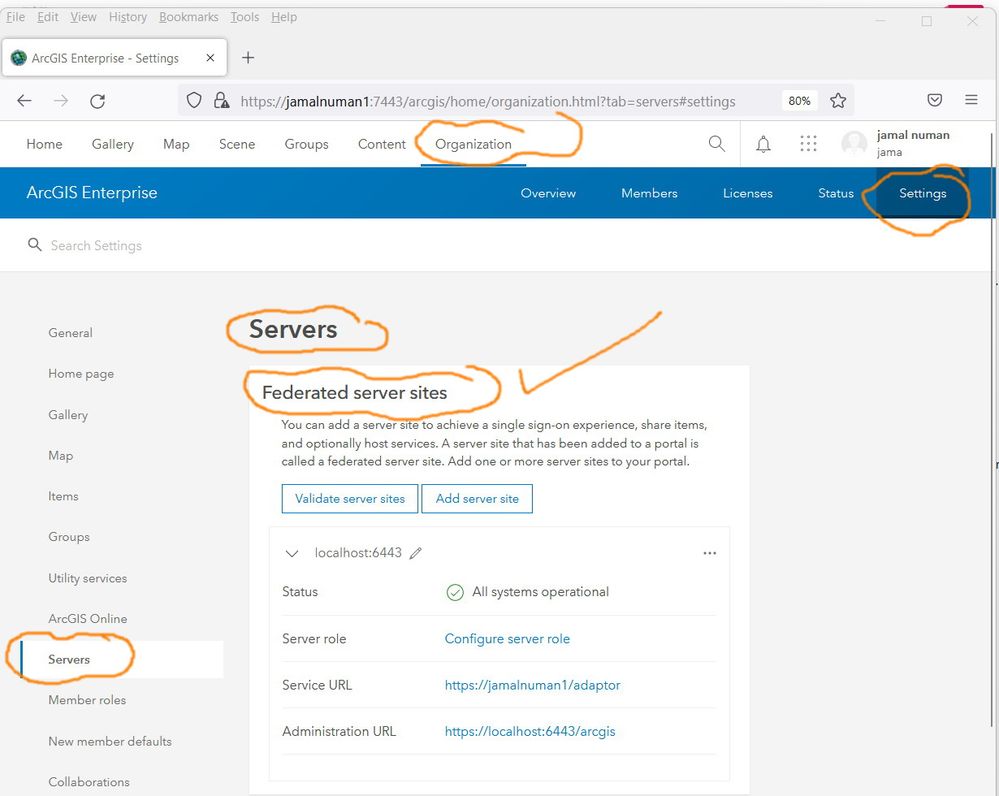

  • The Relational ArcGIS Data Store and Tile Cache ArcGIS Data Store are configured
  • The federated ArcGIS Server is configured
But what do I need to do in order to “set this server as your Hosting server in Portal for ArcGIS”?
How this can be performed?
Jamal Numan

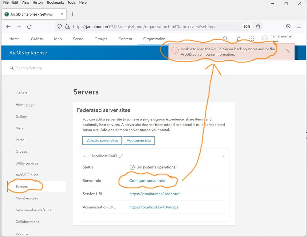

As per the screenshots below, the “configure server role” option ends up with “Unable to load the ArcGIS Server backing stores and/or the ArcGIS Server license information” error

If you have ArcGIS Data Store licenced and configured with ArcGIS Server correctly, it may be communication issues between your Portal and Server. Even if they're on the same machine, you should consider them to be servers trying to communicate with each other. I've noticed you've configured the server as 'localhost'. I also see certificate warnings on your address bar. If you search that error code this is a technical article that comes up:
https://support.esri.com/en/technical-article/000025762
Personally I'd look to revisit how ArcGIS Enterprise was deployed, and try to have the machine names and certificates and trust between enterprise components all configured properly. Doing things like importing certificates into server, portal and data store will save you from a ton of unexpected behaviour.
