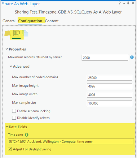

When pulishing to ArcGIS Enterprise via ArcGIS Pro Share as Web Layer, the local time zone and daylight saving option are configured in the sharing wizard.

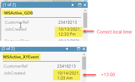

ArcGIS Enterprise doesn't respect the time zone and daylight saving configuration for such dynamic layers. Instead, it treats the value as UTC and convert it to local e.g. adding 13hours for NZ daylight saving time.
However, there is no issue if published from a static feature class from a file gdb. Extactly same data and same publish process.

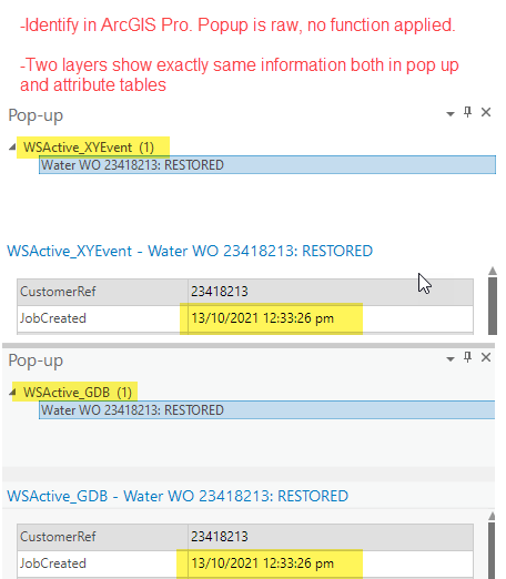

Test: Publish a map with two layers of exactly same data, one from registered feature class and one based on a SQL query table.

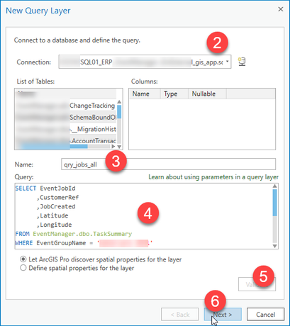

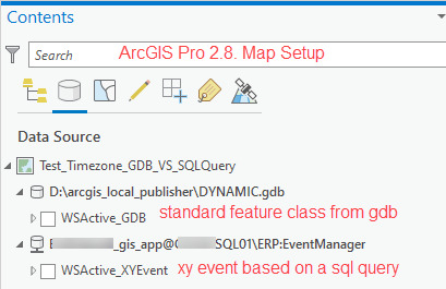

1. Prepare workspace as below. Both layers are registered on the target ArcGIS Server.
2. Check value from local ArcGIS Pro using identify and popup. Same value 13/10/2021, 12:33pm for both layers.

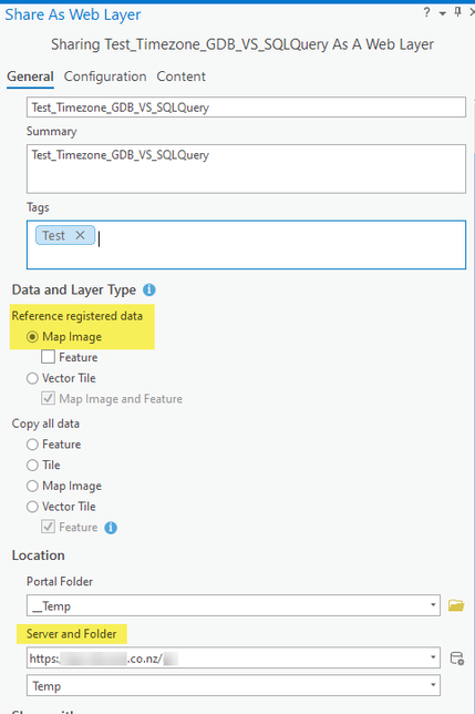

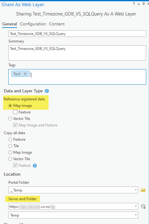

3. Publish as map image layer.

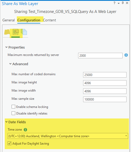

configure timezone and daylight saving
4. Publish to Enterprise is successful. Check on map viewer from Portal.

With timezone and daylight saving configured during publish process, why Enterprise treats feature class layer correctly but not Event layer based on SQL query table?
For the query table and XY event layer, no matter what timezone you choose during the publish stage, NZ+12:00 or UTC or <None> or any other, Enterprise always treats it as UTC and converts it to local time, in my case, +1300.

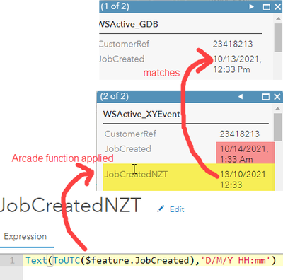

I am aware of a workaround to solve the popup issue by configuring a custom expression like below
However, it doesn't solve the problem of using other widgets e.g. the export csv from attribute table widget, the filter widget etc. Those widgets are all based on the 'converted' datetime.
Ideally, when specifying the timezone and daylight saving options during the publish process, ArcGIS should handle it as suggested.

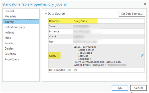

Is this how you created that layer:
  • add a non-spatial table (non-registered to a geodatabase) from an enterprise database to a map.
    • that makes the source of this table a query layer
  • then you used Make XY Event Layer geoprocessing tool to create a xy event layer
cle444
@TanuHoque That's correct. I suspect it is a bug too.
Steps for making the non-spatial query table as per below.
Table added
The last step is to create layer using Make XY Event Layer geoprocesssing tool (NOT add XY point data or XY table to point), just to confirm.
