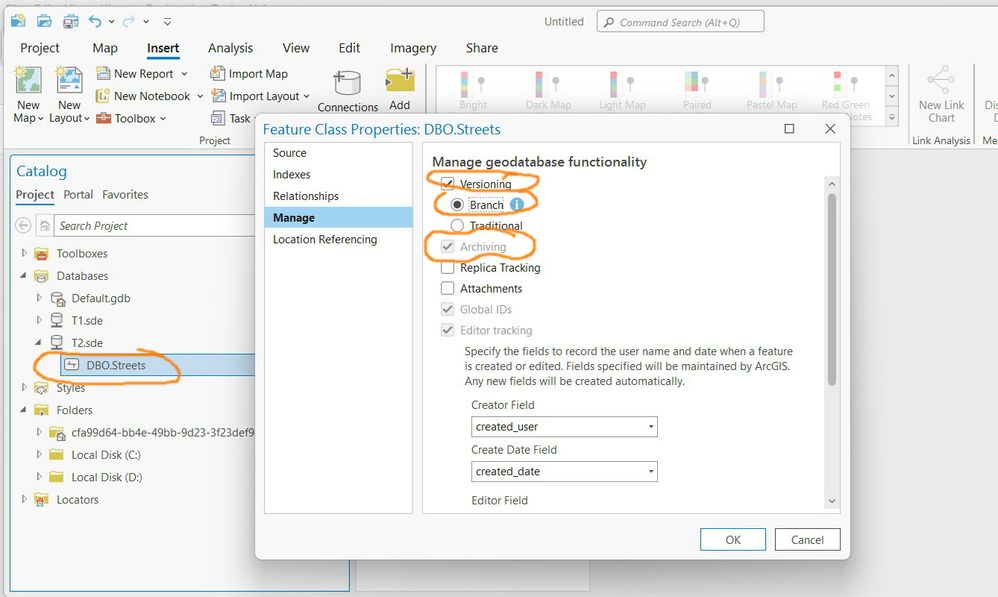

What I meant here is that once the branch option is selected, then the “archiving” option is selected by default.
Is there a way to select the branch option without having the “archiving” option enabled?

I would assume not. Archiving is identified as required for tracking historical edits in the documentation. It's likely a core part of the branched versioning capability. Ratified by it being turned on, in the documentation, and greyed out - they've clearly set it up this way.

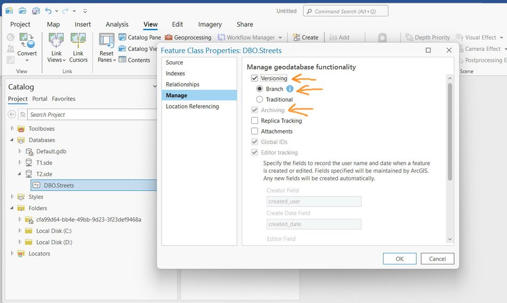

This is exactly my question. Then why it’s mandatory to have the “archiving” and “editor tracking” selected and grayed out by default? Doesn’t that cause the data to get dramatically fat?

As part of registering a dataset as branched versioned, ArcGIS will set up the necessary data structure and functionality to provide the capability. It moves some of the traditional database elements to be managed at a service level.
I can't see any publicly discussed issues tied to branch versioning archiving. I also understand you are not encountering any currently. Esri has indicated that this approach improves performance.
https://www.esri.com/arcgis-blog/products/arcgis-enterprise/data-management/to-branch-or-not-to-bran...
Branch versioning is based on a temporal model which archives edits in a single table that does not need to be compressed, eliminating the performance hits sometimes experienced with traditional versioning. Since branch versioning uses this model, you can now gain all the benefits of archiving without the creation of an additional class. These benefits are realized through a change in design which makes every edit operation an insert behind the scenes allowing a history of your edits (including deletes) to be saved. This provides the ability to perform undo/redo throughout the life of an edit session.
