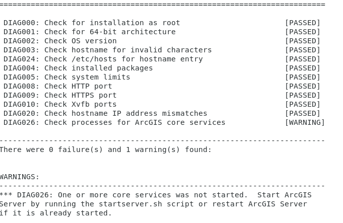

I have tried to use startserver.sh and stopserver.sh to restart but it doesn't work. I run the serverdiag and it shows the following. DIAG026 Warning

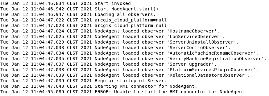

I checked the service-0.log in server/framework/etc/service/logs and it shows the following.
ERROR: Unable to start the RMI connector for NodeAgent
Is there any config that I should do to fix this?
