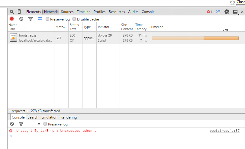

I have just done a clean installed ArcGIS DataStore 10.9.1 on Windows 2016 server. The install went as expected.
A browser launched to go through the configuration wizard (https://localhost:2443/arcgis/datastore/) but came up blank. I looked at the debugger tools and noticed a javascript error on bootstrap.js
Has anybody else come across the type of error before?

For some weird reason the configure url now works

Not sure it's a fix, but I never use localhost when I'm configuring anything in ArcGIS.  I'll replace the localhost with the fully qualified domain name of the host.
Also with your hosting server, have you federated this already?  If so are you configuring the data store with the Primary Site Administrator, and is that still enabled?  if you've federated then could be a reason for token errors.

Scott,
Thanks for the tip. I use to swap localhost for the server name back in 10.3.1 and forgot all about it. Gave that a go and same result. Looks like i'll be putting in a support ticket.
