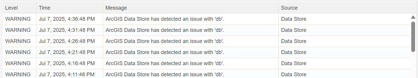

I am using ArcGIS Enterprise 11.3 with ArcGIS Portal, Web Adaptors, Hosting Server, Data Store and another federated ArcGIS Server - each installed on separate virtual machines with Windows Server 2019 OS.
From ArcGIS Hosting Server Manager log, I can see there is a warning that says ArcGIS Data Store has detected an issue with 'db'. This message actually comes from the Data store log that I confirmed when I checked the Data Store log file from within the Data Store machine. Usually it appears after a certain interval. Not the same interval every day. It may appear every 5 minutes or every 9 minutes and sometimes there is a big 3-4 hours gap and then starts appearing.
I raised this issue with local Esri and they could not replicate the issue and could not find the cause of the issue. During the investigation the machine resources were checked like CPU, RAM, Disk Space etc. Nothing found insufficient. I had unique SSL certificates for each machine with the required Subject Alternative Names (SANs) and the machines were trusting each other. Someone else advised to use the same single SSL certificate across all the machines with one common name and the required SANs. I implemented that. Still I get the same warning message.
Is there anything I can do to find the root cause of the message thereby find a solution to fix it?
Following is a screenshot of the error message.

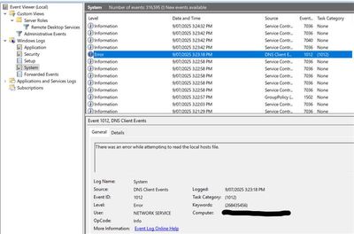

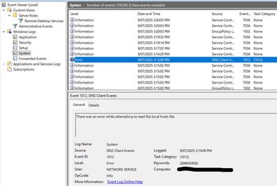

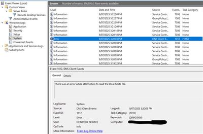

Following are some of the messages from the latest ArcGIS Server log and the messages from the Event Viewer. Times of the errors in the event viewer and ArcGIS logs are not the same though.

I noticed that the "hosts" file is named as "hosts2" in C:\Windows\System32\drivers\etc and it looks like it was modified on 9 May 2025. I have no idea about this file and how it was created and renamed. I never look at this. Our IT may have knowledge about this.

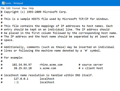

I got the original version of the hosts file. I copied it into the location and since then the event viewer stopped reporting about the file. However, the file is a default one and does not include any of our machine IPs etc. following is a screenshot of the contents of the file.

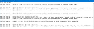

From the log located in "<Disk>:\ arcgisdatastore\logs\MachineName>\database" I see the following message
Screenshot from postgresql log of Data StoreScreenshot from postgresql log of Data Store
For this "could not accept SSL connection: An established connection was aborted by the software in your host machine" message the esri consultant recommended to use a single certificate across all the participating machines with all the SANs and a common name in ArcGIS Enterprise and I did so. But the message still appears.

According to the error you got, the SSLs you use do not seem to be installed to the Trusted Storage on the machines. You can put the SSLs to the Trsuted Storage by double-clicking the used SSLs with the PFX format. After a machine restart, I believe this workflow will prevent both of the error messages from being logged.

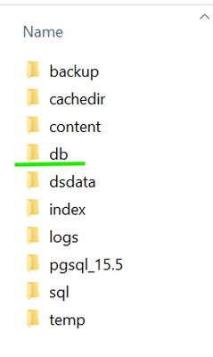

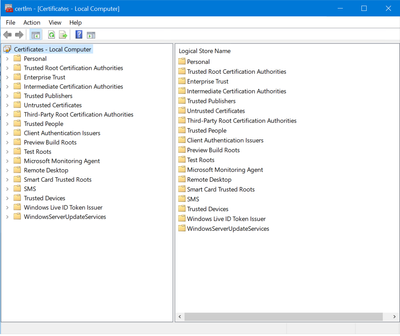

When I look for the "Trusted Storage", I found the folders as shown in the following screenshot. In which folder exactly you want me to install the pfx?
Also, is it only the pfx or you want me to install the full chain, including Root, Intermediate and the pfx?
