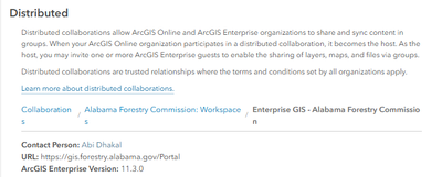

I’m experiencing an issue where my collaboration workspace and feature items are not syncing. I have enabled sync using both the System sync tool from ArcGIS Server Manager and also activated sync for the individual items.
Both my ArcGIS Enterprise Server and ArcGIS Enterprise Portal are running version 11.4.

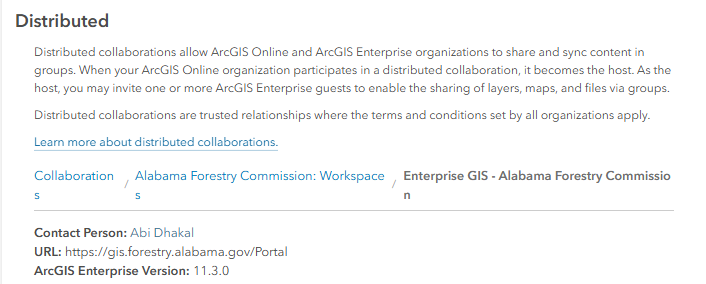

However, I’ve noticed an inconsistency in ArcGIS Online. Under Settings > Collaboration, it shows ArcGIS Enterprise Version 11.3.0, even though it should be showing ArcGIS Enterprise Version 11.4.
Please see the screenshot below for reference.
