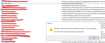

Arc GIS server fails to start on MS Server 2016 Deployment with Error code 1067

I tried 10.5 first and it failed giving the same reason. After that uninstalled that and tried with 10.7 and have same error. Now i tried 10.8.1 and getting same error. It fails to start service and fails to create arc gis server manager in 10.7.1 and 10.8.1. I installed Arc GIS GeoEvent server 10.8 which started successfully.
