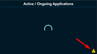

Our team is currently experiencing issue where our apps deployed in ArcGIS Enterprise are not loading properly when accessed by multiple users simultaneously. Some layers in our apps are taking too long to load and eventually throws a data source error and an error 500 when we checked the developer tools. (Please see screenshots below)
We also checked the Portal logs and encountered "The hosting server may not be reachable." message. (Please see screenshot below)
We have not experienced this issue before where multiple users accessed simultaneously. We just encountered this issue since yesterday.

Thank you for the response. We already restarted the DynamicMappingHost service within ArcGIS Server Manager. However, the problem still persists. We are still active in looking for possible solution for this.
