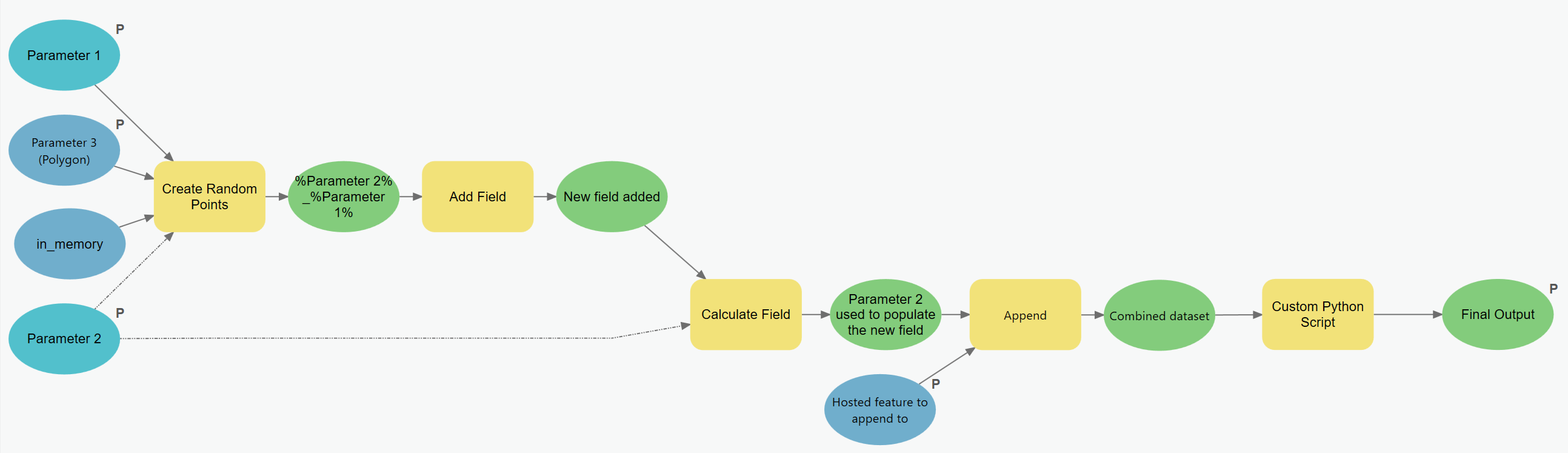

Here is my ModelBuilder workflow:
The basic idea is the user specifies a polygon (Parameter 3) and the number of random points they want created within this (Parameter 1) area. A tool will create the points, then add a new text field, FieldName, to the points that will then store 'Parameter 2' as the value in those fields.
These points, which have been created in memory, are appended to an existing hosted feature. I have a custom Python script at the end that just assigns some ID numbers.
When I add the hosted polygon and point layer to ArcGIS Pro (via URL) and run the model, it works flawlessly and the newly created points are appended to existing points in the hosted feature.

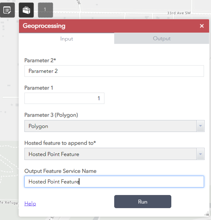

Yes, the tool runs successfully on the REST Endpoint. The issue is that the behavior of the tool in the REST endpoint/ Web AppBuilder environment is not the same as the behavior in ArcGIS Pro.
In the screenshot of the tool in Web App Builder, if I leave 'Output Feature Service Name' blank, then the tool creates a new temporary hosted feature with the appended data instead of appending TO the hosted feature.
If I enter the name of the hosted feature 'Hosted Point Feature' in this space, as shown in the screenshot (in an attempt to overwrite the hosted feature with the appended data), then it gives me the error I mentioned in the original post.
So the tool runs successfully in Pro with the desired behavior, and runs successfully in the Portal/REST environment without error but with different behavior of creating an appended temporary hosted feature as opposed to appending to the original hosted feature.
