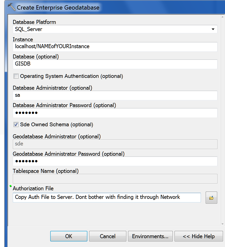

JohnBrockwell
PaulHuffman
Good idea John, but it didn't work.  Thanks.
