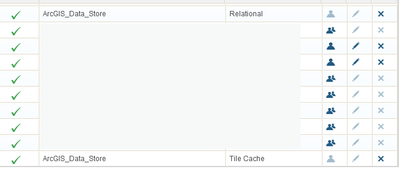

I was curious if your data store validation in the https://<arcgis-server>/<webadaptor>/manager is showing similar to this?

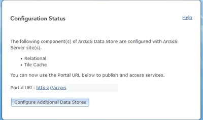

Along with that, can you verify when going on the datastore machine at https://localhost:2443/arcgis/datastore that the correct portal url shows along with the components?
