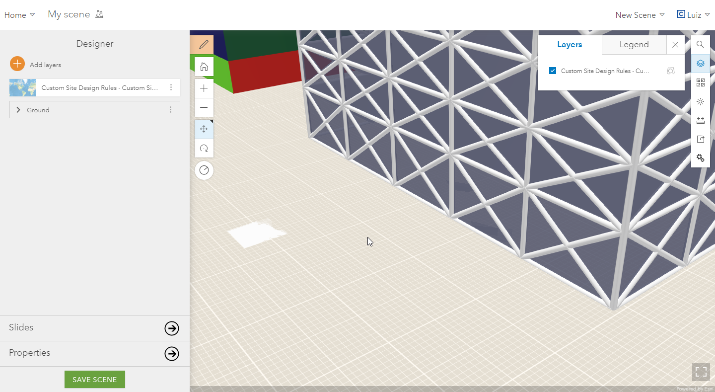

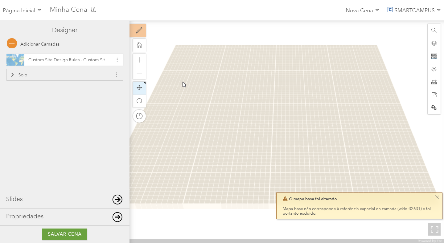

Scene Viewer Portal for ArcGIS
Here the same file on ArcGIS online
AGOL Scene Viewer

Yes it was installed. I can open old projects
