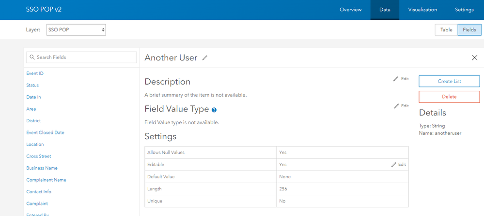

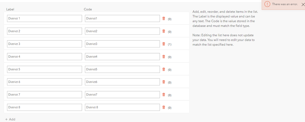

The Create List does not work since our upgrade to 10.9.1. I contacted ESRI and support went thru our logs and index, he indicated everything was good.
I go to item details, data, fields, then try to create list. I get an error.
Is there a step I am forgetting?  Thank you for you help, Annette

Hello, I am sorry I forgot to update and show how I fixed this.  We found if you edit and identify and Field Value Type then the create list works.  Before 10.9.1 we didn't have to do it, but now it appears you must in order for other functions to work.
Annette

Hi @Anonymous User , Yes, I could go into the Fields setting, click "Edit" for Field Value Type, set it to "None", and then I was able to update my List of Values (Domain) . . . thanks for that.
