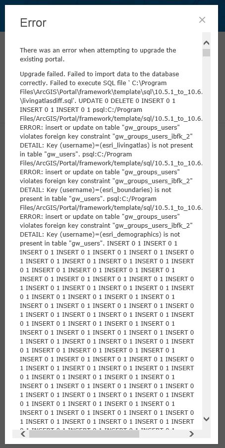

When upgrading my portal from 10.5.1 on a Windows 2008 R2 server, I am getting an error message at the step where I click the Continue Portal Upgrade button on https://machinename.domain.com:7443/arcgis/home/createadmin.html.
There was an error when attempting to upgrade the existing portal.
Upgrade failed. Failed to import data to the database correctly. Failed to execute SQL file ' C:\Program Files\ArcGIS\Portal\framework\template\sql\10.5.1_to_10.6.0\livingatlasdiff.sql'. UPDATE 0 DELETE 0 INSERT 0 1 INSERT 0 1 INSERT 0 1 psql:C:/Program Files/ArcGIS/Portal/framework/template/sql/10.5.1_to_10.6.0/livingatlasdiff.sql:9: ERROR: insert or update on table "gw_groups_users" violates foreign key constraint "gw_groups_users_ibfk_2" DETAIL: Key (username)=(esri_livingatlas) is not present in table "gw_users". psql:
I restarted the Portal service and attempted the installation again, with the same error.
   There was an error when attempting to upgrade the existing portal.  Upgrade failed. Failed to import data to the database correctly. Failed to execute SQL file ' C:\Program Files\ArcGIS\Portal\framework\template\sql\10.5.1_to_10.6.0\livingatlasdiff.sql'. UPDATE 0 DELETE 0 INSERT 0 1 INSERT 0 1 INSERT 0 1 psql:C:/Program Files/ArcGIS/Portal/framework/template/sql/10.5.1_to_10.6.0/livingatlasdiff.sql:9: ERROR: insert or update on table "gw_groups_users" violates foreign key constraint "gw_groups_users_ibfk_2" DETAIL: Key (username)=(esri_livingatlas) is not present in table "gw_users". psql:C:/Program Files/ArcGIS/Portal/framework/template/sql/10.5.1_to_10.6.0/livingatlasdiff.sql:10: ERROR: insert or update on table "gw_groups_users" violates foreign key constraint "gw_groups_users_ibfk_2" DETAIL: Key (username)=(esri_boundaries) is not present in table "gw_users". psql:C:/Program Files/ArcGIS/Portal/framework/template/sql/10.5.1_to_10.6.0/livingatlasdiff.sql:11: ERROR: insert or update on table "gw_groups_users" violates foreign key constraint "gw_groups_users_ibfk_2" DETAIL: Key (username)=(esri_demographics) is not present in table "gw_users". INSERT 0 1 INSERT 0 1 INSERT 0 1 INSERT 0 1 INSERT 0 1 INSERT 0 1 INSERT 0 1 INSERT 0 1 INSERT 0 1 INSERT 0 1 INSERT 0 1 INSERT 0 1 INSERT 0 1 INSERT 0 1 INSERT 0 1 INSERT 0 1 INSERT 0 1 INSERT 0 1 INSERT 0 1 INSERT 0 1 INSERT 0 1 INSERT 0 1 INSERT 0 1 INSERT 0 1 INSERT 0 1 INSERT 0 1 INSERT 0 1 INSERT 0 1 INSERT 0 1 INSERT 0 1 INSERT 0 1 INSERT 0 1 INSERT 0 1 INSERT 0 1 INSERT 0 1 INSERT 0 1 INSERT 0 1 INSERT 0 1 INSERT 0 1 INSERT 0 1 INSERT 0 1 INSERT 0 1 INSERT 0 1 INSERT 0 1 INSERT 0 1 INSERT 0 1 INSERT 0 1 INSERT 0 1 INSERT 0 1 INSERT 0 1 INSERT 0 1 INSERT 0 1 INSERT 0 1 INSERT 0 1 INSERT 0 1 INSERT 0 1 INSERT 0 1 INSERT 0 1 INSERT 0 1 INSERT 0 1 INSERT 0 1 INSERT 0 1 INSERT 0 1 INSERT 0 1 INSERT 0 1 INSERT 0 1 INSERT 0 1 INSERT 0 1 INSERT 0 1 INSERT 0 1 INSERT 0 1 INSERT 0 1 INSERT 0 1 INSERT 0 1 INSERT 0 1 INSERT 0 1 INSERT 0 1 INSERT 0 1 INSERT 0 1 INSERT 0 1 INSERT 0 1 INSERT 0 1 INSERT 0 1 INSERT 0 1 INSERT 0 1 INSERT 0 1 INSERT 0 1 INSERT 0 1 INSERT 0 1 INSERT 0 1 INSERT 0 1 INSERT 0 1 INSERT 0 1 INSERT 0 1 INSERT 0 1 INSERT 0 1 INSERT 0 1 INSERT 0 1 INSERT 0 1 INSERT 0 1 INSERT 0 1 INSERT 0 1 INSERT 0 1 INSERT 0 1 INSERT 0 1 INSERT 0 1 INSERT 0 1 INSERT 0 1 INSERT 0 1 INSERT 0 1 INSERT 0 1 INSERT 0 1 INSERT 0 1 INSERT 0 1 INSERT 0 1 INSERT 0 1 INSERT 0 1 INSERT 0 1 INSERT 0 1 INSERT 0 1 INSERT 0 1 INSERT 0 1 INSERT 0 1 INSERT 0 1 INSERT 0 1 INSERT 0 1 INSERT 0 1 INSERT 0 1 INSERT 0 1 INSERT 0 1 INSERT 0 1 INSERT 0 1 INSERT 0 1 INSERT 0 1 INSERT 0 1 INSERT 0 1 INSERT 0 1 INSERT 0 1 INSERT 0 1 INSERT 0 1 INSERT 0 1 INSERT 0 1 INSERT 0 1 INSERT 0 1 INSERT 0 1 INSERT 0 1 INSERT 0 1 INSERT 0 1 INSERT 0 1 INSERT 0 1 INSERT 0 1 INSERT 0 1 INSERT 0 1 INSERT 0 1 INSERT 0 1 INSERT 0 1 INSERT 0 1 INSERT 0 1 INSERT 0 1 INSERT 0 1 INSERT 0 1 INSERT 0 1 INSERT 0 1 INSERT 0 1 INSERT 0 1 INSERT 0 1 INSERT 0 1 INSERT 0 1 INSERT 0 1 INSERT 0 1 INSERT 0 1 INSERT 0 1 INSERT 0 1 INSERT 0 1 INSERT 0 1 INSERT 0 1 INSERT 0 1 INSERT 0 1 INSERT 0 1 INSERT 0 1 INSERT 0 1 INSERT 0 1 INSERT 0 1 INSERT 0 1 INSERT 0 1 INSERT 0 1 INSERT 0 1 INSERT 0 1 INSERT 0 1 INSERT 0 1 INSERT 0 1 INSERT 0 1 INSERT 0 1 INSERT 0 1 INSERT 0 1 INSERT 0 1 INSERT 0 1 INSERT 0 1 INSERT 0 1 INSERT 0 1 INSERT 0 1 INSERT 0 1 INSERT 0 1 INSERT 0 1 INSERT 0 1 INSERT 0 1 INSERT 0 1 INSERT 0 1 INSERT 0 1 INSERT 0 1 INSERT 0 1 INSERT 0 1 INSERT 0 1 INSERT 0 1 INSERT 0 1 INSERT 0 1 INSERT 0 1 INSERT 0 1 INSERT 0 1 INSERT 0 1 INSERT 0 1 INSERT 0 1 INSERT 0 1 INSERT 0 1 INSERT 0 1 INSERT 0 1 INSERT 0 1 INSERT 0 1 INSERT 0 1 INSERT 0 1 INSERT 0 1 INSERT 0 1 INSERT 0 1 INSERT 0 1 INSERT 0 1 INSERT 0 1 INSERT 0 1 INSERT 0 1 INSERT 0 1 INSERT 0 1 INSERT 0 1 INSERT 0 1 INSERT 0 1 INSERT 0 1 INSERT 0 1 INSERT 0 1 INSERT 0 1 INSERT 0 1 INSERT 0 1 INSERT 0 1 INSERT 0 1 INSERT 0 1 INSERT 0 1 INSERT 0 1 INSERT 0 1 INSERT 0 1 INSERT 0 1 INSERT 0 1 INSERT 0 1 INSERT 0 1 INSERT 0 1 INSERT 0 1 INSERT 0 1 INSERT 0 1 INSERT 0 1 INSERT 0 1 INSERT 0 1 INSERT 0 1 INSERT 0 1 INSERT 0 1 INSERT 0 1 INSERT 0 1 INSERT 0 1 INSERT 0 1 INSERT 0 1 INSERT 0 1 INSERT 0 1 INSERT 0 1 INSERT 0 1 INSERT 0 1 INSERT 0 1 INSERT 0 1 INSERT 0 1 INSERT 0 1 INSERT 0 1 INSERT 0 1 INSERT 0 1 INSERT 0 1 INSERT 0 1 INSERT 0 1 INSERT 0 1 INSERT 0 1 INSERT 0 1 INSERT 0 1 INSERT 0 1 INSERT 0 1 INSERT 0 1 INSERT 0 1 INSERT 0 1 INSERT 0 1 INSERT 0 1 INSERT 0 1 INSERT 0 1 INSERT 0 1 INSERT 0 1 INSERT 0 1 INSERT 0 1 INSERT 0 1 INSERT 0 1 INSERT 0 1 INSERT 0 1 INSERT 0 1 INSERT 0 1 INSERT 0 1 INSERT 0 1 INSERT 0 1 INSERT 0 1 INSERT 0 1 INSERT 0 1 INSERT 0 1 INSERT 0 1 INSERT 0 1 INSERT 0 1 INSERT 0 1 INSERT 0 1 INSERT 0 1 INSERT 0 1 INSERT 0 1 INSERT 0 1 INSERT 0 1 INSERT 0 1 INSERT 0 1 INSERT 0 1 INSERT 0 1 INSERT 0 1 INSERT 0 1 INSERT 0 1 INSERT 0 1 INSERT 0 1 INSERT 0 1 INSERT 0 1 INSERT 0 1 INSERT 0 1 INSERT 0 1 INSERT 0 1 INSERT 0 1 INSERT 0 1 INSERT 0 1 INSERT 0 1 INSERT 0 1 INSERT 0 1 INSERT 0 1 INSERT 0 1 INSERT 0 1 INSERT 0 1 INSERT 0 1 INSERT 0 1 INSERT 0 1 INSERT 0 1 INSERT 0 1 INSERT 0 1 INSERT 0 1 INSERT 0 1 INSERT 0 1 INSERT 0 1 INSERT 0 1 INSERT 0 1 INSERT 0 1 INSERT 0 1 INSERT 0 1 INSERT 0 1 INSERT 0 1 INSERT 0 1 INSERT 0 1 INSERT 0 1 INSERT 0 1 INSERT 0 1 INSERT 0 1 INSERT 0 1 INSERT 0 1 INSERT 0 1 INSERT 0 1 INSERT 0 1 INSERT 0 1 INSERT 0 1 INSERT 0 1 INSERT 0 1 INSERT 0 1 INSERT 0 1 INSERT 0 1 INSERT 0 1 INSERT 0 1 INSERT 0 1 INSERT 0 1 INSERT 0 1 INSERT 0 1 INSERT 0 1 INSERT 0 1 INSERT 0 1 INSERT 0 1 INSERT 0 1 INSERT 0 1 INSERT 0 1 INSERT 0 1 INSERT 0 1 INSERT 0 1 INSERT 0 1 INSERT 0 1 INSERT 0 1 INSERT 0 1 INSERT 0 1 INSERT 0 1 INSERT 0 1 INSERT 0 1 INSERT 0 1 INSERT 0 1 INSERT 0 1 INSERT 0 1 INSERT 0 1 INSERT 0 1 INSERT 0 1 INSERT 0 1 INSERT 0 1 INSERT 0 1 INSERT 0 1 INSERT 0 1 INSERT 0 1 INSERT 0 1 INSERT 0 1 INSERT 0 1 INSERT 0 1 INSERT 0 1 INSERT 0 1 INSERT 0 1 INSERT 0 1 INSERT 0 1 INSERT 0 1 INSERT 0 1 INSERT 0 1 INSERT 0 1 INSERT 0 1 INSERT 0 1 INSERT 0 1 INSERT 0 1 INSERT 0 1 INSERT 0 1 INSERT 0 1 INSERT 0 1 INSERT 0 1 INSERT 0 1 INSERT 0 1 INSERT 0 1 INSERT 0 1 INSERT 0 1 INSERT 0 1 INSERT 0 1 INSERT 0 1 INSERT 0 1 INSERT 0 1 INSERT 0 1 INSERT 0 1 INSERT 0 1 INSERT 0 1 INSERT 0 1 INSERT 0 1 INSERT 0 1 INSERT 0 1 INSERT 0 1 INSERT 0 1 INSERT 0 1 INSERT 0 1 INSERT 0 1 INSERT 0 1 INSERT 0 1 INSERT 0 1 INSERT 0 1 INSERT 0 1 INSERT 0 1 INSERT 0 1 INSERT 0 1 INSERT 0 1 INSERT 0 1 INSERT 0 1 INSERT 0 1 INSERT 0 1 INSERT 0 1 INSERT 0 1 INSERT 0 1 INSERT 0 1 INSERT 0 1 INSERT 0 1 INSERT 0 1 INSERT 0 1 INSERT 0 1 INSERT 0 1 INSERT 0 1 INSERT 0 1 INSERT 0 1 INSERT 0 1 INSERT 0 1 INSERT 0 1 INSERT 0 1 INSERT 0 1 INSERT 0 1 INSERT 0 1 INSERT 0 1 INSERT 0 1 INSERT 0 1 INSERT 0 1 INSERT 0 1 INSERT 0 1 INSERT 0 1 INSERT 0 1 INSERT 0 1 INSERT 0 1 INSERT 0 1 INSERT 0 1 INSERT 0 1 INSERT 0 1 INSERT 0 1 INSERT 0 1 INSERT 0 1 INSERT 0 1 INSERT 0 1 INSERT 0 1 INSERT 0 1 INSERT 0 1 INSERT 0 1 INSERT 0 1 INSERT 0 1 INSERT 0 1 INSERT 0 1 INSERT 0 1 INSERT 0 1 INSERT 0 1 INSERT 0 1 INSERT 0 1 INSERT 0 1 INSERT 0 1 INSERT 0 1 INSERT 0 1 INSERT 0 1 INSERT 0 1 INSERT 0 1 INSERT 0 1 INSERT 0 1 INSERT 0 1 INSERT 0 1 INSERT 0 1 INSERT 0 1 INSERT 0 1 INSERT 0 1 INSERT 0 1 INSERT 0 1 INSERT 0 1 INSERT 0 1 INSERT 0 1 INSERT 0 1 INSERT 0 1 INSERT 0 1 INSERT 0 1 INSERT 0 1 INSERT 0 1 INSERT 0 1 INSERT 0 1 INSERT 0 1 INSERT 0 1 INSERT 0 1 INSERT 0 1 INSERT 0 1 INSERT 0 1 INSERT 0 1 INSERT 0 1 INSERT 0 1 INSERT 0 1 INSERT 0 1 INSERT 0 1 INSERT 0 1 INSERT 0 1 INSERT 0 1 INSERT 0 1 INSERT 0 1 INSERT 0 1 INSERT 0 1 INSERT 0 1 INSERT 0 1 INSERT 0 1 INSERT 0 1 INSERT 0 1 INSERT 0 1 INSERT 0 1 INSERT 0 1 INSERT 0 1 INSERT 0 1 INSERT 0 1 INSERT 0 1 INSERT 0 1 INSERT 0 1 INSERT 0 1 INSERT 0 1 INSERT 0 1 INSERT 0 1 INSERT 0 1 INSERT 0 1 UPDATE 0 UPDATE 0 UPDATE 0 UPDATE 0 UPDATE 0 UPDATE 0 UPDATE 0 UPDATE 0 UPDATE 0 UPDATE 0 UPDATE 0 UPDATE 0 UPDATE 0 UPDATE 0 UPDATE 0 UPDATE 0 UPDATE 0 UPDATE 0 UPDATE 0 UPDATE 0 UPDATE 0 UPDATE 0 UPDATE 0 UPDATE 0 UPDATE 0 UPDATE 0 UPDATE 0 UPDATE 0 UPDATE 0 UPDATE 0 UPDATE 0 UPDATE 0 UPDATE 0 UPDATE 0 UPDATE 0 UPDATE 0 UPDATE 0 UPDATE 0 UPDATE 0 UPDATE 0 UPDATE 0 UPDATE 0 UPDATE 0 UPDATE 0 UPDATE 0 UPDATE 0 UPDATE 0 UPDATE 0 UPDATE 0 UPDATE 0 UPDATE 0 UPDATE 0 UPDATE 0 UPDATE 0 UPDATE 0 UPDATE 0 UPDATE 0 UPDATE 0 UPDATE 0 UPDATE 0 UPDATE 0 UPDATE 0 UPDATE 0 UPDATE 0 UPDATE 0 UPDATE 0 UPDATE 0 UPDATE 0 UPDATE 0 UPDATE 0 UPDATE 0 UPDATE 0 UPDATE 0 UPDATE 0 UPDATE 0 UPDATE 0 UPDATE 0 UPDATE 0 UPDATE 0 UPDATE 0 UPDATE 0 UPDATE 0 UPDATE 0 UPDATE 0 UPDATE 0 UPDATE 0 UPDATE 0 UPDATE 0 UPDATE 0 UPDATE 0 UPDATE 0 UPDATE 0 UPDATE 0 UPDATE 0 UPDATE 0 UPDATE 0 UPDATE 0 UPDATE 0 UPDATE 0 UPDATE 0 UPDATE 0 UPDATE 0 UPDATE 0 UPDATE 0 UPDATE 0 UPDATE 0 UPDATE 0 UPDATE 0 UPDATE 0 UPDATE 0 UPDATE 0 UPDATE 0 UPDATE 0 UPDATE 0 UPDATE 0 UPDATE 0 UPDATE 0 UPDATE 0 UPDATE 0 UPDATE 0 UPDATE 0 UPDATE 0 UPDATE 0 UPDATE 0 UPDATE 0 UPDATE 0 UPDATE 0 UPDATE 0 UPDATE 0 UPDATE 0 UPDATE 0 UPDATE 0 UPDATE 0 UPDATE 0 UPDATE 0 UPDATE 0 UPDATE 0 UPDATE 0 UPDATE 0 UPDATE 0 UPDATE 0 UPDATE 0 UPDATE 0 UPDATE 0 UPDATE 0 UPDATE 0 UPDATE 0 UPDATE 0 UPDATE 0 UPDATE 0 UPDATE 0 UPDATE 0 UPDATE 0 UPDATE 0 UPDATE 0 UPDATE 0 UPDATE 0 UPDATE 0 UPDATE 0 UPDATE 0 UPDATE 0 UPDATE 0 UPDATE 0 UPDATE 0 UPDATE 0 UPDATE 0 UPDATE 0 UPDATE 0 UPDATE 0 UPDATE 0 UPDATE 0 UPDATE 0 UPDATE 0 UPDATE 0 UPDATE 0 UPDATE 0 UPDATE 0 UPDATE 0 UPDATE 0 UPDATE 0 UPDATE 0 UPDATE 0 UPDATE 0 UPDATE 0 UPDATE 0 UPDATE 0 UPDATE 0 UPDATE 0 UPDATE 0 UPDATE 0 UPDATE 0 UPDATE 0 UPDATE 0 UPDATE 0 UPDATE 0 UPDATE 0 UPDATE 0 UPDATE 0 UPDATE 0 UPDATE 0 UPDATE 0 UPDATE 0 UPDATE 0 UPDATE 0 UPDATE 0 UPDATE 0 UPDATE 0 UPDATE 0 UPDATE 0 UPDATE 0 UPDATE 0 UPDATE 0 UPDATE 0 UPDATE 0 UPDATE 0 UPDATE 0 UPDATE 0 UPDATE 0 UPDATE 0 UPDATE 0 UPDATE 0 UPDATE 0 UPDATE 0 UPDATE 0 UPDATE 0 UPDATE 0 UPDATE 0 UPDATE 0 UPDATE 0 UPDATE 0 UPDATE 0 UPDATE 0 UPDATE 0 UPDATE 0 UPDATE 0 UPDATE 0 UPDATE 0 UPDATE 0 UPDATE 0 UPDATE 0 UPDATE 0 UPDATE 0 UPDATE 0 UPDATE 0 UPDATE 0 UPDATE 0 UPDATE 0 UPDATE 0 UPDATE 0 UPDATE 0 UPDATE 0 UPDATE 0 UPDATE 0 UPDATE 0 UPDATE 0 UPDATE 0 UPDATE 0 UPDATE 0 UPDATE 0 UPDATE 0 UPDATE 0 UPDATE 0 UPDATE 0 UPDATE 0 UPDATE 0 UPDATE 0 UPDATE 0 UPDATE 0 UPDATE 0 UPDATE 0 UPDATE 0 UPDATE 0 UPDATE 0 UPDATE 0 UPDATE 0 UPDATE 0 UPDATE 0 UPDATE 0 UPDATE 0 UPDATE 0 UPDATE 0 UPDATE 0 UPDATE 0 UPDATE 0 UPDATE 0 UPDATE 0 UPDATE 0 UPDATE 0 UPDATE 0 UPDATE 0 UPDATE 0 UPDATE 0 UPDATE 0 UPDATE 0 UPDATE 0 UPDATE 0 UPDATE 0 UPDATE 0 UPDATE 0 UPDATE 0 UPDATE 0 UPDATE 0 UPDATE 0 UPDATE 0 UPDATE 0 UPDATE 0 UPDATE 0 UPDATE 0 UPDATE 0 UPDATE 0 UPDATE 0 UPDATE 0 UPDATE 0 UPDATE 0 UPDATE 0 UPDATE 0 UPDATE 0 UPDATE 0 UPDATE 0 UPDATE 0 UPDATE 0 UPDATE 0 UPDATE 0 UPDATE 0 UPDATE 0 UPDATE 0 UPDATE 0 UPDATE 0 UPDATE 0 UPDATE 0 UPDATE 0 UPDATE 0 UPDATE 0 UPDATE 0 UPDATE 0 UPDATE 0 UPDATE 0 UPDATE 0 UPDATE 0 UPDATE 0 UPDATE 0 UPDATE 0 UPDATE 0 UPDATE 0 UPDATE 0 UPDATE 0 UPDATE 0 UPDATE 0 UPDATE 0 UPDATE 0 UPDATE 0 UPDATE 0 UPDATE 0 UPDATE 0 UPDATE 0 UPDATE 0 UPDATE 0 UPDATE 0 UPDATE 0 UPDATE 0 UPDATE 0 UPDATE 0 UPDATE 0 UPDATE 0 UPDATE 0 UPDATE 0 UPDATE 0 UPDATE 0 UPDATE 0 UPDATE 0 UPDATE 0 UPDATE 0 UPDATE 0 UPDATE 0 UPDATE 0 UPDATE 0 UPDATE 0 UPDATE 0 UPDATE 0 UPDATE 0 UPDATE 0 UPDATE 0 UPDATE 0 UPDATE 0 UPDATE 0 UPDATE 0 UPDATE 0 UPDATE 0 UPDATE 0 UPDATE 0 UPDATE 0 UPDATE 0 UPDATE 0 UPDATE 0 UPDATE 0 UPDATE 0 UPDATE 0 UPDATE 0 UPDATE 0 UPDATE 0 UPDATE 0 UPDATE 0 UPDATE 0 UPDATE 0 UPDATE 0 UPDATE 0 UPDATE 0 UPDATE 0 UPDATE 0 UPDATE 0 UPDATE 0 UPDATE 0 UPDATE 0 UPDATE 0 UPDATE 0 UPDATE 0 UPDATE 0 UPDATE 0 UPDATE 0 UPDATE 0 UPDATE 0 UPDATE 0 UPDATE 0 UPDATE 0 UPDATE 0 UPDATE 0 UPDATE 0 UPDATE 0 UPDATE 0 UPDATE 0 UPDATE 0 UPDATE 0 UPDATE 0 UPDATE 0 UPDATE 0 UPDATE 0 UPDATE 0 UPDATE 0 UPDATE 0 UPDATE 0 UPDATE 0 UPDATE 0 UPDATE 0 UPDATE 0 UPDATE 0 UPDATE 0 UPDATE 0 UPDATE 0 UPDATE 0 UPDATE 0 UPDATE 0 UPDATE 0 UPDATE 0 UPDATE 0 UPDATE 0 UPDATE 0 UPDATE 0 UPDATE 0 UPDATE 0 UPDATE 0 UPDATE 0 UPDATE 0 UPDATE 0 UPDATE 0 UPDATE 0 UPDATE 0 UPDATE 0 UPDATE 0 UPDATE 0 UPDATE 0 UPDATE 0 UPDATE 0 UPDATE 0 UPDATE 0 UPDATE 0 UPDATE 0 UPDATE 0 UPDATE 0 UPDATE 0 UPDATE 0 UPDATE 0 UPDATE 0 UPDATE 0 UPDATE 0 UPDATE 0 UPDATE 0 UPDATE 0 UPDATE 0 UPDATE 0 UPDATE 0 UPDATE 0 UPDATE 0 UPDATE 0 UPDATE 0 UPDATE 0 UPDATE 0 UPDATE 0 UPDATE 0 UPDATE 0 UPDATE 0 UPDATE 0 UPDATE 0 UPDATE 0 UPDATE 0 UPDATE 0 UPDATE 0 UPDATE 0 UPDATE 0 UPDATE 0 UPDATE 0 UPDATE 0 UPDATE 0 UPDATE 0 UPDATE 0 UPDATE 0 UPDATE 0 UPDATE 0 UPDATE 0 UPDATE 0 UPDATE 0 UPDATE 0 UPDATE 0 UPDATE 0 UPDATE 0 UPDATE 0 UPDATE 0 UPDATE 0 UPDATE 0 UPDATE 0 UPDATE 0 UPDATE 0 UPDATE 0 UPDATE 0 UPDATE 0 UPDATE 0 UPDATE 0 UPDATE 0 UPDATE 0 UPDATE 0 UPDATE 0 UPDATE 0 UPDATE 0 UPDATE 0 UPDATE 0 UPDATE 0 UPDATE 0 UPDATE 0 UPDATE 0 UPDATE 0 UPDATE 0 UPDATE 0 UPDATE 0 UPDATE 0 UPDATE 0 UPDATE 0 UPDATE 0 UPDATE 0 UPDATE 0 UPDATE 0 UPDATE 0 UPDATE 0 UPDATE 0 UPDATE 0 UPDATE 0 UPDATE 0 UPDATE 0 UPDATE 0 UPDATE 0 UPDATE 0 UPDATE 0 UPDATE 0 UPDATE 0 UPDATE 0 UPDATE 0 UPDATE 0 UPDATE 0 UPDATE 0 UPDATE 0 UPDATE 0 UPDATE 0 UPDATE 0 UPDATE 0 UPDATE 0 UPDATE 0 UPDATE 0 UPDATE 0 UPDATE 0 UPDATE 0 UPDATE 0 UPDATE 0 UPDATE 0 UPDATE 0 UPDATE 0 UPDATE 0 UPDATE 0 UPDATE 0 UPDATE 0 UPDATE 0 UPDATE 0 UPDATE 0 UPDATE 0 UPDATE 0 UPDATE 0 UPDATE 0 UPDATE 0 UPDATE 0 UPDATE 0 UPDATE 0 UPDATE 0 UPDATE 0 UPDATE 0 UPDATE 0 UPDATE 0 UPDATE 0 UPDATE 0 UPDATE 0 UPDATE 0 UPDATE 0 UPDATE 0 UPDATE 0 UPDATE 0 UPDATE 0 UPDATE 0 UPDATE 0 UPDATE 0 UPDATE 0 UPDATE 0 UPDATE 0 UPDATE 0 UPDATE 0 UPDATE 0 UPDATE 0 UPDATE 0 UPDATE 0 UPDATE 0 UPDATE 0 UPDATE 0 UPDATE 0 UPDATE 0 UPDATE 0 UPDATE 0 UPDATE 0 UPDATE 0 UPDATE 0 UPDATE 0 UPDATE 0 UPDATE 0 UPDATE 0 UPDATE 0 UPDATE 0 UPDATE 0 UPDATE 0 UPDATE 0 UPDATE 0 UPDATE 0 UPDATE 0 UPDATE 0 UPDATE 0 UPDATE 0 UPDATE 0 UPDATE 0 UPDATE 0 UPDATE 0 UPDATE 0 UPDATE 0 UPDATE 0 UPDATE 0 UPDATE 0 UPDATE 0 UPDATE 0 UPDATE 0 UPDATE 0 UPDATE 0 UPDATE 0 UPDATE 0 UPDATE 0 UPDATE 0 UPDATE 0 UPDATE 0 UPDATE 0 UPDATE 0 UPDATE 0 UPDATE 0 UPDATE 0 UPDATE 0 UPDATE 0 UPDATE 0 UPDATE 0 UPDATE 0 UPDATE 0 UPDATE 0 UPDATE 0 UPDATE 0 UPDATE 0 UPDATE 0 UPDATE 0 UPDATE 0 UPDATE 0 UPDATE 0 UPDATE 0 UPDATE 0 UPDATE 0 UPDATE 0 UPDATE 0 UPDATE 0 UPDATE 0 UPDATE 0 UPDATE 0 UPDATE 0 UPDATE 0 UPDATE 0 UPDATE 0 UPDATE 0 UPDATE 0 UPDATE 0 UPDATE 0 UPDATE 0 UPDATE 0 UPDATE 0 UPDATE 0 UPDATE 0 UPDATE 0 UPDATE 0 UPDATE 0 UPDATE 0 UPDATE 0 UPDATE 0 UPDATE 0 UPDATE 0 UPDATE 0 UPDATE 0 UPDATE 0 UPDATE 0 UPDATE 0 UPDATE 0 UPDATE 0 UPDATE 0 UPDATE 0 UPDATE 0 UPDATE 0 UPDATE 0 UPDATE 0 UPDATE 0 UPDATE 0 UPDATE 0 UPDATE 0 UPDATE 0 UPDATE 0 UPDATE 0 UPDATE 0 UPDATE 0 UPDATE 0 UPDATE 0 UPDATE 0 UPDATE 0 UPDATE 0 UPDATE 0 UPDATE 0 UPDATE 0 UPDATE 0 UPDATE 0 UPDATE 0 UPDATE 0 UPDATE 0 UPDATE 0 UPDATE 0 UPDATE 0 UPDATE 0 UPDATE 0 UPDATE 0 UPDATE 0 UPDATE 0 UPDATE 0 UPDATE 0 UPDATE 0 UPDATE 0 UPDATE 0 UPDATE 0 UPDATE 0 UPDATE 0 UPDATE 0 UPDATE 0 UPDATE 0 UPDATE 0 UPDATE 0 UPDATE 0 UPDATE 0 UPDATE 0 UPDATE 0 UPDATE 0 UPDATE 0 UPDATE 0 UPDATE 0 UPDATE 0 UPDATE 0 UPDATE 0 UPDATE 0 UPDATE 0 UPDATE 0 UPDATE 0 UPDATE 0 UPDATE 0 UPDATE 0 UPDATE 0 UPDATE 0 UPDATE 0 UPDATE 0 UPDATE 0 UPDATE 0 UPDATE 0 UPDATE 0 UPDATE 0 UPDATE 0 UPDATE 0 UPDATE 0 UPDATE 0 UPDATE 0 UPDATE 0 UPDATE 0 UPDATE 0 UPDATE 0 UPDATE 0 UPDATE 0 UPDATE 0 UPDATE 0 UPDATE 0 UPDATE 0 UPDATE 0 UPDATE 0 UPDATE 0 UPDATE 0 UPDATE 0 UPDATE 0 INSERT 0 1 INSERT 0 1 INSERT 0 1 INSERT 0 1 INSERT 0 1 INSERT 0 1 INSERT 0 1 INSERT 0 1 INSERT 0 1 INSERT 0 1 INSERT 0 1 INSERT 0 1 INSERT 0 1 INSERT 0 1 INSERT 0 1 INSERT 0 1 INSERT 0 1 INSERT 0 1 INSERT 0 1 INSERT 0 1 INSERT 0 1 INSERT 0 1 INSERT 0 1 INSERT 0 1 INSERT 0 1 INSERT 0 1 INSERT 0 1 INSERT 0 1 INSERT 0 1 INSERT 0 1 INSERT 0 1 INSERT 0 1 INSERT 0 1 INSERT 0 1 INSERT 0 1 INSERT 0 1 INSERT 0 1 INSERT 0 1 INSERT 0 1 INSERT 0 1 INSERT 0 1 INSERT 0 1 INSERT 0 1 INSERT 0 1 INSERT 0 1 INSERT 0 1 INSERT 0 1 INSERT 0 1 INSERT 0 1 INSERT 0 1 INSERT 0 1 INSERT 0 1 INSERT 0 1 INSERT 0 1 INSERT 0 1 INSERT 0 1 INSERT 0 1 INSERT 0 1 INSERT 0 1 INSERT 0 1 INSERT 0 1 INSERT 0 1 INSERT 0 1 INSERT 0 1 INSERT 0 1 INSERT 0 1 INSERT 0 1 INSERT 0 1 INSERT 0 1 INSERT 0 1 INSERT 0 1 INSERT 0 1 INSERT 0 1 INSERT 0 1 INSERT 0 1 INSERT 0 1 INSERT 0 1 INSERT 0 1 INSERT 0 1 INSERT 0 1 INSERT 0 1 INSERT 0 1 INSERT 0 1 INSERT 0 1 INSERT 0 1 INSERT 0 1 INSERT 0 1 INSERT 0 1 INSERT 0 1 INSERT 0 1 INSERT 0 1 INSERT 0 1 INSERT 0 1 INSERT 0 1 INSERT 0 1 INSERT 0 1 INSERT 0 1 INSERT 0 1 INSERT 0 1 INSERT 0 1 INSERT 0 1 INSERT 0 1 INSERT 0 1 INSERT 0 1 INSERT 0 1 INSERT 0 1 INSERT 0 1 INSERT 0 1 INSERT 0 1 INSERT 0 1 INSERT 0 1 INSERT 0 1 INSERT 0 1 INSERT 0 1 INSERT 0 1 INSERT 0 1 INSERT 0 1 INSERT 0 1 INSERT 0 1 INSERT 0 1 INSERT 0 1 INSERT 0 1 INSERT 0 1 INSERT 0 1 INSERT 0 1 INSERT 0 1 INSERT 0 1 INSERT 0 1 INSERT 0 1 INSERT 0 1 INSERT 0 1 INSERT 0 1 UPDATE 0 UPDATE 0 UPDATE 0 UPDATE 0 UPDATE 0 UPDATE 0 UPDATE 0 UPDATE 0 UPDATE 0 UPDATE 0 UPDATE 0 UPDATE 0 UPDATE 0 UPDATE 0 UPDATE 0 UPDATE 0 UPDATE 0 UPDATE 0 UPDATE 0 UPDATE 0 UPDATE 0 UPDATE 0 UPDATE 0 UPDATE 0 UPDATE 0 UPDATE 0 UPDATE 0 UPDATE 0 UPDATE 0 UPDATE 0 UPDATE 0 UPDATE 0 UPDATE 0 UPDATE 0 UPDATE 0 UPDATE 0 UPDATE 0 UPDATE 0 UPDATE 0 UPDATE 0 UPDATE 0 UPDATE 0 UPDATE 0 UPDATE 0 UPDATE 0 UPDATE 0 UPDATE 0 psql:C:/Program Files/ArcGIS/Portal/framework/template/sql/10.5.1_to_10.6.0/livingatlasdiff.sql:1629: ERROR: insert or update on table "gw_items_groups" violates foreign key constraint "gw_items_groups_ibfk_2" DETAIL: Key (group_id)=(6646cd89ff1849afa1b95ed670a298b8) is not present in table "gw_groups". psql:C:/Program Files/ArcGIS/Portal/framework/template/sql/10.5.1_to_10.6.0/livingatlasdiff.sql:1630: ERROR: insert or update on table "gw_items_groups" violates foreign key constraint "gw_items_groups_ibfk_2" DETAIL: Key (group_id)=(6646cd89ff1849afa1b95ed670a298b8) is not present in table "gw_groups". psql:C:/Program Files/ArcGIS/Portal/framework/template/sql/10.5.1_to_10.6.0/livingatlasdiff.sql:1631: ERROR: insert or update on table "gw_items_groups" violates foreign key constraint "gw_items_groups_ibfk_2" DETAIL: Key (group_id)=(6646cd89ff1849afa1b95ed670a298b8) is not present in table "gw_groups". psql:C:/Program Files/ArcGIS/Portal/framework/template/sql/10.5.1_to_10.6.0/livingatlasdiff.sql:1632: ERROR: insert or update on table "gw_items_groups" violates foreign key constraint "gw_items_groups_ibfk_2" DETAIL: Key (group_id)=(6646cd89ff1849afa1b95ed670a298b8) is not present in table "gw_groups". psql:C:/Program Files/ArcGIS/Portal/framework/template/sql/10.5.1_to_10.6.0/livingatlasdiff.sql:1633: ERROR: insert or update on table "gw_items_groups" violates foreign key constraint "gw_items_groups_ibfk_2" DETAIL: Key (group_id)=(6646cd89ff1849afa1b95ed670a298b8) is not present in table "gw_groups". psql:C:/Program Files/ArcGIS/Portal/framework/template/sql/10.5.1_to_10.6.0/livingatlasdiff.sql:1634: ERROR: insert or update on table "gw_items_groups" violates foreign key constraint "gw_items_groups_ibfk_2" DETAIL: Key (group_id)=(6646cd89ff1849afa1b95ed670a298b8) is not present in table "gw_groups". psql:C:/Program Files/ArcGIS/Portal/framework/template/sql/10.5.1_to_10.6.0/livingatlasdiff.sql:1635: ERROR: insert or update on table "gw_items_groups" violates foreign key constraint "gw_items_groups_ibfk_2" DETAIL: Key (group_id)=(6646cd89ff1849afa1b95ed670a298b8) is not present in table "gw_groups". psql:C:/Program Files/ArcGIS/Portal/framework/template/sql/10.5.1_to_10.6.0/livingatlasdiff.sql:1636: ERROR: insert or update on table "gw_items_groups" violates foreign key constraint "gw_items_groups_ibfk_2" DETAIL: Key (group_id)=(6646cd89ff1849afa1b95ed670a298b8) is not present in table "gw_groups". psql:C:/Program Files/ArcGIS/Portal/framework/template/sql/10.5.1_to_10.6.0/livingatlasdiff.sql:1637: ERROR: insert or update on table "gw_items_groups" violates foreign key constraint "gw_items_groups_ibfk_2" DETAIL: Key (group_id)=(6646cd89ff1849afa1b95ed670a298b8) is not present in table "gw_groups". psql:C:/Program Files/ArcGIS/Portal/framework/template/sql/10.5.1_to_10.6.0/livingatlasdiff.sql:1638: ERROR: insert or update on table "gw_items_groups" violates foreign key constraint "gw_items_groups_ibfk_2" DETAIL: Key (group_id)=(6646cd89ff1849afa1b95ed670a298b8) is not present in table "gw_groups". psql:C:/Program Files/ArcGIS/Portal/framework/template/sql/10.5.1_to_10.6.0/livingatlasdiff.sql:1639: ERROR: insert or update on table "gw_items_groups" violates foreign key constraint "gw_items_groups_ibfk_2" DETAIL: Key (group_id)=(6646cd89ff1849afa1b95ed670a298b8) is not present in table "gw_groups". psql:C:/Program Files/ArcGIS/Portal/framework/template/sql/10.5.1_to_10.6.0/livingatlasdiff.sql:1640: ERROR: insert or update on table "gw_items_groups" violates foreign key constraint "gw_items_groups_ibfk_2" DETAIL: Key (group_id)=(6646cd89ff1849afa1b95ed670a298b8) is not present in table "gw_groups". psql:C:/Program Files/ArcGIS/Portal/framework/template/sql/10.5.1_to_10.6.0/livingatlasdiff.sql:1641: ERROR: insert or update on table "gw_items_groups" violates foreign key constraint "gw_items_groups_ibfk_2" DETAIL: Key (group_id)=(6646cd89ff1849afa1b95ed670a298b8) is not present in table "gw_groups". psql:C:/Program Files/ArcGIS/Portal/framework/template/sql/10.5.1_to_10.6.0/livingatlasdiff.sql:1642: ERROR: insert or update on table "gw_items_groups" violates foreign key constraint "gw_items_groups_ibfk_2" DETAIL: Key (group_id)=(6646cd89ff1849afa1b95ed670a298b8) is not present in table "gw_groups". psql:C:/Program Files/ArcGIS/Portal/framework/template/sql/10.5.1_to_10.6.0/livingatlasdiff.sql:1643: ERROR: insert or update on table "gw_items_groups" violates foreign key constraint "gw_items_groups_ibfk_2" DETAIL: Key (group_id)=(6646cd89ff1849afa1b95ed670a298b8) is not present in table "gw_groups". psql:C:/Program Files/ArcGIS/Portal/framework/template/sql/10.5.1_to_10.6.0/livingatlasdiff.sql:1644: ERROR: insert or update on table "gw_items_groups" violates foreign key constraint "gw_items_groups_ibfk_2" DETAIL: Key (group_id)=(6646cd89ff1849afa1b95ed670a298b8) is not present in table "gw_groups". psql:C:/Program Files/ArcGIS/Portal/framework/template/sql/10.5.1_to_10.6.0/livingatlasdiff.sql:1645: ERROR: insert or update on table "gw_items_groups" violates foreign key constraint "gw_items_groups_ibfk_2" DETAIL: Key (group_id)=(6646cd89ff1849afa1b95ed670a298b8) is not present in table "gw_groups". psql:C:/Program Files/ArcGIS/Portal/framework/template/sql/10.5.1_to_10.6.0/livingatlasdiff.sql:1646: ERROR: insert or update on table "gw_items_groups" violates foreign key constraint "gw_items_groups_ibfk_2" DETAIL: Key (group_id)=(6646cd89ff1849afa1b95ed670a298b8) is not present in table "gw_groups". psql:C:/Program Files/ArcGIS/Portal/framework/template/sql/10.5.1_to_10.6.0/livingatlasdiff.sql:1647: ERROR: insert or update on table "gw_items_groups" violates foreign key constraint "gw_items_groups_ibfk_2" DETAIL: Key (group_id)=(6646cd89ff1849afa1b95ed670a298b8) is not present in table "gw_groups". psql:C:/Program Files/ArcGIS/Portal/framework/template/sql/10.5.1_to_10.6.0/livingatlasdiff.sql:1648: ERROR: insert or update on table "gw_items_groups" violates foreign key constraint "gw_items_groups_ibfk_2" DETAIL: Key (group_id)=(6646cd89ff1849afa1b95ed670a298b8) is not present in table "gw_groups". psql:C:/Program Files/ArcGIS/Portal/framework/template/sql/10.5.1_to_10.6.0/livingatlasdiff.sql:1649: ERROR: insert or update on table "gw_items_groups" violates foreign key constraint "gw_items_groups_ibfk_2" DETAIL: Key (group_id)=(6646cd89ff1849afa1b95ed670a298b8) is not present in table "gw_groups". psql:C:/Program Files/ArcGIS/Portal/framework/template/sql/10.5.1_to_10.6.0/livingatlasdiff.sql:1650: ERROR: insert or update on table "gw_items_groups" violates foreign key constraint "gw_items_groups_ibfk_2" DETAIL: Key (group_id)=(6646cd89ff1849afa1b95ed670a298b8) is not present in table "gw_groups". psql:C:/Program Files/ArcGIS/Portal/framework/template/sql/10.5.1_to_10.6.0/livingatlasdiff.sql:1651: ERROR: insert or update on table "gw_items_groups" violates foreign key constraint "gw_items_groups_ibfk_2" DETAIL: Key (group_id)=(6646cd89ff1849afa1b95ed670a298b8) is not present in table "gw_groups". psql:C:/Program Files/ArcGIS/Portal/framework/template/sql/10.5.1_to_10.6.0/livingatlasdiff.sql:1652: ERROR: insert or update on table "gw_items_groups" violates foreign key constraint "gw_items_groups_ibfk_2" DETAIL: Key (group_id)=(6646cd89ff1849afa1b95ed670a298b8) is not present in table "gw_groups". psql:C:/Program Files/ArcGIS/Portal/framework/template/sql/10.5.1_to_10.6.0/livingatlasdiff.sql:1653: ERROR: insert or update on table "gw_items_groups" violates foreign key constraint "gw_items_groups_ibfk_2" DETAIL: Key (group_id)=(6646cd89ff1849afa1b95ed670a298b8) is not present in table "gw_groups". psql:C:/Program Files/ArcGIS/Portal/framework/template/sql/10.5.1_to_10.6.0/livingatlasdiff.sql:1654: ERROR: insert or update on table "gw_items_groups" violates foreign key constraint "gw_items_groups_ibfk_2" DETAIL: Key (group_id)=(6646cd89ff1849afa1b95ed670a298b8) is not present in table "gw_groups". psql:C:/Program Files/ArcGIS/Portal/framework/template/sql/10.5.1_to_10.6.0/livingatlasdiff.sql:1655: ERROR: insert or update on table "gw_items_groups" violates foreign key constraint "gw_items_groups_ibfk_2" DETAIL: Key (group_id)=(6646cd89ff1849afa1b95ed670a298b8) is not present in table "gw_groups". psql:C:/Program Files/ArcGIS/Portal/framework/template/sql/10.5.1_to_10.6.0/livingatlasdiff.sql:1656: ERROR: insert or update on table "gw_items_groups" violates foreign key constraint "gw_items_groups_ibfk_2" DETAIL: Key (group_id)=(6646cd89ff1849afa1b95ed670a298b8) is not present in table "gw_groups". psql:C:/Program Files/ArcGIS/Portal/framework/template/sql/10.5.1_to_10.6.0/livingatlasdiff.sql:1657: ERROR: insert or update on table "gw_items_groups" violates foreign key constraint "gw_items_groups_ibfk_2" DETAIL: Key (group_id)=(6646cd89ff1849afa1b95ed670a298b8) is not present in table "gw_groups". psql:C:/Program Files/ArcGIS/Portal/framework/template/sql/10.5.1_to_10.6.0/livingatlasdiff.sql:1658: ERROR: insert or update on table "gw_items_groups" violates foreign key constraint "gw_items_groups_ibfk_2" DETAIL: Key (group_id)=(6646cd89ff1849afa1b95ed670a298b8) is not present in table "gw_groups". psql:C:/Program Files/ArcGIS/Portal/framework/template/sql/10.5.1_to_10.6.0/livingatlasdiff.sql:1659: ERROR: insert or update on table "gw_items_groups" violates foreign key constraint "gw_items_groups_ibfk_2" DETAIL: Key (group_id)=(6646cd89ff1849afa1b95ed670a298b8) is not present in table "gw_groups". psql:C:/Program Files/ArcGIS/Portal/framework/template/sql/10.5.1_to_10.6.0/livingatlasdiff.sql:1660: ERROR: insert or update on table "gw_items_groups" violates foreign key constraint "gw_items_groups_ibfk_2" DETAIL: Key (group_id)=(6646cd89ff1849afa1b95ed670a298b8) is not present in table "gw_groups". psql:C:/Program Files/ArcGIS/Portal/framework/template/sql/10.5.1_to_10.6.0/livingatlasdiff.sql:1661: ERROR: insert or update on table "gw_items_groups" violates foreign key constraint "gw_items_groups_ibfk_2" DETAIL: Key (group_id)=(6646cd89ff1849afa1b95ed670a298b8) is not present in table "gw_groups". psql:C:/Program Files/ArcGIS/Portal/framework/template/sql/10.5.1_to_10.6.0/livingatlasdiff.sql:1662: ERROR: insert or update on table "gw_items_groups" violates foreign key constraint "gw_items_groups_ibfk_2" DETAIL: Key (group_id)=(6646cd89ff1849afa1b95ed670a298b8) is not present in table "gw_groups". psql:C:/Program Files/ArcGIS/Portal/framework/template/sql/10.5.1_to_10.6.0/livingatlasdiff.sql:1663: ERROR: insert or update on table "gw_items_groups" violates foreign key constraint "gw_items_groups_ibfk_2" DETAIL: Key (group_id)=(6646cd89ff1849afa1b95ed670a298b8) is not present in table "gw_groups". psql:C:/Program Files/ArcGIS/Portal/framework/template/sql/10.5.1_to_10.6.0/livingatlasdiff.sql:1664: ERROR: insert or update on table "gw_items_groups" violates foreign key constraint "gw_items_groups_ibfk_2" DETAIL: Key (group_id)=(6646cd89ff1849afa1b95ed670a298b8) is not present in table "gw_groups". psql:C:/Program Files/ArcGIS/Portal/framework/template/sql/10.5.1_to_10.6.0/livingatlasdiff.sql:1665: ERROR: insert or update on table "gw_items_groups" violates foreign key constraint "gw_items_groups_ibfk_2" DETAIL: Key (group_id)=(6646cd89ff1849afa1b95ed670a298b8) is not present in table "gw_groups". psql:C:/Program Files/ArcGIS/Portal/framework/template/sql/10.5.1_to_10.6.0/livingatlasdiff.sql:1666: ERROR: insert or update on table "gw_items_groups" violates foreign key constraint "gw_items_groups_ibfk_2" DETAIL: Key (group_id)=(6646cd89ff1849afa1b95ed670a298b8) is not present in table "gw_groups". psql:C:/Program Files/ArcGIS/Portal/framework/template/sql/10.5.1_to_10.6.0/livingatlasdiff.sql:1667: ERROR: insert or update on table "gw_items_groups" violates foreign key constraint "gw_items_groups_ibfk_2" DETAIL: Key (group_id)=(6646cd89ff1849afa1b95ed670a298b8) is not present in table "gw_groups". psql:C:/Program Files/ArcGIS/Portal/framework/template/sql/10.5.1_to_10.6.0/livingatlasdiff.sql:1668: ERROR: insert or update on table "gw_items_groups" violates foreign key constraint "gw_items_groups_ibfk_2" DETAIL: Key (group_id)=(6646cd89ff1849afa1b95ed670a298b8) is not present in table "gw_groups". psql:C:/Program Files/ArcGIS/Portal/framework/template/sql/10.5.1_to_10.6.0/livingatlasdiff.sql:1669: ERROR: insert or update on table "gw_items_groups" violates foreign key constraint "gw_items_groups_ibfk_2" DETAIL: Key (group_id)=(6646cd89ff1849afa1b95ed670a298b8) is not present in table "gw_groups". psql:C:/Program Files/ArcGIS/Portal/framework/template/sql/10.5.1_to_10.6.0/livingatlasdiff.sql:1670: ERROR: insert or update on table "gw_items_groups" violates foreign key constraint "gw_items_groups_ibfk_2" DETAIL: Key (group_id)=(6646cd89ff1849afa1b95ed670a298b8) is not present in table "gw_groups". psql:C:/Program Files/ArcGIS/Portal/framework/template/sql/10.5.1_to_10.6.0/livingatlasdiff.sql:1671: ERROR: insert or update on table "gw_items_groups" violates foreign key constraint "gw_items_groups_ibfk_2" DETAIL: Key (group_id)=(6646cd89ff1849afa1b95ed670a298b8) is not present in table "gw_groups". psql:C:/Program Files/ArcGIS/Portal/framework/template/sql/10.5.1_to_10.6.0/livingatlasdiff.sql:1672: ERROR: insert or update on table "gw_items_groups" violates foreign key constraint "gw_items_groups_ibfk_2" DETAIL: Key (group_id)=(6646cd89ff1849afa1b95ed670a298b8) is not present in table "gw_groups". psql:C:/Program Files/ArcGIS/Portal/framework/template/sql/10.5.1_to_10.6.0/livingatlasdiff.sql:1673: ERROR: insert or update on table "gw_items_groups" violates foreign key constraint "gw_items_groups_ibfk_2" DETAIL: Key (group_id)=(6646cd89ff1849afa1b95ed670a298b8) is not present in table "gw_groups". psql:C:/Program Files/ArcGIS/Portal/framework/template/sql/10.5.1_to_10.6.0/livingatlasdiff.sql:1674: ERROR: insert or update on table "gw_items_groups" violates foreign key constraint "gw_items_groups_ibfk_2" DETAIL: Key (group_id)=(6646cd89ff1849afa1b95ed670a298b8) is not present in table "gw_groups". psql:C:/Program Files/ArcGIS/Portal/framework/template/sql/10.5.1_to_10.6.0/livingatlasdiff.sql:1675: ERROR: insert or update on table "gw_items_groups" violates foreign key constraint "gw_items_groups_ibfk_2" DETAIL: Key (group_id)=(6646cd89ff1849afa1b95ed670a298b8) is not present in table "gw_groups". psql:C:/Program Files/ArcGIS/Portal/framework/template/sql/10.5.1_to_10.6.0/livingatlasdiff.sql:1676: ERROR: insert or update on table "gw_items_groups" violates foreign key constraint "gw_items_groups_ibfk_2" DETAIL: Key (group_id)=(6646cd89ff1849afa1b95ed670a298b8) is not present in table "gw_groups". psql:C:/Program Files/ArcGIS/Portal/framework/template/sql/10.5.1_to_10.6.0/livingatlasdiff.sql:1677: ERROR: insert or update on table "gw_items_groups" violates foreign key constraint "gw_items_groups_ibfk_2" DETAIL: Key (group_id)=(6646cd89ff1849afa1b95ed670a298b8) is not present in table "gw_groups". psql:C:/Program Files/ArcGIS/Portal/framework/template/sql/10.5.1_to_10.6.0/livingatlasdiff.sql:1678: ERROR: insert or update on table "gw_items_groups" violates foreign key constraint "gw_items_groups_ibfk_2" DETAIL: Key (group_id)=(6646cd89ff1849afa1b95ed670a298b8) is not present in table "gw_groups". psql:C:/Program Files/ArcGIS/Portal/framework/template/sql/10.5.1_to_10.6.0/livingatlasdiff.sql:1679: ERROR: insert or update on table "gw_items_groups" violates foreign key constraint "gw_items_groups_ibfk_2" DETAIL: Key (group_id)=(6646cd89ff1849afa1b95ed670a298b8) is not present in table "gw_groups". psql:C:/Program Files/ArcGIS/Portal/framework/template/sql/10.5.1_to_10.6.0/livingatlasdiff.sql:1680: ERROR: insert or update on table "gw_items_groups" violates foreign key constraint "gw_items_groups_ibfk_2" DETAIL: Key (group_id)=(6646cd89ff1849afa1b95ed670a298b8) is not present in table "gw_groups". psql:C:/Program Files/ArcGIS/Portal/framework/template/sql/10.5.1_to_10.6.0/livingatlasdiff.sql:1681: ERROR: insert or update on table "gw_items_groups" violates foreign key constraint "gw_items_groups_ibfk_2" DETAIL: Key (group_id)=(6646cd89ff1849afa1b95ed670a298b8) is not present in table "gw_groups". psql:C:/Program Files/ArcGIS/Portal/framework/template/sql/10.5.1_to_10.6.0/livingatlasdiff.sql:1682: ERROR: insert or update on table "gw_items_groups" violates foreign key constraint "gw_items_groups_ibfk_2" DETAIL: Key (group_id)=(6646cd89ff1849afa1b95ed670a298b8) is not present in table "gw_groups". psql:C:/Program Files/ArcGIS/Portal/framework/template/sql/10.5.1_to_10.6.0/livingatlasdiff.sql:1683: ERROR: insert or update on table "gw_items_groups" violates foreign key constraint "gw_items_groups_ibfk_2" DETAIL: Key (group_id)=(6646cd89ff1849afa1b95ed670a298b8) is not present in table "gw_groups". psql:C:/Program Files/ArcGIS/Portal/framework/template/sql/10.5.1_to_10.6.0/livingatlasdiff.sql:1684: ERROR: insert or update on table "gw_items_groups" violates foreign key constraint "gw_items_groups_ibfk_2" DETAIL: Key (group_id)=(6646cd89ff1849afa1b95ed670a298b8) is not present in table "gw_groups". psql:C:/Program Files/ArcGIS/Portal/framework/template/sql/10.5.1_to_10.6.0/livingatlasdiff.sql:1685: ERROR: insert or update on table "gw_items_groups" violates foreign key constraint "gw_items_groups_ibfk_2" DETAIL: Key (group_id)=(6646cd89ff1849afa1b95ed670a298b8) is not present in table "gw_groups". psql:C:/Program Files/ArcGIS/Portal/framework/template/sql/10.5.1_to_10.6.0/livingatlasdiff.sql:1686: ERROR: insert or update on table "gw_items_groups" violates foreign key constraint "gw_items_groups_ibfk_2" DETAIL: Key (group_id)=(6646cd89ff1849afa1b95ed670a298b8) is not present in table "gw_groups". psql:C:/Program Files/ArcGIS/Portal/framework/template/sql/10.5.1_to_10.6.0/livingatlasdiff.sql:1687: ERROR: insert or update on table "gw_items_groups" violates foreign key constraint "gw_items_groups_ibfk_2" DETAIL: Key (group_id)=(6646cd89ff1849afa1b95ed670a298b8) is not present in table "gw_groups". psql:C:/Program Files/ArcGIS/Portal/framework/template/sql/10.5.1_to_10.6.0/livingatlasdiff.sql:1688: ERROR: insert or update on table "gw_items_groups" violates foreign key constraint "gw_items_groups_ibfk_2" DETAIL: Key (group_id)=(6646cd89ff1849afa1b95ed670a298b8) is not present in table "gw_groups". psql:C:/Program Files/ArcGIS/Portal/framework/template/sql/10.5.1_to_10.6.0/livingatlasdiff.sql:1689: ERROR: insert or update on table "gw_items_groups" violates foreign key constraint "gw_items_groups_ibfk_2" DETAIL: Key (group_id)=(6646cd89ff1849afa1b95ed670a298b8) is not present in table "gw_groups". psql:C:/Program Files/ArcGIS/Portal/framework/template/sql/10.5.1_to_10.6.0/livingatlasdiff.sql:1690: ERROR: insert or update on table "gw_items_groups" violates foreign key constraint "gw_items_groups_ibfk_2" DETAIL: Key (group_id)=(6646cd89ff1849afa1b95ed670a298b8) is not present in table "gw_groups". psql:C:/Program Files/ArcGIS/Portal/framework/template/sql/10.5.1_to_10.6.0/livingatlasdiff.sql:1691: ERROR: insert or update on table "gw_items_groups" violates foreign key constraint "gw_items_groups_ibfk_2" DETAIL: Key (group_id)=(6646cd89ff1849afa1b95ed670a298b8) is not present in table "gw_groups". psql:C:/Program Files/ArcGIS/Portal/framework/template/sql/10.5.1_to_10.6.0/livingatlasdiff.sql:1692: ERROR: insert or update on table "gw_items_groups" violates foreign key constraint "gw_items_groups_ibfk_2" DETAIL: Key (group_id)=(6646cd89ff1849afa1b95ed670a298b8) is not present in table "gw_groups". psql:C:/Program Files/ArcGIS/Portal/framework/template/sql/10.5.1_to_10.6.0/livingatlasdiff.sql:1693: ERROR: insert or update on table "gw_items_groups" violates foreign key constraint "gw_items_groups_ibfk_2" DETAIL: Key (group_id)=(6646cd89ff1849afa1b95ed670a298b8) is not present in table "gw_groups". psql:C:/Program Files/ArcGIS/Portal/framework/template/sql/10.5.1_to_10.6.0/livingatlasdiff.sql:1694: ERROR: insert or update on table "gw_items_groups" violates foreign key constraint "gw_items_groups_ibfk_2" DETAIL: Key (group_id)=(6646cd89ff1849afa1b95ed670a298b8) is not present in table "gw_groups". psql:C:/Program Files/ArcGIS/Portal/framework/template/sql/10.5.1_to_10.6.0/livingatlasdiff.sql:1695: ERROR: insert or update on table "gw_items_groups" violates foreign key constraint "gw_items_groups_ibfk_2" DETAIL: Key (group_id)=(6646cd89ff1849afa1b95ed670a298b8) is not present in table "gw_groups". psql:C:/Program Files/ArcGIS/Portal/framework/template/sql/10.5.1_to_10.6.0/livingatlasdiff.sql:1696: ERROR: insert or update on table "gw_items_groups" violates foreign key constraint "gw_items_groups_ibfk_2" DETAIL: Key (group_id)=(6646cd89ff1849afa1b95ed670a298b8) is not present in table "gw_groups". psql:C:/Program Files/ArcGIS/Portal/framework/template/sql/10.5.1_to_10.6.0/livingatlasdiff.sql:1697: ERROR: insert or update on table "gw_items_groups" violates foreign key constraint "gw_items_groups_ibfk_2" DETAIL: Key (group_id)=(6646cd89ff1849afa1b95ed670a298b8) is not present in table "gw_groups". psql:C:/Program Files/ArcGIS/Portal/framework/template/sql/10.5.1_to_10.6.0/livingatlasdiff.sql:1698: ERROR: insert or update on table "gw_items_groups" violates foreign key constraint "gw_items_groups_ibfk_2" DETAIL: Key (group_id)=(6646cd89ff1849afa1b95ed670a298b8) is not present in table "gw_groups". psql:C:/Program Files/ArcGIS/Portal/framework/template/sql/10.5.1_to_10.6.0/livingatlasdiff.sql:1699: ERROR: insert or update on table "gw_items_groups" violates foreign key constraint "gw_items_groups_ibfk_2" DETAIL: Key (group_id)=(6646cd89ff1849afa1b95ed670a298b8) is not present in table "gw_groups". psql:C:/Program Files/ArcGIS/Portal/framework/template/sql/10.5.1_to_10.6.0/livingatlasdiff.sql:1700: ERROR: insert or update on table "gw_items_groups" violates foreign key constraint "gw_items_groups_ibfk_2" DETAIL: Key (group_id)=(6646cd89ff1849afa1b95ed670a298b8) is not present in table "gw_groups". psql:C:/Program Files/ArcGIS/Portal/framework/template/sql/10.5.1_to_10.6.0/livingatlasdiff.sql:1701: ERROR: insert or update on table "gw_items_groups" violates foreign key constraint "gw_items_groups_ibfk_2" DETAIL: Key (group_id)=(6646cd89ff1849afa1b95ed670a298b8) is not present in table "gw_groups". psql:C:/Program Files/ArcGIS/Portal/framework/template/sql/10.5.1_to_10.6.0/livingatlasdiff.sql:1702: ERROR: insert or update on table "gw_items_groups" violates foreign key constraint "gw_items_groups_ibfk_2" DETAIL: Key (group_id)=(6646cd89ff1849afa1b95ed670a298b8) is not present in table "gw_groups". psql:C:/Program Files/ArcGIS/Portal/framework/template/sql/10.5.1_to_10.6.0/livingatlasdiff.sql:1703: ERROR: insert or update on table "gw_items_groups" violates foreign key constraint "gw_items_groups_ibfk_2" DETAIL: Key (group_id)=(6646cd89ff1849afa1b95ed670a298b8) is not present in table "gw_groups". psql:C:/Program Files/ArcGIS/Portal/framework/template/sql/10.5.1_to_10.6.0/livingatlasdiff.sql:1704: ERROR: insert or update on table "gw_items_groups" violates foreign key constraint "gw_items_groups_ibfk_2" DETAIL: Key (group_id)=(6646cd89ff1849afa1b95ed670a298b8) is not present in table "gw_groups". psql:C:/Program Files/ArcGIS/Portal/framework/template/sql/10.5.1_to_10.6.0/livingatlasdiff.sql:1705: ERROR: insert or update on table "gw_items_groups" violates foreign key constraint "gw_items_groups_ibfk_2" DETAIL: Key (group_id)=(6646cd89ff1849afa1b95ed670a298b8) is not present in table "gw_groups". psql:C:/Program Files/ArcGIS/Portal/framework/template/sql/10.5.1_to_10.6.0/livingatlasdiff.sql:1706: ERROR: insert or update on table "gw_items_groups" violates foreign key constraint "gw_items_groups_ibfk_2" DETAIL: Key (group_id)=(6646cd89ff1849afa1b95ed670a298b8) is not present in table "gw_groups". psql:C:/Program Files/ArcGIS/Portal/framework/template/sql/10.5.1_to_10.6.0/livingatlasdiff.sql:1707: ERROR: insert or update on table "gw_items_groups" violates foreign key constraint "gw_items_groups_ibfk_2" DETAIL: Key (group_id)=(6646cd89ff1849afa1b95ed670a298b8) is not present in table "gw_groups". psql:C:/Program Files/ArcGIS/Portal/framework/template/sql/10.5.1_to_10.6.0/livingatlasdiff.sql:1708: ERROR: insert or update on table "gw_items_groups" violates foreign key constraint "gw_items_groups_ibfk_2" DETAIL: Key (group_id)=(6646cd89ff1849afa1b95ed670a298b8) is not present in table "gw_groups". psql:C:/Program Files/ArcGIS/Portal/framework/template/sql/10.5.1_to_10.6.0/livingatlasdiff.sql:1709: ERROR: insert or update on table "gw_items_groups" violates foreign key constraint "gw_items_groups_ibfk_2" DETAIL: Key (group_id)=(6646cd89ff1849afa1b95ed670a298b8) is not present in table "gw_groups". psql:C:/Program Files/ArcGIS/Portal/framework/template/sql/10.5.1_to_10.6.0/livingatlasdiff.sql:1710: ERROR: insert or update on table "gw_items_groups" violates foreign key constraint "gw_items_groups_ibfk_2" DETAIL: Key (group_id)=(6646cd89ff1849afa1b95ed670a298b8) is not present in table "gw_groups". psql:C:/Program Files/ArcGIS/Portal/framework/template/sql/10.5.1_to_10.6.0/livingatlasdiff.sql:1711: ERROR: insert or update on table "gw_items_groups" violates foreign key constraint "gw_items_groups_ibfk_2" DETAIL: Key (group_id)=(6646cd89ff1849afa1b95ed670a298b8) is not present in table "gw_groups". psql:C:/Program Files/ArcGIS/Portal/framework/template/sql/10.5.1_to_10.6.0/livingatlasdiff.sql:1712: ERROR: insert or update on table "gw_items_groups" violates foreign key constraint "gw_items_groups_ibfk_2" DETAIL: Key (group_id)=(6646cd89ff1849afa1b95ed670a298b8) is not present in table "gw_groups". psql:C:/Program Files/ArcGIS/Portal/framework/template/sql/10.5.1_to_10.6.0/livingatlasdiff.sql:1713: ERROR: insert or update on table "gw_items_groups" violates foreign key constraint "gw_items_groups_ibfk_2" DETAIL: Key (group_id)=(6646cd89ff1849afa1b95ed670a298b8) is not present in table "gw_groups". psql:C:/Program Files/ArcGIS/Portal/framework/template/sql/10.5.1_to_10.6.0/livingatlasdiff.sql:1714: ERROR: insert or update on table "gw_items_groups" violates foreign key constraint "gw_items_groups_ibfk_2" DETAIL: Key (group_id)=(6646cd89ff1849afa1b95ed670a298b8) is not present in table "gw_groups". psql:C:/Program Files/ArcGIS/Portal/framework/template/sql/10.5.1_to_10.6.0/livingatlasdiff.sql:1715: ERROR: insert or update on table "gw_items_groups" violates foreign key constraint "gw_items_groups_ibfk_2" DETAIL: Key (group_id)=(6646cd89ff1849afa1b95ed670a298b8) is not present in table "gw_groups". psql:C:/Program Files/ArcGIS/Portal/framework/template/sql/10.5.1_to_10.6.0/livingatlasdiff.sql:1716: ERROR: insert or update on table "gw_items_groups" violates foreign key constraint "gw_items_groups_ibfk_2" DETAIL: Key (group_id)=(6646cd89ff1849afa1b95ed670a298b8) is not present in table "gw_groups". psql:C:/Program Files/ArcGIS/Portal/framework/template/sql/10.5.1_to_10.6.0/livingatlasdiff.sql:1717: ERROR: insert or update on table "gw_items_groups" violates foreign key constraint "gw_items_groups_ibfk_2" DETAIL: Key (group_id)=(6646cd89ff1849afa1b95ed670a298b8) is not present in table "gw_groups". psql:C:/Program Files/ArcGIS/Portal/framework/template/sql/10.5.1_to_10.6.0/livingatlasdiff.sql:1718: ERROR: insert or update on table "gw_items_groups" violates foreign key constraint "gw_items_groups_ibfk_2" DETAIL: Key (group_id)=(6646cd89ff1849afa1b95ed670a298b8) is not present in table "gw_groups". psql:C:/Program Files/ArcGIS/Portal/framework/template/sql/10.5.1_to_10.6.0/livingatlasdiff.sql:1719: ERROR: insert or update on table "gw_items_groups" violates foreign key constraint "gw_items_groups_ibfk_2" DETAIL: Key (group_id)=(6646cd89ff1849afa1b95ed670a298b8) is not present in table "gw_groups". psql:C:/Program Files/ArcGIS/Portal/framework/template/sql/10.5.1_to_10.6.0/livingatlasdiff.sql:1720: ERROR: insert or update on table "gw_items_groups" violates foreign key constraint "gw_items_groups_ibfk_2" DETAIL: Key (group_id)=(6646cd89ff1849afa1b95ed670a298b8) is not present in table "gw_groups". psql:C:/Program Files/ArcGIS/Portal/framework/template/sql/10.5.1_to_10.6.0/livingatlasdiff.sql:1721: ERROR: insert or update on table "gw_items_groups" violates foreign key constraint "gw_items_groups_ibfk_2" DETAIL: Key (group_id)=(6646cd89ff1849afa1b95ed670a298b8) is not present in table "gw_groups". psql:C:/Program Files/ArcGIS/Portal/framework/template/sql/10.5.1_to_10.6.0/livingatlasdiff.sql:1722: ERROR: insert or update on table "gw_items_groups" violates foreign key constraint "gw_items_groups_ibfk_2" DETAIL: Key (group_id)=(6646cd89ff1849afa1b95ed670a298b8) is not present in table "gw_groups". psql:C:/Program Files/ArcGIS/Portal/framework/template/sql/10.5.1_to_10.6.0/livingatlasdiff.sql:1723: ERROR: insert or update on table "gw_items_groups" violates foreign key constraint "gw_items_groups_ibfk_2" DETAIL: Key (group_id)=(6646cd89ff1849afa1b95ed670a298b8) is not present in table "gw_groups". psql:C:/Program Files/ArcGIS/Portal/framework/template/sql/10.5.1_to_10.6.0/livingatlasdiff.sql:1724: ERROR: insert or update on table "gw_items_groups" violates foreign key constraint "gw_items_groups_ibfk_2" DETAIL: Key (group_id)=(6646cd89ff1849afa1b95ed670a298b8) is not present in table "gw_groups". psql:C:/Program Files/ArcGIS/Portal/framework/template/sql/10.5.1_to_10.6.0/livingatlasdiff.sql:1725: ERROR: insert or update on table "gw_items_groups" violates foreign key constraint "gw_items_groups_ibfk_2" DETAIL: Key (group_id)=(6646cd89ff1849afa1b95ed670a298b8) is not present in table "gw_groups". psql:C:/Program Files/ArcGIS/Portal/framework/template/sql/10.5.1_to_10.6.0/livingatlasdiff.sql:1726: ERROR: insert or update on table "gw_items_groups" violates foreign key constraint "gw_items_groups_ibfk_2" DETAIL: Key (group_id)=(6646cd89ff1849afa1b95ed670a298b8) is not present in table "gw_groups". psql:C:/Program Files/ArcGIS/Portal/framework/template/sql/10.5.1_to_10.6.0/livingatlasdiff.sql:1727: ERROR: insert or update on table "gw_items_groups" violates foreign key constraint "gw_items_groups_ibfk_2" DETAIL: Key (group_id)=(6646cd89ff1849afa1b95ed670a298b8) is not present in table "gw_groups". psql:C:/Program Files/ArcGIS/Portal/framework/template/sql/10.5.1_to_10.6.0/livingatlasdiff.sql:1728: ERROR: insert or update on table "gw_items_groups" violates foreign key constraint "gw_items_groups_ibfk_2" DETAIL: Key (group_id)=(6646cd89ff1849afa1b95ed670a298b8) is not present in table "gw_groups". psql:C:/Program Files/ArcGIS/Portal/framework/template/sql/10.5.1_to_10.6.0/livingatlasdiff.sql:1729: ERROR: insert or update on table "gw_items_groups" violates foreign key constraint "gw_items_groups_ibfk_2" DETAIL: Key (group_id)=(6646cd89ff1849afa1b95ed670a298b8) is not present in table "gw_groups". psql:C:/Program Files/ArcGIS/Portal/framework/template/sql/10.5.1_to_10.6.0/livingatlasdiff.sql:1730: ERROR: insert or update on table "gw_items_groups" violates foreign key constraint "gw_items_groups_ibfk_2" DETAIL: Key (group_id)=(6646cd89ff1849afa1b95ed670a298b8) is not present in table "gw_groups". psql:C:/Program Files/ArcGIS/Portal/framework/template/sql/10.5.1_to_10.6.0/livingatlasdiff.sql:1731: ERROR: insert or update on table "gw_items_groups" violates foreign key constraint "gw_items_groups_ibfk_2" DETAIL: Key (group_id)=(6646cd89ff1849afa1b95ed670a298b8) is not present in table "gw_groups". psql:C:/Program Files/ArcGIS/Portal/framework/template/sql/10.5.1_to_10.6.0/livingatlasdiff.sql:1732: ERROR: insert or update on table "gw_items_groups" violates foreign key constraint "gw_items_groups_ibfk_2" DETAIL: Key (group_id)=(6646cd89ff1849afa1b95ed670a298b8) is not present in table "gw_groups". psql:C:/Program Files/ArcGIS/Portal/framework/template/sql/10.5.1_to_10.6.0/livingatlasdiff.sql:1733: ERROR: insert or update on table "gw_items_groups" violates foreign key constraint "gw_items_groups_ibfk_2" DETAIL: Key (group_id)=(6646cd89ff1849afa1b95ed670a298b8) is not present in table "gw_groups". psql:C:/Program Files/ArcGIS/Portal/framework/template/sql/10.5.1_to_10.6.0/livingatlasdiff.sql:1734: ERROR: insert or update on table "gw_items_groups" violates foreign key constraint "gw_items_groups_ibfk_2" DETAIL: Key (group_id)=(6646cd89ff1849afa1b95ed670a298b8) is not present in table "gw_groups". psql:C:/Program Files/ArcGIS/Portal/framework/template/sql/10.5.1_to_10.6.0/livingatlasdiff.sql:1735: ERROR: insert or update on table "gw_items_groups" violates foreign key constraint "gw_items_groups_ibfk_2" DETAIL: Key (group_id)=(6646cd89ff1849afa1b95ed670a298b8) is not present in table "gw_groups". psql:C:/Program Files/ArcGIS/Portal/framework/template/sql/10.5.1_to_10.6.0/livingatlasdiff.sql:1736: ERROR: insert or update on table "gw_items_groups" violates foreign key constraint "gw_items_groups_ibfk_2" DETAIL: Key (group_id)=(6646cd89ff1849afa1b95ed670a298b8) is not present in table "gw_groups". psql:C:/Program Files/ArcGIS/Portal/framework/template/sql/10.5.1_to_10.6.0/livingatlasdiff.sql:1737: ERROR: insert or update on table "gw_items_groups" violates foreign key constraint "gw_items_groups_ibfk_2" DETAIL: Key (group_id)=(6646cd89ff1849afa1b95ed670a298b8) is not present in table "gw_groups". psql:C:/Program Files/ArcGIS/Portal/framework/template/sql/10.5.1_to_10.6.0/livingatlasdiff.sql:1738: ERROR: insert or update on table "gw_items_groups" violates foreign key constraint "gw_items_groups_ibfk_2" DETAIL: Key (group_id)=(6646cd89ff1849afa1b95ed670a298b8) is not present in table "gw_groups". psql:C:/Program Files/ArcGIS/Portal/framework/template/sql/10.5.1_to_10.6.0/livingatlasdiff.sql:1739: ERROR: insert or update on table "gw_items_groups" violates foreign key constraint "gw_items_groups_ibfk_2" DETAIL: Key (group_id)=(6646cd89ff1849afa1b95ed670a298b8) is not present in table "gw_groups". psql:C:/Program Files/ArcGIS/Portal/framework/template/sql/10.5.1_to_10.6.0/livingatlasdiff.sql:1740: ERROR: insert or update on table "gw_items_groups" violates foreign key constraint "gw_items_groups_ibfk_2" DETAIL: Key (group_id)=(6646cd89ff1849afa1b95ed670a298b8) is not present in table "gw_groups". psql:C:/Program Files/ArcGIS/Portal/framework/template/sql/10.5.1_to_10.6.0/livingatlasdiff.sql:1741: ERROR: insert or update on table "gw_items_groups" violates foreign key constraint "gw_items_groups_ibfk_2" DETAIL: Key (group_id)=(6646cd89ff1849afa1b95ed670a298b8) is not present in table "gw_groups". psql:C:/Program Files/ArcGIS/Portal/framework/template/sql/10.5.1_to_10.6.0/livingatlasdiff.sql:1742: ERROR: insert or update on table "gw_items_groups" violates foreign key constraint "gw_items_groups_ibfk_2" DETAIL: Key (group_id)=(6646cd89ff1849afa1b95ed670a298b8) is not present in table "gw_groups". psql:C:/Program Files/ArcGIS/Portal/framework/template/sql/10.5.1_to_10.6.0/livingatlasdiff.sql:1743: ERROR: insert or update on table "gw_items_groups" violates foreign key constraint "gw_items_groups_ibfk_2" DETAIL: Key (group_id)=(6646cd89ff1849afa1b95ed670a298b8) is not present in table "gw_groups". psql:C:/Program Files/ArcGIS/Portal/framework/template/sql/10.5.1_to_10.6.0/livingatlasdiff.sql:1744: ERROR: insert or update on table "gw_items_groups" violates foreign key constraint "gw_items_groups_ibfk_2" DETAIL: Key (group_id)=(6646cd89ff1849afa1b95ed670a298b8) is not present in table "gw_groups". psql:C:/Program Files/ArcGIS/Portal/framework/template/sql/10.5.1_to_10.6.0/livingatlasdiff.sql:1745: ERROR: insert or update on table "gw_items_groups" violates foreign key constraint "gw_items_groups_ibfk_2" DETAIL: Key (group_id)=(6646cd89ff1849afa1b95ed670a298b8) is not present in table "gw_groups". psql:C:/Program Files/ArcGIS/Portal/framework/template/sql/10.5.1_to_10.6.0/livingatlasdiff.sql:1746: ERROR: insert or update on table "gw_items_groups" violates foreign key constraint "gw_items_groups_ibfk_2" DETAIL: Key (group_id)=(6646cd89ff1849afa1b95ed670a298b8) is not present in table "gw_groups". psql:C:/Program Files/ArcGIS/Portal/framework/template/sql/10.5.1_to_10.6.0/livingatlasdiff.sql:1747: ERROR: insert or update on table "gw_items_groups" violates foreign key constraint "gw_items_groups_ibfk_2" DETAIL: Key (group_id)=(6646cd89ff1849afa1b95ed670a298b8) is not present in table "gw_groups". psql:C:/Program Files/ArcGIS/Portal/framework/template/sql/10.5.1_to_10.6.0/livingatlasdiff.sql:1748: ERROR: insert or update on table "gw_items_groups" violates foreign key constraint "gw_items_groups_ibfk_2" DETAIL: Key (group_id)=(6646cd89ff1849afa1b95ed670a298b8) is not present in table "gw_groups". psql:C:/Program Files/ArcGIS/Portal/framework/template/sql/10.5.1_to_10.6.0/livingatlasdiff.sql:1749: ERROR: insert or update on table "gw_items_groups" violates foreign key constraint "gw_items_groups_ibfk_2" DETAIL: Key (group_id)=(6646cd89ff1849afa1b95ed670a298b8) is not present in table "gw_groups". psql:C:/Program Files/ArcGIS/Portal/framework/template/sql/10.5.1_to_10.6.0/livingatlasdiff.sql:1750: ERROR: insert or update on table "gw_items_groups" violates foreign key constraint "gw_items_groups_ibfk_2" DETAIL: Key (group_id)=(6646cd89ff1849afa1b95ed670a298b8) is not present in table "gw_groups". psql:C:/Program Files/ArcGIS/Portal/framework/template/sql/10.5.1_to_10.6.0/livingatlasdiff.sql:1751: ERROR: insert or update on table "gw_items_groups" violates foreign key constraint "gw_items_groups_ibfk_2" DETAIL: Key (group_id)=(6646cd89ff1849afa1b95ed670a298b8) is not present in table "gw_groups". psql:C:/Program Files/ArcGIS/Portal/framework/template/sql/10.5.1_to_10.6.0/livingatlasdiff.sql:1752: ERROR: insert or update on table "gw_items_groups" violates foreign key constraint "gw_items_groups_ibfk_2" DETAIL: Key (group_id)=(6646cd89ff1849afa1b95ed670a298b8) is not present in table "gw_groups". psql:C:/Program Files/ArcGIS/Portal/framework/template/sql/10.5.1_to_10.6.0/livingatlasdiff.sql:1753: ERROR: insert or update on table "gw_items_groups" violates foreign key constraint "gw_items_groups_ibfk_2" DETAIL: Key (group_id)=(6646cd89ff1849afa1b95ed670a298b8) is not present in table "gw_groups". psql:C:/Program Files/ArcGIS/Portal/framework/template/sql/10.5.1_to_10.6.0/livingatlasdiff.sql:1754: ERROR: insert or update on table "gw_items_groups" violates foreign key constraint "gw_items_groups_ibfk_2" DETAIL: Key (group_id)=(6646cd89ff1849afa1b95ed670a298b8) is not present in table "gw_groups". psql:C:/Program Files/ArcGIS/Portal/framework/template/sql/10.5.1_to_10.6.0/livingatlasdiff.sql:1755: ERROR: insert or update on table "gw_items_groups" violates foreign key constraint "gw_items_groups_ibfk_2" DETAIL: Key (group_id)=(6646cd89ff1849afa1b95ed670a298b8) is not present in table "gw_groups". psql:C:/Program Files/ArcGIS/Portal/framework/template/sql/10.5.1_to_10.6.0/livingatlasdiff.sql:1756: ERROR: insert or update on table "gw_items_groups" violates foreign key constraint "gw_items_groups_ibfk_2" DETAIL: Key (group_id)=(6646cd89ff1849afa1b95ed670a298b8) is not present in table "gw_groups". psql:C:/Program Files/ArcGIS/Portal/framework/template/sql/10.5.1_to_10.6.0/livingatlasdiff.sql:1757: ERROR: insert or update on table "gw_items_groups" violates foreign key constraint "gw_items_groups_ibfk_2" DETAIL: Key (group_id)=(6646cd89ff1849afa1b95ed670a298b8) is not present in table "gw_groups". psql:C:/Program Files/ArcGIS/Portal/framework/template/sql/10.5.1_to_10.6.0/livingatlasdiff.sql:1758: ERROR: insert or update on table "gw_items_groups" violates foreign key constraint "gw_items_groups_ibfk_2" DETAIL: Key (group_id)=(6646cd89ff1849afa1b95ed670a298b8) is not present in table "gw_groups". psql:C:/Program Files/ArcGIS/Portal/framework/template/sql/10.5.1_to_10.6.0/livingatlasdiff.sql:1759: ERROR: insert or update on table "gw_items_groups" violates foreign key constraint "gw_items_groups_ibfk_2" DETAIL: Key (group_id)=(6646cd89ff1849afa1b95ed670a298b8) is not present in table "gw_groups". psql:C:/Program Files/ArcGIS/Portal/framework/template/sql/10.5.1_to_10.6.0/livingatlasdiff.sql:1760: ERROR: insert or update on table "gw_items_groups" violates foreign key constraint "gw_items_groups_ibfk_2" DETAIL: Key (group_id)=(6646cd89ff1849afa1b95ed670a298b8) is not present in table "gw_groups". psql:C:/Program Files/ArcGIS/Portal/framework/template/sql/10.5.1_to_10.6.0/livingatlasdiff.sql:1761: ERROR: insert or update on table "gw_items_groups" violates foreign key constraint "gw_items_groups_ibfk_2" DETAIL: Key (group_id)=(6646cd89ff1849afa1b95ed670a298b8) is not present in table "gw_groups". psql:C:/Program Files/ArcGIS/Portal/framework/template/sql/10.5.1_to_10.6.0/livingatlasdiff.sql:1762: ERROR: insert or update on table "gw_items_groups" violates foreign key constraint "gw_items_groups_ibfk_2" DETAIL: Key (group_id)=(6646cd89ff1849afa1b95ed670a298b8) is not present in table "gw_groups". psql:C:/Program Files/ArcGIS/Portal/framework/template/sql/10.5.1_to_10.6.0/livingatlasdiff.sql:1763: ERROR: insert or update on table "gw_items_groups" violates foreign key constraint "gw_items_groups_ibfk_2" DETAIL: Key (group_id)=(6646cd89ff1849afa1b95ed670a298b8) is not present in table "gw_groups". psql:C:/Program Files/ArcGIS/Portal/framework/template/sql/10.5.1_to_10.6.0/livingatlasdiff.sql:1764: ERROR: insert or update on table "gw_items_groups" violates foreign key constraint "gw_items_groups_ibfk_2" DETAIL: Key (group_id)=(6646cd89ff1849afa1b95ed670a298b8) is not present in table "gw_groups". psql:C:/Program Files/ArcGIS/Portal/framework/template/sql/10.5.1_to_10.6.0/livingatlasdiff.sql:1765: ERROR: insert or update on table "gw_items_groups" violates foreign key constraint "gw_items_groups_ibfk_2" DETAIL: Key (group_id)=(6646cd89ff1849afa1b95ed670a298b8) is not present in table "gw_groups". psql:C:/Program Files/ArcGIS/Portal/framework/template/sql/10.5.1_to_10.6.0/livingatlasdiff.sql:1766: ERROR: insert or update on table "gw_items_groups" violates foreign key constraint "gw_items_groups_ibfk_2" DETAIL: Key (group_id)=(6646cd89ff1849afa1b95ed670a298b8) is not present in table "gw_groups". psql:C:/Program Files/ArcGIS/Portal/framework/template/sql/10.5.1_to_10.6.0/livingatlasdiff.sql:1767: ERROR: insert or update on table "gw_items_groups" violates foreign key constraint "gw_items_groups_ibfk_2" DETAIL: Key (group_id)=(6646cd89ff1849afa1b95ed670a298b8) is not present in table "gw_groups". psql:C:/Program Files/ArcGIS/Portal/framework/template/sql/10.5.1_to_10.6.0/livingatlasdiff.sql:1768: ERROR: insert or update on table "gw_items_groups" violates foreign key constraint "gw_items_groups_ibfk_2" DETAIL: Key (group_id)=(6646cd89ff1849afa1b95ed670a298b8) is not present in table "gw_groups". psql:C:/Program Files/ArcGIS/Portal/framework/template/sql/10.5.1_to_10.6.0/livingatlasdiff.sql:1769: ERROR: insert or update on table "gw_items_groups" violates foreign key constraint "gw_items_groups_ibfk_2" DETAIL: Key (group_id)=(6646cd89ff1849afa1b95ed670a298b8) is not present in table "gw_groups". psql:C:/Program Files/ArcGIS/Portal/framework/template/sql/10.5.1_to_10.6.0/livingatlasdiff.sql:1770: ERROR: insert or update on table "gw_items_groups" violates foreign key constraint "gw_items_groups_ibfk_2" DETAIL: Key (group_id)=(6646cd89ff1849afa1b95ed670a298b8) is not present in table "gw_groups". psql:C:/Program Files/ArcGIS/Portal/framework/template/sql/10.5.1_to_10.6.0/livingatlasdiff.sql:1771: ERROR: insert or update on table "gw_items_groups" violates foreign key constraint "gw_items_groups_ibfk_2" DETAIL: Key (group_id)=(6646cd89ff1849afa1b95ed670a298b8) is not present in table "gw_groups". psql:C:/Program Files/ArcGIS/Portal/framework/template/sql/10.5.1_to_10.6.0/livingatlasdiff.sql:1772: ERROR: insert or update on table "gw_items_groups" violates foreign key constraint "gw_items_groups_ibfk_2" DETAIL: Key (group_id)=(6646cd89ff1849afa1b95ed670a298b8) is not present in table "gw_groups". psql:C:/Program Files/ArcGIS/Portal/framework/template/sql/10.5.1_to_10.6.0/livingatlasdiff.sql:1773: ERROR: insert or update on table "gw_items_groups" violates foreign key constraint "gw_items_groups_ibfk_2" DETAIL: Key (group_id)=(6646cd89ff1849afa1b95ed670a298b8) is not present in table "gw_groups". psql:C:/Program Files/ArcGIS/Portal/framework/template/sql/10.5.1_to_10.6.0/livingatlasdiff.sql:1774: ERROR: insert or update on table "gw_items_groups" violates foreign key constraint "gw_items_groups_ibfk_2" DETAIL: Key (group_id)=(6646cd89ff1849afa1b95ed670a298b8) is not present in table "gw_groups". psql:C:/Program Files/ArcGIS/Portal/framework/template/sql/10.5.1_to_10.6.0/livingatlasdiff.sql:1775: ERROR: insert or update on table "gw_items_groups" violates foreign key constraint "gw_items_groups_ibfk_2" DETAIL: Key (group_id)=(6646cd89ff1849afa1b95ed670a298b8) is not present in table "gw_groups". psql:C:/Program Files/ArcGIS/Portal/framework/template/sql/10.5.1_to_10.6.0/livingatlasdiff.sql:1776: ERROR: insert or update on table "gw_items_groups" violates foreign key constraint "gw_items_groups_ibfk_2" DETAIL: Key (group_id)=(6646cd89ff1849afa1b95ed670a298b8) is not present in table "gw_groups". psql:C:/Program Files/ArcGIS/Portal/framework/template/sql/10.5.1_to_10.6.0/livingatlasdiff.sql:1777: ERROR: insert or update on table "gw_items_groups" violates foreign key constraint "gw_items_groups_ibfk_2" DETAIL: Key (group_id)=(6646cd89ff1849afa1b95ed670a298b8) is not present in table "gw_groups". psql:C:/Program Files/ArcGIS/Portal/framework/template/sql/10.5.1_to_10.6.0/livingatlasdiff.sql:1778: ERROR: insert or update on table "gw_items_groups" violates foreign key constraint "gw_items_groups_ibfk_2" DETAIL: Key (group_id)=(6646cd89ff1849afa1b95ed670a298b8) is not present in table "gw_groups". psql:C:/Program Files/ArcGIS/Portal/framework/template/sql/10.5.1_to_10.6.0/livingatlasdiff.sql:1779: ERROR: insert or update on table "gw_items_groups" violates foreign key constraint "gw_items_groups_ibfk_2" DETAIL: Key (group_id)=(6646cd89ff1849afa1b95ed670a298b8) is not present in table "gw_groups". psql:C:/Program Files/ArcGIS/Portal/framework/template/sql/10.5.1_to_10.6.0/livingatlasdiff.sql:1780: ERROR: insert or update on table "gw_items_groups" violates foreign key constraint "gw_items_groups_ibfk_2" DETAIL: Key (group_id)=(6646cd89ff1849afa1b95ed670a298b8) is not present in table "gw_groups". psql:C:/Program Files/ArcGIS/Portal/framework/template/sql/10.5.1_to_10.6.0/livingatlasdiff.sql:1781: ERROR: insert or update on table "gw_items_groups" violates foreign key constraint "gw_items_groups_ibfk_2" DETAIL: Key (group_id)=(6646cd89ff1849afa1b95ed670a298b8) is not present in table "gw_groups". psql:C:/Program Files/ArcGIS/Portal/framework/template/sql/10.5.1_to_10.6.0/livingatlasdiff.sql:1782: ERROR: insert or update on table "gw_items_groups" violates foreign key constraint "gw_items_groups_ibfk_2" DETAIL: Key (group_id)=(6646cd89ff1849afa1b95ed670a298b8) is not present in table "gw_groups". psql:C:/Program Files/ArcGIS/Portal/framework/template/sql/10.5.1_to_10.6.0/livingatlasdiff.sql:1783: ERROR: insert or update on table "gw_items_groups" violates foreign key constraint "gw_items_groups_ibfk_2" DETAIL: Key (group_id)=(6646cd89ff1849afa1b95ed670a298b8) is not present in table "gw_groups". psql:C:/Program Files/ArcGIS/Portal/framework/template/sql/10.5.1_to_10.6.0/livingatlasdiff.sql:1784: ERROR: insert or update on table "gw_items_groups" violates foreign key constraint "gw_items_groups_ibfk_2" DETAIL: Key (group_id)=(6646cd89ff1849afa1b95ed670a298b8) is not present in table "gw_groups". psql:C:/Program Files/ArcGIS/Portal/framework/template/sql/10.5.1_to_10.6.0/livingatlasdiff.sql:1785: ERROR: insert or update on table "gw_items_groups" violates foreign key constraint "gw_items_groups_ibfk_2" DETAIL: Key (group_id)=(6646cd89ff1849afa1b95ed670a298b8) is not present in table "gw_groups". psql:C:/Program Files/ArcGIS/Portal/framework/template/sql/10.5.1_to_10.6.0/livingatlasdiff.sql:1786: ERROR: insert or update on table "gw_items_groups" violates foreign key constraint "gw_items_groups_ibfk_2" DETAIL: Key (group_id)=(6646cd89ff1849afa1b95ed670a298b8) is not present in table "gw_groups". psql:C:/Program Files/ArcGIS/Portal/framework/template/sql/10.5.1_to_10.6.0/livingatlasdiff.sql:1787: ERROR: insert or update on table "gw_items_groups" violates foreign key constraint "gw_items_groups_ibfk_2" DETAIL: Key (group_id)=(6646cd89ff1849afa1b95ed670a298b8) is not present in table "gw_groups". psql:C:/Program Files/ArcGIS/Portal/framework/template/sql/10.5.1_to_10.6.0/livingatlasdiff.sql:1788: ERROR: insert or update on table "gw_items_groups" violates foreign key constraint "gw_items_groups_ibfk_2" DETAIL: Key (group_id)=(6646cd89ff1849afa1b95ed670a298b8) is not present in table "gw_groups". psql:C:/Program Files/ArcGIS/Portal/framework/template/sql/10.5.1_to_10.6.0/livingatlasdiff.sql:1789: ERROR: insert or update on table "gw_items_groups" violates foreign key constraint "gw_items_groups_ibfk_2" DETAIL: Key (group_id)=(6646cd89ff1849afa1b95ed670a298b8) is not present in table "gw_groups". psql:C:/Program Files/ArcGIS/Portal/framework/template/sql/10.5.1_to_10.6.0/livingatlasdiff.sql:1790: ERROR: insert or update on table "gw_items_groups" violates foreign key constraint "gw_items_groups_ibfk_2" DETAIL: Key (group_id)=(6646cd89ff1849afa1b95ed670a298b8) is not present in table "gw_groups". psql:C:/Program Files/ArcGIS/Portal/framework/template/sql/10.5.1_to_10.6.0/livingatlasdiff.sql:1791: ERROR: insert or update on table "gw_items_groups" violates foreign key constraint "gw_items_groups_ibfk_2" DETAIL: Key (group_id)=(6646cd89ff1849afa1b95ed670a298b8) is not present in table "gw_groups". psql:C:/Program Files/ArcGIS/Portal/framework/template/sql/10.5.1_to_10.6.0/livingatlasdiff.sql:1792: ERROR: insert or update on table "gw_items_groups" violates foreign key constraint "gw_items_groups_ibfk_2" DETAIL: Key (group_id)=(6646cd89ff1849afa1b95ed670a298b8) is not present in table "gw_groups". psql:C:/Program Files/ArcGIS/Portal/framework/template/sql/10.5.1_to_10.6.0/livingatlasdiff.sql:1793: ERROR: insert or update on table "gw_items_groups" violates foreign key constraint "gw_items_groups_ibfk_2" DETAIL: Key (group_id)=(6646cd89ff1849afa1b95ed670a298b8) is not present in table "gw_groups". psql:C:/Program Files/ArcGIS/Portal/framework/template/sql/10.5.1_to_10.6.0/livingatlasdiff.sql:1794: ERROR: insert or update on table "gw_items_groups" violates foreign key constraint "gw_items_groups_ibfk_2" DETAIL: Key (group_id)=(6646cd89ff1849afa1b95ed670a298b8) is not present in table "gw_groups". psql:C:/Program Files/ArcGIS/Portal/framework/template/sql/10.5.1_to_10.6.0/livingatlasdiff.sql:1795: ERROR: insert or update on table "gw_items_groups" violates foreign key constraint "gw_items_groups_ibfk_2" DETAIL: Key (group_id)=(6646cd89ff1849afa1b95ed670a298b8) is not present in table "gw_groups". psql:C:/Program Files/ArcGIS/Portal/framework/template/sql/10.5.1_to_10.6.0/livingatlasdiff.sql:1796: ERROR: insert or update on table "gw_items_groups" violates foreign key constraint "gw_items_groups_ibfk_2" DETAIL: Key (group_id)=(6646cd89ff1849afa1b95ed670a298b8) is not present in table "gw_groups". psql:C:/Program Files/ArcGIS/Portal/framework/template/sql/10.5.1_to_10.6.0/livingatlasdiff.sql:1797: ERROR: insert or update on table "gw_items_groups" violates foreign key constraint "gw_items_groups_ibfk_2" DETAIL: Key (group_id)=(6646cd89ff1849afa1b95ed670a298b8) is not present in table "gw_groups". psql:C:/Program Files/ArcGIS/Portal/framework/template/sql/10.5.1_to_10.6.0/livingatlasdiff.sql:1798: ERROR: insert or update on table "gw_items_groups" violates foreign key constraint "gw_items_groups_ibfk_2" DETAIL: Key (group_id)=(6646cd89ff1849afa1b95ed670a298b8) is not present in table "gw_groups". psql:C:/Program Files/ArcGIS/Portal/framework/template/sql/10.5.1_to_10.6.0/livingatlasdiff.sql:1799: ERROR: insert or update on table "gw_items_groups" violates foreign key constraint "gw_items_groups_ibfk_2" DETAIL: Key (group_id)=(6646cd89ff1849afa1b95ed670a298b8) is not present in table "gw_groups". psql:C:/Program Files/ArcGIS/Portal/framework/template/sql/10.5.1_to_10.6.0/livingatlasdiff.sql:1800: ERROR: insert or update on table "gw_items_groups" violates foreign key constraint "gw_items_groups_ibfk_2" DETAIL: Key (group_id)=(6646cd89ff1849afa1b95ed670a298b8) is not present in table "gw_groups". psql:C:/Program Files/ArcGIS/Portal/framework/template/sql/10.5.1_to_10.6.0/livingatlasdiff.sql:1801: ERROR: insert or update on table "gw_items_groups" violates foreign key constraint "gw_items_groups_ibfk_2" DETAIL: Key (group_id)=(6646cd89ff1849afa1b95ed670a298b8) is not present in table "gw_groups". psql:C:/Program Files/ArcGIS/Portal/framework/template/sql/10.5.1_to_10.6.0/livingatlasdiff.sql:1802: ERROR: insert or update on table "gw_items_groups" violates foreign key constraint "gw_items_groups_ibfk_2" DETAIL: Key (group_id)=(6646cd89ff1849afa1b95ed670a298b8) is not present in table "gw_groups". psql:C:/Program Files/ArcGIS/Portal/framework/template/sql/10.5.1_to_10.6.0/livingatlasdiff.sql:1803: ERROR: insert or update on table "gw_items_groups" violates foreign key constraint "gw_items_groups_ibfk_2" DETAIL: Key (group_id)=(6646cd89ff1849afa1b95ed670a298b8) is not present in table "gw_groups". psql:C:/Program Files/ArcGIS/Portal/framework/template/sql/10.5.1_to_10.6.0/livingatlasdiff.sql:1804: ERROR: insert or update on table "gw_items_groups" violates foreign key constraint "gw_items_groups_ibfk_2" DETAIL: Key (group_id)=(6646cd89ff1849afa1b95ed670a298b8) is not present in table "gw_groups". psql:C:/Program Files/ArcGIS/Portal/framework/template/sql/10.5.1_to_10.6.0/livingatlasdiff.sql:1805: ERROR: insert or update on table "gw_items_groups" violates foreign key constraint "gw_items_groups_ibfk_2" DETAIL: Key (group_id)=(6646cd89ff1849afa1b95ed670a298b8) is not present in table "gw_groups". psql:C:/Program Files/ArcGIS/Portal/framework/template/sql/10.5.1_to_10.6.0/livingatlasdiff.sql:1806: ERROR: insert or update on table "gw_items_groups" violates foreign key constraint "gw_items_groups_ibfk_2" DETAIL: Key (group_id)=(6646cd89ff1849afa1b95ed670a298b8) is not present in table "gw_groups". psql:C:/Program Files/ArcGIS/Portal/framework/template/sql/10.5.1_to_10.6.0/livingatlasdiff.sql:1807: ERROR: insert or update on table "gw_items_groups" violates foreign key constraint "gw_items_groups_ibfk_2" DETAIL: Key (group_id)=(6646cd89ff1849afa1b95ed670a298b8) is not present in table "gw_groups". psql:C:/Program Files/ArcGIS/Portal/framework/template/sql/10.5.1_to_10.6.0/livingatlasdiff.sql:1808: ERROR: insert or update on table "gw_items_groups" violates foreign key constraint "gw_items_groups_ibfk_2" DETAIL: Key (group_id)=(6646cd89ff1849afa1b95ed670a298b8) is not present in table "gw_groups". psql:C:/Program Files/ArcGIS/Portal/framework/template/sql/10.5.1_to_10.6.0/livingatlasdiff.sql:1809: ERROR: insert or update on table "gw_items_groups" violates foreign key constraint "gw_items_groups_ibfk_2" DETAIL: Key (group_id)=(6646cd89ff1849afa1b95ed670a298b8) is not present in table "gw_groups". psql:C:/Program Files/ArcGIS/Portal/framework/template/sql/10.5.1_to_10.6.0/livingatlasdiff.sql:1810: ERROR: insert or update on table "gw_items_groups" violates foreign key constraint "gw_items_groups_ibfk_2" DETAIL: Key (group_id)=(6646cd89ff1849afa1b95ed670a298b8) is not present in table "gw_groups". psql:C:/Program Files/ArcGIS/Portal/framework/template/sql/10.5.1_to_10.6.0/livingatlasdiff.sql:1811: ERROR: insert or update on table "gw_items_groups" violates foreign key constraint "gw_items_groups_ibfk_2" DETAIL: Key (group_id)=(6646cd89ff1849afa1b95ed670a298b8) is not present in table "gw_groups". psql:C:/Program Files/ArcGIS/Portal/framework/template/sql/10.5.1_to_10.6.0/livingatlasdiff.sql:1812: ERROR: insert or update on table "gw_items_groups" violates foreign key constraint "gw_items_groups_ibfk_2" DETAIL: Key (group_id)=(6646cd89ff1849afa1b95ed670a298b8) is not present in table "gw_groups". psql:C:/Program Files/ArcGIS/Portal/framework/template/sql/10.5.1_to_10.6.0/livingatlasdiff.sql:1813: ERROR: insert or update on table "gw_items_groups" violates foreign key constraint "gw_items_groups_ibfk_2" DETAIL: Key (group_id)=(6646cd89ff1849afa1b95ed670a298b8) is not present in table "gw_groups". psql:C:/Program Files/ArcGIS/Portal/framework/template/sql/10.5.1_to_10.6.0/livingatlasdiff.sql:1814: ERROR: insert or update on table "gw_items_groups" violates foreign key constraint "gw_items_groups_ibfk_2" DETAIL: Key (group_id)=(6646cd89ff1849afa1b95ed670a298b8) is not present in table "gw_groups". psql:C:/Program Files/ArcGIS/Portal/framework/template/sql/10.5.1_to_10.6.0/livingatlasdiff.sql:1815: ERROR: insert or update on table "gw_items_groups" violates foreign key constraint "gw_items_groups_ibfk_2" DETAIL: Key (group_id)=(6646cd89ff1849afa1b95ed670a298b8) is not present in table "gw_groups". psql:C:/Program Files/ArcGIS/Portal/framework/template/sql/10.5.1_to_10.6.0/livingatlasdiff.sql:1816: ERROR: insert or update on table "gw_items_groups" violates foreign key constraint "gw_items_groups_ibfk_2" DETAIL: Key (group_id)=(6646cd89ff1849afa1b95ed670a298b8) is not present in table "gw_groups". psql:C:/Program Files/ArcGIS/Portal/framework/template/sql/10.5.1_to_10.6.0/livingatlasdiff.sql:1817: ERROR: insert or update on table "gw_items_groups" violates foreign key constraint "gw_items_groups_ibfk_2" DETAIL: Key (group_id)=(6646cd89ff1849afa1b95ed670a298b8) is not present in table "gw_groups". psql:C:/Program Files/ArcGIS/Portal/framework/template/sql/10.5.1_to_10.6.0/livingatlasdiff.sql:1818: ERROR: insert or update on table "gw_items_groups" violates foreign key constraint "gw_items_groups_ibfk_2" DETAIL: Key (group_id)=(6646cd89ff1849afa1b95ed670a298b8) is not present in table "gw_groups". psql:C:/Program Files/ArcGIS/Portal/framework/template/sql/10.5.1_to_10.6.0/livingatlasdiff.sql:1819: ERROR: insert or update on table "gw_items_groups" violates foreign key constraint "gw_items_groups_ibfk_2" DETAIL: Key (group_id)=(6646cd89ff1849afa1b95ed670a298b8) is not present in table "gw_groups". psql:C:/Program Files/ArcGIS/Portal/framework/template/sql/10.5.1_to_10.6.0/livingatlasdiff.sql:1820: ERROR: insert or update on table "gw_items_groups" violates foreign key constraint "gw_items_groups_ibfk_2" DETAIL: Key (group_id)=(6646cd89ff1849afa1b95ed670a298b8) is not present in table "gw_groups". psql:C:/Program Files/ArcGIS/Portal/framework/template/sql/10.5.1_to_10.6.0/livingatlasdiff.sql:1821: ERROR: insert or update on table "gw_items_groups" violates foreign key constraint "gw_items_groups_ibfk_2" DETAIL: Key (group_id)=(6646cd89ff1849afa1b95ed670a298b8) is not present in table "gw_groups". psql:C:/Program Files/ArcGIS/Portal/framework/template/sql/10.5.1_to_10.6.0/livingatlasdiff.sql:1822: ERROR: insert or update on table "gw_items_groups" violates foreign key constraint "gw_items_groups_ibfk_2" DETAIL: Key (group_id)=(6646cd89ff1849afa1b95ed670a298b8) is not present in table "gw_groups". psql:C:/Program Files/ArcGIS/Portal/framework/template/sql/10.5.1_to_10.6.0/livingatlasdiff.sql:1823: ERROR: insert or update on table "gw_items_groups" violates foreign key constraint "gw_items_groups_ibfk_2" DETAIL: Key (group_id)=(6646cd89ff1849afa1b95ed670a298b8) is not present in table "gw_groups". psql:C:/Program Files/ArcGIS/Portal/framework/template/sql/10.5.1_to_10.6.0/livingatlasdiff.sql:1824: ERROR: insert or update on table "gw_items_groups" violates foreign key constraint "gw_items_groups_ibfk_2" DETAIL: Key (group_id)=(6646cd89ff1849afa1b95ed670a298b8) is not present in table "gw_groups". psql:C:/Program Files/ArcGIS/Portal/framework/template/sql/10.5.1_to_10.6.0/livingatlasdiff.sql:1825: ERROR: insert or update on table "gw_items_groups" violates foreign key constraint "gw_items_groups_ibfk_2" DETAIL: Key (group_id)=(6646cd89ff1849afa1b95ed670a298b8) is not present in table "gw_groups". psql:C:/Program Files/ArcGIS/Portal/framework/template/sql/10.5.1_to_10.6.0/livingatlasdiff.sql:1826: ERROR: insert or update on table "gw_items_groups" violates foreign key constraint "gw_items_groups_ibfk_2" DETAIL: Key (group_id)=(6646cd89ff1849afa1b95ed670a298b8) is not present in table "gw_groups". psql:C:/Program Files/ArcGIS/Portal/framework/template/sql/10.5.1_to_10.6.0/livingatlasdiff.sql:1827: ERROR: insert or update on table "gw_items_groups" violates foreign key constraint "gw_items_groups_ibfk_2" DETAIL: Key (group_id)=(6646cd89ff1849afa1b95ed670a298b8) is not present in table "gw_groups". psql:C:/Program Files/ArcGIS/Portal/framework/template/sql/10.5.1_to_10.6.0/livingatlasdiff.sql:1828: ERROR: insert or update on table "gw_items_groups" violates foreign key constraint "gw_items_groups_ibfk_2" DETAIL: Key (group_id)=(6646cd89ff1849afa1b95ed670a298b8) is not present in table "gw_groups". psql:C:/Program Files/ArcGIS/Portal/framework/template/sql/10.5.1_to_10.6.0/livingatlasdiff.sql:1829: ERROR: insert or update on table "gw_items_groups" violates foreign key constraint "gw_items_groups_ibfk_2" DETAIL: Key (group_id)=(6646cd89ff1849afa1b95ed670a298b8) is not present in table "gw_groups". psql:C:/Program Files/ArcGIS/Portal/framework/template/sql/10.5.1_to_10.6.0/livingatlasdiff.sql:1830: ERROR: insert or update on table "gw_items_groups" violates foreign key constraint "gw_items_groups_ibfk_2" DETAIL: Key (group_id)=(6646cd89ff1849afa1b95ed670a298b8) is not present in table "gw_groups". psql:C:/Program Files/ArcGIS/Portal/framework/template/sql/10.5.1_to_10.6.0/livingatlasdiff.sql:1831: ERROR: insert or update on table "gw_items_groups" violates foreign key constraint "gw_items_groups_ibfk_2" DETAIL: Key (group_id)=(6646cd89ff1849afa1b95ed670a298b8) is not present in table "gw_groups". psql:C:/Program Files/ArcGIS/Portal/framework/template/sql/10.5.1_to_10.6.0/livingatlasdiff.sql:1832: ERROR: insert or update on table "gw_items_groups" violates foreign key constraint "gw_items_groups_ibfk_2" DETAIL: Key (group_id)=(6646cd89ff1849afa1b95ed670a298b8) is not present in table "gw_groups". psql:C:/Program Files/ArcGIS/Portal/framework/template/sql/10.5.1_to_10.6.0/livingatlasdiff.sql:1833: ERROR: insert or update on table "gw_items_groups" violates foreign key constraint "gw_items_groups_ibfk_2" DETAIL: Key (group_id)=(6646cd89ff1849afa1b95ed670a298b8) is not present in table "gw_groups". psql:C:/Program Files/ArcGIS/Portal/framework/template/sql/10.5.1_to_10.6.0/livingatlasdiff.sql:1834: ERROR: insert or update on table "gw_items_groups" violates foreign key constraint "gw_items_groups_ibfk_2" DETAIL: Key (group_id)=(6646cd89ff1849afa1b95ed670a298b8) is not present in table "gw_groups". psql:C:/Program Files/ArcGIS/Portal/framework/template/sql/10.5.1_to_10.6.0/livingatlasdiff.sql:1835: ERROR: insert or update on table "gw_items_groups" violates foreign key constraint "gw_items_groups_ibfk_2" DETAIL: Key (group_id)=(6646cd89ff1849afa1b95ed670a298b8) is not present in table "gw_groups". psql:C:/Program Files/ArcGIS/Portal/framework/template/sql/10.5.1_to_10.6.0/livingatlasdiff.sql:1836: ERROR: insert or update on table "gw_items_groups" violates foreign key constraint "gw_items_groups_ibfk_2" DETAIL: Key (group_id)=(6646cd89ff1849afa1b95ed670a298b8) is not present in table "gw_groups". psql:C:/Program Files/ArcGIS/Portal/framework/template/sql/10.5.1_to_10.6.0/livingatlasdiff.sql:1837: ERROR: insert or update on table "gw_items_groups" violates foreign key constraint "gw_items_groups_ibfk_2" DETAIL: Key (group_id)=(6646cd89ff1849afa1b95ed670a298b8) is not present in table "gw_groups". psql:C:/Program Files/ArcGIS/Portal/framework/template/sql/10.5.1_to_10.6.0/livingatlasdiff.sql:1838: ERROR: insert or update on table "gw_items_groups" violates foreign key constraint "gw_items_groups_ibfk_2" DETAIL: Key (group_id)=(6646cd89ff1849afa1b95ed670a298b8) is not present in table "gw_groups". psql:C:/Program Files/ArcGIS/Portal/framework/template/sql/10.5.1_to_10.6.0/livingatlasdiff.sql:1839: ERROR: insert or update on table "gw_items_groups" violates foreign key constraint "gw_items_groups_ibfk_2" DETAIL: Key (group_id)=(6646cd89ff1849afa1b95ed670a298b8) is not present in table "gw_groups". psql:C:/Program Files/ArcGIS/Portal/framework/template/sql/10.5.1_to_10.6.0/livingatlasdiff.sql:1840: ERROR: insert or update on table "gw_items_groups" violates foreign key constraint "gw_items_groups_ibfk_2" DETAIL: Key (group_id)=(6646cd89ff1849afa1b95ed670a298b8) is not present in table "gw_groups". psql:C:/Program Files/ArcGIS/Portal/framework/template/sql/10.5.1_to_10.6.0/livingatlasdiff.sql:1841: ERROR: insert or update on table "gw_items_groups" violates foreign key constraint "gw_items_groups_ibfk_2" DETAIL: Key (group_id)=(6646cd89ff1849afa1b95ed670a298b8) is not present in table "gw_groups". psql:C:/Program Files/ArcGIS/Portal/framework/template/sql/10.5.1_to_10.6.0/livingatlasdiff.sql:1842: ERROR: insert or update on table "gw_items_groups" violates foreign key constraint "gw_items_groups_ibfk_2" DETAIL: Key (group_id)=(6646cd89ff1849afa1b95ed670a298b8) is not present in table "gw_groups". psql:C:/Program Files/ArcGIS/Portal/framework/template/sql/10.5.1_to_10.6.0/livingatlasdiff.sql:1843: ERROR: insert or update on table "gw_items_groups" violates foreign key constraint "gw_items_groups_ibfk_2" DETAIL: Key (group_id)=(6646cd89ff1849afa1b95ed670a298b8) is not present in table "gw_groups". psql:C:/Program Files/ArcGIS/Portal/framework/template/sql/10.5.1_to_10.6.0/livingatlasdiff.sql:1844: ERROR: insert or update on table "gw_items_groups" violates foreign key constraint "gw_items_groups_ibfk_2" DETAIL: Key (group_id)=(6646cd89ff1849afa1b95ed670a298b8) is not present in table "gw_groups". psql:C:/Program Files/ArcGIS/Portal/framework/template/sql/10.5.1_to_10.6.0/livingatlasdiff.sql:1845: ERROR: insert or update on table "gw_items_groups" violates foreign key constraint "gw_items_groups_ibfk_2" DETAIL: Key (group_id)=(6646cd89ff1849afa1b95ed670a298b8) is not present in table "gw_groups". psql:C:/Program Files/ArcGIS/Portal/framework/template/sql/10.5.1_to_10.6.0/livingatlasdiff.sql:1846: ERROR: insert or update on table "gw_items_groups" violates foreign key constraint "gw_items_groups_ibfk_2" DETAIL: Key (group_id)=(6646cd89ff1849afa1b95ed670a298b8) is not present in table "gw_groups". psql:C:/Program Files/ArcGIS/Portal/framework/template/sql/10.5.1_to_10.6.0/livingatlasdiff.sql:1847: ERROR: insert or update on table "gw_items_groups" violates foreign key constraint "gw_items_groups_ibfk_2" DETAIL: Key (group_id)=(6646cd89ff1849afa1b95ed670a298b8) is not present in table "gw_groups". psql:C:/Program Files/ArcGIS/Portal/framework/template/sql/10.5.1_to_10.6.0/livingatlasdiff.sql:1848: ERROR: insert or update on table "gw_items_groups" violates foreign key constraint "gw_items_groups_ibfk_2" DETAIL: Key (group_id)=(6646cd89ff1849afa1b95ed670a298b8) is not present in table "gw_groups". psql:C:/Program Files/ArcGIS/Portal/framework/template/sql/10.5.1_to_10.6.0/livingatlasdiff.sql:1849: ERROR: insert or update on table "gw_items_groups" violates foreign key constraint "gw_items_groups_ibfk_2" DETAIL: Key (group_id)=(6646cd89ff1849afa1b95ed670a298b8) is not present in table "gw_groups". psql:C:/Program Files/ArcGIS/Portal/framework/template/sql/10.5.1_to_10.6.0/livingatlasdiff.sql:1850: ERROR: insert or update on table "gw_items_groups" violates foreign key constraint "gw_items_groups_ibfk_2" DETAIL: Key (group_id)=(6646cd89ff1849afa1b95ed670a298b8) is not present in table "gw_groups". psql:C:/Program Files/ArcGIS/Portal/framework/template/sql/10.5.1_to_10.6.0/livingatlasdiff.sql:1851: ERROR: insert or update on table "gw_items_groups" violates foreign key constraint "gw_items_groups_ibfk_2" DETAIL: Key (group_id)=(6646cd89ff1849afa1b95ed670a298b8) is not present in table "gw_groups". psql:C:/Program Files/ArcGIS/Portal/framework/template/sql/10.5.1_to_10.6.0/livingatlasdiff.sql:1852: ERROR: insert or update on table "gw_items_groups" violates foreign key constraint "gw_items_groups_ibfk_2" DETAIL: Key (group_id)=(6646cd89ff1849afa1b95ed670a298b8) is not present in table "gw_groups". psql:C:/Program Files/ArcGIS/Portal/framework/template/sql/10.5.1_to_10.6.0/livingatlasdiff.sql:1853: ERROR: insert or update on table "gw_items_groups" violates foreign key constraint "gw_items_groups_ibfk_2" DETAIL: Key (group_id)=(6646cd89ff1849afa1b95ed670a298b8) is not present in table "gw_groups". psql:C:/Program Files/ArcGIS/Portal/framework/template/sql/10.5.1_to_10.6.0/livingatlasdiff.sql:1854: ERROR: insert or update on table "gw_items_groups" violates foreign key constraint "gw_items_groups_ibfk_2" DETAIL: Key (group_id)=(6646cd89ff1849afa1b95ed670a298b8) is not present in table "gw_groups". psql:C:/Program Files/ArcGIS/Portal/framework/template/sql/10.5.1_to_10.6.0/livingatlasdiff.sql:1855: ERROR: insert or update on table "gw_items_groups" violates foreign key constraint "gw_items_groups_ibfk_2" DETAIL: Key (group_id)=(6646cd89ff1849afa1b95ed670a298b8) is not present in table "gw_groups". psql:C:/Program Files/ArcGIS/Portal/framework/template/sql/10.5.1_to_10.6.0/livingatlasdiff.sql:1856: ERROR: insert or update on table "gw_items_groups" violates foreign key constraint "gw_items_groups_ibfk_2" DETAIL: Key (group_id)=(6646cd89ff1849afa1b95ed670a298b8) is not present in table "gw_groups". psql:C:/Program Files/ArcGIS/Portal/framework/template/sql/10.5.1_to_10.6.0/livingatlasdiff.sql:1857: ERROR: insert or update on table "gw_items_groups" violates foreign key constraint "gw_items_groups_ibfk_2" DETAIL: Key (group_id)=(6646cd89ff1849afa1b95ed670a298b8) is not present in table "gw_groups". psql:C:/Program Files/ArcGIS/Portal/framework/template/sql/10.5.1_to_10.6.0/livingatlasdiff.sql:1858: ERROR: insert or update on table "gw_items_groups" violates foreign key constraint "gw_items_groups_ibfk_2" DETAIL: Key (group_id)=(6646cd89ff1849afa1b95ed670a298b8) is not present in table "gw_groups". psql:C:/Program Files/ArcGIS/Portal/framework/template/sql/10.5.1_to_10.6.0/livingatlasdiff.sql:1859: ERROR: insert or update on table "gw_items_groups" violates foreign key constraint "gw_items_groups_ibfk_2" DETAIL: Key (group_id)=(6646cd89ff1849afa1b95ed670a298b8) is not present in table "gw_groups". psql:C:/Program Files/ArcGIS/Portal/framework/template/sql/10.5.1_to_10.6.0/livingatlasdiff.sql:1860: ERROR: insert or update on table "gw_items_groups" violates foreign key constraint "gw_items_groups_ibfk_2" DETAIL: Key (group_id)=(6646cd89ff1849afa1b95ed670a298b8) is not present in table "gw_groups". psql:C:/Program Files/ArcGIS/Portal/framework/template/sql/10.5.1_to_10.6.0/livingatlasdiff.sql:1861: ERROR: insert or update on table "gw_items_groups" violates foreign key constraint "gw_items_groups_ibfk_2" DETAIL: Key (group_id)=(6646cd89ff1849afa1b95ed670a298b8) is not present in table "gw_groups". psql:C:/Program Files/ArcGIS/Portal/framework/template/sql/10.5.1_to_10.6.0/livingatlasdiff.sql:1862: ERROR: insert or update on table "gw_items_groups" violates foreign key constraint "gw_items_groups_ibfk_2" DETAIL: Key (group_id)=(6646cd89ff1849afa1b95ed670a298b8) is not present in table "gw_groups". psql:C:/Program Files/ArcGIS/Portal/framework/template/sql/10.5.1_to_10.6.0/livingatlasdiff.sql:1863: ERROR: insert or update on table "gw_items_groups" violates foreign key constraint "gw_items_groups_ibfk_2" DETAIL: Key (group_id)=(6646cd89ff1849afa1b95ed670a298b8) is not present in table "gw_groups". psql:C:/Program Files/ArcGIS/Portal/framework/template/sql/10.5.1_to_10.6.0/livingatlasdiff.sql:1864: ERROR: insert or update on table "gw_items_groups" violates foreign key constraint "gw_items_groups_ibfk_2" DETAIL: Key (group_id)=(6646cd89ff1849afa1b95ed670a298b8) is not present in table "gw_groups". psql:C:/Program Files/ArcGIS/Portal/framework/template/sql/10.5.1_to_10.6.0/livingatlasdiff.sql:1865: ERROR: insert or update on table "gw_items_groups" violates foreign key constraint "gw_items_groups_ibfk_2" DETAIL: Key (group_id)=(6646cd89ff1849afa1b95ed670a298b8) is not present in table "gw_groups". psql:C:/Program Files/ArcGIS/Portal/framework/template/sql/10.5.1_to_10.6.0/livingatlasdiff.sql:1866: ERROR: insert or update on table "gw_items_groups" violates foreign key constraint "gw_items_groups_ibfk_2" DETAIL: Key (group_id)=(6646cd89ff1849afa1b95ed670a298b8) is not present in table "gw_groups". psql:C:/Program Files/ArcGIS/Portal/framework/template/sql/10.5.1_to_10.6.0/livingatlasdiff.sql:1867: ERROR: insert or update on table "gw_items_groups" violates foreign key constraint "gw_items_groups_ibfk_2" DETAIL: Key (group_id)=(6646cd89ff1849afa1b95ed670a298b8) is not present in table "gw_groups". psql:C:/Program Files/ArcGIS/Portal/framework/template/sql/10.5.1_to_10.6.0/livingatlasdiff.sql:1868: ERROR: insert or update on table "gw_items_groups" violates foreign key constraint "gw_items_groups_ibfk_2" DETAIL: Key (group_id)=(6646cd89ff1849afa1b95ed670a298b8) is not present in table "gw_groups". psql:C:/Program Files/ArcGIS/Portal/framework/template/sql/10.5.1_to_10.6.0/livingatlasdiff.sql:1869: ERROR: insert or update on table "gw_items_groups" violates foreign key constraint "gw_items_groups_ibfk_2" DETAIL: Key (group_id)=(6646cd89ff1849afa1b95ed670a298b8) is not present in table "gw_groups". psql:C:/Program Files/ArcGIS/Portal/framework/template/sql/10.5.1_to_10.6.0/livingatlasdiff.sql:1870: ERROR: insert or update on table "gw_items_groups" violates foreign key constraint "gw_items_groups_ibfk_2" DETAIL: Key (group_id)=(6646cd89ff1849afa1b95ed670a298b8) is not present in table "gw_groups". psql:C:/Program Files/ArcGIS/Portal/framework/template/sql/10.5.1_to_10.6.0/livingatlasdiff.sql:1871: ERROR: insert or update on table "gw_items_groups" violates foreign key constraint "gw_items_groups_ibfk_2" DETAIL: Key (group_id)=(6646cd89ff1849afa1b95ed670a298b8) is not present in table "gw_groups". psql:C:/Program Files/ArcGIS/Portal/framework/template/sql/10.5.1_to_10.6.0/livingatlasdiff.sql:1872: ERROR: insert or update on table "gw_items_groups" violates foreign key constraint "gw_items_groups_ibfk_2" DETAIL: Key (group_id)=(6646cd89ff1849afa1b95ed670a298b8) is not present in table "gw_groups". psql:C:/Program Files/ArcGIS/Portal/framework/template/sql/10.5.1_to_10.6.0/livingatlasdiff.sql:1873: ERROR: insert or update on table "gw_items_groups" violates foreign key constraint "gw_items_groups_ibfk_2" DETAIL: Key (group_id)=(6646cd89ff1849afa1b95ed670a298b8) is not present in table "gw_groups". psql:C:/Program Files/ArcGIS/Portal/framework/template/sql/10.5.1_to_10.6.0/livingatlasdiff.sql:1874: ERROR: insert or update on table "gw_items_groups" violates foreign key constraint "gw_items_groups_ibfk_2" DETAIL: Key (group_id)=(6646cd89ff1849afa1b95ed670a298b8) is not present in table "gw_groups". psql:C:/Program Files/ArcGIS/Portal/framework/template/sql/10.5.1_to_10.6.0/livingatlasdiff.sql:1875: ERROR: insert or update on table "gw_items_groups" violates foreign key constraint "gw_items_groups_ibfk_2" DETAIL: Key (group_id)=(6646cd89ff1849afa1b95ed670a298b8) is not present in table "gw_groups". psql:C:/Program Files/ArcGIS/Portal/framework/template/sql/10.5.1_to_10.6.0/livingatlasdiff.sql:1876: ERROR: insert or update on table "gw_items_groups" violates foreign key constraint "gw_items_groups_ibfk_2" DETAIL: Key (group_id)=(6646cd89ff1849afa1b95ed670a298b8) is not present in table "gw_groups". psql:C:/Program Files/ArcGIS/Portal/framework/template/sql/10.5.1_to_10.6.0/livingatlasdiff.sql:1877: ERROR: insert or update on table "gw_items_groups" violates foreign key constraint "gw_items_groups_ibfk_2" DETAIL: Key (group_id)=(6646cd89ff1849afa1b95ed670a298b8) is not present in table "gw_groups". psql:C:/Program Files/ArcGIS/Portal/framework/template/sql/10.5.1_to_10.6.0/livingatlasdiff.sql:1878: ERROR: insert or update on table "gw_items_groups" violates foreign key constraint "gw_items_groups_ibfk_2" DETAIL: Key (group_id)=(6646cd89ff1849afa1b95ed670a298b8) is not present in table "gw_groups". psql:C:/Program Files/ArcGIS/Portal/framework/template/sql/10.5.1_to_10.6.0/livingatlasdiff.sql:1879: ERROR: insert or update on table "gw_items_groups" violates foreign key constraint "gw_items_groups_ibfk_2" DETAIL: Key (group_id)=(6646cd89ff1849afa1b95ed670a298b8) is not present in table "gw_groups". psql:C:/Program Files/ArcGIS/Portal/framework/template/sql/10.5.1_to_10.6.0/livingatlasdiff.sql:1880: ERROR: insert or update on table "gw_items_groups" violates foreign key constraint "gw_items_groups_ibfk_2" DETAIL: Key (group_id)=(6646cd89ff1849afa1b95ed670a298b8) is not present in table "gw_groups". psql:C:/Program Files/ArcGIS/Portal/framework/template/sql/10.5.1_to_10.6.0/livingatlasdiff.sql:1881: ERROR: insert or update on table "gw_items_groups" violates foreign key constraint "gw_items_groups_ibfk_2" DETAIL: Key (group_id)=(6646cd89ff1849afa1b95ed670a298b8) is not present in table "gw_groups". psql:C:/Program Files/ArcGIS/Portal/framework/template/sql/10.5.1_to_10.6.0/livingatlasdiff.sql:1882: ERROR: insert or update on table "gw_items_groups" violates foreign key constraint "gw_items_groups_ibfk_2" DETAIL: Key (group_id)=(6646cd89ff1849afa1b95ed670a298b8) is not present in table "gw_groups". psql:C:/Program Files/ArcGIS/Portal/framework/template/sql/10.5.1_to_10.6.0/livingatlasdiff.sql:1883: ERROR: insert or update on table "gw_items_groups" violates foreign key constraint "gw_items_groups_ibfk_2" DETAIL: Key (group_id)=(6646cd89ff1849afa1b95ed670a298b8) is not present in table "gw_groups". psql:C:/Program Files/ArcGIS/Portal/framework/template/sql/10.5.1_to_10.6.0/livingatlasdiff.sql:1884: ERROR: insert or update on table "gw_items_groups" violates foreign key constraint "gw_items_groups_ibfk_2" DETAIL: Key (group_id)=(6646cd89ff1849afa1b95ed670a298b8) is not present in table "gw_groups". psql:C:/Program Files/ArcGIS/Portal/framework/template/sql/10.5.1_to_10.6.0/livingatlasdiff.sql:1885: ERROR: insert or update on table "gw_items_groups" violates foreign key constraint "gw_items_groups_ibfk_2" DETAIL: Key (group_id)=(6646cd89ff1849afa1b95ed670a298b8) is not present in table "gw_groups". psql:C:/Program Files/ArcGIS/Portal/framework/template/sql/10.5.1_to_10.6.0/livingatlasdiff.sql:1886: ERROR: insert or update on table "gw_items_groups" violates foreign key constraint "gw_items_groups_ibfk_2" DETAIL: Key (group_id)=(6646cd89ff1849afa1b95ed670a298b8) is not present in table "gw_groups". psql:C:/Program Files/ArcGIS/Portal/framework/template/sql/10.5.1_to_10.6.0/livingatlasdiff.sql:1887: ERROR: insert or update on table "gw_items_groups" violates foreign key constraint "gw_items_groups_ibfk_2" DETAIL: Key (group_id)=(6646cd89ff1849afa1b95ed670a298b8) is not present in table "gw_groups". psql:C:/Program Files/ArcGIS/Portal/framework/template/sql/10.5.1_to_10.6.0/livingatlasdiff.sql:1888: ERROR: insert or update on table "gw_items_groups" violates foreign key constraint "gw_items_groups_ibfk_2" DETAIL: Key (group_id)=(6646cd89ff1849afa1b95ed670a298b8) is not present in table "gw_groups". psql:C:/Program Files/ArcGIS/Portal/framework/template/sql/10.5.1_to_10.6.0/livingatlasdiff.sql:1889: ERROR: insert or update on table "gw_items_groups" violates foreign key constraint "gw_items_groups_ibfk_2" DETAIL: Key (group_id)=(6646cd89ff1849afa1b95ed670a298b8) is not present in table "gw_groups". psql:C:/Program Files/ArcGIS/Portal/framework/template/sql/10.5.1_to_10.6.0/livingatlasdiff.sql:1890: ERROR: insert or update on table "gw_items_groups" violates foreign key constraint "gw_items_groups_ibfk_2" DETAIL: Key (group_id)=(6646cd89ff1849afa1b95ed670a298b8) is not present in table "gw_groups". psql:C:/Program Files/ArcGIS/Portal/framework/template/sql/10.5.1_to_10.6.0/livingatlasdiff.sql:1891: ERROR: insert or update on table "gw_items_groups" violates foreign key constraint "gw_items_groups_ibfk_2" DETAIL: Key (group_id)=(6646cd89ff1849afa1b95ed670a298b8) is not present in table "gw_groups". psql:C:/Program Files/ArcGIS/Portal/framework/template/sql/10.5.1_to_10.6.0/livingatlasdiff.sql:1892: ERROR: insert or update on table "gw_items_groups" violates foreign key constraint "gw_items_groups_ibfk_2" DETAIL: Key (group_id)=(6646cd89ff1849afa1b95ed670a298b8) is not present in table "gw_groups". psql:C:/Program Files/ArcGIS/Portal/framework/template/sql/10.5.1_to_10.6.0/livingatlasdiff.sql:1893: ERROR: insert or update on table "gw_items_groups" violates foreign key constraint "gw_items_groups_ibfk_2" DETAIL: Key (group_id)=(6646cd89ff1849afa1b95ed670a298b8) is not present in table "gw_groups". psql:C:/Program Files/ArcGIS/Portal/framework/template/sql/10.5.1_to_10.6.0/livingatlasdiff.sql:1894: ERROR: insert or update on table "gw_items_groups" violates foreign key constraint "gw_items_groups_ibfk_2" DETAIL: Key (group_id)=(6646cd89ff1849afa1b95ed670a298b8) is not present in table "gw_groups". psql:C:/Program Files/ArcGIS/Portal/framework/template/sql/10.5.1_to_10.6.0/livingatlasdiff.sql:1895: ERROR: insert or update on table "gw_items_groups" violates foreign key constraint "gw_items_groups_ibfk_2" DETAIL: Key (group_id)=(6646cd89ff1849afa1b95ed670a298b8) is not present in table "gw_groups". psql:C:/Program Files/ArcGIS/Portal/framework/template/sql/10.5.1_to_10.6.0/livingatlasdiff.sql:1896: ERROR: insert or update on table "gw_items_groups" violates foreign key constraint "gw_items_groups_ibfk_2" DETAIL: Key (group_id)=(6646cd89ff1849afa1b95ed670a298b8) is not present in table "gw_groups". psql:C:/Program Files/ArcGIS/Portal/framework/template/sql/10.5.1_to_10.6.0/livingatlasdiff.sql:1897: ERROR: insert or update on table "gw_items_groups" violates foreign key constraint "gw_items_groups_ibfk_2" DETAIL: Key (group_id)=(6646cd89ff1849afa1b95ed670a298b8) is not present in table "gw_groups". psql:C:/Program Files/ArcGIS/Portal/framework/template/sql/10.5.1_to_10.6.0/livingatlasdiff.sql:1898: ERROR: insert or update on table "gw_items_groups" violates foreign key constraint "gw_items_groups_ibfk_2" DETAIL: Key (group_id)=(6646cd89ff1849afa1b95ed670a298b8) is not present in table "gw_groups". psql:C:/Program Files/ArcGIS/Portal/framework/template/sql/10.5.1_to_10.6.0/livingatlasdiff.sql:1899: ERROR: insert or update on table "gw_items_groups" violates foreign key constraint "gw_items_groups_ibfk_2" DETAIL: Key (group_id)=(6646cd89ff1849afa1b95ed670a298b8) is not present in table "gw_groups". psql:C:/Program Files/ArcGIS/Portal/framework/template/sql/10.5.1_to_10.6.0/livingatlasdiff.sql:1900: ERROR: insert or update on table "gw_items_groups" violates foreign key constraint "gw_items_groups_ibfk_2" DETAIL: Key (group_id)=(6646cd89ff1849afa1b95ed670a298b8) is not present in table "gw_groups". psql:C:/Program Files/ArcGIS/Portal/framework/template/sql/10.5.1_to_10.6.0/livingatlasdiff.sql:1901: ERROR: insert or update on table "gw_items_groups" violates foreign key constraint "gw_items_groups_ibfk_2" DETAIL: Key (group_id)=(6646cd89ff1849afa1b95ed670a298b8) is not present in table "gw_groups". psql:C:/Program Files/ArcGIS/Portal/framework/template/sql/10.5.1_to_10.6.0/livingatlasdiff.sql:1902: ERROR: insert or update on table "gw_items_groups" violates foreign key constraint "gw_items_groups_ibfk_2" DETAIL: Key (group_id)=(6646cd89ff1849afa1b95ed670a298b8) is not present in table "gw_groups". psql:C:/Program Files/ArcGIS/Portal/framework/template/sql/10.5.1_to_10.6.0/livingatlasdiff.sql:1903: ERROR: insert or update on table "gw_items_groups" violates foreign key constraint "gw_items_groups_ibfk_2" DETAIL: Key (group_id)=(6646cd89ff1849afa1b95ed670a298b8) is not present in table "gw_groups". psql:C:/Program Files/ArcGIS/Portal/framework/template/sql/10.5.1_to_10.6.0/livingatlasdiff.sql:1904: ERROR: insert or update on table "gw_items_groups" violates foreign key constraint "gw_items_groups_ibfk_2" DETAIL: Key (group_id)=(6646cd89ff1849afa1b95ed670a298b8) is not present in table "gw_groups". psql:C:/Program Files/ArcGIS/Portal/framework/template/sql/10.5.1_to_10.6.0/livingatlasdiff.sql:1905: ERROR: insert or update on table "gw_items_groups" violates foreign key constraint "gw_items_groups_ibfk_2" DETAIL: Key (group_id)=(6646cd89ff1849afa1b95ed670a298b8) is not present in table "gw_groups". psql:C:/Program Files/ArcGIS/Portal/framework/template/sql/10.5.1_to_10.6.0/livingatlasdiff.sql:1906: ERROR: insert or update on table "gw_items_groups" violates foreign key constraint "gw_items_groups_ibfk_2" DETAIL: Key (group_id)=(6646cd89ff1849afa1b95ed670a298b8) is not present in table "gw_groups". psql:C:/Program Files/ArcGIS/Portal/framework/template/sql/10.5.1_to_10.6.0/livingatlasdiff.sql:1907: ERROR: insert or update on table "gw_items_groups" violates foreign key constraint "gw_items_groups_ibfk_2" DETAIL: Key (group_id)=(6646cd89ff1849afa1b95ed670a298b8) is not present in table "gw_groups". psql:C:/Program Files/ArcGIS/Portal/framework/template/sql/10.5.1_to_10.6.0/livingatlasdiff.sql:1908: ERROR: insert or update on table "gw_items_groups" violates foreign key constraint "gw_items_groups_ibfk_2" DETAIL: Key (group_id)=(6646cd89ff1849afa1b95ed670a298b8) is not present in table "gw_groups". psql:C:/Program Files/ArcGIS/Portal/framework/template/sql/10.5.1_to_10.6.0/livingatlasdiff.sql:1909: ERROR: insert or update on table "gw_items_groups" violates foreign key constraint "gw_items_groups_ibfk_2" DETAIL: Key (group_id)=(6646cd89ff1849afa1b95ed670a298b8) is not present in table "gw_groups". psql:C:/Program Files/ArcGIS/Portal/framework/template/sql/10.5.1_to_10.6.0/livingatlasdiff.sql:1910: ERROR: insert or update on table "gw_items_groups" violates foreign key constraint "gw_items_groups_ibfk_2" DETAIL: Key (group_id)=(6646cd89ff1849afa1b95ed670a298b8) is not present in table "gw_groups". psql:C:/Program Files/ArcGIS/Portal/framework/template/sql/10.5.1_to_10.6.0/livingatlasdiff.sql:1911: ERROR: insert or update on table "gw_items_groups" violates foreign key constraint "gw_items_groups_ibfk_2" DETAIL: Key (group_id)=(6646cd89ff1849afa1b95ed670a298b8) is not present in table "gw_groups". psql:C:/Program Files/ArcGIS/Portal/framework/template/sql/10.5.1_to_10.6.0/livingatlasdiff.sql:1912: ERROR: insert or update on table "gw_items_groups" violates foreign key constraint "gw_items_groups_ibfk_2" DETAIL: Key (group_id)=(6646cd89ff1849afa1b95ed670a298b8) is not present in table "gw_groups". psql:C:/Program Files/ArcGIS/Portal/framework/template/sql/10.5.1_to_10.6.0/livingatlasdiff.sql:1913: ERROR: insert or update on table "gw_items_groups" violates foreign key constraint "gw_items_groups_ibfk_2" DETAIL: Key (group_id)=(6646cd89ff1849afa1b95ed670a298b8) is not present in table "gw_groups". psql:C:/Program Files/ArcGIS/Portal/framework/template/sql/10.5.1_to_10.6.0/livingatlasdiff.sql:1914: ERROR: insert or update on table "gw_items_groups" violates foreign key constraint "gw_items_groups_ibfk_2" DETAIL: Key (group_id)=(6646cd89ff1849afa1b95ed670a298b8) is not present in table "gw_groups". psql:C:/Program Files/ArcGIS/Portal/framework/template/sql/10.5.1_to_10.6.0/livingatlasdiff.sql:1915: ERROR: insert or update on table "gw_items_groups" violates foreign key constraint "gw_items_groups_ibfk_2" DETAIL: Key (group_id)=(6646cd89ff1849afa1b95ed670a298b8) is not present in table "gw_groups". psql:C:/Program Files/ArcGIS/Portal/framework/template/sql/10.5.1_to_10.6.0/livingatlasdiff.sql:1916: ERROR: insert or update on table "gw_items_groups" violates foreign key constraint "gw_items_groups_ibfk_2" DETAIL: Key (group_id)=(6646cd89ff1849afa1b95ed670a298b8) is not present in table "gw_groups". psql:C:/Program Files/ArcGIS/Portal/framework/template/sql/10.5.1_to_10.6.0/livingatlasdiff.sql:1917: ERROR: insert or update on table "gw_items_groups" violates foreign key constraint "gw_items_groups_ibfk_2" DETAIL: Key (group_id)=(6646cd89ff1849afa1b95ed670a298b8) is not present in table "gw_groups". psql:C:/Program Files/ArcGIS/Portal/framework/template/sql/10.5.1_to_10.6.0/livingatlasdiff.sql:1918: ERROR: insert or update on table "gw_items_groups" violates foreign key constraint "gw_items_groups_ibfk_2" DETAIL: Key (group_id)=(6646cd89ff1849afa1b95ed670a298b8) is not present in table "gw_groups". psql:C:/Program Files/ArcGIS/Portal/framework/template/sql/10.5.1_to_10.6.0/livingatlasdiff.sql:1919: ERROR: insert or update on table "gw_items_groups" violates foreign key constraint "gw_items_groups_ibfk_2" DETAIL: Key (group_id)=(6646cd89ff1849afa1b95ed670a298b8) is not present in table "gw_groups". psql:C:/Program Files/ArcGIS/Portal/framework/template/sql/10.5.1_to_10.6.0/livingatlasdiff.sql:1920: ERROR: insert or update on table "gw_items_groups" violates foreign key constraint "gw_items_groups_ibfk_2" DETAIL: Key (group_id)=(6646cd89ff1849afa1b95ed670a298b8) is not present in table "gw_groups". psql:C:/Program Files/ArcGIS/Portal/framework/template/sql/10.5.1_to_10.6.0/livingatlasdiff.sql:1921: ERROR: insert or update on table "gw_items_groups" violates foreign key constraint "gw_items_groups_ibfk_2" DETAIL: Key (group_id)=(6646cd89ff1849afa1b95ed670a298b8) is not present in table "gw_groups". psql:C:/Program Files/ArcGIS/Portal/framework/template/sql/10.5.1_to_10.6.0/livingatlasdiff.sql:1922: ERROR: insert or update on table "gw_items_groups" violates foreign key constraint "gw_items_groups_ibfk_2" DETAIL: Key (group_id)=(6646cd89ff1849afa1b95ed670a298b8) is not present in table "gw_groups". psql:C:/Program Files/ArcGIS/Portal/framework/template/sql/10.5.1_to_10.6.0/livingatlasdiff.sql:1923: ERROR: insert or update on table "gw_items_groups" violates foreign key constraint "gw_items_groups_ibfk_2" DETAIL: Key (group_id)=(6646cd89ff1849afa1b95ed670a298b8) is not present in table "gw_groups". psql:C:/Program Files/ArcGIS/Portal/framework/template/sql/10.5.1_to_10.6.0/livingatlasdiff.sql:1924: ERROR: insert or update on table "gw_items_groups" violates foreign key constraint "gw_items_groups_ibfk_2" DETAIL: Key (group_id)=(6646cd89ff1849afa1b95ed670a298b8) is not present in table "gw_groups". psql:C:/Program Files/ArcGIS/Portal/framework/template/sql/10.5.1_to_10.6.0/livingatlasdiff.sql:1925: ERROR: insert or update on table "gw_items_groups" violates foreign key constraint "gw_items_groups_ibfk_2" DETAIL: Key (group_id)=(6646cd89ff1849afa1b95ed670a298b8) is not present in table "gw_groups". psql:C:/Program Files/ArcGIS/Portal/framework/template/sql/10.5.1_to_10.6.0/livingatlasdiff.sql:1926: ERROR: insert or update on table "gw_items_groups" violates foreign key constraint "gw_items_groups_ibfk_2" DETAIL: Key (group_id)=(6646cd89ff1849afa1b95ed670a298b8) is not present in table "gw_groups". psql:C:/Program Files/ArcGIS/Portal/framework/template/sql/10.5.1_to_10.6.0/livingatlasdiff.sql:1927: ERROR: insert or update on table "gw_items_groups" violates foreign key constraint "gw_items_groups_ibfk_2" DETAIL: Key (group_id)=(6646cd89ff1849afa1b95ed670a298b8) is not present in table "gw_groups". psql:C:/Program Files/ArcGIS/Portal/framework/template/sql/10.5.1_to_10.6.0/livingatlasdiff.sql:1928: ERROR: insert or update on table "gw_items_groups" violates foreign key constraint "gw_items_groups_ibfk_2" DETAIL: Key (group_id)=(6646cd89ff1849afa1b95ed670a298b8) is not present in table "gw_groups". psql:C:/Program Files/ArcGIS/Portal/framework/template/sql/10.5.1_to_10.6.0/livingatlasdiff.sql:1929: ERROR: insert or update on table "gw_items_groups" violates foreign key constraint "gw_items_groups_ibfk_2" DETAIL: Key (group_id)=(6646cd89ff1849afa1b95ed670a298b8) is not present in table "gw_groups". psql:C:/Program Files/ArcGIS/Portal/framework/template/sql/10.5.1_to_10.6.0/livingatlasdiff.sql:1930: ERROR: insert or update on table "gw_items_groups" violates foreign key constraint "gw_items_groups_ibfk_2" DETAIL: Key (group_id)=(6646cd89ff1849afa1b95ed670a298b8) is not present in table "gw_groups". psql:C:/Program Files/ArcGIS/Portal/framework/template/sql/10.5.1_to_10.6.0/livingatlasdiff.sql:1931: ERROR: insert or update on table "gw_items_groups" violates foreign key constraint "gw_items_groups_ibfk_2" DETAIL: Key (group_id)=(6646cd89ff1849afa1b95ed670a298b8) is not present in table "gw_groups". psql:C:/Program Files/ArcGIS/Portal/framework/template/sql/10.5.1_to_10.6.0/livingatlasdiff.sql:1932: ERROR: insert or update on table "gw_items_groups" violates foreign key constraint "gw_items_groups_ibfk_2" DETAIL: Key (group_id)=(6646cd89ff1849afa1b95ed670a298b8) is not present in table "gw_groups". psql:C:/Program Files/ArcGIS/Portal/framework/template/sql/10.5.1_to_10.6.0/livingatlasdiff.sql:1933: ERROR: insert or update on table "gw_items_groups" violates foreign key constraint "gw_items_groups_ibfk_2" DETAIL: Key (group_id)=(6646cd89ff1849afa1b95ed670a298b8) is not present in table "gw_groups". psql:C:/Program Files/ArcGIS/Portal/framework/template/sql/10.5.1_to_10.6.0/livingatlasdiff.sql:1934: ERROR: insert or update on table "gw_items_groups" violates foreign key constraint "gw_items_groups_ibfk_2" DETAIL: Key (group_id)=(6646cd89ff1849afa1b95ed670a298b8) is not present in table "gw_groups". psql:C:/Program Files/ArcGIS/Portal/framework/template/sql/10.5.1_to_10.6.0/livingatlasdiff.sql:1935: ERROR: insert or update on table "gw_items_groups" violates foreign key constraint "gw_items_groups_ibfk_2" DETAIL: Key (group_id)=(6646cd89ff1849afa1b95ed670a298b8) is not present in table "gw_groups". psql:C:/Program Files/ArcGIS/Portal/framework/template/sql/10.5.1_to_10.6.0/livingatlasdiff.sql:1936: ERROR: insert or update on table "gw_items_groups" violates foreign key constraint "gw_items_groups_ibfk_2" DETAIL: Key (group_id)=(6646cd89ff1849afa1b95ed670a298b8) is not present in table "gw_groups". psql:C:/Program Files/ArcGIS/Portal/framework/template/sql/10.5.1_to_10.6.0/livingatlasdiff.sql:1937: ERROR: insert or update on table "gw_items_groups" violates foreign key constraint "gw_items_groups_ibfk_2" DETAIL: Key (group_id)=(6646cd89ff1849afa1b95ed670a298b8) is not present in table "gw_groups". psql:C:/Program Files/ArcGIS/Portal/framework/template/sql/10.5.1_to_10.6.0/livingatlasdiff.sql:1938: ERROR: insert or update on table "gw_items_groups" violates foreign key constraint "gw_items_groups_ibfk_2" DETAIL: Key (group_id)=(6646cd89ff1849afa1b95ed670a298b8) is not present in table "gw_groups". psql:C:/Program Files/ArcGIS/Portal/framework/template/sql/10.5.1_to_10.6.0/livingatlasdiff.sql:1939: ERROR: insert or update on table "gw_items_groups" violates foreign key constraint "gw_items_groups_ibfk_2" DETAIL: Key (group_id)=(6646cd89ff1849afa1b95ed670a298b8) is not present in table "gw_groups". psql:C:/Program Files/ArcGIS/Portal/framework/template/sql/10.5.1_to_10.6.0/livingatlasdiff.sql:1940: ERROR: insert or update on table "gw_items_groups" violates foreign key constraint "gw_items_groups_ibfk_2" DETAIL: Key (group_id)=(6646cd89ff1849afa1b95ed670a298b8) is not present in table "gw_groups". psql:C:/Program Files/ArcGIS/Portal/framework/template/sql/10.5.1_to_10.6.0/livingatlasdiff.sql:1941: ERROR: insert or update on table "gw_items_groups" violates foreign key constraint "gw_items_groups_ibfk_2" DETAIL: Key (group_id)=(6646cd89ff1849afa1b95ed670a298b8) is not present in table "gw_groups". psql:C:/Program Files/ArcGIS/Portal/framework/template/sql/10.5.1_to_10.6.0/livingatlasdiff.sql:1942: ERROR: insert or update on table "gw_items_groups" violates foreign key constraint "gw_items_groups_ibfk_2" DETAIL: Key (group_id)=(6646cd89ff1849afa1b95ed670a298b8) is not present in table "gw_groups". psql:C:/Program Files/ArcGIS/Portal/framework/template/sql/10.5.1_to_10.6.0/livingatlasdiff.sql:1943: ERROR: insert or update on table "gw_items_groups" violates foreign key constraint "gw_items_groups_ibfk_2" DETAIL: Key (group_id)=(6646cd89ff1849afa1b95ed670a298b8) is not present in table "gw_groups". psql:C:/Program Files/ArcGIS/Portal/framework/template/sql/10.5.1_to_10.6.0/livingatlasdiff.sql:1944: ERROR: insert or update on table "gw_items_groups" violates foreign key constraint "gw_items_groups_ibfk_2" DETAIL: Key (group_id)=(6646cd89ff1849afa1b95ed670a298b8) is not present in table "gw_groups". psql:C:/Program Files/ArcGIS/Portal/framework/template/sql/10.5.1_to_10.6.0/livingatlasdiff.sql:1945: ERROR: insert or update on table "gw_items_groups" violates foreign key constraint "gw_items_groups_ibfk_2" DETAIL: Key (group_id)=(6646cd89ff1849afa1b95ed670a298b8) is not present in table "gw_groups". psql:C:/Program Files/ArcGIS/Portal/framework/template/sql/10.5.1_to_10.6.0/livingatlasdiff.sql:1946: ERROR: insert or update on table "gw_items_groups" violates foreign key constraint "gw_items_groups_ibfk_2" DETAIL: Key (group_id)=(6646cd89ff1849afa1b95ed670a298b8) is not present in table "gw_groups". psql:C:/Program Files/ArcGIS/Portal/framework/template/sql/10.5.1_to_10.6.0/livingatlasdiff.sql:1947: ERROR: insert or update on table "gw_items_groups" violates foreign key constraint "gw_items_groups_ibfk_2" DETAIL: Key (group_id)=(6646cd89ff1849afa1b95ed670a298b8) is not present in table "gw_groups". psql:C:/Program Files/ArcGIS/Portal/framework/template/sql/10.5.1_to_10.6.0/livingatlasdiff.sql:1948: ERROR: insert or update on table "gw_items_groups" violates foreign key constraint "gw_items_groups_ibfk_2" DETAIL: Key (group_id)=(6646cd89ff1849afa1b95ed670a298b8) is not present in table "gw_groups". psql:C:/Program Files/ArcGIS/Portal/framework/template/sql/10.5.1_to_10.6.0/livingatlasdiff.sql:1949: ERROR: insert or update on table "gw_items_groups" violates foreign key constraint "gw_items_groups_ibfk_2" DETAIL: Key (group_id)=(6646cd89ff1849afa1b95ed670a298b8) is not present in table "gw_groups". psql:C:/Program Files/ArcGIS/Portal/framework/template/sql/10.5.1_to_10.6.0/livingatlasdiff.sql:1950: ERROR: insert or update on table "gw_items_groups" violates foreign key constraint "gw_items_groups_ibfk_2" DETAIL: Key (group_id)=(6646cd89ff1849afa1b95ed670a298b8) is not present in table "gw_groups". psql:C:/Program Files/ArcGIS/Portal/framework/template/sql/10.5.1_to_10.6.0/livingatlasdiff.sql:1951: ERROR: insert or update on table "gw_items_groups" violates foreign key constraint "gw_items_groups_ibfk_2" DETAIL: Key (group_id)=(6646cd89ff1849afa1b95ed670a298b8) is not present in table "gw_groups". psql:C:/Program Files/ArcGIS/Portal/framework/template/sql/10.5.1_to_10.6.0/livingatlasdiff.sql:1952: ERROR: insert or update on table "gw_items_groups" violates foreign key constraint "gw_items_groups_ibfk_2" DETAIL: Key (group_id)=(6646cd89ff1849afa1b95ed670a298b8) is not present in table "gw_groups". psql:C:/Program Files/ArcGIS/Portal/framework/template/sql/10.5.1_to_10.6.0/livingatlasdiff.sql:1953: ERROR: insert or update on table "gw_items_groups" violates foreign key constraint "gw_items_groups_ibfk_2" DETAIL: Key (group_id)=(6646cd89ff1849afa1b95ed670a298b8) is not present in table "gw_groups". psql:C:/Program Files/ArcGIS/Portal/framework/template/sql/10.5.1_to_10.6.0/livingatlasdiff.sql:1954: ERROR: insert or update on table "gw_items_groups" violates foreign key constraint "gw_items_groups_ibfk_2" DETAIL: Key (group_id)=(6646cd89ff1849afa1b95ed670a298b8) is not present in table "gw_groups". psql:C:/Program Files/ArcGIS/Portal/framework/template/sql/10.5.1_to_10.6.0/livingatlasdiff.sql:1955: ERROR: insert or update on table "gw_items_groups" violates foreign key constraint "gw_items_groups_ibfk_2" DETAIL: Key (group_id)=(6646cd89ff1849afa1b95ed670a298b8) is not present in table "gw_groups". psql:C:/Program Files/ArcGIS/Portal/framework/template/sql/10.5.1_to_10.6.0/livingatlasdiff.sql:1956: ERROR: insert or update on table "gw_items_groups" violates foreign key constraint "gw_items_groups_ibfk_2" DETAIL: Key (group_id)=(6646cd89ff1849afa1b95ed670a298b8) is not present in table "gw_groups". psql:C:/Program Files/ArcGIS/Portal/framework/template/sql/10.5.1_to_10.6.0/livingatlasdiff.sql:1957: ERROR: insert or update on table "gw_items_groups" violates foreign key constraint "gw_items_groups_ibfk_2" DETAIL: Key (group_id)=(6646cd89ff1849afa1b95ed670a298b8) is not present in table "gw_groups". psql:C:/Program Files/ArcGIS/Portal/framework/template/sql/10.5.1_to_10.6.0/livingatlasdiff.sql:1958: ERROR: insert or update on table "gw_items_groups" violates foreign key constraint "gw_items_groups_ibfk_2" DETAIL: Key (group_id)=(6646cd89ff1849afa1b95ed670a298b8) is not present in table "gw_groups". psql:C:/Program Files/ArcGIS/Portal/framework/template/sql/10.5.1_to_10.6.0/livingatlasdiff.sql:1959: ERROR: insert or update on table "gw_items_groups" violates foreign key constraint "gw_items_groups_ibfk_2" DETAIL: Key (group_id)=(6646cd89ff1849afa1b95ed670a298b8) is not present in table "gw_groups". psql:C:/Program Files/ArcGIS/Portal/framework/template/sql/10.5.1_to_10.6.0/livingatlasdiff.sql:1960: ERROR: insert or update on table "gw_items_groups" violates foreign key constraint "gw_items_groups_ibfk_2" DETAIL: Key (group_id)=(6646cd89ff1849afa1b95ed670a298b8) is not present in table "gw_groups". psql:C:/Program Files/ArcGIS/Portal/framework/template/sql/10.5.1_to_10.6.0/livingatlasdiff.sql:1961: ERROR: insert or update on table "gw_items_groups" violates foreign key constraint "gw_items_groups_ibfk_2" DETAIL: Key (group_id)=(6646cd89ff1849afa1b95ed670a298b8) is not present in table "gw_groups". psql:C:/Program Files/ArcGIS/Portal/framework/template/sql/10.5.1_to_10.6.0/livingatlasdiff.sql:1962: ERROR: insert or update on table "gw_items_groups" violates foreign key constraint "gw_items_groups_ibfk_2" DETAIL: Key (group_id)=(6646cd89ff1849afa1b95ed670a298b8) is not present in table "gw_groups". psql:C:/Program Files/ArcGIS/Portal/framework/template/sql/10.5.1_to_10.6.0/livingatlasdiff.sql:1963: ERROR: insert or update on table "gw_items_groups" violates foreign key constraint "gw_items_groups_ibfk_2" DETAIL: Key (group_id)=(6646cd89ff1849afa1b95ed670a298b8) is not present in table "gw_groups". psql:C:/Program Files/ArcGIS/Portal/framework/template/sql/10.5.1_to_10.6.0/livingatlasdiff.sql:1964: ERROR: insert or update on table "gw_items_groups" violates foreign key constraint "gw_items_groups_ibfk_2" DETAIL: Key (group_id)=(6646cd89ff1849afa1b95ed670a298b8) is not present in table "gw_groups". psql:C:/Program Files/ArcGIS/Portal/framework/template/sql/10.5.1_to_10.6.0/livingatlasdiff.sql:1965: ERROR: insert or update on table "gw_items_groups" violates foreign key constraint "gw_items_groups_ibfk_2" DETAIL: Key (group_id)=(6646cd89ff1849afa1b95ed670a298b8) is not present in table "gw_groups". psql:C:/Program Files/ArcGIS/Portal/framework/template/sql/10.5.1_to_10.6.0/livingatlasdiff.sql:1966: ERROR: insert or update on table "gw_items_groups" violates foreign key constraint "gw_items_groups_ibfk_2" DETAIL: Key (group_id)=(6646cd89ff1849afa1b95ed670a298b8) is not present in table "gw_groups". psql:C:/Program Files/ArcGIS/Portal/framework/template/sql/10.5.1_to_10.6.0/livingatlasdiff.sql:1967: ERROR: insert or update on table "gw_items_groups" violates foreign key constraint "gw_items_groups_ibfk_2" DETAIL: Key (group_id)=(6646cd89ff1849afa1b95ed670a298b8) is not present in table "gw_groups". psql:C:/Program Files/ArcGIS/Portal/framework/template/sql/10.5.1_to_10.6.0/livingatlasdiff.sql:1968: ERROR: insert or update on table "gw_items_groups" violates foreign key constraint "gw_items_groups_ibfk_2" DETAIL: Key (group_id)=(6646cd89ff1849afa1b95ed670a298b8) is not present in table "gw_groups". psql:C:/Program Files/ArcGIS/Portal/framework/template/sql/10.5.1_to_10.6.0/livingatlasdiff.sql:1969: ERROR: insert or update on table "gw_items_groups" violates foreign key constraint "gw_items_groups_ibfk_2" DETAIL: Key (group_id)=(6646cd89ff1849afa1b95ed670a298b8) is not present in table "gw_groups". psql:C:/Program Files/ArcGIS/Portal/framework/template/sql/10.5.1_to_10.6.0/livingatlasdiff.sql:1970: ERROR: insert or update on table "gw_items_groups" violates foreign key constraint "gw_items_groups_ibfk_2" DETAIL: Key (group_id)=(6646cd89ff1849afa1b95ed670a298b8) is not present in table "gw_groups". psql:C:/Program Files/ArcGIS/Portal/framework/template/sql/10.5.1_to_10.6.0/livingatlasdiff.sql:1971: ERROR: insert or update on table "gw_items_groups" violates foreign key constraint "gw_items_groups_ibfk_2" DETAIL: Key (group_id)=(6646cd89ff1849afa1b95ed670a298b8) is not present in table "gw_groups". psql:C:/Program Files/ArcGIS/Portal/framework/template/sql/10.5.1_to_10.6.0/livingatlasdiff.sql:1972: ERROR: insert or update on table "gw_items_groups" violates foreign key constraint "gw_items_groups_ibfk_2" DETAIL: Key (group_id)=(6646cd89ff1849afa1b95ed670a298b8) is not present in table "gw_groups". psql:C:/Program Files/ArcGIS/Portal/framework/template/sql/10.5.1_to_10.6.0/livingatlasdiff.sql:1973: ERROR: insert or update on table "gw_items_groups" violates foreign key constraint "gw_items_groups_ibfk_2" DETAIL: Key (group_id)=(6646cd89ff1849afa1b95ed670a298b8) is not present in table "gw_groups". psql:C:/Program Files/ArcGIS/Portal/framework/template/sql/10.5.1_to_10.6.0/livingatlasdiff.sql:1974: ERROR: insert or update on table "gw_items_groups" violates foreign key constraint "gw_items_groups_ibfk_2" DETAIL: Key (group_id)=(6646cd89ff1849afa1b95ed670a298b8) is not present in table "gw_groups". psql:C:/Program Files/ArcGIS/Portal/framework/template/sql/10.5.1_to_10.6.0/livingatlasdiff.sql:1975: ERROR: insert or update on table "gw_items_groups" violates foreign key constraint "gw_items_groups_ibfk_2" DETAIL: Key (group_id)=(6646cd89ff1849afa1b95ed670a298b8) is not present in table "gw_groups". psql:C:/Program Files/ArcGIS/Portal/framework/template/sql/10.5.1_to_10.6.0/livingatlasdiff.sql:1976: ERROR: insert or update on table "gw_items_groups" violates foreign key constraint "gw_items_groups_ibfk_2" DETAIL: Key (group_id)=(6646cd89ff1849afa1b95ed670a298b8) is not present in table "gw_groups". psql:C:/Program Files/ArcGIS/Portal/framework/template/sql/10.5.1_to_10.6.0/livingatlasdiff.sql:1977: ERROR: insert or update on table "gw_items_groups" violates foreign key constraint "gw_items_groups_ibfk_2" DETAIL: Key (group_id)=(6646cd89ff1849afa1b95ed670a298b8) is not present in table "gw_groups". psql:C:/Program Files/ArcGIS/Portal/framework/template/sql/10.5.1_to_10.6.0/livingatlasdiff.sql:1978: ERROR: insert or update on table "gw_items_groups" violates foreign key constraint "gw_items_groups_ibfk_2" DETAIL: Key (group_id)=(6646cd89ff1849afa1b95ed670a298b8) is not present in table "gw_groups". psql:C:/Program Files/ArcGIS/Portal/framework/template/sql/10.5.1_to_10.6.0/livingatlasdiff.sql:1979: ERROR: insert or update on table "gw_items_groups" violates foreign key constraint "gw_items_groups_ibfk_2" DETAIL: Key (group_id)=(6646cd89ff1849afa1b95ed670a298b8) is not present in table "gw_groups". psql:C:/Program Files/ArcGIS/Portal/framework/template/sql/10.5.1_to_10.6.0/livingatlasdiff.sql:1980: ERROR: insert or update on table "gw_items_groups" violates foreign key constraint "gw_items_groups_ibfk_2" DETAIL: Key (group_id)=(6646cd89ff1849afa1b95ed670a298b8) is not present in table "gw_groups". psql:C:/Program Files/ArcGIS/Portal/framework/template/sql/10.5.1_to_10.6.0/livingatlasdiff.sql:1981: ERROR: insert or update on table "gw_items_groups" violates foreign key constraint "gw_items_groups_ibfk_2" DETAIL: Key (group_id)=(6646cd89ff1849afa1b95ed670a298b8) is not present in table "gw_groups". psql:C:/Program Files/ArcGIS/Portal/framework/template/sql/10.5.1_to_10.6.0/livingatlasdiff.sql:1982: ERROR: insert or update on table "gw_items_groups" violates foreign key constraint "gw_items_groups_ibfk_2" DETAIL: Key (group_id)=(6646cd89ff1849afa1b95ed670a298b8) is not present in table "gw_groups". psql:C:/Program Files/ArcGIS/Portal/framework/template/sql/10.5.1_to_10.6.0/livingatlasdiff.sql:1983: ERROR: insert or update on table "gw_items_groups" violates foreign key constraint "gw_items_groups_ibfk_2" DETAIL: Key (group_id)=(6646cd89ff1849afa1b95ed670a298b8) is not present in table "gw_groups". psql:C:/Program Files/ArcGIS/Portal/framework/template/sql/10.5.1_to_10.6.0/livingatlasdiff.sql:1984: ERROR: insert or update on table "gw_items_groups" violates foreign key constraint "gw_items_groups_ibfk_2" DETAIL: Key (group_id)=(6646cd89ff1849afa1b95ed670a298b8) is not present in table "gw_groups". psql:C:/Program Files/ArcGIS/Portal/framework/template/sql/10.5.1_to_10.6.0/livingatlasdiff.sql:1985: ERROR: insert or update on table "gw_items_groups" violates foreign key constraint "gw_items_groups_ibfk_2" DETAIL: Key (group_id)=(6646cd89ff1849afa1b95ed670a298b8) is not present in table "gw_groups". psql:C:/Program Files/ArcGIS/Portal/framework/template/sql/10.5.1_to_10.6.0/livingatlasdiff.sql:1986: ERROR: insert or update on table "gw_items_groups" violates foreign key constraint "gw_items_groups_ibfk_2" DETAIL: Key (group_id)=(6646cd89ff1849afa1b95ed670a298b8) is not present in table "gw_groups". psql:C:/Program Files/ArcGIS/Portal/framework/template/sql/10.5.1_to_10.6.0/livingatlasdiff.sql:1987: ERROR: insert or update on table "gw_items_groups" violates foreign key constraint "gw_items_groups_ibfk_2" DETAIL: Key (group_id)=(6646cd89ff1849afa1b95ed670a298b8) is not present in table "gw_groups". psql:C:/Program Files/ArcGIS/Portal/framework/template/sql/10.5.1_to_10.6.0/livingatlasdiff.sql:1988: ERROR: insert or update on table "gw_items_groups" violates foreign key constraint "gw_items_groups_ibfk_2" DETAIL: Key (group_id)=(6646cd89ff1849afa1b95ed670a298b8) is not present in table "gw_groups". psql:C:/Program Files/ArcGIS/Portal/framework/template/sql/10.5.1_to_10.6.0/livingatlasdiff.sql:1989: ERROR: insert or update on table "gw_items_groups" violates foreign key constraint "gw_items_groups_ibfk_2" DETAIL: Key (group_id)=(6646cd89ff1849afa1b95ed670a298b8) is not present in table "gw_groups". psql:C:/Program Files/ArcGIS/Portal/framework/template/sql/10.5.1_to_10.6.0/livingatlasdiff.sql:1990: ERROR: insert or update on table "gw_items_groups" violates foreign key constraint "gw_items_groups_ibfk_2" DETAIL: Key (group_id)=(6646cd89ff1849afa1b95ed670a298b8) is not present in table "gw_groups". psql:C:/Program Files/ArcGIS/Portal/framework/template/sql/10.5.1_to_10.6.0/livingatlasdiff.sql:1991: ERROR: insert or update on table "gw_items_groups" violates foreign key constraint "gw_items_groups_ibfk_2" DETAIL: Key (group_id)=(6646cd89ff1849afa1b95ed670a298b8) is not present in table "gw_groups". psql:C:/Program Files/ArcGIS/Portal/framework/template/sql/10.5.1_to_10.6.0/livingatlasdiff.sql:1992: ERROR: insert or update on table "gw_items_groups" violates foreign key constraint "gw_items_groups_ibfk_2" DETAIL: Key (group_id)=(6646cd89ff1849afa1b95ed670a298b8) is not present in table "gw_groups". psql:C:/Program Files/ArcGIS/Portal/framework/template/sql/10.5.1_to_10.6.0/livingatlasdiff.sql:1993: ERROR: insert or update on table "gw_items_groups" violates foreign key constraint "gw_items_groups_ibfk_2" DETAIL: Key (group_id)=(6646cd89ff1849afa1b95ed670a298b8) is not present in table "gw_groups". psql:C:/Program Files/ArcGIS/Portal/framework/template/sql/10.5.1_to_10.6.0/livingatlasdiff.sql:1994: ERROR: insert or update on table "gw_items_groups" violates foreign key constraint "gw_items_groups_ibfk_2" DETAIL: Key (group_id)=(6646cd89ff1849afa1b95ed670a298b8) is not present in table "gw_groups". psql:C:/Program Files/ArcGIS/Portal/framework/template/sql/10.5.1_to_10.6.0/livingatlasdiff.sql:1995: ERROR: insert or update on table "gw_items_groups" violates foreign key constraint "gw_items_groups_ibfk_2" DETAIL: Key (group_id)=(6646cd89ff1849afa1b95ed670a298b8) is not present in table "gw_groups". psql:C:/Program Files/ArcGIS/Portal/framework/template/sql/10.5.1_to_10.6.0/livingatlasdiff.sql:1996: ERROR: insert or update on table "gw_items_groups" violates foreign key constraint "gw_items_groups_ibfk_2" DETAIL: Key (group_id)=(6646cd89ff1849afa1b95ed670a298b8) is not present in table "gw_groups". psql:C:/Program Files/ArcGIS/Portal/framework/template/sql/10.5.1_to_10.6.0/livingatlasdiff.sql:1997: ERROR: insert or update on table "gw_items_groups" violates foreign key constraint "gw_items_groups_ibfk_2" DETAIL: Key (group_id)=(6646cd89ff1849afa1b95ed670a298b8) is not present in table "gw_groups". psql:C:/Program Files/ArcGIS/Portal/framework/template/sql/10.5.1_to_10.6.0/livingatlasdiff.sql:1998: ERROR: insert or update on table "gw_items_groups" violates foreign key constraint "gw_items_groups_ibfk_2" DETAIL: Key (group_id)=(6646cd89ff1849afa1b95ed670a298b8) is not present in table "gw_groups". psql:C:/Program Files/ArcGIS/Portal/framework/template/sql/10.5.1_to_10.6.0/livingatlasdiff.sql:1999: ERROR: insert or update on table "gw_items_groups" violates foreign key constraint "gw_items_groups_ibfk_2" DETAIL: Key (group_id)=(6646cd89ff1849afa1b95ed670a298b8) is not present in table "gw_groups". psql:C:/Program Files/ArcGIS/Portal/framework/template/sql/10.5.1_to_10.6.0/livingatlasdiff.sql:2000: ERROR: insert or update on table "gw_items_groups" violates foreign key constraint "gw_items_groups_ibfk_2" DETAIL: Key (group_id)=(6646cd89ff1849afa1b95ed670a298b8) is not present in table "gw_groups". psql:C:/Program Files/ArcGIS/Portal/framework/template/sql/10.5.1_to_10.6.0/livingatlasdiff.sql:2001: ERROR: insert or update on table "gw_items_groups" violates foreign key constraint "gw_items_groups_ibfk_2" DETAIL: Key (group_id)=(6646cd89ff1849afa1b95ed670a298b8) is not present in table "gw_groups". psql:C:/Program Files/ArcGIS/Portal/framework/template/sql/10.5.1_to_10.6.0/livingatlasdiff.sql:2002: ERROR: insert or update on table "gw_items_groups" violates foreign key constraint "gw_items_groups_ibfk_2" DETAIL: Key (group_id)=(6646cd89ff1849afa1b95ed670a298b8) is not present in table "gw_groups". psql:C:/Program Files/ArcGIS/Portal/framework/template/sql/10.5.1_to_10.6.0/livingatlasdiff.sql:2003: ERROR: insert or update on table "gw_items_groups" violates foreign key constraint "gw_items_groups_ibfk_2" DETAIL: Key (group_id)=(6646cd89ff1849afa1b95ed670a298b8) is not present in table "gw_groups". psql:C:/Program Files/ArcGIS/Portal/framework/template/sql/10.5.1_to_10.6.0/livingatlasdiff.sql:2004: ERROR: insert or update on table "gw_items_groups" violates foreign key constraint "gw_items_groups_ibfk_2" DETAIL: Key (group_id)=(6646cd89ff1849afa1b95ed670a298b8) is not present in table "gw_groups". psql:C:/Program Files/ArcGIS/Portal/framework/template/sql/10.5.1_to_10.6.0/livingatlasdiff.sql:2005: ERROR: insert or update on table "gw_items_groups" violates foreign key constraint "gw_items_groups_ibfk_2" DETAIL: Key (group_id)=(6646cd89ff1849afa1b95ed670a298b8) is not present in table "gw_groups". psql:C:/Program Files/ArcGIS/Portal/framework/template/sql/10.5.1_to_10.6.0/livingatlasdiff.sql:2006: ERROR: insert or update on table "gw_items_groups" violates foreign key constraint "gw_items_groups_ibfk_2" DETAIL: Key (group_id)=(6646cd89ff1849afa1b95ed670a298b8) is not present in table "gw_groups". psql:C:/Program Files/ArcGIS/Portal/framework/template/sql/10.5.1_to_10.6.0/livingatlasdiff.sql:2007: ERROR: insert or update on table "gw_items_groups" violates foreign key constraint "gw_items_groups_ibfk_2" DETAIL: Key (group_id)=(6646cd89ff1849afa1b95ed670a298b8) is not present in table "gw_groups". psql:C:/Program Files/ArcGIS/Portal/framework/template/sql/10.5.1_to_10.6.0/livingatlasdiff.sql:2008: ERROR: insert or update on table "gw_items_groups" violates foreign key constraint "gw_items_groups_ibfk_2" DETAIL: Key (group_id)=(6646cd89ff1849afa1b95ed670a298b8) is not present in table "gw_groups". psql:C:/Program Files/ArcGIS/Portal/framework/template/sql/10.5.1_to_10.6.0/livingatlasdiff.sql:2009: ERROR: insert or update on table "gw_items_groups" violates foreign key constraint "gw_items_groups_ibfk_2" DETAIL: Key (group_id)=(6646cd89ff1849afa1b95ed670a298b8) is not present in table "gw_groups". psql:C:/Program Files/ArcGIS/Portal/framework/template/sql/10.5.1_to_10.6.0/livingatlasdiff.sql:2010: ERROR: insert or update on table "gw_items_groups" violates foreign key constraint "gw_items_groups_ibfk_2" DETAIL: Key (group_id)=(6646cd89ff1849afa1b95ed670a298b8) is not present in table "gw_groups". psql:C:/Program Files/ArcGIS/Portal/framework/template/sql/10.5.1_to_10.6.0/livingatlasdiff.sql:2011: ERROR: insert or update on table "gw_items_groups" violates foreign key constraint "gw_items_groups_ibfk_2" DETAIL: Key (group_id)=(6646cd89ff1849afa1b95ed670a298b8) is not present in table "gw_groups". psql:C:/Program Files/ArcGIS/Portal/framework/template/sql/10.5.1_to_10.6.0/livingatlasdiff.sql:2012: ERROR: insert or update on table "gw_items_groups" violates foreign key constraint "gw_items_groups_ibfk_2" DETAIL: Key (group_id)=(6646cd89ff1849afa1b95ed670a298b8) is not present in table "gw_groups". psql:C:/Program Files/ArcGIS/Portal/framework/template/sql/10.5.1_to_10.6.0/livingatlasdiff.sql:2013: ERROR: insert or update on table "gw_items_groups" violates foreign key constraint "gw_items_groups_ibfk_2" DETAIL: Key (group_id)=(6646cd89ff1849afa1b95ed670a298b8) is not present in table "gw_groups". psql:C:/Program Files/ArcGIS/Portal/framework/template/sql/10.5.1_to_10.6.0/livingatlasdiff.sql:2014: ERROR: insert or update on table "gw_items_groups" violates foreign key constraint "gw_items_groups_ibfk_2" DETAIL: Key (group_id)=(6646cd89ff1849afa1b95ed670a298b8) is not present in table "gw_groups". psql:C:/Program Files/ArcGIS/Portal/framework/template/sql/10.5.1_to_10.6.0/livingatlasdiff.sql:2015: ERROR: insert or update on table "gw_items_groups" violates foreign key constraint "gw_items_groups_ibfk_2" DETAIL: Key (group_id)=(6646cd89ff1849afa1b95ed670a298b8) is not present in table "gw_groups". psql:C:/Program Files/ArcGIS/Portal/framework/template/sql/10.5.1_to_10.6.0/livingatlasdiff.sql:2016: ERROR: insert or update on table "gw_items_groups" violates foreign key constraint "gw_items_groups_ibfk_2" DETAIL: Key (group_id)=(6646cd89ff1849afa1b95ed670a298b8) is not present in table "gw_groups". psql:C:/Program Files/ArcGIS/Portal/framework/template/sql/10.5.1_to_10.6.0/livingatlasdiff.sql:2017: ERROR: insert or update on table "gw_items_groups" violates foreign key constraint "gw_items_groups_ibfk_2" DETAIL: Key (group_id)=(6646cd89ff1849afa1b95ed670a298b8) is not present in table "gw_groups". psql:C:/Program Files/ArcGIS/Portal/framework/template/sql/10.5.1_to_10.6.0/livingatlasdiff.sql:2018: ERROR: insert or update on table "gw_items_groups" violates foreign key constraint "gw_items_groups_ibfk_2" DETAIL: Key (group_id)=(6646cd89ff1849afa1b95ed670a298b8) is not present in table "gw_groups". psql:C:/Program Files/ArcGIS/Portal/framework/template/sql/10.5.1_to_10.6.0/livingatlasdiff.sql:2019: ERROR: insert or update on table "gw_items_groups" violates foreign key constraint "gw_items_groups_ibfk_2" DETAIL: Key (group_id)=(6646cd89ff1849afa1b95ed670a298b8) is not present in table "gw_groups". psql:C:/Program Files/ArcGIS/Portal/framework/template/sql/10.5.1_to_10.6.0/livingatlasdiff.sql:2020: ERROR: insert or update on table "gw_items_groups" violates foreign key constraint "gw_items_groups_ibfk_2" DETAIL: Key (group_id)=(6646cd89ff1849afa1b95ed670a298b8) is not present in table "gw_groups". psql:C:/Program Files/ArcGIS/Portal/framework/template/sql/10.5.1_to_10.6.0/livingatlasdiff.sql:2021: ERROR: insert or update on table "gw_items_groups" violates foreign key constraint "gw_items_groups_ibfk_2" DETAIL: Key (group_id)=(6646cd89ff1849afa1b95ed670a298b8) is not present in table "gw_groups". psql:C:/Program Files/ArcGIS/Portal/framework/template/sql/10.5.1_to_10.6.0/livingatlasdiff.sql:2022: ERROR: insert or update on table "gw_items_groups" violates foreign key constraint "gw_items_groups_ibfk_2" DETAIL: Key (group_id)=(6646cd89ff1849afa1b95ed670a298b8) is not present in table "gw_groups". psql:C:/Program Files/ArcGIS/Portal/framework/template/sql/10.5.1_to_10.6.0/livingatlasdiff.sql:2023: ERROR: insert or update on table "gw_items_groups" violates foreign key constraint "gw_items_groups_ibfk_2" DETAIL: Key (group_id)=(6646cd89ff1849afa1b95ed670a298b8) is not present in table "gw_groups". psql:C:/Program Files/ArcGIS/Portal/framework/template/sql/10.5.1_to_10.6.0/livingatlasdiff.sql:2024: ERROR: insert or update on table "gw_items_groups" violates foreign key constraint "gw_items_groups_ibfk_2" DETAIL: Key (group_id)=(6646cd89ff1849afa1b95ed670a298b8) is not present in table "gw_groups". psql:C:/Program Files/ArcGIS/Portal/framework/template/sql/10.5.1_to_10.6.0/livingatlasdiff.sql:2025: ERROR: insert or update on table "gw_items_groups" violates foreign key constraint "gw_items_groups_ibfk_2" DETAIL: Key (group_id)=(6646cd89ff1849afa1b95ed670a298b8) is not present in table "gw_groups". psql:C:/Program Files/ArcGIS/Portal/framework/template/sql/10.5.1_to_10.6.0/livingatlasdiff.sql:2026: ERROR: insert or update on table "gw_items_groups" violates foreign key constraint "gw_items_groups_ibfk_2" DETAIL: Key (group_id)=(6646cd89ff1849afa1b95ed670a298b8) is not present in table "gw_groups". psql:C:/Program Files/ArcGIS/Portal/framework/template/sql/10.5.1_to_10.6.0/livingatlasdiff.sql:2027: ERROR: insert or update on table "gw_items_groups" violates foreign key constraint "gw_items_groups_ibfk_2" DETAIL: Key (group_id)=(6646cd89ff1849afa1b95ed670a298b8) is not present in table "gw_groups". psql:C:/Program Files/ArcGIS/Portal/framework/template/sql/10.5.1_to_10.6.0/livingatlasdiff.sql:2028: ERROR: insert or update on table "gw_items_groups" violates foreign key constraint "gw_items_groups_ibfk_2" DETAIL: Key (group_id)=(6646cd89ff1849afa1b95ed670a298b8) is not present in table "gw_groups". psql:C:/Program Files/ArcGIS/Portal/framework/template/sql/10.5.1_to_10.6.0/livingatlasdiff.sql:2029: ERROR: insert or update on table "gw_items_groups" violates foreign key constraint "gw_items_groups_ibfk_2" DETAIL: Key (group_id)=(6646cd89ff1849afa1b95ed670a298b8) is not present in table "gw_groups". psql:C:/Program Files/ArcGIS/Portal/framework/template/sql/10.5.1_to_10.6.0/livingatlasdiff.sql:2030: ERROR: insert or update on table "gw_items_groups" violates foreign key constraint "gw_items_groups_ibfk_2" DETAIL: Key (group_id)=(6646cd89ff1849afa1b95ed670a298b8) is not present in table "gw_groups". psql:C:/Program Files/ArcGIS/Portal/framework/template/sql/10.5.1_to_10.6.0/livingatlasdiff.sql:2031: ERROR: insert or update on table "gw_items_groups" violates foreign key constraint "gw_items_groups_ibfk_2" DETAIL: Key (group_id)=(6646cd89ff1849afa1b95ed670a298b8) is not present in table "gw_groups". psql:C:/Program Files/ArcGIS/Portal/framework/template/sql/10.5.1_to_10.6.0/livingatlasdiff.sql:2032: ERROR: insert or update on table "gw_items_groups" violates foreign key constraint "gw_items_groups_ibfk_2" DETAIL: Key (group_id)=(6646cd89ff1849afa1b95ed670a298b8) is not present in table "gw_groups". psql:C:/Program Files/ArcGIS/Portal/framework/template/sql/10.5.1_to_10.6.0/livingatlasdiff.sql:2033: ERROR: insert or update on table "gw_items_groups" violates foreign key constraint "gw_items_groups_ibfk_2" DETAIL: Key (group_id)=(6646cd89ff1849afa1b95ed670a298b8) is not present in table "gw_groups". psql:C:/Program Files/ArcGIS/Portal/framework/template/sql/10.5.1_to_10.6.0/livingatlasdiff.sql:2034: ERROR: insert or update on table "gw_items_groups" violates foreign key constraint "gw_items_groups_ibfk_2" DETAIL: Key (group_id)=(6646cd89ff1849afa1b95ed670a298b8) is not present in table "gw_groups". psql:C:/Program Files/ArcGIS/Portal/framework/template/sql/10.5.1_to_10.6.0/livingatlasdiff.sql:2035: ERROR: insert or update on table "gw_items_groups" violates foreign key constraint "gw_items_groups_ibfk_2" DETAIL: Key (group_id)=(6646cd89ff1849afa1b95ed670a298b8) is not present in table "gw_groups". psql:C:/Program Files/ArcGIS/Portal/framework/template/sql/10.5.1_to_10.6.0/livingatlasdiff.sql:2036: ERROR: insert or update on table "gw_items_groups" violates foreign key constraint "gw_items_groups_ibfk_2" DETAIL: Key (group_id)=(6646cd89ff1849afa1b95ed670a298b8) is not present in table "gw_groups". psql:C:/Program Files/ArcGIS/Portal/framework/template/sql/10.5.1_to_10.6.0/livingatlasdiff.sql:2037: ERROR: insert or update on table "gw_items_groups" violates foreign key constraint "gw_items_groups_ibfk_2" DETAIL: Key (group_id)=(6646cd89ff1849afa1b95ed670a298b8) is not present in table "gw_groups". psql:C:/Program Files/ArcGIS/Portal/framework/template/sql/10.5.1_to_10.6.0/livingatlasdiff.sql:2038: ERROR: insert or update on table "gw_items_groups" violates foreign key constraint "gw_items_groups_ibfk_2" DETAIL: Key (group_id)=(6646cd89ff1849afa1b95ed670a298b8) is not present in table "gw_groups". psql:C:/Program Files/ArcGIS/Portal/framework/template/sql/10.5.1_to_10.6.0/livingatlasdiff.sql:2039: ERROR: insert or update on table "gw_items_groups" violates foreign key constraint "gw_items_groups_ibfk_2" DETAIL: Key (group_id)=(6646cd89ff1849afa1b95ed670a298b8) is not present in table "gw_groups". psql:C:/Program Files/ArcGIS/Portal/framework/template/sql/10.5.1_to_10.6.0/livingatlasdiff.sql:2040: ERROR: insert or update on table "gw_items_groups" violates foreign key constraint "gw_items_groups_ibfk_2" DETAIL: Key (group_id)=(6646cd89ff1849afa1b95ed670a298b8) is not present in table "gw_groups". psql:C:/Program Files/ArcGIS/Portal/framework/template/sql/10.5.1_to_10.6.0/livingatlasdiff.sql:2041: ERROR: insert or update on table "gw_items_groups" violates foreign key constraint "gw_items_groups_ibfk_2" DETAIL: Key (group_id)=(6646cd89ff1849afa1b95ed670a298b8) is not present in table "gw_groups". psql:C:/Program Files/ArcGIS/Portal/framework/template/sql/10.5.1_to_10.6.0/livingatlasdiff.sql:2042: ERROR: insert or update on table "gw_items_groups" violates foreign key constraint "gw_items_groups_ibfk_2" DETAIL: Key (group_id)=(6646cd89ff1849afa1b95ed670a298b8) is not present in table "gw_groups". psql:C:/Program Files/ArcGIS/Portal/framework/template/sql/10.5.1_to_10.6.0/livingatlasdiff.sql:2043: ERROR: insert or update on table "gw_items_groups" violates foreign key constraint "gw_items_groups_ibfk_2" DETAIL: Key (group_id)=(6646cd89ff1849afa1b95ed670a298b8) is not present in table "gw_groups". psql:C:/Program Files/ArcGIS/Portal/framework/template/sql/10.5.1_to_10.6.0/livingatlasdiff.sql:2044: ERROR: insert or update on table "gw_items_groups" violates foreign key constraint "gw_items_groups_ibfk_2" DETAIL: Key (group_id)=(6646cd89ff1849afa1b95ed670a298b8) is not present in table "gw_groups". psql:C:/Program Files/ArcGIS/Portal/framework/template/sql/10.5.1_to_10.6.0/livingatlasdiff.sql:2045: ERROR: insert or update on table "gw_items_groups" violates foreign key constraint "gw_items_groups_ibfk_2" DETAIL: Key (group_id)=(6646cd89ff1849afa1b95ed670a298b8) is not present in table "gw_groups". psql:C:/Program Files/ArcGIS/Portal/framework/template/sql/10.5.1_to_10.6.0/livingatlasdiff.sql:2046: ERROR: insert or update on table "gw_items_groups" violates foreign key constraint "gw_items_groups_ibfk_2" DETAIL: Key (group_id)=(6646cd89ff1849afa1b95ed670a298b8) is not present in table "gw_groups". psql:C:/Program Files/ArcGIS/Portal/framework/template/sql/10.5.1_to_10.6.0/livingatlasdiff.sql:2047: ERROR: insert or update on table "gw_items_groups" violates foreign key constraint "gw_items_groups_ibfk_2" DETAIL: Key (group_id)=(6646cd89ff1849afa1b95ed670a298b8) is not present in table "gw_groups". psql:C:/Program Files/ArcGIS/Portal/framework/template/sql/10.5.1_to_10.6.0/livingatlasdiff.sql:2048: ERROR: insert or update on table "gw_items_groups" violates foreign key constraint "gw_items_groups_ibfk_2" DETAIL: Key (group_id)=(6646cd89ff1849afa1b95ed670a298b8) is not present in table "gw_groups". psql:C:/Program Files/ArcGIS/Portal/framework/template/sql/10.5.1_to_10.6.0/livingatlasdiff.sql:2049: ERROR: insert or update on table "gw_items_groups" violates foreign key constraint "gw_items_groups_ibfk_2" DETAIL: Key (group_id)=(6646cd89ff1849afa1b95ed670a298b8) is not present in table "gw_groups". psql:C:/Program Files/ArcGIS/Portal/framework/template/sql/10.5.1_to_10.6.0/livingatlasdiff.sql:2050: ERROR: insert or update on table "gw_items_groups" violates foreign key constraint "gw_items_groups_ibfk_2" DETAIL: Key (group_id)=(6646cd89ff1849afa1b95ed670a298b8) is not present in table "gw_groups". psql:C:/Program Files/ArcGIS/Portal/framework/template/sql/10.5.1_to_10.6.0/livingatlasdiff.sql:2051: ERROR: insert or update on table "gw_items_groups" violates foreign key constraint "gw_items_groups_ibfk_2" DETAIL: Key (group_id)=(6646cd89ff1849afa1b95ed670a298b8) is not present in table "gw_groups". psql:C:/Program Files/ArcGIS/Portal/framework/template/sql/10.5.1_to_10.6.0/livingatlasdiff.sql:2052: ERROR: insert or update on table "gw_items_groups" violates foreign key constraint "gw_items_groups_ibfk_2" DETAIL: Key (group_id)=(6646cd89ff1849afa1b95ed670a298b8) is not present in table "gw_groups". psql:C:/Program Files/ArcGIS/Portal/framework/template/sql/10.5.1_to_10.6.0/livingatlasdiff.sql:2053: ERROR: insert or update on table "gw_items_groups" violates foreign key constraint "gw_items_groups_ibfk_2" DETAIL: Key (group_id)=(6646cd89ff1849afa1b95ed670a298b8) is not present in table "gw_groups". psql:C:/Program Files/ArcGIS/Portal/framework/template/sql/10.5.1_to_10.6.0/livingatlasdiff.sql:2054: ERROR: insert or update on table "gw_items_groups" violates foreign key constraint "gw_items_groups_ibfk_2" DETAIL: Key (group_id)=(6646cd89ff1849afa1b95ed670a298b8) is not present in table "gw_groups". psql:C:/Program Files/ArcGIS/Portal/framework/template/sql/10.5.1_to_10.6.0/livingatlasdiff.sql:2055: ERROR: insert or update on table "gw_items_groups" violates foreign key constraint "gw_items_groups_ibfk_2" DETAIL: Key (group_id)=(6646cd89ff1849afa1b95ed670a298b8) is not present in table "gw_groups". psql:C:/Program Files/ArcGIS/Portal/framework/template/sql/10.5.1_to_10.6.0/livingatlasdiff.sql:2056: ERROR: insert or update on table "gw_items_groups" violates foreign key constraint "gw_items_groups_ibfk_2" DETAIL: Key (group_id)=(6646cd89ff1849afa1b95ed670a298b8) is not present in table "gw_groups". psql:C:/Program Files/ArcGIS/Portal/framework/template/sql/10.5.1_to_10.6.0/livingatlasdiff.sql:2057: ERROR: insert or update on table "gw_items_groups" violates foreign key constraint "gw_items_groups_ibfk_2" DETAIL: Key (group_id)=(6646cd89ff1849afa1b95ed670a298b8) is not present in table "gw_groups". psql:C:/Program Files/ArcGIS/Portal/framework/template/sql/10.5.1_to_10.6.0/livingatlasdiff.sql:2058: ERROR: insert or update on table "gw_items_groups" violates foreign key constraint "gw_items_groups_ibfk_2" DETAIL: Key (group_id)=(6646cd89ff1849afa1b95ed670a298b8) is not present in table "gw_groups". psql:C:/Program Files/ArcGIS/Portal/framework/template/sql/10.5.1_to_10.6.0/livingatlasdiff.sql:2059: ERROR: insert or update on table "gw_items_groups" violates foreign key constraint "gw_items_groups_ibfk_2" DETAIL: Key (group_id)=(6646cd89ff1849afa1b95ed670a298b8) is not present in table "gw_groups". psql:C:/Program Files/ArcGIS/Portal/framework/template/sql/10.5.1_to_10.6.0/livingatlasdiff.sql:2060: ERROR: insert or update on table "gw_items_groups" violates foreign key constraint "gw_items_groups_ibfk_2" DETAIL: Key (group_id)=(6646cd89ff1849afa1b95ed670a298b8) is not present in table "gw_groups". psql:C:/Program Files/ArcGIS/Portal/framework/template/sql/10.5.1_to_10.6.0/livingatlasdiff.sql:2061: ERROR: insert or update on table "gw_items_groups" violates foreign key constraint "gw_items_groups_ibfk_2" DETAIL: Key (group_id)=(6646cd89ff1849afa1b95ed670a298b8) is not present in table "gw_groups". psql:C:/Program Files/ArcGIS/Portal/framework/template/sql/10.5.1_to_10.6.0/livingatlasdiff.sql:2062: ERROR: insert or update on table "gw_items_groups" violates foreign key constraint "gw_items_groups_ibfk_2" DETAIL: Key (group_id)=(6646cd89ff1849afa1b95ed670a298b8) is not present in table "gw_groups". psql:C:/Program Files/ArcGIS/Portal/framework/template/sql/10.5.1_to_10.6.0/livingatlasdiff.sql:2063: ERROR: insert or update on table "gw_items_groups" violates foreign key constraint "gw_items_groups_ibfk_2" DETAIL: Key (group_id)=(6646cd89ff1849afa1b95ed670a298b8) is not present in table "gw_groups". psql:C:/Program Files/ArcGIS/Portal/framework/template/sql/10.5.1_to_10.6.0/livingatlasdiff.sql:2064: ERROR: insert or update on table "gw_items_groups" violates foreign key constraint "gw_items_groups_ibfk_2" DETAIL: Key (group_id)=(6646cd89ff1849afa1b95ed670a298b8) is not present in table "gw_groups". psql:C:/Program Files/ArcGIS/Portal/framework/template/sql/10.5.1_to_10.6.0/livingatlasdiff.sql:2065: ERROR: insert or update on table "gw_items_groups" violates foreign key constraint "gw_items_groups_ibfk_2" DETAIL: Key (group_id)=(6646cd89ff1849afa1b95ed670a298b8) is not present in table "gw_groups". psql:C:/Program Files/ArcGIS/Portal/framework/template/sql/10.5.1_to_10.6.0/livingatlasdiff.sql:2066: ERROR: insert or update on table "gw_items_groups" violates foreign key constraint "gw_items_groups_ibfk_2" DETAIL: Key (group_id)=(6646cd89ff1849afa1b95ed670a298b8) is not present in table "gw_groups". psql:C:/Program Files/ArcGIS/Portal/framework/template/sql/10.5.1_to_10.6.0/livingatlasdiff.sql:2067: ERROR: insert or update on table "gw_items_groups" violates foreign key constraint "gw_items_groups_ibfk_2" DETAIL: Key (group_id)=(6646cd89ff1849afa1b95ed670a298b8) is not present in table "gw_groups". psql:C:/Program Files/ArcGIS/Portal/framework/template/sql/10.5.1_to_10.6.0/livingatlasdiff.sql:2068: ERROR: insert or update on table "gw_items_groups" violates foreign key constraint "gw_items_groups_ibfk_2" DETAIL: Key (group_id)=(6646cd89ff1849afa1b95ed670a298b8) is not present in table "gw_groups". psql:C:/Program Files/ArcGIS/Portal/framework/template/sql/10.5.1_to_10.6.0/livingatlasdiff.sql:2069: ERROR: insert or update on table "gw_items_groups" violates foreign key constraint "gw_items_groups_ibfk_2" DETAIL: Key (group_id)=(6646cd89ff1849afa1b95ed670a298b8) is not present in table "gw_groups". psql:C:/Program Files/ArcGIS/Portal/framework/template/sql/10.5.1_to_10.6.0/livingatlasdiff.sql:2070: ERROR: insert or update on table "gw_items_groups" violates foreign key constraint "gw_items_groups_ibfk_2" DETAIL: Key (group_id)=(6646cd89ff1849afa1b95ed670a298b8) is not present in table "gw_groups". psql:C:/Program Files/ArcGIS/Portal/framework/template/sql/10.5.1_to_10.6.0/livingatlasdiff.sql:2071: ERROR: insert or update on table "gw_items_groups" violates foreign key constraint "gw_items_groups_ibfk_2" DETAIL: Key (group_id)=(6646cd89ff1849afa1b95ed670a298b8) is not present in table "gw_groups". psql:C:/Program Files/ArcGIS/Portal/framework/template/sql/10.5.1_to_10.6.0/livingatlasdiff.sql:2072: ERROR: insert or update on table "gw_items_groups" violates foreign key constraint "gw_items_groups_ibfk_2" DETAIL: Key (group_id)=(6646cd89ff1849afa1b95ed670a298b8) is not present in table "gw_groups". psql:C:/Program Files/ArcGIS/Portal/framework/template/sql/10.5.1_to_10.6.0/livingatlasdiff.sql:2073: ERROR: insert or update on table "gw_items_groups" violates foreign key constraint "gw_items_groups_ibfk_2" DETAIL: Key (group_id)=(6646cd89ff1849afa1b95ed670a298b8) is not present in table "gw_groups". psql:C:/Program Files/ArcGIS/Portal/framework/template/sql/10.5.1_to_10.6.0/livingatlasdiff.sql:2074: ERROR: insert or update on table "gw_items_groups" violates foreign key constraint "gw_items_groups_ibfk_2" DETAIL: Key (group_id)=(6646cd89ff1849afa1b95ed670a298b8) is not present in table "gw_groups". psql:C:/Program Files/ArcGIS/Portal/framework/template/sql/10.5.1_to_10.6.0/livingatlasdiff.sql:2075: ERROR: insert or update on table "gw_items_groups" violates foreign key constraint "gw_items_groups_ibfk_2" DETAIL: Key (group_id)=(6646cd89ff1849afa1b95ed670a298b8) is not present in table "gw_groups". psql:C:/Program Files/ArcGIS/Portal/framework/template/sql/10.5.1_to_10.6.0/livingatlasdiff.sql:2076: ERROR: insert or update on table "gw_items_groups" violates foreign key constraint "gw_items_groups_ibfk_2" DETAIL: Key (group_id)=(6646cd89ff1849afa1b95ed670a298b8) is not present in table "gw_groups". psql:C:/Program Files/ArcGIS/Portal/framework/template/sql/10.5.1_to_10.6.0/livingatlasdiff.sql:2077: ERROR: insert or update on table "gw_items_groups" violates foreign key constraint "gw_items_groups_ibfk_2" DETAIL: Key (group_id)=(6646cd89ff1849afa1b95ed670a298b8) is not present in table "gw_groups". psql:C:/Program Files/ArcGIS/Portal/framework/template/sql/10.5.1_to_10.6.0/livingatlasdiff.sql:2078: ERROR: insert or update on table "gw_items_groups" violates foreign key constraint "gw_items_groups_ibfk_2" DETAIL: Key (group_id)=(6646cd89ff1849afa1b95ed670a298b8) is not present in table "gw_groups". psql:C:/Program Files/ArcGIS/Portal/framework/template/sql/10.5.1_to_10.6.0/livingatlasdiff.sql:2079: ERROR: insert or update on table "gw_items_groups" violates foreign key constraint "gw_items_groups_ibfk_2" DETAIL: Key (group_id)=(6646cd89ff1849afa1b95ed670a298b8) is not present in table "gw_groups". psql:C:/Program Files/ArcGIS/Portal/framework/template/sql/10.5.1_to_10.6.0/livingatlasdiff.sql:2080: ERROR: insert or update on table "gw_items_groups" violates foreign key constraint "gw_items_groups_ibfk_2" DETAIL: Key (group_id)=(6646cd89ff1849afa1b95ed670a298b8) is not present in table "gw_groups". psql:C:/Program Files/ArcGIS/Portal/framework/template/sql/10.5.1_to_10.6.0/livingatlasdiff.sql:2081: ERROR: insert or update on table "gw_items_groups" violates foreign key constraint "gw_items_groups_ibfk_2" DETAIL: Key (group_id)=(6646cd89ff1849afa1b95ed670a298b8) is not present in table "gw_groups". psql:C:/Program Files/ArcGIS/Portal/framework/template/sql/10.5.1_to_10.6.0/livingatlasdiff.sql:2082: ERROR: insert or update on table "gw_items_groups" violates foreign key constraint "gw_items_groups_ibfk_2" DETAIL: Key (group_id)=(6646cd89ff1849afa1b95ed670a298b8) is not present in table "gw_groups". psql:C:/Program Files/ArcGIS/Portal/framework/template/sql/10.5.1_to_10.6.0/livingatlasdiff.sql:2083: ERROR: insert or update on table "gw_items_groups" violates foreign key constraint "gw_items_groups_ibfk_2" DETAIL: Key (group_id)=(6646cd89ff1849afa1b95ed670a298b8) is not present in table "gw_groups". psql:C:/Program Files/ArcGIS/Portal/framework/template/sql/10.5.1_to_10.6.0/livingatlasdiff.sql:2084: ERROR: insert or update on table "gw_items_groups" violates foreign key constraint "gw_items_groups_ibfk_2" DETAIL: Key (group_id)=(6646cd89ff1849afa1b95ed670a298b8) is not present in table "gw_groups". psql:C:/Program Files/ArcGIS/Portal/framework/template/sql/10.5.1_to_10.6.0/livingatlasdiff.sql:2085: ERROR: insert or update on table "gw_items_groups" violates foreign key constraint "gw_items_groups_ibfk_2" DETAIL: Key (group_id)=(6646cd89ff1849afa1b95ed670a298b8) is not present in table "gw_groups". psql:C:/Program Files/ArcGIS/Portal/framework/template/sql/10.5.1_to_10.6.0/livingatlasdiff.sql:2086: ERROR: insert or update on table "gw_items_groups" violates foreign key constraint "gw_items_groups_ibfk_2" DETAIL: Key (group_id)=(6646cd89ff1849afa1b95ed670a298b8) is not present in table "gw_groups". psql:C:/Program Files/ArcGIS/Portal/framework/template/sql/10.5.1_to_10.6.0/livingatlasdiff.sql:2087: ERROR: insert or update on table "gw_items_groups" violates foreign key constraint "gw_items_groups_ibfk_2" DETAIL: Key (group_id)=(6646cd89ff1849afa1b95ed670a298b8) is not present in table "gw_groups". psql:C:/Program Files/ArcGIS/Portal/framework/template/sql/10.5.1_to_10.6.0/livingatlasdiff.sql:2088: ERROR: insert or update on table "gw_items_groups" violates foreign key constraint "gw_items_groups_ibfk_2" DETAIL: Key (group_id)=(6646cd89ff1849afa1b95ed670a298b8) is not present in table "gw_groups". psql:C:/Program Files/ArcGIS/Portal/framework/template/sql/10.5.1_to_10.6.0/livingatlasdiff.sql:2089: ERROR: insert or update on table "gw_items_groups" violates foreign key constraint "gw_items_groups_ibfk_2" DETAIL: Key (group_id)=(6646cd89ff1849afa1b95ed670a298b8) is not present in table "gw_groups". psql:C:/Program Files/ArcGIS/Portal/framework/template/sql/10.5.1_to_10.6.0/livingatlasdiff.sql:2090: ERROR: insert or update on table "gw_items_groups" violates foreign key constraint "gw_items_groups_ibfk_2" DETAIL: Key (group_id)=(6646cd89ff1849afa1b95ed670a298b8) is not present in table "gw_groups". psql:C:/Program Files/ArcGIS/Portal/framework/template/sql/10.5.1_to_10.6.0/livingatlasdiff.sql:2091: ERROR: insert or update on table "gw_items_groups" violates foreign key constraint "gw_items_groups_ibfk_2" DETAIL: Key (group_id)=(6646cd89ff1849afa1b95ed670a298b8) is not present in table "gw_groups". psql:C:/Program Files/ArcGIS/Portal/framework/template/sql/10.5.1_to_10.6.0/livingatlasdiff.sql:2092: ERROR: insert or update on table "gw_items_groups" violates foreign key constraint "gw_items_groups_ibfk_2" DETAIL: Key (group_id)=(6646cd89ff1849afa1b95ed670a298b8) is not present in table "gw_groups". psql:C:/Program Files/ArcGIS/Portal/framework/template/sql/10.5.1_to_10.6.0/livingatlasdiff.sql:2093: ERROR: insert or update on table "gw_items_groups" violates foreign key constraint "gw_items_groups_ibfk_2" DETAIL: Key (group_id)=(6646cd89ff1849afa1b95ed670a298b8) is not present in table "gw_groups". psql:C:/Program Files/ArcGIS/Portal/framework/template/sql/10.5.1_to_10.6.0/livingatlasdiff.sql:2094: ERROR: insert or update on table "gw_items_groups" violates foreign key constraint "gw_items_groups_ibfk_2" DETAIL: Key (group_id)=(6646cd89ff1849afa1b95ed670a298b8) is not present in table "gw_groups". psql:C:/Program Files/ArcGIS/Portal/framework/template/sql/10.5.1_to_10.6.0/livingatlasdiff.sql:2095: ERROR: insert or update on table "gw_items_groups" violates foreign key constraint "gw_items_groups_ibfk_2" DETAIL: Key (group_id)=(6646cd89ff1849afa1b95ed670a298b8) is not present in table "gw_groups". psql:C:/Program Files/ArcGIS/Portal/framework/template/sql/10.5.1_to_10.6.0/livingatlasdiff.sql:2096: ERROR: insert or update on table "gw_items_groups" violates foreign key constraint "gw_items_groups_ibfk_2" DETAIL: Key (group_id)=(6646cd89ff1849afa1b95ed670a298b8) is not present in table "gw_groups". psql:C:/Program Files/ArcGIS/Portal/framework/template/sql/10.5.1_to_10.6.0/livingatlasdiff.sql:2097: ERROR: insert or update on table "gw_items_groups" violates foreign key constraint "gw_items_groups_ibfk_2" DETAIL: Key (group_id)=(6646cd89ff1849afa1b95ed670a298b8) is not present in table "gw_groups". psql:C:/Program Files/ArcGIS/Portal/framework/template/sql/10.5.1_to_10.6.0/livingatlasdiff.sql:2098: ERROR: insert or update on table "gw_items_groups" violates foreign key constraint "gw_items_groups_ibfk_2" DETAIL: Key (group_id)=(6646cd89ff1849afa1b95ed670a298b8) is not present in table "gw_groups". psql:C:/Program Files/ArcGIS/Portal/framework/template/sql/10.5.1_to_10.6.0/livingatlasdiff.sql:2099: ERROR: insert or update on table "gw_items_groups" violates foreign key constraint "gw_items_groups_ibfk_2" DETAIL: Key (group_id)=(6646cd89ff1849afa1b95ed670a298b8) is not present in table "gw_groups". psql:C:/Program Files/ArcGIS/Portal/framework/template/sql/10.5.1_to_10.6.0/livingatlasdiff.sql:2100: ERROR: insert or update on table "gw_items_groups" violates foreign key constraint "gw_items_groups_ibfk_2" DETAIL: Key (group_id)=(6646cd89ff1849afa1b95ed670a298b8) is not present in table "gw_groups". psql:C:/Program Files/ArcGIS/Portal/framework/template/sql/10.5.1_to_10.6.0/livingatlasdiff.sql:2101: ERROR: insert or update on table "gw_items_groups" violates foreign key constraint "gw_items_groups_ibfk_2" DETAIL: Key (group_id)=(6646cd89ff1849afa1b95ed670a298b8) is not present in table "gw_groups". psql:C:/Program Files/ArcGIS/Portal/framework/template/sql/10.5.1_to_10.6.0/livingatlasdiff.sql:2102: ERROR: insert or update on table "gw_items_groups" violates foreign key constraint "gw_items_groups_ibfk_2" DETAIL: Key (group_id)=(6646cd89ff1849afa1b95ed670a298b8) is not present in table "gw_groups". psql:C:/Program Files/ArcGIS/Portal/framework/template/sql/10.5.1_to_10.6.0/livingatlasdiff.sql:2103: ERROR: insert or update on table "gw_items_groups" violates foreign key constraint "gw_items_groups_ibfk_2" DETAIL: Key (group_id)=(6646cd89ff1849afa1b95ed670a298b8) is not present in table "gw_groups". psql:C:/Program Files/ArcGIS/Portal/framework/template/sql/10.5.1_to_10.6.0/livingatlasdiff.sql:2104: ERROR: insert or update on table "gw_items_groups" violates foreign key constraint "gw_items_groups_ibfk_2" DETAIL: Key (group_id)=(6646cd89ff1849afa1b95ed670a298b8) is not present in table "gw_groups". psql:C:/Program Files/ArcGIS/Portal/framework/template/sql/10.5.1_to_10.6.0/livingatlasdiff.sql:2105: ERROR: insert or update on table "gw_items_groups" violates foreign key constraint "gw_items_groups_ibfk_2" DETAIL: Key (group_id)=(6646cd89ff1849afa1b95ed670a298b8) is not present in table "gw_groups". psql:C:/Program Files/ArcGIS/Portal/framework/template/sql/10.5.1_to_10.6.0/livingatlasdiff.sql:2106: ERROR: insert or update on table "gw_items_groups" violates foreign key constraint "gw_items_groups_ibfk_2" DETAIL: Key (group_id)=(6646cd89ff1849afa1b95ed670a298b8) is not present in table "gw_groups". psql:C:/Program Files/ArcGIS/Portal/framework/template/sql/10.5.1_to_10.6.0/livingatlasdiff.sql:2107: ERROR: insert or update on table "gw_items_groups" violates foreign key constraint "gw_items_groups_ibfk_2" DETAIL: Key (group_id)=(6646cd89ff1849afa1b95ed670a298b8) is not present in table "gw_groups". psql:C:/Program Files/ArcGIS/Portal/framework/template/sql/10.5.1_to_10.6.0/livingatlasdiff.sql:2108: ERROR: insert or update on table "gw_items_groups" violates foreign key constraint "gw_items_groups_ibfk_2" DETAIL: Key (group_id)=(6646cd89ff1849afa1b95ed670a298b8) is not present in table "gw_groups". psql:C:/Program Files/ArcGIS/Portal/framework/template/sql/10.5.1_to_10.6.0/livingatlasdiff.sql:2109: ERROR: insert or update on table "gw_items_groups" violates foreign key constraint "gw_items_groups_ibfk_2" DETAIL: Key (group_id)=(6646cd89ff1849afa1b95ed670a298b8) is not present in table "gw_groups". psql:C:/Program Files/ArcGIS/Portal/framework/template/sql/10.5.1_to_10.6.0/livingatlasdiff.sql:2110: ERROR: insert or update on table "gw_items_groups" violates foreign key constraint "gw_items_groups_ibfk_2" DETAIL: Key (group_id)=(6646cd89ff1849afa1b95ed670a298b8) is not present in table "gw_groups". psql:C:/Program Files/ArcGIS/Portal/framework/template/sql/10.5.1_to_10.6.0/livingatlasdiff.sql:2111: ERROR: insert or update on table "gw_items_groups" violates foreign key constraint "gw_items_groups_ibfk_2" DETAIL: Key (group_id)=(6646cd89ff1849afa1b95ed670a298b8) is not present in table "gw_groups". psql:C:/Program Files/ArcGIS/Portal/framework/template/sql/10.5.1_to_10.6.0/livingatlasdiff.sql:2112: ERROR: insert or update on table "gw_items_groups" violates foreign key constraint "gw_items_groups_ibfk_2" DETAIL: Key (group_id)=(6646cd89ff1849afa1b95ed670a298b8) is not present in table "gw_groups". psql:C:/Program Files/ArcGIS/Portal/framework/template/sql/10.5.1_to_10.6.0/livingatlasdiff.sql:2113: ERROR: insert or update on table "gw_items_groups" violates foreign key constraint "gw_items_groups_ibfk_2" DETAIL: Key (group_id)=(6646cd89ff1849afa1b95ed670a298b8) is not present in table "gw_groups". psql:C:/Program Files/ArcGIS/Portal/framework/template/sql/10.5.1_to_10.6.0/livingatlasdiff.sql:2114: ERROR: insert or update on table "gw_items_groups" violates foreign key constraint "gw_items_groups_ibfk_2" DETAIL: Key (group_id)=(6646cd89ff1849afa1b95ed670a298b8) is not present in table "gw_groups". psql:C:/Program Files/ArcGIS/Portal/framework/template/sql/10.5.1_to_10.6.0/livingatlasdiff.sql:2115: ERROR: insert or update on table "gw_items_groups" violates foreign key constraint "gw_items_groups_ibfk_2" DETAIL: Key (group_id)=(6646cd89ff1849afa1b95ed670a298b8) is not present in table "gw_groups". psql:C:/Program Files/ArcGIS/Portal/framework/template/sql/10.5.1_to_10.6.0/livingatlasdiff.sql:2116: ERROR: insert or update on table "gw_items_groups" violates foreign key constraint "gw_items_groups_ibfk_2" DETAIL: Key (group_id)=(6646cd89ff1849afa1b95ed670a298b8) is not present in table "gw_groups". psql:C:/Program Files/ArcGIS/Portal/framework/template/sql/10.5.1_to_10.6.0/livingatlasdiff.sql:2117: ERROR: insert or update on table "gw_items_groups" violates foreign key constraint "gw_items_groups_ibfk_2" DETAIL: Key (group_id)=(6646cd89ff1849afa1b95ed670a298b8) is not present in table "gw_groups". psql:C:/Program Files/ArcGIS/Portal/framework/template/sql/10.5.1_to_10.6.0/livingatlasdiff.sql:2118: ERROR: insert or update on table "gw_items_groups" violates foreign key constraint "gw_items_groups_ibfk_2" DETAIL: Key (group_id)=(6646cd89ff1849afa1b95ed670a298b8) is not present in table "gw_groups". psql:C:/Program Files/ArcGIS/Portal/framework/template/sql/10.5.1_to_10.6.0/livingatlasdiff.sql:2119: ERROR: insert or update on table "gw_items_groups" violates foreign key constraint "gw_items_groups_ibfk_2" DETAIL: Key (group_id)=(81f4ed89c3c74086a99d168925ce609e) is not present in table "gw_groups". psql:C:/Program Files/ArcGIS/Portal/framework/template/sql/10.5.1_to_10.6.0/livingatlasdiff.sql:2120: ERROR: insert or update on table "gw_items_groups" violates foreign key constraint "gw_items_groups_ibfk_2" DETAIL: Key (group_id)=(81f4ed89c3c74086a99d168925ce609e) is not present in table "gw_groups". psql:C:/Program Files/ArcGIS/Portal/framework/template/sql/10.5.1_to_10.6.0/livingatlasdiff.sql:2121: ERROR: insert or update on table "gw_items_groups" violates foreign key constraint "gw_items_groups_ibfk_2" DETAIL: Key (group_id)=(81f4ed89c3c74086a99d168925ce609e) is not present in table "gw_groups". psql:C:/Program Files/ArcGIS/Portal/framework/template/sql/10.5.1_to_10.6.0/livingatlasdiff.sql:2122: ERROR: insert or update on table "gw_items_groups" violates foreign key constraint "gw_items_groups_ibfk_2" DETAIL: Key (group_id)=(81f4ed89c3c74086a99d168925ce609e) is not present in table "gw_groups". psql:C:/Program Files/ArcGIS/Portal/framework/template/sql/10.5.1_to_10.6.0/livingatlasdiff.sql:2123: ERROR: insert or update on table "gw_items_groups" violates foreign key constraint "gw_items_groups_ibfk_2" DETAIL: Key (group_id)=(81f4ed89c3c74086a99d168925ce609e) is not present in table "gw_groups". psql:C:/Program Files/ArcGIS/Portal/framework/template/sql/10.5.1_to_10.6.0/livingatlasdiff.sql:2124: ERROR: insert or update on table "gw_items_groups" violates foreign key constraint "gw_items_groups_ibfk_2" DETAIL: Key (group_id)=(81f4ed89c3c74086a99d168925ce609e) is not present in table "gw_groups". psql:C:/Program Files/ArcGIS/Portal/framework/template/sql/10.5.1_to_10.6.0/livingatlasdiff.sql:2125: ERROR: insert or update on table "gw_items_groups" violates foreign key constraint "gw_items_groups_ibfk_2" DETAIL: Key (group_id)=(81f4ed89c3c74086a99d168925ce609e) is not present in table "gw_groups". psql:C:/Program Files/ArcGIS/Portal/framework/template/sql/10.5.1_to_10.6.0/livingatlasdiff.sql:2126: ERROR: insert or update on table "gw_items_groups" violates foreign key constraint "gw_items_groups_ibfk_2" DETAIL: Key (group_id)=(81f4ed89c3c74086a99d168925ce609e) is not present in table "gw_groups". psql:C:/Program Files/ArcGIS/Portal/framework/template/sql/10.5.1_to_10.6.0/livingatlasdiff.sql:2127: ERROR: insert or update on table "gw_items_groups" violates foreign key constraint "gw_items_groups_ibfk_2" DETAIL: Key (group_id)=(81f4ed89c3c74086a99d168925ce609e) is not present in table "gw_groups". psql:C:/Program Files/ArcGIS/Portal/framework/template/sql/10.5.1_to_10.6.0/livingatlasdiff.sql:2128: ERROR: insert or update on table "gw_items_groups" violates foreign key constraint "gw_items_groups_ibfk_2" DETAIL: Key (group_id)=(81f4ed89c3c74086a99d168925ce609e) is not present in table "gw_groups". psql:C:/Program Files/ArcGIS/Portal/framework/template/sql/10.5.1_to_10.6.0/livingatlasdiff.sql:2129: ERROR: insert or update on table "gw_items_groups" violates foreign key constraint "gw_items_groups_ibfk_2" DETAIL: Key (group_id)=(81f4ed89c3c74086a99d168925ce609e) is not present in table "gw_groups". psql:C:/Program Files/ArcGIS/Portal/framework/template/sql/10.5.1_to_10.6.0/livingatlasdiff.sql:2130: ERROR: insert or update on table "gw_items_groups" violates foreign key constraint "gw_items_groups_ibfk_2" DETAIL: Key (group_id)=(81f4ed89c3c74086a99d168925ce609e) is not present in table "gw_groups". psql:C:/Program Files/ArcGIS/Portal/framework/template/sql/10.5.1_to_10.6.0/livingatlasdiff.sql:2131: ERROR: insert or update on table "gw_items_groups" violates foreign key constraint "gw_items_groups_ibfk_2" DETAIL: Key (group_id)=(81f4ed89c3c74086a99d168925ce609e) is not present in table "gw_groups". psql:C:/Program Files/ArcGIS/Portal/framework/template/sql/10.5.1_to_10.6.0/livingatlasdiff.sql:2132: ERROR: insert or update on table "gw_items_groups" violates foreign key constraint "gw_items_groups_ibfk_2" DETAIL: Key (group_id)=(81f4ed89c3c74086a99d168925ce609e) is not present in table "gw_groups". psql:C:/Program Files/ArcGIS/Portal/framework/template/sql/10.5.1_to_10.6.0/livingatlasdiff.sql:2133: ERROR: insert or update on table "gw_items_groups" violates foreign key constraint "gw_items_groups_ibfk_2" DETAIL: Key (group_id)=(81f4ed89c3c74086a99d168925ce609e) is not present in table "gw_groups". psql:C:/Program Files/ArcGIS/Portal/framework/template/sql/10.5.1_to_10.6.0/livingatlasdiff.sql:2134: ERROR: insert or update on table "gw_items_groups" violates foreign key constraint "gw_items_groups_ibfk_2" DETAIL: Key (group_id)=(81f4ed89c3c74086a99d168925ce609e) is not present in table "gw_groups". psql:C:/Program Files/ArcGIS/Portal/framework/template/sql/10.5.1_to_10.6.0/livingatlasdiff.sql:2135: ERROR: insert or update on table "gw_items_groups" violates foreign key constraint "gw_items_groups_ibfk_2" DETAIL: Key (group_id)=(81f4ed89c3c74086a99d168925ce609e) is not present in table "gw_groups". psql:C:/Program Files/ArcGIS/Portal/framework/template/sql/10.5.1_to_10.6.0/livingatlasdiff.sql:2136: ERROR: insert or update on table "gw_items_groups" violates foreign key constraint "gw_items_groups_ibfk_2" DETAIL: Key (group_id)=(81f4ed89c3c74086a99d168925ce609e) is not present in table "gw_groups". psql:C:/Program Files/ArcGIS/Portal/framework/template/sql/10.5.1_to_10.6.0/livingatlasdiff.sql:2137: ERROR: insert or update on table "gw_items_groups" violates foreign key constraint "gw_items_groups_ibfk_2" DETAIL: Key (group_id)=(81f4ed89c3c74086a99d168925ce609e) is not present in table "gw_groups". psql:C:/Program Files/ArcGIS/Portal/framework/template/sql/10.5.1_to_10.6.0/livingatlasdiff.sql:2138: ERROR: insert or update on table "gw_items_groups" violates foreign key constraint "gw_items_groups_ibfk_2" DETAIL: Key (group_id)=(81f4ed89c3c74086a99d168925ce609e) is not present in table "gw_groups". psql:C:/Program Files/ArcGIS/Portal/framework/template/sql/10.5.1_to_10.6.0/livingatlasdiff.sql:2139: ERROR: insert or update on table "gw_items_groups" violates foreign key constraint "gw_items_groups_ibfk_2" DETAIL: Key (group_id)=(81f4ed89c3c74086a99d168925ce609e) is not present in table "gw_groups". psql:C:/Program Files/ArcGIS/Portal/framework/template/sql/10.5.1_to_10.6.0/livingatlasdiff.sql:2140: ERROR: insert or update on table "gw_items_groups" violates foreign key constraint "gw_items_groups_ibfk_2" DETAIL: Key (group_id)=(81f4ed89c3c74086a99d168925ce609e) is not present in table "gw_groups". psql:C:/Program Files/ArcGIS/Portal/framework/template/sql/10.5.1_to_10.6.0/livingatlasdiff.sql:2141: ERROR: insert or update on table "gw_items_groups" violates foreign key constraint "gw_items_groups_ibfk_2" DETAIL: Key (group_id)=(81f4ed89c3c74086a99d168925ce609e) is not present in table "gw_groups". psql:C:/Program Files/ArcGIS/Portal/framework/template/sql/10.5.1_to_10.6.0/livingatlasdiff.sql:2142: ERROR: insert or update on table "gw_items_groups" violates foreign key constraint "gw_items_groups_ibfk_2" DETAIL: Key (group_id)=(81f4ed89c3c74086a99d168925ce609e) is not present in table "gw_groups". psql:C:/Program Files/ArcGIS/Portal/framework/template/sql/10.5.1_to_10.6.0/livingatlasdiff.sql:2143: ERROR: insert or update on table "gw_items_groups" violates foreign key constraint "gw_items_groups_ibfk_2" DETAIL: Key (group_id)=(81f4ed89c3c74086a99d168925ce609e) is not present in table "gw_groups". psql:C:/Program Files/ArcGIS/Portal/framework/template/sql/10.5.1_to_10.6.0/livingatlasdiff.sql:2144: ERROR: insert or update on table "gw_items_groups" violates foreign key constraint "gw_items_groups_ibfk_2" DETAIL: Key (group_id)=(81f4ed89c3c74086a99d168925ce609e) is not present in table "gw_groups". psql:C:/Program Files/ArcGIS/Portal/framework/template/sql/10.5.1_to_10.6.0/livingatlasdiff.sql:2145: ERROR: insert or update on table "gw_items_groups" violates foreign key constraint "gw_items_groups_ibfk_2" DETAIL: Key (group_id)=(81f4ed89c3c74086a99d168925ce609e) is not present in table "gw_groups". psql:C:/Program Files/ArcGIS/Portal/framework/template/sql/10.5.1_to_10.6.0/livingatlasdiff.sql:2146: ERROR: insert or update on table "gw_items_groups" violates foreign key constraint "gw_items_groups_ibfk_2" DETAIL: Key (group_id)=(81f4ed89c3c74086a99d168925ce609e) is not present in table "gw_groups". psql:C:/Program Files/ArcGIS/Portal/framework/template/sql/10.5.1_to_10.6.0/livingatlasdiff.sql:2147: ERROR: insert or update on table "gw_items_groups" violates foreign key constraint "gw_items_groups_ibfk_2" DETAIL: Key (group_id)=(81f4ed89c3c74086a99d168925ce609e) is not present in table "gw_groups". psql:C:/Program Files/ArcGIS/Portal/framework/template/sql/10.5.1_to_10.6.0/livingatlasdiff.sql:2148: ERROR: insert or update on table "gw_items_groups" violates foreign key constraint "gw_items_groups_ibfk_2" DETAIL: Key (group_id)=(81f4ed89c3c74086a99d168925ce609e) is not present in table "gw_groups". psql:C:/Program Files/ArcGIS/Portal/framework/template/sql/10.5.1_to_10.6.0/livingatlasdiff.sql:2149: ERROR: insert or update on table "gw_items_groups" violates foreign key constraint "gw_items_groups_ibfk_2" DETAIL: Key (group_id)=(81f4ed89c3c74086a99d168925ce609e) is not present in table "gw_groups". psql:C:/Program Files/ArcGIS/Portal/framework/template/sql/10.5.1_to_10.6.0/livingatlasdiff.sql:2150: ERROR: insert or update on table "gw_items_groups" violates foreign key constraint "gw_items_groups_ibfk_2" DETAIL: Key (group_id)=(81f4ed89c3c74086a99d168925ce609e) is not present in table "gw_groups". psql:C:/Program Files/ArcGIS/Portal/framework/template/sql/10.5.1_to_10.6.0/livingatlasdiff.sql:2151: ERROR: insert or update on table "gw_items_groups" violates foreign key constraint "gw_items_groups_ibfk_2" DETAIL: Key (group_id)=(81f4ed89c3c74086a99d168925ce609e) is not present in table "gw_groups". psql:C:/Program Files/ArcGIS/Portal/framework/template/sql/10.5.1_to_10.6.0/livingatlasdiff.sql:2152: ERROR: insert or update on table "gw_items_groups" violates foreign key constraint "gw_items_groups_ibfk_2" DETAIL: Key (group_id)=(81f4ed89c3c74086a99d168925ce609e) is not present in table "gw_groups". psql:C:/Program Files/ArcGIS/Portal/framework/template/sql/10.5.1_to_10.6.0/livingatlasdiff.sql:2153: ERROR: insert or update on table "gw_items_groups" violates foreign key constraint "gw_items_groups_ibfk_2" DETAIL: Key (group_id)=(81f4ed89c3c74086a99d168925ce609e) is not present in table "gw_groups". psql:C:/Program Files/ArcGIS/Portal/framework/template/sql/10.5.1_to_10.6.0/livingatlasdiff.sql:2154: ERROR: insert or update on table "gw_items_groups" violates foreign key constraint "gw_items_groups_ibfk_2" DETAIL: Key (group_id)=(81f4ed89c3c74086a99d168925ce609e) is not present in table "gw_groups". psql:C:/Program Files/ArcGIS/Portal/framework/template/sql/10.5.1_to_10.6.0/livingatlasdiff.sql:2155: ERROR: insert or update on table "gw_items_groups" violates foreign key constraint "gw_items_groups_ibfk_2" DETAIL: Key (group_id)=(81f4ed89c3c74086a99d168925ce609e) is not present in table "gw_groups". psql:C:/Program Files/ArcGIS/Portal/framework/template/sql/10.5.1_to_10.6.0/livingatlasdiff.sql:2156: ERROR: insert or update on table "gw_items_groups" violates foreign key constraint "gw_items_groups_ibfk_2" DETAIL: Key (group_id)=(81f4ed89c3c74086a99d168925ce609e) is not present in table "gw_groups". psql:C:/Program Files/ArcGIS/Portal/framework/template/sql/10.5.1_to_10.6.0/livingatlasdiff.sql:2157: ERROR: insert or update on table "gw_items_groups" violates foreign key constraint "gw_items_groups_ibfk_2" DETAIL: Key (group_id)=(81f4ed89c3c74086a99d168925ce609e) is not present in table "gw_groups". psql:C:/Program Files/ArcGIS/Portal/framework/template/sql/10.5.1_to_10.6.0/livingatlasdiff.sql:2158: ERROR: insert or update on table "gw_items_groups" violates foreign key constraint "gw_items_groups_ibfk_2" DETAIL: Key (group_id)=(81f4ed89c3c74086a99d168925ce609e) is not present in table "gw_groups". psql:C:/Program Files/ArcGIS/Portal/framework/template/sql/10.5.1_to_10.6.0/livingatlasdiff.sql:2159: ERROR: insert or update on table "gw_items_groups" violates foreign key constraint "gw_items_groups_ibfk_2" DETAIL: Key (group_id)=(81f4ed89c3c74086a99d168925ce609e) is not present in table "gw_groups". psql:C:/Program Files/ArcGIS/Portal/framework/template/sql/10.5.1_to_10.6.0/livingatlasdiff.sql:2160: ERROR: insert or update on table "gw_items_groups" violates foreign key constraint "gw_items_groups_ibfk_2" DETAIL: Key (group_id)=(81f4ed89c3c74086a99d168925ce609e) is not present in table "gw_groups". psql:C:/Program Files/ArcGIS/Portal/framework/template/sql/10.5.1_to_10.6.0/livingatlasdiff.sql:2161: ERROR: insert or update on table "gw_items_groups" violates foreign key constraint "gw_items_groups_ibfk_2" DETAIL: Key (group_id)=(81f4ed89c3c74086a99d168925ce609e) is not present in table "gw_groups". psql:C:/Program Files/ArcGIS/Portal/framework/template/sql/10.5.1_to_10.6.0/livingatlasdiff.sql:2162: ERROR: insert or update on table "gw_items_groups" violates foreign key constraint "gw_items_groups_ibfk_2" DETAIL: Key (group_id)=(81f4ed89c3c74086a99d168925ce609e) is not present in table "gw_groups". psql:C:/Program Files/ArcGIS/Portal/framework/template/sql/10.5.1_to_10.6.0/livingatlasdiff.sql:2163: ERROR: insert or update on table "gw_items_groups" violates foreign key constraint "gw_items_groups_ibfk_2" DETAIL: Key (group_id)=(81f4ed89c3c74086a99d168925ce609e) is not present in table "gw_groups". psql:C:/Program Files/ArcGIS/Portal/framework/template/sql/10.5.1_to_10.6.0/livingatlasdiff.sql:2164: ERROR: insert or update on table "gw_items_groups" violates foreign key constraint "gw_items_groups_ibfk_2" DETAIL: Key (group_id)=(81f4ed89c3c74086a99d168925ce609e) is not present in table "gw_groups". psql:C:/Program Files/ArcGIS/Portal/framework/template/sql/10.5.1_to_10.6.0/livingatlasdiff.sql:2165: ERROR: insert or update on table "gw_items_groups" violates foreign key constraint "gw_items_groups_ibfk_2" DETAIL: Key (group_id)=(81f4ed89c3c74086a99d168925ce609e) is not present in table "gw_groups". psql:C:/Program Files/ArcGIS/Portal/framework/template/sql/10.5.1_to_10.6.0/livingatlasdiff.sql:2166: ERROR: insert or update on table "gw_items_groups" violates foreign key constraint "gw_items_groups_ibfk_2" DETAIL: Key (group_id)=(81f4ed89c3c74086a99d168925ce609e) is not present in table "gw_groups". psql:C:/Program Files/ArcGIS/Portal/framework/template/sql/10.5.1_to_10.6.0/livingatlasdiff.sql:2167: ERROR: insert or update on table "gw_items_groups" violates foreign key constraint "gw_items_groups_ibfk_2" DETAIL: Key (group_id)=(81f4ed89c3c74086a99d168925ce609e) is not present in table "gw_groups". psql:C:/Program Files/ArcGIS/Portal/framework/template/sql/10.5.1_to_10.6.0/livingatlasdiff.sql:2168: ERROR: insert or update on table "gw_items_groups" violates foreign key constraint "gw_items_groups_ibfk_2" DETAIL: Key (group_id)=(81f4ed89c3c74086a99d168925ce609e) is not present in table "gw_groups". psql:C:/Program Files/ArcGIS/Portal/framework/template/sql/10.5.1_to_10.6.0/livingatlasdiff.sql:2169: ERROR: insert or update on table "gw_items_groups" violates foreign key constraint "gw_items_groups_ibfk_2" DETAIL: Key (group_id)=(81f4ed89c3c74086a99d168925ce609e) is not present in table "gw_groups". psql:C:/Program Files/ArcGIS/Portal/framework/template/sql/10.5.1_to_10.6.0/livingatlasdiff.sql:2170: ERROR: insert or update on table "gw_items_groups" violates foreign key constraint "gw_items_groups_ibfk_2" DETAIL: Key (group_id)=(81f4ed89c3c74086a99d168925ce609e) is not present in table "gw_groups". psql:C:/Program Files/ArcGIS/Portal/framework/template/sql/10.5.1_to_10.6.0/livingatlasdiff.sql:2171: ERROR: insert or update on table "gw_items_groups" violates foreign key constraint "gw_items_groups_ibfk_2" DETAIL: Key (group_id)=(81f4ed89c3c74086a99d168925ce609e) is not present in table "gw_groups". psql:C:/Program Files/ArcGIS/Portal/framework/template/sql/10.5.1_to_10.6.0/livingatlasdiff.sql:2172: ERROR: insert or update on table "gw_items_groups" violates foreign key constraint "gw_items_groups_ibfk_2" DETAIL: Key (group_id)=(81f4ed89c3c74086a99d168925ce609e) is not present in table "gw_groups". psql:C:/Program Files/ArcGIS/Portal/framework/template/sql/10.5.1_to_10.6.0/livingatlasdiff.sql:2173: ERROR: insert or update on table "gw_items_groups" violates foreign key constraint "gw_items_groups_ibfk_2" DETAIL: Key (group_id)=(81f4ed89c3c74086a99d168925ce609e) is not present in table "gw_groups". psql:C:/Program Files/ArcGIS/Portal/framework/template/sql/10.5.1_to_10.6.0/livingatlasdiff.sql:2174: ERROR: insert or update on table "gw_items_groups" violates foreign key constraint "gw_items_groups_ibfk_2" DETAIL: Key (group_id)=(81f4ed89c3c74086a99d168925ce609e) is not present in table "gw_groups". psql:C:/Program Files/ArcGIS/Portal/framework/template/sql/10.5.1_to_10.6.0/livingatlasdiff.sql:2175: ERROR: insert or update on table "gw_items_groups" violates foreign key constraint "gw_items_groups_ibfk_2" DETAIL: Key (group_id)=(81f4ed89c3c74086a99d168925ce609e) is not present in table "gw_groups". psql:C:/Program Files/ArcGIS/Portal/framework/template/sql/10.5.1_to_10.6.0/livingatlasdiff.sql:2176: ERROR: insert or update on table "gw_items_groups" violates foreign key constraint "gw_items_groups_ibfk_2" DETAIL: Key (group_id)=(81f4ed89c3c74086a99d168925ce609e) is not present in table "gw_groups". psql:C:/Program Files/ArcGIS/Portal/framework/template/sql/10.5.1_to_10.6.0/livingatlasdiff.sql:2177: ERROR: insert or update on table "gw_items_groups" violates foreign key constraint "gw_items_groups_ibfk_2" DETAIL: Key (group_id)=(81f4ed89c3c74086a99d168925ce609e) is not present in table "gw_groups". psql:C:/Program Files/ArcGIS/Portal/framework/template/sql/10.5.1_to_10.6.0/livingatlasdiff.sql:2178: ERROR: insert or update on table "gw_items_groups" violates foreign key constraint "gw_items_groups_ibfk_2" DETAIL: Key (group_id)=(81f4ed89c3c74086a99d168925ce609e) is not present in table "gw_groups". psql:C:/Program Files/ArcGIS/Portal/framework/template/sql/10.5.1_to_10.6.0/livingatlasdiff.sql:2179: ERROR: insert or update on table "gw_items_groups" violates foreign key constraint "gw_items_groups_ibfk_2" DETAIL: Key (group_id)=(81f4ed89c3c74086a99d168925ce609e) is not present in table "gw_groups". psql:C:/Program Files/ArcGIS/Portal/framework/template/sql/10.5.1_to_10.6.0/livingatlasdiff.sql:2180: ERROR: insert or update on table "gw_items_groups" violates foreign key constraint "gw_items_groups_ibfk_2" DETAIL: Key (group_id)=(81f4ed89c3c74086a99d168925ce609e) is not present in table "gw_groups". psql:C:/Program Files/ArcGIS/Portal/framework/template/sql/10.5.1_to_10.6.0/livingatlasdiff.sql:2181: ERROR: insert or update on table "gw_items_groups" violates foreign key constraint "gw_items_groups_ibfk_2" DETAIL: Key (group_id)=(81f4ed89c3c74086a99d168925ce609e) is not present in table "gw_groups". psql:C:/Program Files/ArcGIS/Portal/framework/template/sql/10.5.1_to_10.6.0/livingatlasdiff.sql:2182: ERROR: insert or update on table "gw_items_groups" violates foreign key constraint "gw_items_groups_ibfk_2" DETAIL: Key (group_id)=(81f4ed89c3c74086a99d168925ce609e) is not present in table "gw_groups". psql:C:/Program Files/ArcGIS/Portal/framework/template/sql/10.5.1_to_10.6.0/livingatlasdiff.sql:2183: ERROR: insert or update on table "gw_items_groups" violates foreign key constraint "gw_items_groups_ibfk_2" DETAIL: Key (group_id)=(81f4ed89c3c74086a99d168925ce609e) is not present in table "gw_groups". psql:C:/Program Files/ArcGIS/Portal/framework/template/sql/10.5.1_to_10.6.0/livingatlasdiff.sql:2184: ERROR: insert or update on table "gw_items_groups" violates foreign key constraint "gw_items_groups_ibfk_2" DETAIL: Key (group_id)=(81f4ed89c3c74086a99d168925ce609e) is not present in table "gw_groups". psql:C:/Program Files/ArcGIS/Portal/framework/template/sql/10.5.1_to_10.6.0/livingatlasdiff.sql:2185: ERROR: insert or update on table "gw_items_groups" violates foreign key constraint "gw_items_groups_ibfk_2" DETAIL: Key (group_id)=(81f4ed89c3c74086a99d168925ce609e) is not present in table "gw_groups". psql:C:/Program Files/ArcGIS/Portal/framework/template/sql/10.5.1_to_10.6.0/livingatlasdiff.sql:2186: ERROR: insert or update on table "gw_items_groups" violates foreign key constraint "gw_items_groups_ibfk_2" DETAIL: Key (group_id)=(81f4ed89c3c74086a99d168925ce609e) is not present in table "gw_groups". psql:C:/Program Files/ArcGIS/Portal/framework/template/sql/10.5.1_to_10.6.0/livingatlasdiff.sql:2187: ERROR: insert or update on table "gw_items_groups" violates foreign key constraint "gw_items_groups_ibfk_2" DETAIL: Key (group_id)=(81f4ed89c3c74086a99d168925ce609e) is not present in table "gw_groups". psql:C:/Program Files/ArcGIS/Portal/framework/template/sql/10.5.1_to_10.6.0/livingatlasdiff.sql:2188: ERROR: insert or update on table "gw_items_groups" violates foreign key constraint "gw_items_groups_ibfk_2" DETAIL: Key (group_id)=(81f4ed89c3c74086a99d168925ce609e) is not present in table "gw_groups". psql:C:/Program Files/ArcGIS/Portal/framework/template/sql/10.5.1_to_10.6.0/livingatlasdiff.sql:2189: ERROR: insert or update on table "gw_items_groups" violates foreign key constraint "gw_items_groups_ibfk_2" DETAIL: Key (group_id)=(81f4ed89c3c74086a99d168925ce609e) is not present in table "gw_groups". psql:C:/Program Files/ArcGIS/Portal/framework/template/sql/10.5.1_to_10.6.0/livingatlasdiff.sql:2190: ERROR: insert or update on table "gw_items_groups" violates foreign key constraint "gw_items_groups_ibfk_2" DETAIL: Key (group_id)=(81f4ed89c3c74086a99d168925ce609e) is not present in table "gw_groups". psql:C:/Program Files/ArcGIS/Portal/framework/template/sql/10.5.1_to_10.6.0/livingatlasdiff.sql:2191: ERROR: insert or update on table "gw_items_groups" violates foreign key constraint "gw_items_groups_ibfk_2" DETAIL: Key (group_id)=(81f4ed89c3c74086a99d168925ce609e) is not present in table "gw_groups". psql:C:/Program Files/ArcGIS/Portal/framework/template/sql/10.5.1_to_10.6.0/livingatlasdiff.sql:2192: ERROR: insert or update on table "gw_items_groups" violates foreign key constraint "gw_items_groups_ibfk_2" DETAIL: Key (group_id)=(81f4ed89c3c74086a99d168925ce609e) is not present in table "gw_groups". psql:C:/Program Files/ArcGIS/Portal/framework/template/sql/10.5.1_to_10.6.0/livingatlasdiff.sql:2193: ERROR: insert or update on table "gw_items_groups" violates foreign key constraint "gw_items_groups_ibfk_2" DETAIL: Key (group_id)=(81f4ed89c3c74086a99d168925ce609e) is not present in table "gw_groups". psql:C:/Program Files/ArcGIS/Portal/framework/template/sql/10.5.1_to_10.6.0/livingatlasdiff.sql:2194: ERROR: insert or update on table "gw_items_groups" violates foreign key constraint "gw_items_groups_ibfk_2" DETAIL: Key (group_id)=(81f4ed89c3c74086a99d168925ce609e) is not present in table "gw_groups". psql:C:/Program Files/ArcGIS/Portal/framework/template/sql/10.5.1_to_10.6.0/livingatlasdiff.sql:2195: ERROR: insert or update on table "gw_items_groups" violates foreign key constraint "gw_items_groups_ibfk_2" DETAIL: Key (group_id)=(81f4ed89c3c74086a99d168925ce609e) is not present in table "gw_groups". psql:C:/Program Files/ArcGIS/Portal/framework/template/sql/10.5.1_to_10.6.0/livingatlasdiff.sql:2196: ERROR: insert or update on table "gw_items_groups" violates foreign key constraint "gw_items_groups_ibfk_2" DETAIL: Key (group_id)=(81f4ed89c3c74086a99d168925ce609e) is not present in table "gw_groups". psql:C:/Program Files/ArcGIS/Portal/framework/template/sql/10.5.1_to_10.6.0/livingatlasdiff.sql:2197: ERROR: insert or update on table "gw_items_groups" violates foreign key constraint "gw_items_groups_ibfk_2" DETAIL: Key (group_id)=(81f4ed89c3c74086a99d168925ce609e) is not present in table "gw_groups". psql:C:/Program Files/ArcGIS/Portal/framework/template/sql/10.5.1_to_10.6.0/livingatlasdiff.sql:2198: ERROR: insert or update on table "gw_items_groups" violates foreign key constraint "gw_items_groups_ibfk_2" DETAIL: Key (group_id)=(81f4ed89c3c74086a99d168925ce609e) is not present in table "gw_groups". psql:C:/Program Files/ArcGIS/Portal/framework/template/sql/10.5.1_to_10.6.0/livingatlasdiff.sql:2199: ERROR: insert or update on table "gw_items_groups" violates foreign key constraint "gw_items_groups_ibfk_2" DETAIL: Key (group_id)=(81f4ed89c3c74086a99d168925ce609e) is not present in table "gw_groups". psql:C:/Program Files/ArcGIS/Portal/framework/template/sql/10.5.1_to_10.6.0/livingatlasdiff.sql:2200: ERROR: insert or update on table "gw_items_groups" violates foreign key constraint "gw_items_groups_ibfk_2" DETAIL: Key (group_id)=(81f4ed89c3c74086a99d168925ce609e) is not present in table "gw_groups". psql:C:/Program Files/ArcGIS/Portal/framework/template/sql/10.5.1_to_10.6.0/livingatlasdiff.sql:2201: ERROR: insert or update on table "gw_items_groups" violates foreign key constraint "gw_items_groups_ibfk_2" DETAIL: Key (group_id)=(81f4ed89c3c74086a99d168925ce609e) is not present in table "gw_groups". psql:C:/Program Files/ArcGIS/Portal/framework/template/sql/10.5.1_to_10.6.0/livingatlasdiff.sql:2202: ERROR: insert or update on table "gw_items_groups" violates foreign key constraint "gw_items_groups_ibfk_2" DETAIL: Key (group_id)=(81f4ed89c3c74086a99d168925ce609e) is not present in table "gw_groups". psql:C:/Program Files/ArcGIS/Portal/framework/template/sql/10.5.1_to_10.6.0/livingatlasdiff.sql:2203: ERROR: insert or update on table "gw_items_groups" violates foreign key constraint "gw_items_groups_ibfk_2" DETAIL: Key (group_id)=(81f4ed89c3c74086a99d168925ce609e) is not present in table "gw_groups". psql:C:/Program Files/ArcGIS/Portal/framework/template/sql/10.5.1_to_10.6.0/livingatlasdiff.sql:2204: ERROR: insert or update on table "gw_items_groups" violates foreign key constraint "gw_items_groups_ibfk_2" DETAIL: Key (group_id)=(81f4ed89c3c74086a99d168925ce609e) is not present in table "gw_groups". psql:C:/Program Files/ArcGIS/Portal/framework/template/sql/10.5.1_to_10.6.0/livingatlasdiff.sql:2205: ERROR: insert or update on table "gw_items_groups" violates foreign key constraint "gw_items_groups_ibfk_2" DETAIL: Key (group_id)=(81f4ed89c3c74086a99d168925ce609e) is not present in table "gw_groups". psql:C:/Program Files/ArcGIS/Portal/framework/template/sql/10.5.1_to_10.6.0/livingatlasdiff.sql:2206: ERROR: insert or update on table "gw_items_groups" violates foreign key constraint "gw_items_groups_ibfk_2" DETAIL: Key (group_id)=(81f4ed89c3c74086a99d168925ce609e) is not present in table "gw_groups". psql:C:/Program Files/ArcGIS/Portal/framework/template/sql/10.5.1_to_10.6.0/livingatlasdiff.sql:2207: ERROR: insert or update on table "gw_items_groups" violates foreign key constraint "gw_items_groups_ibfk_2" DETAIL: Key (group_id)=(81f4ed89c3c74086a99d168925ce609e) is not present in table "gw_groups". psql:C:/Program Files/ArcGIS/Portal/framework/template/sql/10.5.1_to_10.6.0/livingatlasdiff.sql:2208: ERROR: insert or update on table "gw_items_groups" violates foreign key constraint "gw_items_groups_ibfk_2" DETAIL: Key (group_id)=(81f4ed89c3c74086a99d168925ce609e) is not present in table "gw_groups". psql:C:/Program Files/ArcGIS/Portal/framework/template/sql/10.5.1_to_10.6.0/livingatlasdiff.sql:2209: ERROR: insert or update on table "gw_items_groups" violates foreign key constraint "gw_items_groups_ibfk_2" DETAIL: Key (group_id)=(81f4ed89c3c74086a99d168925ce609e) is not present in table "gw_groups". psql:C:/Program Files/ArcGIS/Portal/framework/template/sql/10.5.1_to_10.6.0/livingatlasdiff.sql:2210: ERROR: insert or update on table "gw_items_groups" violates foreign key constraint "gw_items_groups_ibfk_2" DETAIL: Key (group_id)=(81f4ed89c3c74086a99d168925ce609e) is not present in table "gw_groups". psql:C:/Program Files/ArcGIS/Portal/framework/template/sql/10.5.1_to_10.6.0/livingatlasdiff.sql:2211: ERROR: insert or update on table "gw_items_groups" violates foreign key constraint "gw_items_groups_ibfk_2" DETAIL: Key (group_id)=(81f4ed89c3c74086a99d168925ce609e) is not present in table "gw_groups". psql:C:/Program Files/ArcGIS/Portal/framework/template/sql/10.5.1_to_10.6.0/livingatlasdiff.sql:2212: ERROR: insert or update on table "gw_items_groups" violates foreign key constraint "gw_items_groups_ibfk_2" DETAIL: Key (group_id)=(81f4ed89c3c74086a99d168925ce609e) is not present in table "gw_groups". psql:C:/Program Files/ArcGIS/Portal/framework/template/sql/10.5.1_to_10.6.0/livingatlasdiff.sql:2213: ERROR: insert or update on table "gw_items_groups" violates foreign key constraint "gw_items_groups_ibfk_2" DETAIL: Key (group_id)=(81f4ed89c3c74086a99d168925ce609e) is not present in table "gw_groups". psql:C:/Program Files/ArcGIS/Portal/framework/template/sql/10.5.1_to_10.6.0/livingatlasdiff.sql:2214: ERROR: insert or update on table "gw_items_groups" violates foreign key constraint "gw_items_groups_ibfk_2" DETAIL: Key (group_id)=(81f4ed89c3c74086a99d168925ce609e) is not present in table "gw_groups". psql:C:/Program Files/ArcGIS/Portal/framework/template/sql/10.5.1_to_10.6.0/livingatlasdiff.sql:2215: ERROR: insert or update on table "gw_items_groups" violates foreign key constraint "gw_items_groups_ibfk_2" DETAIL: Key (group_id)=(81f4ed89c3c74086a99d168925ce609e) is not present in table "gw_groups". psql:C:/Program Files/ArcGIS/Portal/framework/template/sql/10.5.1_to_10.6.0/livingatlasdiff.sql:2216: ERROR: insert or update on table "gw_items_groups" violates foreign key constraint "gw_items_groups_ibfk_2" DETAIL: Key (group_id)=(81f4ed89c3c74086a99d168925ce609e) is not present in table "gw_groups". psql:C:/Program Files/ArcGIS/Portal/framework/template/sql/10.5.1_to_10.6.0/livingatlasdiff.sql:2217: ERROR: insert or update on table "gw_items_groups" violates foreign key constraint "gw_items_groups_ibfk_2" DETAIL: Key (group_id)=(81f4ed89c3c74086a99d168925ce609e) is not present in table "gw_groups". psql:C:/Program Files/ArcGIS/Portal/framework/template/sql/10.5.1_to_10.6.0/livingatlasdiff.sql:2218: ERROR: insert or update on table "gw_items_groups" violates foreign key constraint "gw_items_groups_ibfk_2" DETAIL: Key (group_id)=(81f4ed89c3c74086a99d168925ce609e) is not present in table "gw_groups". psql:C:/Program Files/ArcGIS/Portal/framework/template/sql/10.5.1_to_10.6.0/livingatlasdiff.sql:2219: ERROR: insert or update on table "gw_items_groups" violates foreign key constraint "gw_items_groups_ibfk_2" DETAIL: Key (group_id)=(81f4ed89c3c74086a99d168925ce609e) is not present in table "gw_groups". psql:C:/Program Files/ArcGIS/Portal/framework/template/sql/10.5.1_to_10.6.0/livingatlasdiff.sql:2220: ERROR: insert or update on table "gw_items_groups" violates foreign key constraint "gw_items_groups_ibfk_2" DETAIL: Key (group_id)=(81f4ed89c3c74086a99d168925ce609e) is not present in table "gw_groups". psql:C:/Program Files/ArcGIS/Portal/framework/template/sql/10.5.1_to_10.6.0/livingatlasdiff.sql:2221: ERROR: insert or update on table "gw_items_groups" violates foreign key constraint "gw_items_groups_ibfk_2" DETAIL: Key (group_id)=(81f4ed89c3c74086a99d168925ce609e) is not present in table "gw_groups". psql:C:/Program Files/ArcGIS/Portal/framework/template/sql/10.5.1_to_10.6.0/livingatlasdiff.sql:2222: ERROR: insert or update on table "gw_items_groups" violates foreign key constraint "gw_items_groups_ibfk_2" DETAIL: Key (group_id)=(81f4ed89c3c74086a99d168925ce609e) is not present in table "gw_groups". psql:C:/Program Files/ArcGIS/Portal/framework/template/sql/10.5.1_to_10.6.0/livingatlasdiff.sql:2223: ERROR: insert or update on table "gw_items_groups" violates foreign key constraint "gw_items_groups_ibfk_2" DETAIL: Key (group_id)=(81f4ed89c3c74086a99d168925ce609e) is not present in table "gw_groups". psql:C:/Program Files/ArcGIS/Portal/framework/template/sql/10.5.1_to_10.6.0/livingatlasdiff.sql:2224: ERROR: insert or update on table "gw_items_groups" violates foreign key constraint "gw_items_groups_ibfk_2" DETAIL: Key (group_id)=(81f4ed89c3c74086a99d168925ce609e) is not present in table "gw_groups". psql:C:/Program Files/ArcGIS/Portal/framework/template/sql/10.5.1_to_10.6.0/livingatlasdiff.sql:2225: ERROR: insert or update on table "gw_items_groups" violates foreign key constraint "gw_items_groups_ibfk_2" DETAIL: Key (group_id)=(81f4ed89c3c74086a99d168925ce609e) is not present in table "gw_groups". psql:C:/Program Files/ArcGIS/Portal/framework/template/sql/10.5.1_to_10.6.0/livingatlasdiff.sql:2226: ERROR: insert or update on table "gw_items_groups" violates foreign key constraint "gw_items_groups_ibfk_2" DETAIL: Key (group_id)=(81f4ed89c3c74086a99d168925ce609e) is not present in table "gw_groups". psql:C:/Program Files/ArcGIS/Portal/framework/template/sql/10.5.1_to_10.6.0/livingatlasdiff.sql:2227: ERROR: insert or update on table "gw_items_groups" violates foreign key constraint "gw_items_groups_ibfk_2" DETAIL: Key (group_id)=(81f4ed89c3c74086a99d168925ce609e) is not present in table "gw_groups". psql:C:/Program Files/ArcGIS/Portal/framework/template/sql/10.5.1_to_10.6.0/livingatlasdiff.sql:2228: ERROR: insert or update on table "gw_items_groups" violates foreign key constraint "gw_items_groups_ibfk_2" DETAIL: Key (group_id)=(81f4ed89c3c74086a99d168925ce609e) is not present in table "gw_groups". psql:C:/Program Files/ArcGIS/Portal/framework/template/sql/10.5.1_to_10.6.0/livingatlasdiff.sql:2229: ERROR: insert or update on table "gw_items_groups" violates foreign key constraint "gw_items_groups_ibfk_2" DETAIL: Key (group_id)=(81f4ed89c3c74086a99d168925ce609e) is not present in table "gw_groups". psql:C:/Program Files/ArcGIS/Portal/framework/template/sql/10.5.1_to_10.6.0/livingatlasdiff.sql:2230: ERROR: insert or update on table "gw_items_groups" violates foreign key constraint "gw_items_groups_ibfk_2" DETAIL: Key (group_id)=(81f4ed89c3c74086a99d168925ce609e) is not present in table "gw_groups". psql:C:/Program Files/ArcGIS/Portal/framework/template/sql/10.5.1_to_10.6.0/livingatlasdiff.sql:2231: ERROR: insert or update on table "gw_items_groups" violates foreign key constraint "gw_items_groups_ibfk_2" DETAIL: Key (group_id)=(81f4ed89c3c74086a99d168925ce609e) is not present in table "gw_groups". psql:C:/Program Files/ArcGIS/Portal/framework/template/sql/10.5.1_to_10.6.0/livingatlasdiff.sql:2232: ERROR: insert or update on table "gw_items_groups" violates foreign key constraint "gw_items_groups_ibfk_2" DETAIL: Key (group_id)=(81f4ed89c3c74086a99d168925ce609e) is not present in table "gw_groups". psql:C:/Program Files/ArcGIS/Portal/framework/template/sql/10.5.1_to_10.6.0/livingatlasdiff.sql:2233: ERROR: insert or update on table "gw_items_groups" violates foreign key constraint "gw_items_groups_ibfk_2" DETAIL: Key (group_id)=(81f4ed89c3c74086a99d168925ce609e) is not present in table "gw_groups". psql:C:/Program Files/ArcGIS/Portal/framework/template/sql/10.5.1_to_10.6.0/livingatlasdiff.sql:2234: ERROR: insert or update on table "gw_items_groups" violates foreign key constraint "gw_items_groups_ibfk_2" DETAIL: Key (group_id)=(81f4ed89c3c74086a99d168925ce609e) is not present in table "gw_groups". psql:C:/Program Files/ArcGIS/Portal/framework/template/sql/10.5.1_to_10.6.0/livingatlasdiff.sql:2235: ERROR: insert or update on table "gw_items_groups" violates foreign key constraint "gw_items_groups_ibfk_2" DETAIL: Key (group_id)=(81f4ed89c3c74086a99d168925ce609e) is not present in table "gw_groups". psql:C:/Program Files/ArcGIS/Portal/framework/template/sql/10.5.1_to_10.6.0/livingatlasdiff.sql:2236: ERROR: insert or update on table "gw_items_groups" violates foreign key constraint "gw_items_groups_ibfk_2" DETAIL: Key (group_id)=(81f4ed89c3c74086a99d168925ce609e) is not present in table "gw_groups". psql:C:/Program Files/ArcGIS/Portal/framework/template/sql/10.5.1_to_10.6.0/livingatlasdiff.sql:2237: ERROR: insert or update on table "gw_items_groups" violates foreign key constraint "gw_items_groups_ibfk_2" DETAIL: Key (group_id)=(81f4ed89c3c74086a99d168925ce609e) is not present in table "gw_groups". psql:C:/Program Files/ArcGIS/Portal/framework/template/sql/10.5.1_to_10.6.0/livingatlasdiff.sql:2238: ERROR: insert or update on table "gw_items_groups" violates foreign key constraint "gw_items_groups_ibfk_2" DETAIL: Key (group_id)=(81f4ed89c3c74086a99d168925ce609e) is not present in table "gw_groups". psql:C:/Program Files/ArcGIS/Portal/framework/template/sql/10.5.1_to_10.6.0/livingatlasdiff.sql:2239: ERROR: insert or update on table "gw_items_groups" violates foreign key constraint "gw_items_groups_ibfk_2" DETAIL: Key (group_id)=(81f4ed89c3c74086a99d168925ce609e) is not present in table "gw_groups". psql:C:/Program Files/ArcGIS/Portal/framework/template/sql/10.5.1_to_10.6.0/livingatlasdiff.sql:2240: ERROR: insert or update on table "gw_items_groups" violates foreign key constraint "gw_items_groups_ibfk_2" DETAIL: Key (group_id)=(81f4ed89c3c74086a99d168925ce609e) is not present in table "gw_groups". psql:C:/Program Files/ArcGIS/Portal/framework/template/sql/10.5.1_to_10.6.0/livingatlasdiff.sql:2241: ERROR: insert or update on table "gw_items_groups" violates foreign key constraint "gw_items_groups_ibfk_2" DETAIL: Key (group_id)=(81f4ed89c3c74086a99d168925ce609e) is not present in table "gw_groups". psql:C:/Program Files/ArcGIS/Portal/framework/template/sql/10.5.1_to_10.6.0/livingatlasdiff.sql:2242: ERROR: insert or update on table "gw_items_groups" violates foreign key constraint "gw_items_groups_ibfk_2" DETAIL: Key (group_id)=(81f4ed89c3c74086a99d168925ce609e) is not present in table "gw_groups". psql:C:/Program Files/ArcGIS/Portal/framework/template/sql/10.5.1_to_10.6.0/livingatlasdiff.sql:2243: ERROR: insert or update on table "gw_items_groups" violates foreign key constraint "gw_items_groups_ibfk_2" DETAIL: Key (group_id)=(81f4ed89c3c74086a99d168925ce609e) is not present in table "gw_groups". psql:C:/Program Files/ArcGIS/Portal/framework/template/sql/10.5.1_to_10.6.0/livingatlasdiff.sql:2244: ERROR: insert or update on table "gw_items_groups" violates foreign key constraint "gw_items_groups_ibfk_2" DETAIL: Key (group_id)=(81f4ed89c3c74086a99d168925ce609e) is not present in table "gw_groups". psql:C:/Program Files/ArcGIS/Portal/framework/template/sql/10.5.1_to_10.6.0/livingatlasdiff.sql:2245: ERROR: insert or update on table "gw_items_groups" violates foreign key constraint "gw_items_groups_ibfk_2" DETAIL: Key (group_id)=(81f4ed89c3c74086a99d168925ce609e) is not present in table "gw_groups". psql:C:/Program Files/ArcGIS/Portal/framework/template/sql/10.5.1_to_10.6.0/livingatlasdiff.sql:2246: ERROR: insert or update on table "gw_items_groups" violates foreign key constraint "gw_items_groups_ibfk_2" DETAIL: Key (group_id)=(81f4ed89c3c74086a99d168925ce609e) is not present in table "gw_groups". psql:C:/Program Files/ArcGIS/Portal/framework/template/sql/10.5.1_to_10.6.0/livingatlasdiff.sql:2247: ERROR: insert or update on table "gw_items_groups" violates foreign key constraint "gw_items_groups_ibfk_2" DETAIL: Key (group_id)=(81f4ed89c3c74086a99d168925ce609e) is not present in table "gw_groups". psql:C:/Program Files/ArcGIS/Portal/framework/template/sql/10.5.1_to_10.6.0/livingatlasdiff.sql:2248: ERROR: insert or update on table "gw_items_groups" violates foreign key constraint "gw_items_groups_ibfk_2" DETAIL: Key (group_id)=(81f4ed89c3c74086a99d168925ce609e) is not present in table "gw_groups". psql:C:/Program Files/ArcGIS/Portal/framework/template/sql/10.5.1_to_10.6.0/livingatlasdiff.sql:2249: ERROR: insert or update on table "gw_items_groups" violates foreign key constraint "gw_items_groups_ibfk_2" DETAIL: Key (group_id)=(81f4ed89c3c74086a99d168925ce609e) is not present in table "gw_groups". psql:C:/Program Files/ArcGIS/Portal/framework/template/sql/10.5.1_to_10.6.0/livingatlasdiff.sql:2250: ERROR: insert or update on table "gw_items_groups" violates foreign key constraint "gw_items_groups_ibfk_2" DETAIL: Key (group_id)=(81f4ed89c3c74086a99d168925ce609e) is not present in table "gw_groups". psql:C:/Program Files/ArcGIS/Portal/framework/template/sql/10.5.1_to_10.6.0/livingatlasdiff.sql:2251: ERROR: insert or update on table "gw_items_groups" violates foreign key constraint "gw_items_groups_ibfk_2" DETAIL: Key (group_id)=(81f4ed89c3c74086a99d168925ce609e) is not present in table "gw_groups". psql:C:/Program Files/ArcGIS/Portal/framework/template/sql/10.5.1_to_10.6.0/livingatlasdiff.sql:2252: ERROR: insert or update on table "gw_items_groups" violates foreign key constraint "gw_items_groups_ibfk_2" DETAIL: Key (group_id)=(81f4ed89c3c74086a99d168925ce609e) is not present in table "gw_groups". psql:C:/Program Files/ArcGIS/Portal/framework/template/sql/10.5.1_to_10.6.0/livingatlasdiff.sql:2253: ERROR: insert or update on table "gw_items_groups" violates foreign key constraint "gw_items_groups_ibfk_2" DETAIL: Key (group_id)=(81f4ed89c3c74086a99d168925ce609e) is not present in table "gw_groups". psql:C:/Program Files/ArcGIS/Portal/framework/template/sql/10.5.1_to_10.6.0/livingatlasdiff.sql:2254: ERROR: insert or update on table "gw_items_groups" violates foreign key constraint "gw_items_groups_ibfk_2" DETAIL: Key (group_id)=(81f4ed89c3c74086a99d168925ce609e) is not present in table "gw_groups". psql:C:/Program Files/ArcGIS/Portal/framework/template/sql/10.5.1_to_10.6.0/livingatlasdiff.sql:2255: ERROR: insert or update on table "gw_items_groups" violates foreign key constraint "gw_items_groups_ibfk_2" DETAIL: Key (group_id)=(81f4ed89c3c74086a99d168925ce609e) is not present in table "gw_groups". psql:C:/Program Files/ArcGIS/Portal/framework/template/sql/10.5.1_to_10.6.0/livingatlasdiff.sql:2256: ERROR: insert or update on table "gw_items_groups" violates foreign key constraint "gw_items_groups_ibfk_2" DETAIL: Key (group_id)=(81f4ed89c3c74086a99d168925ce609e) is not present in table "gw_groups". psql:C:/Program Files/ArcGIS/Portal/framework/template/sql/10.5.1_to_10.6.0/livingatlasdiff.sql:2257: ERROR: insert or update on table "gw_items_groups" violates foreign key constraint "gw_items_groups_ibfk_2" DETAIL: Key (group_id)=(81f4ed89c3c74086a99d168925ce609e) is not present in table "gw_groups". psql:C:/Program Files/ArcGIS/Portal/framework/template/sql/10.5.1_to_10.6.0/livingatlasdiff.sql:2258: ERROR: insert or update on table "gw_items_groups" violates foreign key constraint "gw_items_groups_ibfk_2" DETAIL: Key (group_id)=(81f4ed89c3c74086a99d168925ce609e) is not present in table "gw_groups". psql:C:/Program Files/ArcGIS/Portal/framework/template/sql/10.5.1_to_10.6.0/livingatlasdiff.sql:2259: ERROR: insert or update on table "gw_items_groups" violates foreign key constraint "gw_items_groups_ibfk_2" DETAIL: Key (group_id)=(81f4ed89c3c74086a99d168925ce609e) is not present in table "gw_groups". psql:C:/Program Files/ArcGIS/Portal/framework/template/sql/10.5.1_to_10.6.0/livingatlasdiff.sql:2260: ERROR: insert or update on table "gw_items_groups" violates foreign key constraint "gw_items_groups_ibfk_2" DETAIL: Key (group_id)=(81f4ed89c3c74086a99d168925ce609e) is not present in table "gw_groups". psql:C:/Program Files/ArcGIS/Portal/framework/template/sql/10.5.1_to_10.6.0/livingatlasdiff.sql:2261: ERROR: insert or update on table "gw_items_groups" violates foreign key constraint "gw_items_groups_ibfk_2" DETAIL: Key (group_id)=(81f4ed89c3c74086a99d168925ce609e) is not present in table "gw_groups". psql:C:/Program Files/ArcGIS/Portal/framework/template/sql/10.5.1_to_10.6.0/livingatlasdiff.sql:2262: ERROR: insert or update on table "gw_items_groups" violates foreign key constraint "gw_items_groups_ibfk_2" DETAIL: Key (group_id)=(81f4ed89c3c74086a99d168925ce609e) is not present in table "gw_groups". psql:C:/Program Files/ArcGIS/Portal/framework/template/sql/10.5.1_to_10.6.0/livingatlasdiff.sql:2263: ERROR: insert or update on table "gw_items_groups" violates foreign key constraint "gw_items_groups_ibfk_2" DETAIL: Key (group_id)=(81f4ed89c3c74086a99d168925ce609e) is not present in table "gw_groups". psql:C:/Program Files/ArcGIS/Portal/framework/template/sql/10.5.1_to_10.6.0/livingatlasdiff.sql:2264: ERROR: insert or update on table "gw_items_groups" violates foreign key constraint "gw_items_groups_ibfk_2" DETAIL: Key (group_id)=(81f4ed89c3c74086a99d168925ce609e) is not present in table "gw_groups". psql:C:/Program Files/ArcGIS/Portal/framework/template/sql/10.5.1_to_10.6.0/livingatlasdiff.sql:2265: ERROR: insert or update on table "gw_items_groups" violates foreign key constraint "gw_items_groups_ibfk_2" DETAIL: Key (group_id)=(81f4ed89c3c74086a99d168925ce609e) is not present in table "gw_groups". psql:C:/Program Files/ArcGIS/Portal/framework/template/sql/10.5.1_to_10.6.0/livingatlasdiff.sql:2266: ERROR: insert or update on table "gw_items_groups" violates foreign key constraint "gw_items_groups_ibfk_2" DETAIL: Key (group_id)=(81f4ed89c3c74086a99d168925ce609e) is not present in table "gw_groups". psql:C:/Program Files/ArcGIS/Portal/framework/template/sql/10.5.1_to_10.6.0/livingatlasdiff.sql:2267: ERROR: insert or update on table "gw_items_groups" violates foreign key constraint "gw_items_groups_ibfk_2" DETAIL: Key (group_id)=(81f4ed89c3c74086a99d168925ce609e) is not present in table "gw_groups". psql:C:/Program Files/ArcGIS/Portal/framework/template/sql/10.5.1_to_10.6.0/livingatlasdiff.sql:2268: ERROR: insert or update on table "gw_items_groups" violates foreign key constraint "gw_items_groups_ibfk_2" DETAIL: Key (group_id)=(81f4ed89c3c74086a99d168925ce609e) is not present in table "gw_groups". psql:C:/Program Files/ArcGIS/Portal/framework/template/sql/10.5.1_to_10.6.0/livingatlasdiff.sql:2269: ERROR: insert or update on table "gw_items_groups" violates foreign key constraint "gw_items_groups_ibfk_2" DETAIL: Key (group_id)=(81f4ed89c3c74086a99d168925ce609e) is not present in table "gw_groups". psql:C:/Program Files/ArcGIS/Portal/framework/template/sql/10.5.1_to_10.6.0/livingatlasdiff.sql:2270: ERROR: insert or update on table "gw_items_groups" violates foreign key constraint "gw_items_groups_ibfk_2" DETAIL: Key (group_id)=(81f4ed89c3c74086a99d168925ce609e) is not present in table "gw_groups". psql:C:/Program Files/ArcGIS/Portal/framework/template/sql/10.5.1_to_10.6.0/livingatlasdiff.sql:2271: ERROR: insert or update on table "gw_items_groups" violates foreign key constraint "gw_items_groups_ibfk_2" DETAIL: Key (group_id)=(81f4ed89c3c74086a99d168925ce609e) is not present in table "gw_groups". psql:C:/Program Files/ArcGIS/Portal/framework/template/sql/10.5.1_to_10.6.0/livingatlasdiff.sql:2272: ERROR: insert or update on table "gw_items_groups" violates foreign key constraint "gw_items_groups_ibfk_2" DETAIL: Key (group_id)=(81f4ed89c3c74086a99d168925ce609e) is not present in table "gw_groups". psql:C:/Program Files/ArcGIS/Portal/framework/template/sql/10.5.1_to_10.6.0/livingatlasdiff.sql:2273: ERROR: insert or update on table "gw_items_groups" violates foreign key constraint "gw_items_groups_ibfk_2" DETAIL: Key (group_id)=(81f4ed89c3c74086a99d168925ce609e) is not present in table "gw_groups". psql:C:/Program Files/ArcGIS/Portal/framework/template/sql/10.5.1_to_10.6.0/livingatlasdiff.sql:2274: ERROR: insert or update on table "gw_items_groups" violates foreign key constraint "gw_items_groups_ibfk_2" DETAIL: Key (group_id)=(81f4ed89c3c74086a99d168925ce609e) is not present in table "gw_groups". psql:C:/Program Files/ArcGIS/Portal/framework/template/sql/10.5.1_to_10.6.0/livingatlasdiff.sql:2275: ERROR: insert or update on table "gw_items_groups" violates foreign key constraint "gw_items_groups_ibfk_2" DETAIL: Key (group_id)=(81f4ed89c3c74086a99d168925ce609e) is not present in table "gw_groups". psql:C:/Program Files/ArcGIS/Portal/framework/template/sql/10.5.1_to_10.6.0/livingatlasdiff.sql:2276: ERROR: insert or update on table "gw_items_groups" violates foreign key constraint "gw_items_groups_ibfk_2" DETAIL: Key (group_id)=(81f4ed89c3c74086a99d168925ce609e) is not present in table "gw_groups". psql:C:/Program Files/ArcGIS/Portal/framework/template/sql/10.5.1_to_10.6.0/livingatlasdiff.sql:2277: ERROR: insert or update on table "gw_items_groups" violates foreign key constraint "gw_items_groups_ibfk_2" DETAIL: Key (group_id)=(81f4ed89c3c74086a99d168925ce609e) is not present in table "gw_groups". psql:C:/Program Files/ArcGIS/Portal/framework/template/sql/10.5.1_to_10.6.0/livingatlasdiff.sql:2278: ERROR: insert or update on table "gw_items_groups" violates foreign key constraint "gw_items_groups_ibfk_2" DETAIL: Key (group_id)=(81f4ed89c3c74086a99d168925ce609e) is not present in table "gw_groups". psql:C:/Program Files/ArcGIS/Portal/framework/template/sql/10.5.1_to_10.6.0/livingatlasdiff.sql:2279: ERROR: insert or update on table "gw_items_groups" violates foreign key constraint "gw_items_groups_ibfk_2" DETAIL: Key (group_id)=(81f4ed89c3c74086a99d168925ce609e) is not present in table "gw_groups". psql:C:/Program Files/ArcGIS/Portal/framework/template/sql/10.5.1_to_10.6.0/livingatlasdiff.sql:2280: ERROR: insert or update on table "gw_items_groups" violates foreign key constraint "gw_items_groups_ibfk_2" DETAIL: Key (group_id)=(81f4ed89c3c74086a99d168925ce609e) is not present in table "gw_groups". psql:C:/Program Files/ArcGIS/Portal/framework/template/sql/10.5.1_to_10.6.0/livingatlasdiff.sql:2281: ERROR: insert or update on table "gw_items_groups" violates foreign key constraint "gw_items_groups_ibfk_2" DETAIL: Key (group_id)=(81f4ed89c3c74086a99d168925ce609e) is not present in table "gw_groups". psql:C:/Program Files/ArcGIS/Portal/framework/template/sql/10.5.1_to_10.6.0/livingatlasdiff.sql:2282: ERROR: insert or update on table "gw_items_groups" violates foreign key constraint "gw_items_groups_ibfk_2" DETAIL: Key (group_id)=(81f4ed89c3c74086a99d168925ce609e) is not present in table "gw_groups". psql:C:/Program Files/ArcGIS/Portal/framework/template/sql/10.5.1_to_10.6.0/livingatlasdiff.sql:2283: ERROR: insert or update on table "gw_items_groups" violates foreign key constraint "gw_items_groups_ibfk_2" DETAIL: Key (group_id)=(81f4ed89c3c74086a99d168925ce609e) is not present in table "gw_groups". psql:C:/Program Files/ArcGIS/Portal/framework/template/sql/10.5.1_to_10.6.0/livingatlasdiff.sql:2284: ERROR: insert or update on table "gw_items_groups" violates foreign key constraint "gw_items_groups_ibfk_2" DETAIL: Key (group_id)=(81f4ed89c3c74086a99d168925ce609e) is not present in table "gw_groups". psql:C:/Program Files/ArcGIS/Portal/framework/template/sql/10.5.1_to_10.6.0/livingatlasdiff.sql:2285: ERROR: insert or update on table "gw_items_groups" violates foreign key constraint "gw_items_groups_ibfk_2" DETAIL: Key (group_id)=(81f4ed89c3c74086a99d168925ce609e) is not present in table "gw_groups". psql:C:/Program Files/ArcGIS/Portal/framework/template/sql/10.5.1_to_10.6.0/livingatlasdiff.sql:2286: ERROR: insert or update on table "gw_items_groups" violates foreign key constraint "gw_items_groups_ibfk_2" DETAIL: Key (group_id)=(81f4ed89c3c74086a99d168925ce609e) is not present in table "gw_groups". psql:C:/Program Files/ArcGIS/Portal/framework/template/sql/10.5.1_to_10.6.0/livingatlasdiff.sql:2287: ERROR: insert or update on table "gw_items_groups" violates foreign key constraint "gw_items_groups_ibfk_2" DETAIL: Key (group_id)=(81f4ed89c3c74086a99d168925ce609e) is not present in table "gw_groups". psql:C:/Program Files/ArcGIS/Portal/framework/template/sql/10.5.1_to_10.6.0/livingatlasdiff.sql:2288: ERROR: insert or update on table "gw_items_groups" violates foreign key constraint "gw_items_groups_ibfk_2" DETAIL: Key (group_id)=(81f4ed89c3c74086a99d168925ce609e) is not present in table "gw_groups". psql:C:/Program Files/ArcGIS/Portal/framework/template/sql/10.5.1_to_10.6.0/livingatlasdiff.sql:2289: ERROR: insert or update on table "gw_items_groups" violates foreign key constraint "gw_items_groups_ibfk_2" DETAIL: Key (group_id)=(81f4ed89c3c74086a99d168925ce609e) is not present in table "gw_groups". psql:C:/Program Files/ArcGIS/Portal/framework/template/sql/10.5.1_to_10.6.0/livingatlasdiff.sql:2290: ERROR: insert or update on table "gw_items_groups" violates foreign key constraint "gw_items_groups_ibfk_2" DETAIL: Key (group_id)=(81f4ed89c3c74086a99d168925ce609e) is not present in table "gw_groups". psql:C:/Program Files/ArcGIS/Portal/framework/template/sql/10.5.1_to_10.6.0/livingatlasdiff.sql:2291: ERROR: insert or update on table "gw_items_groups" violates foreign key constraint "gw_items_groups_ibfk_2" DETAIL: Key (group_id)=(81f4ed89c3c74086a99d168925ce609e) is not present in table "gw_groups". psql:C:/Program Files/ArcGIS/Portal/framework/template/sql/10.5.1_to_10.6.0/livingatlasdiff.sql:2292: ERROR: insert or update on table "gw_items_groups" violates foreign key constraint "gw_items_groups_ibfk_2" DETAIL: Key (group_id)=(81f4ed89c3c74086a99d168925ce609e) is not present in table "gw_groups". psql:C:/Program Files/ArcGIS/Portal/framework/template/sql/10.5.1_to_10.6.0/livingatlasdiff.sql:2293: ERROR: insert or update on table "gw_items_groups" violates foreign key constraint "gw_items_groups_ibfk_2" DETAIL: Key (group_id)=(81f4ed89c3c74086a99d168925ce609e) is not present in table "gw_groups". psql:C:/Program Files/ArcGIS/Portal/framework/template/sql/10.5.1_to_10.6.0/livingatlasdiff.sql:2294: ERROR: insert or update on table "gw_items_groups" violates foreign key constraint "gw_items_groups_ibfk_2" DETAIL: Key (group_id)=(81f4ed89c3c74086a99d168925ce609e) is not present in table "gw_groups". psql:C:/Program Files/ArcGIS/Portal/framework/template/sql/10.5.1_to_10.6.0/livingatlasdiff.sql:2295: ERROR: insert or update on table "gw_items_groups" violates foreign key constraint "gw_items_groups_ibfk_2" DETAIL: Key (group_id)=(81f4ed89c3c74086a99d168925ce609e) is not present in table "gw_groups". psql:C:/Program Files/ArcGIS/Portal/framework/template/sql/10.5.1_to_10.6.0/livingatlasdiff.sql:2296: ERROR: insert or update on table "gw_items_groups" violates foreign key constraint "gw_items_groups_ibfk_2" DETAIL: Key (group_id)=(81f4ed89c3c74086a99d168925ce609e) is not present in table "gw_groups". psql:C:/Program Files/ArcGIS/Portal/framework/template/sql/10.5.1_to_10.6.0/livingatlasdiff.sql:2297: ERROR: insert or update on table "gw_items_groups" violates foreign key constraint "gw_items_groups_ibfk_2" DETAIL: Key (group_id)=(81f4ed89c3c74086a99d168925ce609e) is not present in table "gw_groups". psql:C:/Program Files/ArcGIS/Portal/framework/template/sql/10.5.1_to_10.6.0/livingatlasdiff.sql:2298: ERROR: insert or update on table "gw_items_groups" violates foreign key constraint "gw_items_groups_ibfk_2" DETAIL: Key (group_id)=(81f4ed89c3c74086a99d168925ce609e) is not present in table "gw_groups". psql:C:/Program Files/ArcGIS/Portal/framework/template/sql/10.5.1_to_10.6.0/livingatlasdiff.sql:2299: ERROR: insert or update on table "gw_items_groups" violates foreign key constraint "gw_items_groups_ibfk_2" DETAIL: Key (group_id)=(81f4ed89c3c74086a99d168925ce609e) is not present in table "gw_groups". psql:C:/Program Files/ArcGIS/Portal/framework/template/sql/10.5.1_to_10.6.0/livingatlasdiff.sql:2300: ERROR: insert or update on table "gw_items_groups" violates foreign key constraint "gw_items_groups_ibfk_2" DETAIL: Key (group_id)=(81f4ed89c3c74086a99d168925ce609e) is not present in table "gw_groups". psql:C:/Program Files/ArcGIS/Portal/framework/template/sql/10.5.1_to_10.6.0/livingatlasdiff.sql:2301: ERROR: insert or update on table "gw_items_groups" violates foreign key constraint "gw_items_groups_ibfk_2" DETAIL: Key (group_id)=(81f4ed89c3c74086a99d168925ce609e) is not present in table "gw_groups". psql:C:/Program Files/ArcGIS/Portal/framework/template/sql/10.5.1_to_10.6.0/livingatlasdiff.sql:2302: ERROR: insert or update on table "gw_items_groups" violates foreign key constraint "gw_items_groups_ibfk_2" DETAIL: Key (group_id)=(81f4ed89c3c74086a99d168925ce609e) is not present in table "gw_groups". psql:C:/Program Files/ArcGIS/Portal/framework/template/sql/10.5.1_to_10.6.0/livingatlasdiff.sql:2303: ERROR: insert or update on table "gw_items_groups" violates foreign key constraint "gw_items_groups_ibfk_2" DETAIL: Key (group_id)=(81f4ed89c3c74086a99d168925ce609e) is not present in table "gw_groups". psql:C:/Program Files/ArcGIS/Portal/framework/template/sql/10.5.1_to_10.6.0/livingatlasdiff.sql:2304: ERROR: insert or update on table "gw_items_groups" violates foreign key constraint "gw_items_groups_ibfk_2" DETAIL: Key (group_id)=(81f4ed89c3c74086a99d168925ce609e) is not present in table "gw_groups". psql:C:/Program Files/ArcGIS/Portal/framework/template/sql/10.5.1_to_10.6.0/livingatlasdiff.sql:2305: ERROR: insert or update on table "gw_items_groups" violates foreign key constraint "gw_items_groups_ibfk_2" DETAIL: Key (group_id)=(81f4ed89c3c74086a99d168925ce609e) is not present in table "gw_groups". psql:C:/Program Files/ArcGIS/Portal/framework/template/sql/10.5.1_to_10.6.0/livingatlasdiff.sql:2306: ERROR: insert or update on table "gw_items_groups" violates foreign key constraint "gw_items_groups_ibfk_2" DETAIL: Key (group_id)=(81f4ed89c3c74086a99d168925ce609e) is not present in table "gw_groups". psql:C:/Program Files/ArcGIS/Portal/framework/template/sql/10.5.1_to_10.6.0/livingatlasdiff.sql:2307: ERROR: insert or update on table "gw_items_groups" violates foreign key constraint "gw_items_groups_ibfk_2" DETAIL: Key (group_id)=(81f4ed89c3c74086a99d168925ce609e) is not present in table "gw_groups". psql:C:/Program Files/ArcGIS/Portal/framework/template/sql/10.5.1_to_10.6.0/livingatlasdiff.sql:2308: ERROR: insert or update on table "gw_items_groups" violates foreign key constraint "gw_items_groups_ibfk_2" DETAIL: Key (group_id)=(81f4ed89c3c74086a99d168925ce609e) is not present in table "gw_groups". psql:C:/Program Files/ArcGIS/Portal/framework/template/sql/10.5.1_to_10.6.0/livingatlasdiff.sql:2309: ERROR: insert or update on table "gw_items_groups" violates foreign key constraint "gw_items_groups_ibfk_2" DETAIL: Key (group_id)=(81f4ed89c3c74086a99d168925ce609e) is not present in table "gw_groups". psql:C:/Program Files/ArcGIS/Portal/framework/template/sql/10.5.1_to_10.6.0/livingatlasdiff.sql:2310: ERROR: insert or update on table "gw_items_groups" violates foreign key constraint "gw_items_groups_ibfk_2" DETAIL: Key (group_id)=(81f4ed89c3c74086a99d168925ce609e) is not present in table "gw_groups". psql:C:/Program Files/ArcGIS/Portal/framework/template/sql/10.5.1_to_10.6.0/livingatlasdiff.sql:2311: ERROR: insert or update on table "gw_items_groups" violates foreign key constraint "gw_items_groups_ibfk_2" DETAIL: Key (group_id)=(81f4ed89c3c74086a99d168925ce609e) is not present in table "gw_groups". psql:C:/Program Files/ArcGIS/Portal/framework/template/sql/10.5.1_to_10.6.0/livingatlasdiff.sql:2312: ERROR: insert or update on table "gw_items_groups" violates foreign key constraint "gw_items_groups_ibfk_2" DETAIL: Key (group_id)=(81f4ed89c3c74086a99d168925ce609e) is not present in table "gw_groups". psql:C:/Program Files/ArcGIS/Portal/framework/template/sql/10.5.1_to_10.6.0/livingatlasdiff.sql:2313: ERROR: insert or update on table "gw_items_groups" violates foreign key constraint "gw_items_groups_ibfk_2" DETAIL: Key (group_id)=(81f4ed89c3c74086a99d168925ce609e) is not present in table "gw_groups". psql:C:/Program Files/ArcGIS/Portal/framework/template/sql/10.5.1_to_10.6.0/livingatlasdiff.sql:2314: ERROR: insert or update on table "gw_items_groups" violates foreign key constraint "gw_items_groups_ibfk_2" DETAIL: Key (group_id)=(81f4ed89c3c74086a99d168925ce609e) is not present in table "gw_groups". psql:C:/Program Files/ArcGIS/Portal/framework/template/sql/10.5.1_to_10.6.0/livingatlasdiff.sql:2315: ERROR: insert or update on table "gw_items_groups" violates foreign key constraint "gw_items_groups_ibfk_2" DETAIL: Key (group_id)=(81f4ed89c3c74086a99d168925ce609e) is not present in table "gw_groups". psql:C:/Program Files/ArcGIS/Portal/framework/template/sql/10.5.1_to_10.6.0/livingatlasdiff.sql:2316: ERROR: insert or update on table "gw_items_groups" violates foreign key constraint "gw_items_groups_ibfk_2" DETAIL: Key (group_id)=(81f4ed89c3c74086a99d168925ce609e) is not present in table "gw_groups". psql:C:/Program Files/ArcGIS/Portal/framework/template/sql/10.5.1_to_10.6.0/livingatlasdiff.sql:2317: ERROR: insert or update on table "gw_items_groups" violates foreign key constraint "gw_items_groups_ibfk_2" DETAIL: Key (group_id)=(81f4ed89c3c74086a99d168925ce609e) is not present in table "gw_groups". psql:C:/Program Files/ArcGIS/Portal/framework/template/sql/10.5.1_to_10.6.0/livingatlasdiff.sql:2318: ERROR: insert or update on table "gw_items_groups" violates foreign key constraint "gw_items_groups_ibfk_2" DETAIL: Key (group_id)=(81f4ed89c3c74086a99d168925ce609e) is not present in table "gw_groups". psql:C:/Program Files/ArcGIS/Portal/framework/template/sql/10.5.1_to_10.6.0/livingatlasdiff.sql:2319: ERROR: insert or update on table "gw_items_groups" violates foreign key constraint "gw_items_groups_ibfk_2" DETAIL: Key (group_id)=(81f4ed89c3c74086a99d168925ce609e) is not present in table "gw_groups". psql:C:/Program Files/ArcGIS/Portal/framework/template/sql/10.5.1_to_10.6.0/livingatlasdiff.sql:2320: ERROR: insert or update on table "gw_items_groups" violates foreign key constraint "gw_items_groups_ibfk_2" DETAIL: Key (group_id)=(81f4ed89c3c74086a99d168925ce609e) is not present in table "gw_groups". psql:C:/Program Files/ArcGIS/Portal/framework/template/sql/10.5.1_to_10.6.0/livingatlasdiff.sql:2321: ERROR: insert or update on table "gw_items_groups" violates foreign key constraint "gw_items_groups_ibfk_2" DETAIL: Key (group_id)=(81f4ed89c3c74086a99d168925ce609e) is not present in table "gw_groups". psql:C:/Program Files/ArcGIS/Portal/framework/template/sql/10.5.1_to_10.6.0/livingatlasdiff.sql:2322: ERROR: insert or update on table "gw_items_groups" violates foreign key constraint "gw_items_groups_ibfk_2" DETAIL: Key (group_id)=(81f4ed89c3c74086a99d168925ce609e) is not present in table "gw_groups". psql:C:/Program Files/ArcGIS/Portal/framework/template/sql/10.5.1_to_10.6.0/livingatlasdiff.sql:2323: ERROR: insert or update on table "gw_items_groups" violates foreign key constraint "gw_items_groups_ibfk_2" DETAIL: Key (group_id)=(81f4ed89c3c74086a99d168925ce609e) is not present in table "gw_groups". psql:C:/Program Files/ArcGIS/Portal/framework/template/sql/10.5.1_to_10.6.0/livingatlasdiff.sql:2324: ERROR: insert or update on table "gw_items_groups" violates foreign key constraint "gw_items_groups_ibfk_2" DETAIL: Key (group_id)=(81f4ed89c3c74086a99d168925ce609e) is not present in table "gw_groups". psql:C:/Program Files/ArcGIS/Portal/framework/template/sql/10.5.1_to_10.6.0/livingatlasdiff.sql:2325: ERROR: insert or update on table "gw_items_groups" violates foreign key constraint "gw_items_groups_ibfk_2" DETAIL: Key (group_id)=(81f4ed89c3c74086a99d168925ce609e) is not present in table "gw_groups". psql:C:/Program Files/ArcGIS/Portal/framework/template/sql/10.5.1_to_10.6.0/livingatlasdiff.sql:2326: ERROR: insert or update on table "gw_items_groups" violates foreign key constraint "gw_items_groups_ibfk_2" DETAIL: Key (group_id)=(81f4ed89c3c74086a99d168925ce609e) is not present in table "gw_groups". psql:C:/Program Files/ArcGIS/Portal/framework/template/sql/10.5.1_to_10.6.0/livingatlasdiff.sql:2327: ERROR: insert or update on table "gw_items_groups" violates foreign key constraint "gw_items_groups_ibfk_2" DETAIL: Key (group_id)=(81f4ed89c3c74086a99d168925ce609e) is not present in table "gw_groups". psql:C:/Program Files/ArcGIS/Portal/framework/template/sql/10.5.1_to_10.6.0/livingatlasdiff.sql:2328: ERROR: insert or update on table "gw_items_groups" violates foreign key constraint "gw_items_groups_ibfk_2" DETAIL: Key (group_id)=(81f4ed89c3c74086a99d168925ce609e) is not present in table "gw_groups". psql:C:/Program Files/ArcGIS/Portal/framework/template/sql/10.5.1_to_10.6.0/livingatlasdiff.sql:2329: ERROR: insert or update on table "gw_items_groups" violates foreign key constraint "gw_items_groups_ibfk_2" DETAIL: Key (group_id)=(81f4ed89c3c74086a99d168925ce609e) is not present in table "gw_groups". psql:C:/Program Files/ArcGIS/Portal/framework/template/sql/10.5.1_to_10.6.0/livingatlasdiff.sql:2330: ERROR: insert or update on table "gw_items_groups" violates foreign key constraint "gw_items_groups_ibfk_2" DETAIL: Key (group_id)=(81f4ed89c3c74086a99d168925ce609e) is not present in table "gw_groups". psql:C:/Program Files/ArcGIS/Portal/framework/template/sql/10.5.1_to_10.6.0/livingatlasdiff.sql:2331: ERROR: insert or update on table "gw_items_groups" violates foreign key constraint "gw_items_groups_ibfk_2" DETAIL: Key (group_id)=(81f4ed89c3c74086a99d168925ce609e) is not present in table "gw_groups". psql:C:/Program Files/ArcGIS/Portal/framework/template/sql/10.5.1_to_10.6.0/livingatlasdiff.sql:2332: ERROR: insert or update on table "gw_items_groups" violates foreign key constraint "gw_items_groups_ibfk_2" DETAIL: Key (group_id)=(81f4ed89c3c74086a99d168925ce609e) is not present in table "gw_groups". psql:C:/Program Files/ArcGIS/Portal/framework/template/sql/10.5.1_to_10.6.0/livingatlasdiff.sql:2333: ERROR: insert or update on table "gw_items_groups" violates foreign key constraint "gw_items_groups_ibfk_2" DETAIL: Key (group_id)=(81f4ed89c3c74086a99d168925ce609e) is not present in table "gw_groups". psql:C:/Program Files/ArcGIS/Portal/framework/template/sql/10.5.1_to_10.6.0/livingatlasdiff.sql:2334: ERROR: insert or update on table "gw_items_groups" violates foreign key constraint "gw_items_groups_ibfk_2" DETAIL: Key (group_id)=(81f4ed89c3c74086a99d168925ce609e) is not present in table "gw_groups". psql:C:/Program Files/ArcGIS/Portal/framework/template/sql/10.5.1_to_10.6.0/livingatlasdiff.sql:2335: ERROR: insert or update on table "gw_items_groups" violates foreign key constraint "gw_items_groups_ibfk_2" DETAIL: Key (group_id)=(81f4ed89c3c74086a99d168925ce609e) is not present in table "gw_groups". psql:C:/Program Files/ArcGIS/Portal/framework/template/sql/10.5.1_to_10.6.0/livingatlasdiff.sql:2336: ERROR: insert or update on table "gw_items_groups" violates foreign key constraint "gw_items_groups_ibfk_2" DETAIL: Key (group_id)=(81f4ed89c3c74086a99d168925ce609e) is not present in table "gw_groups". psql:C:/Program Files/ArcGIS/Portal/framework/template/sql/10.5.1_to_10.6.0/livingatlasdiff.sql:2337: ERROR: insert or update on table "gw_items_groups" violates foreign key constraint "gw_items_groups_ibfk_2" DETAIL: Key (group_id)=(81f4ed89c3c74086a99d168925ce609e) is not present in table "gw_groups". psql:C:/Program Files/ArcGIS/Portal/framework/template/sql/10.5.1_to_10.6.0/livingatlasdiff.sql:2338: ERROR: insert or update on table "gw_items_groups" violates foreign key constraint "gw_items_groups_ibfk_2" DETAIL: Key (group_id)=(81f4ed89c3c74086a99d168925ce609e) is not present in table "gw_groups". psql:C:/Program Files/ArcGIS/Portal/framework/template/sql/10.5.1_to_10.6.0/livingatlasdiff.sql:2339: ERROR: insert or update on table "gw_items_groups" violates foreign key constraint "gw_items_groups_ibfk_2" DETAIL: Key (group_id)=(81f4ed89c3c74086a99d168925ce609e) is not present in table "gw_groups". psql:C:/Program Files/ArcGIS/Portal/framework/template/sql/10.5.1_to_10.6.0/livingatlasdiff.sql:2340: ERROR: insert or update on table "gw_items_groups" violates foreign key constraint "gw_items_groups_ibfk_2" DETAIL: Key (group_id)=(81f4ed89c3c74086a99d168925ce609e) is not present in table "gw_groups". psql:C:/Program Files/ArcGIS/Portal/framework/template/sql/10.5.1_to_10.6.0/livingatlasdiff.sql:2341: ERROR: insert or update on table "gw_items_groups" violates foreign key constraint "gw_items_groups_ibfk_2" DETAIL: Key (group_id)=(81f4ed89c3c74086a99d168925ce609e) is not present in table "gw_groups". psql:C:/Program Files/ArcGIS/Portal/framework/template/sql/10.5.1_to_10.6.0/livingatlasdiff.sql:2342: ERROR: insert or update on table "gw_items_groups" violates foreign key constraint "gw_items_groups_ibfk_2" DETAIL: Key (group_id)=(81f4ed89c3c74086a99d168925ce609e) is not present in table "gw_groups". psql:C:/Program Files/ArcGIS/Portal/framework/template/sql/10.5.1_to_10.6.0/livingatlasdiff.sql:2343: ERROR: insert or update on table "gw_items_groups" violates foreign key constraint "gw_items_groups_ibfk_2" DETAIL: Key (group_id)=(81f4ed89c3c74086a99d168925ce609e) is not present in table "gw_groups". psql:C:/Program Files/ArcGIS/Portal/framework/template/sql/10.5.1_to_10.6.0/livingatlasdiff.sql:2344: ERROR: insert or update on table "gw_items_groups" violates foreign key constraint "gw_items_groups_ibfk_2" DETAIL: Key (group_id)=(81f4ed89c3c74086a99d168925ce609e) is not present in table "gw_groups". psql:C:/Program Files/ArcGIS/Portal/framework/template/sql/10.5.1_to_10.6.0/livingatlasdiff.sql:2345: ERROR: insert or update on table "gw_items_groups" violates foreign key constraint "gw_items_groups_ibfk_2" DETAIL: Key (group_id)=(81f4ed89c3c74086a99d168925ce609e) is not present in table "gw_groups". psql:C:/Program Files/ArcGIS/Portal/framework/template/sql/10.5.1_to_10.6.0/livingatlasdiff.sql:2346: ERROR: insert or update on table "gw_items_groups" violates foreign key constraint "gw_items_groups_ibfk_2" DETAIL: Key (group_id)=(81f4ed89c3c74086a99d168925ce609e) is not present in table "gw_groups". psql:C:/Program Files/ArcGIS/Portal/framework/template/sql/10.5.1_to_10.6.0/livingatlasdiff.sql:2347: ERROR: insert or update on table "gw_items_groups" violates foreign key constraint "gw_items_groups_ibfk_2" DETAIL: Key (group_id)=(81f4ed89c3c74086a99d168925ce609e) is not present in table "gw_groups". psql:C:/Program Files/ArcGIS/Portal/framework/template/sql/10.5.1_to_10.6.0/livingatlasdiff.sql:2348: ERROR: insert or update on table "gw_items_groups" violates foreign key constraint "gw_items_groups_ibfk_2" DETAIL: Key (group_id)=(81f4ed89c3c74086a99d168925ce609e) is not present in table "gw_groups". psql:C:/Program Files/ArcGIS/Portal/framework/template/sql/10.5.1_to_10.6.0/livingatlasdiff.sql:2349: ERROR: insert or update on table "gw_items_groups" violates foreign key constraint "gw_items_groups_ibfk_2" DETAIL: Key (group_id)=(81f4ed89c3c74086a99d168925ce609e) is not present in table "gw_groups". psql:C:/Program Files/ArcGIS/Portal/framework/template/sql/10.5.1_to_10.6.0/livingatlasdiff.sql:2350: ERROR: insert or update on table "gw_items_groups" violates foreign key constraint "gw_items_groups_ibfk_2" DETAIL: Key (group_id)=(81f4ed89c3c74086a99d168925ce609e) is not present in table "gw_groups". psql:C:/Program Files/ArcGIS/Portal/framework/template/sql/10.5.1_to_10.6.0/livingatlasdiff.sql:2351: ERROR: insert or update on table "gw_items_groups" violates foreign key constraint "gw_items_groups_ibfk_2" DETAIL: Key (group_id)=(81f4ed89c3c74086a99d168925ce609e) is not present in table "gw_groups". psql:C:/Program Files/ArcGIS/Portal/framework/template/sql/10.5.1_to_10.6.0/livingatlasdiff.sql:2352: ERROR: insert or update on table "gw_items_groups" violates foreign key constraint "gw_items_groups_ibfk_2" DETAIL: Key (group_id)=(81f4ed89c3c74086a99d168925ce609e) is not present in table "gw_groups". psql:C:/Program Files/ArcGIS/Portal/framework/template/sql/10.5.1_to_10.6.0/livingatlasdiff.sql:2353: ERROR: insert or update on table "gw_items_groups" violates foreign key constraint "gw_items_groups_ibfk_2" DETAIL: Key (group_id)=(81f4ed89c3c74086a99d168925ce609e) is not present in table "gw_groups". psql:C:/Program Files/ArcGIS/Portal/framework/template/sql/10.5.1_to_10.6.0/livingatlasdiff.sql:2354: ERROR: insert or update on table "gw_items_groups" violates foreign key constraint "gw_items_groups_ibfk_2" DETAIL: Key (group_id)=(81f4ed89c3c74086a99d168925ce609e) is not present in table "gw_groups". psql:C:/Program Files/ArcGIS/Portal/framework/template/sql/10.5.1_to_10.6.0/livingatlasdiff.sql:2355: ERROR: insert or update on table "gw_items_groups" violates foreign key constraint "gw_items_groups_ibfk_2" DETAIL: Key (group_id)=(81f4ed89c3c74086a99d168925ce609e) is not present in table "gw_groups". psql:C:/Program Files/ArcGIS/Portal/framework/template/sql/10.5.1_to_10.6.0/livingatlasdiff.sql:2356: ERROR: insert or update on table "gw_items_groups" violates foreign key constraint "gw_items_groups_ibfk_2" DETAIL: Key (group_id)=(81f4ed89c3c74086a99d168925ce609e) is not present in table "gw_groups". psql:C:/Program Files/ArcGIS/Portal/framework/template/sql/10.5.1_to_10.6.0/livingatlasdiff.sql:2357: ERROR: insert or update on table "gw_items_groups" violates foreign key constraint "gw_items_groups_ibfk_2" DETAIL: Key (group_id)=(81f4ed89c3c74086a99d168925ce609e) is not present in table "gw_groups". psql:C:/Program Files/ArcGIS/Portal/framework/template/sql/10.5.1_to_10.6.0/livingatlasdiff.sql:2358: ERROR: insert or update on table "gw_items_groups" violates foreign key constraint "gw_items_groups_ibfk_2" DETAIL: Key (group_id)=(81f4ed89c3c74086a99d168925ce609e) is not present in table "gw_groups". psql:C:/Program Files/ArcGIS/Portal/framework/template/sql/10.5.1_to_10.6.0/livingatlasdiff.sql:2359: ERROR: insert or update on table "gw_items_groups" violates foreign key constraint "gw_items_groups_ibfk_2" DETAIL: Key (group_id)=(81f4ed89c3c74086a99d168925ce609e) is not present in table "gw_groups". psql:C:/Program Files/ArcGIS/Portal/framework/template/sql/10.5.1_to_10.6.0/livingatlasdiff.sql:2360: ERROR: insert or update on table "gw_items_groups" violates foreign key constraint "gw_items_groups_ibfk_2" DETAIL: Key (group_id)=(81f4ed89c3c74086a99d168925ce609e) is not present in table "gw_groups". psql:C:/Program Files/ArcGIS/Portal/framework/template/sql/10.5.1_to_10.6.0/livingatlasdiff.sql:2361: ERROR: insert or update on table "gw_items_groups" violates foreign key constraint "gw_items_groups_ibfk_2" DETAIL: Key (group_id)=(81f4ed89c3c74086a99d168925ce609e) is not present in table "gw_groups". psql:C:/Program Files/ArcGIS/Portal/framework/template/sql/10.5.1_to_10.6.0/livingatlasdiff.sql:2362: ERROR: insert or update on table "gw_items_groups" violates foreign key constraint "gw_items_groups_ibfk_2" DETAIL: Key (group_id)=(81f4ed89c3c74086a99d168925ce609e) is not present in table "gw_groups". psql:C:/Program Files/ArcGIS/Portal/framework/template/sql/10.5.1_to_10.6.0/livingatlasdiff.sql:2363: ERROR: insert or update on table "gw_items_groups" violates foreign key constraint "gw_items_groups_ibfk_2" DETAIL: Key (group_id)=(81f4ed89c3c74086a99d168925ce609e) is not present in table "gw_groups". psql:C:/Program Files/ArcGIS/Portal/framework/template/sql/10.5.1_to_10.6.0/livingatlasdiff.sql:2364: ERROR: insert or update on table "gw_items_groups" violates foreign key constraint "gw_items_groups_ibfk_2" DETAIL: Key (group_id)=(81f4ed89c3c74086a99d168925ce609e) is not present in table "gw_groups". psql:C:/Program Files/ArcGIS/Portal/framework/template/sql/10.5.1_to_10.6.0/livingatlasdiff.sql:2365: ERROR: insert or update on table "gw_items_groups" violates foreign key constraint "gw_items_groups_ibfk_2" DETAIL: Key (group_id)=(81f4ed89c3c74086a99d168925ce609e) is not present in table "gw_groups". psql:C:/Program Files/ArcGIS/Portal/framework/template/sql/10.5.1_to_10.6.0/livingatlasdiff.sql:2366: ERROR: insert or update on table "gw_items_groups" violates foreign key constraint "gw_items_groups_ibfk_2" DETAIL: Key (group_id)=(81f4ed89c3c74086a99d168925ce609e) is not present in table "gw_groups". psql:C:/Program Files/ArcGIS/Portal/framework/template/sql/10.5.1_to_10.6.0/livingatlasdiff.sql:2367: ERROR: insert or update on table "gw_items_groups" violates foreign key constraint "gw_items_groups_ibfk_2" DETAIL: Key (group_id)=(81f4ed89c3c74086a99d168925ce609e) is not present in table "gw_groups". psql:C:/Program Files/ArcGIS/Portal/framework/template/sql/10.5.1_to_10.6.0/livingatlasdiff.sql:2368: ERROR: insert or update on table "gw_items_groups" violates foreign key constraint "gw_items_groups_ibfk_2" DETAIL: Key (group_id)=(81f4ed89c3c74086a99d168925ce609e) is not present in table "gw_groups". psql:C:/Program Files/ArcGIS/Portal/framework/template/sql/10.5.1_to_10.6.0/livingatlasdiff.sql:2369: ERROR: insert or update on table "gw_items_groups" violates foreign key constraint "gw_items_groups_ibfk_2" DETAIL: Key (group_id)=(81f4ed89c3c74086a99d168925ce609e) is not present in table "gw_groups". psql:C:/Program Files/ArcGIS/Portal/framework/template/sql/10.5.1_to_10.6.0/livingatlasdiff.sql:2370: ERROR: insert or update on table "gw_items_groups" violates foreign key constraint "gw_items_groups_ibfk_2" DETAIL: Key (group_id)=(81f4ed89c3c74086a99d168925ce609e) is not present in table "gw_groups". psql:C:/Program Files/ArcGIS/Portal/framework/template/sql/10.5.1_to_10.6.0/livingatlasdiff.sql:2371: ERROR: insert or update on table "gw_items_groups" violates foreign key constraint "gw_items_groups_ibfk_2" DETAIL: Key (group_id)=(81f4ed89c3c74086a99d168925ce609e) is not present in table "gw_groups". psql:C:/Program Files/ArcGIS/Portal/framework/template/sql/10.5.1_to_10.6.0/livingatlasdiff.sql:2372: ERROR: insert or update on table "gw_items_groups" violates foreign key constraint "gw_items_groups_ibfk_2" DETAIL: Key (group_id)=(81f4ed89c3c74086a99d168925ce609e) is not present in table "gw_groups". psql:C:/Program Files/ArcGIS/Portal/framework/template/sql/10.5.1_to_10.6.0/livingatlasdiff.sql:2373: ERROR: insert or update on table "gw_items_groups" violates foreign key constraint "gw_items_groups_ibfk_2" DETAIL: Key (group_id)=(81f4ed89c3c74086a99d168925ce609e) is not present in table "gw_groups". psql:C:/Program Files/ArcGIS/Portal/framework/template/sql/10.5.1_to_10.6.0/livingatlasdiff.sql:2374: ERROR: insert or update on table "gw_items_groups" violates foreign key constraint "gw_items_groups_ibfk_2" DETAIL: Key (group_id)=(81f4ed89c3c74086a99d168925ce609e) is not present in table "gw_groups". psql:C:/Program Files/ArcGIS/Portal/framework/template/sql/10.5.1_to_10.6.0/livingatlasdiff.sql:2375: ERROR: insert or update on table "gw_items_groups" violates foreign key constraint "gw_items_groups_ibfk_2" DETAIL: Key (group_id)=(81f4ed89c3c74086a99d168925ce609e) is not present in table "gw_groups". psql:C:/Program Files/ArcGIS/Portal/framework/template/sql/10.5.1_to_10.6.0/livingatlasdiff.sql:2376: ERROR: insert or update on table "gw_items_groups" violates foreign key constraint "gw_items_groups_ibfk_2" DETAIL: Key (group_id)=(81f4ed89c3c74086a99d168925ce609e) is not present in table "gw_groups". psql:C:/Program Files/ArcGIS/Portal/framework/template/sql/10.5.1_to_10.6.0/livingatlasdiff.sql:2377: ERROR: insert or update on table "gw_items_groups" violates foreign key constraint "gw_items_groups_ibfk_2" DETAIL: Key (group_id)=(81f4ed89c3c74086a99d168925ce609e) is not present in table "gw_groups". psql:C:/Program Files/ArcGIS/Portal/framework/template/sql/10.5.1_to_10.6.0/livingatlasdiff.sql:2378: ERROR: insert or update on table "gw_items_groups" violates foreign key constraint "gw_items_groups_ibfk_2" DETAIL: Key (group_id)=(81f4ed89c3c74086a99d168925ce609e) is not present in table "gw_groups". psql:C:/Program Files/ArcGIS/Portal/framework/template/sql/10.5.1_to_10.6.0/livingatlasdiff.sql:2379: ERROR: insert or update on table "gw_items_groups" violates foreign key constraint "gw_items_groups_ibfk_2" DETAIL: Key (group_id)=(81f4ed89c3c74086a99d168925ce609e) is not present in table "gw_groups". psql:C:/Program Files/ArcGIS/Portal/framework/template/sql/10.5.1_to_10.6.0/livingatlasdiff.sql:2380: ERROR: insert or update on table "gw_items_groups" violates foreign key constraint "gw_items_groups_ibfk_2" DETAIL: Key (group_id)=(81f4ed89c3c74086a99d168925ce609e) is not present in table "gw_groups". psql:C:/Program Files/ArcGIS/Portal/framework/template/sql/10.5.1_to_10.6.0/livingatlasdiff.sql:2381: ERROR: insert or update on table "gw_items_groups" violates foreign key constraint "gw_items_groups_ibfk_2" DETAIL: Key (group_id)=(81f4ed89c3c74086a99d168925ce609e) is not present in table "gw_groups". psql:C:/Program Files/ArcGIS/Portal/framework/template/sql/10.5.1_to_10.6.0/livingatlasdiff.sql:2382: ERROR: insert or update on table "gw_items_groups" violates foreign key constraint "gw_items_groups_ibfk_2" DETAIL: Key (group_id)=(81f4ed89c3c74086a99d168925ce609e) is not present in table "gw_groups". psql:C:/Program Files/ArcGIS/Portal/framework/template/sql/10.5.1_to_10.6.0/livingatlasdiff.sql:2383: ERROR: insert or update on table "gw_items_groups" violates foreign key constraint "gw_items_groups_ibfk_2" DETAIL: Key (group_id)=(81f4ed89c3c74086a99d168925ce609e) is not present in table "gw_groups". psql:C:/Program Files/ArcGIS/Portal/framework/template/sql/10.5.1_to_10.6.0/livingatlasdiff.sql:2384: ERROR: insert or update on table "gw_items_groups" violates foreign key constraint "gw_items_groups_ibfk_2" DETAIL: Key (group_id)=(81f4ed89c3c74086a99d168925ce609e) is not present in table "gw_groups". psql:C:/Program Files/ArcGIS/Portal/framework/template/sql/10.5.1_to_10.6.0/livingatlasdiff.sql:2385: ERROR: insert or update on table "gw_items_groups" violates foreign key constraint "gw_items_groups_ibfk_2" DETAIL: Key (group_id)=(81f4ed89c3c74086a99d168925ce609e) is not present in table "gw_groups". psql:C:/Program Files/ArcGIS/Portal/framework/template/sql/10.5.1_to_10.6.0/livingatlasdiff.sql:2386: ERROR: insert or update on table "gw_items_groups" violates foreign key constraint "gw_items_groups_ibfk_2" DETAIL: Key (group_id)=(81f4ed89c3c74086a99d168925ce609e) is not present in table "gw_groups". psql:C:/Program Files/ArcGIS/Portal/framework/template/sql/10.5.1_to_10.6.0/livingatlasdiff.sql:2387: ERROR: insert or update on table "gw_items_groups" violates foreign key constraint "gw_items_groups_ibfk_2" DETAIL: Key (group_id)=(81f4ed89c3c74086a99d168925ce609e) is not present in table "gw_groups". psql:C:/Program Files/ArcGIS/Portal/framework/template/sql/10.5.1_to_10.6.0/livingatlasdiff.sql:2388: ERROR: insert or update on table "gw_items_groups" violates foreign key constraint "gw_items_groups_ibfk_2" DETAIL: Key (group_id)=(81f4ed89c3c74086a99d168925ce609e) is not present in table "gw_groups". psql:C:/Program Files/ArcGIS/Portal/framework/template/sql/10.5.1_to_10.6.0/livingatlasdiff.sql:2389: ERROR: insert or update on table "gw_items_groups" violates foreign key constraint "gw_items_groups_ibfk_2" DETAIL: Key (group_id)=(81f4ed89c3c74086a99d168925ce609e) is not present in table "gw_groups". psql:C:/Program Files/ArcGIS/Portal/framework/template/sql/10.5.1_to_10.6.0/livingatlasdiff.sql:2390: ERROR: insert or update on table "gw_items_groups" violates foreign key constraint "gw_items_groups_ibfk_2" DETAIL: Key (group_id)=(81f4ed89c3c74086a99d168925ce609e) is not present in table "gw_groups". psql:C:/Program Files/ArcGIS/Portal/framework/template/sql/10.5.1_to_10.6.0/livingatlasdiff.sql:2391: ERROR: insert or update on table "gw_items_groups" violates foreign key constraint "gw_items_groups_ibfk_2" DETAIL: Key (group_id)=(81f4ed89c3c74086a99d168925ce609e) is not present in table "gw_groups". psql:C:/Program Files/ArcGIS/Portal/framework/template/sql/10.5.1_to_10.6.0/livingatlasdiff.sql:2392: ERROR: insert or update on table "gw_items_groups" violates foreign key constraint "gw_items_groups_ibfk_2" DETAIL: Key (group_id)=(81f4ed89c3c74086a99d168925ce609e) is not present in table "gw_groups". psql:C:/Program Files/ArcGIS/Portal/framework/template/sql/10.5.1_to_10.6.0/livingatlasdiff.sql:2393: ERROR: insert or update on table "gw_items_groups" violates foreign key constraint "gw_items_groups_ibfk_2" DETAIL: Key (group_id)=(81f4ed89c3c74086a99d168925ce609e) is not present in table "gw_groups". psql:C:/Program Files/ArcGIS/Portal/framework/template/sql/10.5.1_to_10.6.0/livingatlasdiff.sql:2394: ERROR: insert or update on table "gw_items_groups" violates foreign key constraint "gw_items_groups_ibfk_2" DETAIL: Key (group_id)=(81f4ed89c3c74086a99d168925ce609e) is not present in table "gw_groups". psql:C:/Program Files/ArcGIS/Portal/framework/template/sql/10.5.1_to_10.6.0/livingatlasdiff.sql:2395: ERROR: insert or update on table "gw_items_groups" violates foreign key constraint "gw_items_groups_ibfk_2" DETAIL: Key (group_id)=(81f4ed89c3c74086a99d168925ce609e) is not present in table "gw_groups". psql:C:/Program Files/ArcGIS/Portal/framework/template/sql/10.5.1_to_10.6.0/livingatlasdiff.sql:2396: ERROR: insert or update on table "gw_items_groups" violates foreign key constraint "gw_items_groups_ibfk_2" DETAIL: Key (group_id)=(81f4ed89c3c74086a99d168925ce609e) is not present in table "gw_groups". psql:C:/Program Files/ArcGIS/Portal/framework/template/sql/10.5.1_to_10.6.0/livingatlasdiff.sql:2397: ERROR: insert or update on table "gw_items_groups" violates foreign key constraint "gw_items_groups_ibfk_2" DETAIL: Key (group_id)=(81f4ed89c3c74086a99d168925ce609e) is not present in table "gw_groups". psql:C:/Program Files/ArcGIS/Portal/framework/template/sql/10.5.1_to_10.6.0/livingatlasdiff.sql:2398: ERROR: insert or update on table "gw_items_groups" violates foreign key constraint "gw_items_groups_ibfk_2" DETAIL: Key (group_id)=(81f4ed89c3c74086a99d168925ce609e) is not present in table "gw_groups". psql:C:/Program Files/ArcGIS/Portal/framework/template/sql/10.5.1_to_10.6.0/livingatlasdiff.sql:2399: ERROR: insert or update on table "gw_items_groups" violates foreign key constraint "gw_items_groups_ibfk_2" DETAIL: Key (group_id)=(81f4ed89c3c74086a99d168925ce609e) is not present in table "gw_groups". psql:C:/Program Files/ArcGIS/Portal/framework/template/sql/10.5.1_to_10.6.0/livingatlasdiff.sql:2400: ERROR: insert or update on table "gw_items_groups" violates foreign key constraint "gw_items_groups_ibfk_2" DETAIL: Key (group_id)=(81f4ed89c3c74086a99d168925ce609e) is not present in table "gw_groups". psql:C:/Program Files/ArcGIS/Portal/framework/template/sql/10.5.1_to_10.6.0/livingatlasdiff.sql:2401: ERROR: insert or update on table "gw_items_groups" violates foreign key constraint "gw_items_groups_ibfk_2" DETAIL: Key (group_id)=(81f4ed89c3c74086a99d168925ce609e) is not present in table "gw_groups". psql:C:/Program Files/ArcGIS/Portal/framework/template/sql/10.5.1_to_10.6.0/livingatlasdiff.sql:2402: ERROR: insert or update on table "gw_items_groups" violates foreign key constraint "gw_items_groups_ibfk_2" DETAIL: Key (group_id)=(81f4ed89c3c74086a99d168925ce609e) is not present in table "gw_groups". psql:C:/Program Files/ArcGIS/Portal/framework/template/sql/10.5.1_to_10.6.0/livingatlasdiff.sql:2403: ERROR: insert or update on table "gw_items_groups" violates foreign key constraint "gw_items_groups_ibfk_2" DETAIL: Key (group_id)=(81f4ed89c3c74086a99d168925ce609e) is not present in table "gw_groups". psql:C:/Program Files/ArcGIS/Portal/framework/template/sql/10.5.1_to_10.6.0/livingatlasdiff.sql:2404: ERROR: insert or update on table "gw_items_groups" violates foreign key constraint "gw_items_groups_ibfk_2" DETAIL: Key (group_id)=(81f4ed89c3c74086a99d168925ce609e) is not present in table "gw_groups". psql:C:/Program Files/ArcGIS/Portal/framework/template/sql/10.5.1_to_10.6.0/livingatlasdiff.sql:2405: ERROR: insert or update on table "gw_items_groups" violates foreign key constraint "gw_items_groups_ibfk_2" DETAIL: Key (group_id)=(81f4ed89c3c74086a99d168925ce609e) is not present in table "gw_groups". psql:C:/Program Files/ArcGIS/Portal/framework/template/sql/10.5.1_to_10.6.0/livingatlasdiff.sql:2406: ERROR: insert or update on table "gw_items_groups" violates foreign key constraint "gw_items_groups_ibfk_2" DETAIL: Key (group_id)=(81f4ed89c3c74086a99d168925ce609e) is not present in table "gw_groups". psql:C:/Program Files/ArcGIS/Portal/framework/template/sql/10.5.1_to_10.6.0/livingatlasdiff.sql:2407: ERROR: insert or update on table "gw_items_groups" violates foreign key constraint "gw_items_groups_ibfk_2" DETAIL: Key (group_id)=(81f4ed89c3c74086a99d168925ce609e) is not present in table "gw_groups". psql:C:/Program Files/ArcGIS/Portal/framework/template/sql/10.5.1_to_10.6.0/livingatlasdiff.sql:2408: ERROR: insert or update on table "gw_items_groups" violates foreign key constraint "gw_items_groups_ibfk_2" DETAIL: Key (group_id)=(81f4ed89c3c74086a99d168925ce609e) is not present in table "gw_groups". psql:C:/Program Files/ArcGIS/Portal/framework/template/sql/10.5.1_to_10.6.0/livingatlasdiff.sql:2409: ERROR: insert or update on table "gw_items_groups" violates foreign key constraint "gw_items_groups_ibfk_2" DETAIL: Key (group_id)=(81f4ed89c3c74086a99d168925ce609e) is not present in table "gw_groups". psql:C:/Program Files/ArcGIS/Portal/framework/template/sql/10.5.1_to_10.6.0/livingatlasdiff.sql:2410: ERROR: insert or update on table "gw_items_groups" violates foreign key constraint "gw_items_groups_ibfk_2" DETAIL: Key (group_id)=(81f4ed89c3c74086a99d168925ce609e) is not present in table "gw_groups". psql:C:/Program Files/ArcGIS/Portal/framework/template/sql/10.5.1_to_10.6.0/livingatlasdiff.sql:2411: ERROR: insert or update on table "gw_items_groups" violates foreign key constraint "gw_items_groups_ibfk_2" DETAIL: Key (group_id)=(81f4ed89c3c74086a99d168925ce609e) is not present in table "gw_groups". psql:C:/Program Files/ArcGIS/Portal/framework/template/sql/10.5.1_to_10.6.0/livingatlasdiff.sql:2412: ERROR: insert or update on table "gw_items_groups" violates foreign key constraint "gw_items_groups_ibfk_2" DETAIL: Key (group_id)=(81f4ed89c3c74086a99d168925ce609e) is not present in table "gw_groups". psql:C:/Program Files/ArcGIS/Portal/framework/template/sql/10.5.1_to_10.6.0/livingatlasdiff.sql:2413: ERROR: insert or update on table "gw_items_groups" violates foreign key constraint "gw_items_groups_ibfk_2" DETAIL: Key (group_id)=(81f4ed89c3c74086a99d168925ce609e) is not present in table "gw_groups". psql:C:/Program Files/ArcGIS/Portal/framework/template/sql/10.5.1_to_10.6.0/livingatlasdiff.sql:2414: ERROR: insert or update on table "gw_items_groups" violates foreign key constraint "gw_items_groups_ibfk_2" DETAIL: Key (group_id)=(81f4ed89c3c74086a99d168925ce609e) is not present in table "gw_groups". psql:C:/Program Files/ArcGIS/Portal/framework/template/sql/10.5.1_to_10.6.0/livingatlasdiff.sql:2415: ERROR: insert or update on table "gw_items_groups" violates foreign key constraint "gw_items_groups_ibfk_2" DETAIL: Key (group_id)=(81f4ed89c3c74086a99d168925ce609e) is not present in table "gw_groups". psql:C:/Program Files/ArcGIS/Portal/framework/template/sql/10.5.1_to_10.6.0/livingatlasdiff.sql:2416: ERROR: insert or update on table "gw_items_groups" violates foreign key constraint "gw_items_groups_ibfk_2" DETAIL: Key (group_id)=(81f4ed89c3c74086a99d168925ce609e) is not present in table "gw_groups". psql:C:/Program Files/ArcGIS/Portal/framework/template/sql/10.5.1_to_10.6.0/livingatlasdiff.sql:2417: ERROR: insert or update on table "gw_items_groups" violates foreign key constraint "gw_items_groups_ibfk_2" DETAIL: Key (group_id)=(81f4ed89c3c74086a99d168925ce609e) is not present in table "gw_groups". psql:C:/Program Files/ArcGIS/Portal/framework/template/sql/10.5.1_to_10.6.0/livingatlasdiff.sql:2418: ERROR: insert or update on table "gw_items_groups" violates foreign key constraint "gw_items_groups_ibfk_2" DETAIL: Key (group_id)=(81f4ed89c3c74086a99d168925ce609e) is not present in table "gw_groups". psql:C:/Program Files/ArcGIS/Portal/framework/template/sql/10.5.1_to_10.6.0/livingatlasdiff.sql:2419: ERROR: insert or update on table "gw_items_groups" violates foreign key constraint "gw_items_groups_ibfk_2" DETAIL: Key (group_id)=(81f4ed89c3c74086a99d168925ce609e) is not present in table "gw_groups". psql:C:/Program Files/ArcGIS/Portal/framework/template/sql/10.5.1_to_10.6.0/livingatlasdiff.sql:2420: ERROR: insert or update on table "gw_items_groups" violates foreign key constraint "gw_items_groups_ibfk_2" DETAIL: Key (group_id)=(81f4ed89c3c74086a99d168925ce609e) is not present in table "gw_groups". psql:C:/Program Files/ArcGIS/Portal/framework/template/sql/10.5.1_to_10.6.0/livingatlasdiff.sql:2421: ERROR: insert or update on table "gw_items_groups" violates foreign key constraint "gw_items_groups_ibfk_2" DETAIL: Key (group_id)=(81f4ed89c3c74086a99d168925ce609e) is not present in table "gw_groups". psql:C:/Program Files/ArcGIS/Portal/framework/template/sql/10.5.1_to_10.6.0/livingatlasdiff.sql:2422: ERROR: insert or update on table "gw_items_groups" violates foreign key constraint "gw_items_groups_ibfk_2" DETAIL: Key (group_id)=(81f4ed89c3c74086a99d168925ce609e) is not present in table "gw_groups". psql:C:/Program Files/ArcGIS/Portal/framework/template/sql/10.5.1_to_10.6.0/livingatlasdiff.sql:2423: ERROR: insert or update on table "gw_items_groups" violates foreign key constraint "gw_items_groups_ibfk_2" DETAIL: Key (group_id)=(81f4ed89c3c74086a99d168925ce609e) is not present in table "gw_groups". psql:C:/Program Files/ArcGIS/Portal/framework/template/sql/10.5.1_to_10.6.0/livingatlasdiff.sql:2424: ERROR: insert or update on table "gw_items_groups" violates foreign key constraint "gw_items_groups_ibfk_2" DETAIL: Key (group_id)=(81f4ed89c3c74086a99d168925ce609e) is not present in table "gw_groups". psql:C:/Program Files/ArcGIS/Portal/framework/template/sql/10.5.1_to_10.6.0/livingatlasdiff.sql:2425: ERROR: insert or update on table "gw_items_groups" violates foreign key constraint "gw_items_groups_ibfk_2" DETAIL: Key (group_id)=(81f4ed89c3c74086a99d168925ce609e) is not present in table "gw_groups". psql:C:/Program Files/ArcGIS/Portal/framework/template/sql/10.5.1_to_10.6.0/livingatlasdiff.sql:2426: ERROR: insert or update on table "gw_items_groups" violates foreign key constraint "gw_items_groups_ibfk_2" DETAIL: Key (group_id)=(81f4ed89c3c74086a99d168925ce609e) is not present in table "gw_groups". psql:C:/Program Files/ArcGIS/Portal/framework/template/sql/10.5.1_to_10.6.0/livingatlasdiff.sql:2427: ERROR: insert or update on table "gw_items_groups" violates foreign key constraint "gw_items_groups_ibfk_2" DETAIL: Key (group_id)=(81f4ed89c3c74086a99d168925ce609e) is not present in table "gw_groups". psql:C:/Program Files/ArcGIS/Portal/framework/template/sql/10.5.1_to_10.6.0/livingatlasdiff.sql:2428: ERROR: insert or update on table "gw_items_groups" violates foreign key constraint "gw_items_groups_ibfk_2" DETAIL: Key (group_id)=(81f4ed89c3c74086a99d168925ce609e) is not present in table "gw_groups". psql:C:/Program Files/ArcGIS/Portal/framework/template/sql/10.5.1_to_10.6.0/livingatlasdiff.sql:2429: ERROR: insert or update on table "gw_items_groups" violates foreign key constraint "gw_items_groups_ibfk_2" DETAIL: Key (group_id)=(81f4ed89c3c74086a99d168925ce609e) is not present in table "gw_groups". psql:C:/Program Files/ArcGIS/Portal/framework/template/sql/10.5.1_to_10.6.0/livingatlasdiff.sql:2430: ERROR: insert or update on table "gw_items_groups" violates foreign key constraint "gw_items_groups_ibfk_2" DETAIL: Key (group_id)=(81f4ed89c3c74086a99d168925ce609e) is not present in table "gw_groups". psql:C:/Program Files/ArcGIS/Portal/framework/template/sql/10.5.1_to_10.6.0/livingatlasdiff.sql:2431: ERROR: insert or update on table "gw_items_groups" violates foreign key constraint "gw_items_groups_ibfk_2" DETAIL: Key (group_id)=(81f4ed89c3c74086a99d168925ce609e) is not present in table "gw_groups". psql:C:/Program Files/ArcGIS/Portal/framework/template/sql/10.5.1_to_10.6.0/livingatlasdiff.sql:2432: ERROR: insert or update on table "gw_items_groups" violates foreign key constraint "gw_items_groups_ibfk_2" DETAIL: Key (group_id)=(81f4ed89c3c74086a99d168925ce609e) is not present in table "gw_groups". psql:C:/Program Files/ArcGIS/Portal/framework/template/sql/10.5.1_to_10.6.0/livingatlasdiff.sql:2433: ERROR: insert or update on table "gw_items_groups" violates foreign key constraint "gw_items_groups_ibfk_2" DETAIL: Key (group_id)=(81f4ed89c3c74086a99d168925ce609e) is not present in table "gw_groups". psql:C:/Program Files/ArcGIS/Portal/framework/template/sql/10.5.1_to_10.6.0/livingatlasdiff.sql:2434: ERROR: insert or update on table "gw_items_groups" violates foreign key constraint "gw_items_groups_ibfk_2" DETAIL: Key (group_id)=(81f4ed89c3c74086a99d168925ce609e) is not present in table "gw_groups". psql:C:/Program Files/ArcGIS/Portal/framework/template/sql/10.5.1_to_10.6.0/livingatlasdiff.sql:2435: ERROR: insert or update on table "gw_items_groups" violates foreign key constraint "gw_items_groups_ibfk_2" DETAIL: Key (group_id)=(81f4ed89c3c74086a99d168925ce609e) is not present in table "gw_groups". psql:C:/Program Files/ArcGIS/Portal/framework/template/sql/10.5.1_to_10.6.0/livingatlasdiff.sql:2436: ERROR: insert or update on table "gw_items_groups" violates foreign key constraint "gw_items_groups_ibfk_2" DETAIL: Key (group_id)=(81f4ed89c3c74086a99d168925ce609e) is not present in table "gw_groups". psql:C:/Program Files/ArcGIS/Portal/framework/template/sql/10.5.1_to_10.6.0/livingatlasdiff.sql:2437: ERROR: insert or update on table "gw_items_groups" violates foreign key constraint "gw_items_groups_ibfk_2" DETAIL: Key (group_id)=(81f4ed89c3c74086a99d168925ce609e) is not present in table "gw_groups". psql:C:/Program Files/ArcGIS/Portal/framework/template/sql/10.5.1_to_10.6.0/livingatlasdiff.sql:2438: ERROR: insert or update on table "gw_items_groups" violates foreign key constraint "gw_items_groups_ibfk_2" DETAIL: Key (group_id)=(81f4ed89c3c74086a99d168925ce609e) is not present in table "gw_groups". psql:C:/Program Files/ArcGIS/Portal/framework/template/sql/10.5.1_to_10.6.0/livingatlasdiff.sql:2439: ERROR: insert or update on table "gw_items_groups" violates foreign key constraint "gw_items_groups_ibfk_2" DETAIL: Key (group_id)=(81f4ed89c3c74086a99d168925ce609e) is not present in table "gw_groups". psql:C:/Program Files/ArcGIS/Portal/framework/template/sql/10.5.1_to_10.6.0/livingatlasdiff.sql:2440: ERROR: insert or update on table "gw_items_groups" violates foreign key constraint "gw_items_groups_ibfk_2" DETAIL: Key (group_id)=(81f4ed89c3c74086a99d168925ce609e) is not present in table "gw_groups". psql:C:/Program Files/ArcGIS/Portal/framework/template/sql/10.5.1_to_10.6.0/livingatlasdiff.sql:2441: ERROR: insert or update on table "gw_items_groups" violates foreign key constraint "gw_items_groups_ibfk_2" DETAIL: Key (group_id)=(81f4ed89c3c74086a99d168925ce609e) is not present in table "gw_groups". psql:C:/Program Files/ArcGIS/Portal/framework/template/sql/10.5.1_to_10.6.0/livingatlasdiff.sql:2442: ERROR: insert or update on table "gw_items_groups" violates foreign key constraint "gw_items_groups_ibfk_2" DETAIL: Key (group_id)=(81f4ed89c3c74086a99d168925ce609e) is not present in table "gw_groups". psql:C:/Program Files/ArcGIS/Portal/framework/template/sql/10.5.1_to_10.6.0/livingatlasdiff.sql:2443: ERROR: insert or update on table "gw_items_groups" violates foreign key constraint "gw_items_groups_ibfk_2" DETAIL: Key (group_id)=(81f4ed89c3c74086a99d168925ce609e) is not present in table "gw_groups". psql:C:/Program Files/ArcGIS/Portal/framework/template/sql/10.5.1_to_10.6.0/livingatlasdiff.sql:2444: ERROR: insert or update on table "gw_items_groups" violates foreign key constraint "gw_items_groups_ibfk_2" DETAIL: Key (group_id)=(81f4ed89c3c74086a99d168925ce609e) is not present in table "gw_groups". psql:C:/Program Files/ArcGIS/Portal/framework/template/sql/10.5.1_to_10.6.0/livingatlasdiff.sql:2445: ERROR: insert or update on table "gw_items_groups" violates foreign key constraint "gw_items_groups_ibfk_2" DETAIL: Key (group_id)=(81f4ed89c3c74086a99d168925ce609e) is not present in table "gw_groups". psql:C:/Program Files/ArcGIS/Portal/framework/template/sql/10.5.1_to_10.6.0/livingatlasdiff.sql:2446: ERROR: insert or update on table "gw_items_groups" violates foreign key constraint "gw_items_groups_ibfk_2" DETAIL: Key (group_id)=(81f4ed89c3c74086a99d168925ce609e) is not present in table "gw_groups". psql:C:/Program Files/ArcGIS/Portal/framework/template/sql/10.5.1_to_10.6.0/livingatlasdiff.sql:2447: ERROR: insert or update on table "gw_items_groups" violates foreign key constraint "gw_items_groups_ibfk_2" DETAIL: Key (group_id)=(81f4ed89c3c74086a99d168925ce609e) is not present in table "gw_groups". psql:C:/Program Files/ArcGIS/Portal/framework/template/sql/10.5.1_to_10.6.0/livingatlasdiff.sql:2448: ERROR: insert or update on table "gw_items_groups" violates foreign key constraint "gw_items_groups_ibfk_2" DETAIL: Key (group_id)=(81f4ed89c3c74086a99d168925ce609e) is not present in table "gw_groups". psql:C:/Program Files/ArcGIS/Portal/framework/template/sql/10.5.1_to_10.6.0/livingatlasdiff.sql:2449: ERROR: insert or update on table "gw_items_groups" violates foreign key constraint "gw_items_groups_ibfk_2" DETAIL: Key (group_id)=(81f4ed89c3c74086a99d168925ce609e) is not present in table "gw_groups". psql:C:/Program Files/ArcGIS/Portal/framework/template/sql/10.5.1_to_10.6.0/livingatlasdiff.sql:2450: ERROR: insert or update on table "gw_items_groups" violates foreign key constraint "gw_items_groups_ibfk_2" DETAIL: Key (group_id)=(81f4ed89c3c74086a99d168925ce609e) is not present in table "gw_groups". psql:C:/Program Files/ArcGIS/Portal/framework/template/sql/10.5.1_to_10.6.0/livingatlasdiff.sql:2451: ERROR: insert or update on table "gw_items_groups" violates foreign key constraint "gw_items_groups_ibfk_2" DETAIL: Key (group_id)=(81f4ed89c3c74086a99d168925ce609e) is not present in table "gw_groups". psql:C:/Program Files/ArcGIS/Portal/framework/template/sql/10.5.1_to_10.6.0/livingatlasdiff.sql:2452: ERROR: insert or update on table "gw_items_groups" violates foreign key constraint "gw_items_groups_ibfk_2" DETAIL: Key (group_id)=(81f4ed89c3c74086a99d168925ce609e) is not present in table "gw_groups". psql:C:/Program Files/ArcGIS/Portal/framework/template/sql/10.5.1_to_10.6.0/livingatlasdiff.sql:2453: ERROR: insert or update on table "gw_items_groups" violates foreign key constraint "gw_items_groups_ibfk_2" DETAIL: Key (group_id)=(81f4ed89c3c74086a99d168925ce609e) is not present in table "gw_groups". psql:C:/Program Files/ArcGIS/Portal/framework/template/sql/10.5.1_to_10.6.0/livingatlasdiff.sql:2454: ERROR: insert or update on table "gw_items_groups" violates foreign key constraint "gw_items_groups_ibfk_2" DETAIL: Key (group_id)=(81f4ed89c3c74086a99d168925ce609e) is not present in table "gw_groups". psql:C:/Program Files/ArcGIS/Portal/framework/template/sql/10.5.1_to_10.6.0/livingatlasdiff.sql:2455: ERROR: insert or update on table "gw_items_groups" violates foreign key constraint "gw_items_groups_ibfk_2" DETAIL: Key (group_id)=(81f4ed89c3c74086a99d168925ce609e) is not present in table "gw_groups". psql:C:/Program Files/ArcGIS/Portal/framework/template/sql/10.5.1_to_10.6.0/livingatlasdiff.sql:2456: ERROR: insert or update on table "gw_items_groups" violates foreign key constraint "gw_items_groups_ibfk_2" DETAIL: Key (group_id)=(81f4ed89c3c74086a99d168925ce609e) is not present in table "gw_groups". psql:C:/Program Files/ArcGIS/Portal/framework/template/sql/10.5.1_to_10.6.0/livingatlasdiff.sql:2457: ERROR: insert or update on table "gw_items_groups" violates foreign key constraint "gw_items_groups_ibfk_2" DETAIL: Key (group_id)=(81f4ed89c3c74086a99d168925ce609e) is not present in table "gw_groups". psql:C:/Program Files/ArcGIS/Portal/framework/template/sql/10.5.1_to_10.6.0/livingatlasdiff.sql:2458: ERROR: insert or update on table "gw_items_groups" violates foreign key constraint "gw_items_groups_ibfk_2" DETAIL: Key (group_id)=(81f4ed89c3c74086a99d168925ce609e) is not present in table "gw_groups". psql:C:/Program Files/ArcGIS/Portal/framework/template/sql/10.5.1_to_10.6.0/livingatlasdiff.sql:2459: ERROR: insert or update on table "gw_items_groups" violates foreign key constraint "gw_items_groups_ibfk_2" DETAIL: Key (group_id)=(81f4ed89c3c74086a99d168925ce609e) is not present in table "gw_groups". psql:C:/Program Files/ArcGIS/Portal/framework/template/sql/10.5.1_to_10.6.0/livingatlasdiff.sql:2460: ERROR: insert or update on table "gw_items_groups" violates foreign key constraint "gw_items_groups_ibfk_2" DETAIL: Key (group_id)=(81f4ed89c3c74086a99d168925ce609e) is not present in table "gw_groups". psql:C:/Program Files/ArcGIS/Portal/framework/template/sql/10.5.1_to_10.6.0/livingatlasdiff.sql:2461: ERROR: insert or update on table "gw_items_groups" violates foreign key constraint "gw_items_groups_ibfk_2" DETAIL: Key (group_id)=(81f4ed89c3c74086a99d168925ce609e) is not present in table "gw_groups". psql:C:/Program Files/ArcGIS/Portal/framework/template/sql/10.5.1_to_10.6.0/livingatlasdiff.sql:2462: ERROR: insert or update on table "gw_items_groups" violates foreign key constraint "gw_items_groups_ibfk_2" DETAIL: Key (group_id)=(81f4ed89c3c74086a99d168925ce609e) is not present in table "gw_groups". psql:C:/Program Files/ArcGIS/Portal/framework/template/sql/10.5.1_to_10.6.0/livingatlasdiff.sql:2463: ERROR: insert or update on table "gw_items_groups" violates foreign key constraint "gw_items_groups_ibfk_2" DETAIL: Key (group_id)=(81f4ed89c3c74086a99d168925ce609e) is not present in table "gw_groups". psql:C:/Program Files/ArcGIS/Portal/framework/template/sql/10.5.1_to_10.6.0/livingatlasdiff.sql:2464: ERROR: insert or update on table "gw_items_groups" violates foreign key constraint "gw_items_groups_ibfk_2" DETAIL: Key (group_id)=(81f4ed89c3c74086a99d168925ce609e) is not present in table "gw_groups". psql:C:/Program Files/ArcGIS/Portal/framework/template/sql/10.5.1_to_10.6.0/livingatlasdiff.sql:2465: ERROR: insert or update on table "gw_items_groups" violates foreign key constraint "gw_items_groups_ibfk_2" DETAIL: Key (group_id)=(81f4ed89c3c74086a99d168925ce609e) is not present in table "gw_groups". psql:C:/Program Files/ArcGIS/Portal/framework/template/sql/10.5.1_to_10.6.0/livingatlasdiff.sql:2466: ERROR: insert or update on table "gw_items_groups" violates foreign key constraint "gw_items_groups_ibfk_2" DETAIL: Key (group_id)=(81f4ed89c3c74086a99d168925ce609e) is not present in table "gw_groups". psql:C:/Program Files/ArcGIS/Portal/framework/template/sql/10.5.1_to_10.6.0/livingatlasdiff.sql:2467: ERROR: insert or update on table "gw_items_groups" violates foreign key constraint "gw_items_groups_ibfk_2" DETAIL: Key (group_id)=(81f4ed89c3c74086a99d168925ce609e) is not present in table "gw_groups". psql:C:/Program Files/ArcGIS/Portal/framework/template/sql/10.5.1_to_10.6.0/livingatlasdiff.sql:2468: ERROR: insert or update on table "gw_items_groups" violates foreign key constraint "gw_items_groups_ibfk_2" DETAIL: Key (group_id)=(81f4ed89c3c74086a99d168925ce609e) is not present in table "gw_groups". psql:C:/Program Files/ArcGIS/Portal/framework/template/sql/10.5.1_to_10.6.0/livingatlasdiff.sql:2469: ERROR: insert or update on table "gw_items_groups" violates foreign key constraint "gw_items_groups_ibfk_2" DETAIL: Key (group_id)=(81f4ed89c3c74086a99d168925ce609e) is not present in table "gw_groups". psql:C:/Program Files/ArcGIS/Portal/framework/template/sql/10.5.1_to_10.6.0/livingatlasdiff.sql:2470: ERROR: insert or update on table "gw_items_groups" violates foreign key constraint "gw_items_groups_ibfk_2" DETAIL: Key (group_id)=(81f4ed89c3c74086a99d168925ce609e) is not present in table "gw_groups". psql:C:/Program Files/ArcGIS/Portal/framework/template/sql/10.5.1_to_10.6.0/livingatlasdiff.sql:2471: ERROR: insert or update on table "gw_items_groups" violates foreign key constraint "gw_items_groups_ibfk_2" DETAIL: Key (group_id)=(81f4ed89c3c74086a99d168925ce609e) is not present in table "gw_groups". psql:C:/Program Files/ArcGIS/Portal/framework/template/sql/10.5.1_to_10.6.0/livingatlasdiff.sql:2472: ERROR: insert or update on table "gw_items_groups" violates foreign key constraint "gw_items_groups_ibfk_2" DETAIL: Key (group_id)=(81f4ed89c3c74086a99d168925ce609e) is not present in table "gw_groups". psql:C:/Program Files/ArcGIS/Portal/framework/template/sql/10.5.1_to_10.6.0/livingatlasdiff.sql:2473: ERROR: insert or update on table "gw_items_groups" violates foreign key constraint "gw_items_groups_ibfk_2" DETAIL: Key (group_id)=(81f4ed89c3c74086a99d168925ce609e) is not present in table "gw_groups". psql:C:/Program Files/ArcGIS/Portal/framework/template/sql/10.5.1_to_10.6.0/livingatlasdiff.sql:2474: ERROR: insert or update on table "gw_items_groups" violates foreign key constraint "gw_items_groups_ibfk_2" DETAIL: Key (group_id)=(81f4ed89c3c74086a99d168925ce609e) is not present in table "gw_groups". psql:C:/Program Files/ArcGIS/Portal/framework/template/sql/10.5.1_to_10.6.0/livingatlasdiff.sql:2475: ERROR: insert or update on table "gw_items_groups" violates foreign key constraint "gw_items_groups_ibfk_2" DETAIL: Key (group_id)=(81f4ed89c3c74086a99d168925ce609e) is not present in table "gw_groups". psql:C:/Program Files/ArcGIS/Portal/framework/template/sql/10.5.1_to_10.6.0/livingatlasdiff.sql:2476: ERROR: insert or update on table "gw_items_groups" violates foreign key constraint "gw_items_groups_ibfk_2" DETAIL: Key (group_id)=(81f4ed89c3c74086a99d168925ce609e) is not present in table "gw_groups". psql:C:/Program Files/ArcGIS/Portal/framework/template/sql/10.5.1_to_10.6.0/livingatlasdiff.sql:2477: ERROR: insert or update on table "gw_items_groups" violates foreign key constraint "gw_items_groups_ibfk_2" DETAIL: Key (group_id)=(81f4ed89c3c74086a99d168925ce609e) is not present in table "gw_groups". psql:C:/Program Files/ArcGIS/Portal/framework/template/sql/10.5.1_to_10.6.0/livingatlasdiff.sql:2478: ERROR: insert or update on table "gw_items_groups" violates foreign key constraint "gw_items_groups_ibfk_2" DETAIL: Key (group_id)=(81f4ed89c3c74086a99d168925ce609e) is not present in table "gw_groups". psql:C:/Program Files/ArcGIS/Portal/framework/template/sql/10.5.1_to_10.6.0/livingatlasdiff.sql:2479: ERROR: insert or update on table "gw_items_groups" violates foreign key constraint "gw_items_groups_ibfk_2" DETAIL: Key (group_id)=(81f4ed89c3c74086a99d168925ce609e) is not present in table "gw_groups". psql:C:/Program Files/ArcGIS/Portal/framework/template/sql/10.5.1_to_10.6.0/livingatlasdiff.sql:2480: ERROR: insert or update on table "gw_items_groups" violates foreign key constraint "gw_items_groups_ibfk_2" DETAIL: Key (group_id)=(81f4ed89c3c74086a99d168925ce609e) is not present in table "gw_groups". psql:C:/Program Files/ArcGIS/Portal/framework/template/sql/10.5.1_to_10.6.0/livingatlasdiff.sql:2481: ERROR: insert or update on table "gw_items_groups" violates foreign key constraint "gw_items_groups_ibfk_2" DETAIL: Key (group_id)=(81f4ed89c3c74086a99d168925ce609e) is not present in table "gw_groups". psql:C:/Program Files/ArcGIS/Portal/framework/template/sql/10.5.1_to_10.6.0/livingatlasdiff.sql:2482: ERROR: insert or update on table "gw_items_groups" violates foreign key constraint "gw_items_groups_ibfk_2" DETAIL: Key (group_id)=(81f4ed89c3c74086a99d168925ce609e) is not present in table "gw_groups". psql:C:/Program Files/ArcGIS/Portal/framework/template/sql/10.5.1_to_10.6.0/livingatlasdiff.sql:2483: ERROR: insert or update on table "gw_items_groups" violates foreign key constraint "gw_items_groups_ibfk_2" DETAIL: Key (group_id)=(81f4ed89c3c74086a99d168925ce609e) is not present in table "gw_groups". psql:C:/Program Files/ArcGIS/Portal/framework/template/sql/10.5.1_to_10.6.0/livingatlasdiff.sql:2484: ERROR: insert or update on table "gw_items_groups" violates foreign key constraint "gw_items_groups_ibfk_2" DETAIL: Key (group_id)=(81f4ed89c3c74086a99d168925ce609e) is not present in table "gw_groups". psql:C:/Program Files/ArcGIS/Portal/framework/template/sql/10.5.1_to_10.6.0/livingatlasdiff.sql:2485: ERROR: insert or update on table "gw_items_groups" violates foreign key constraint "gw_items_groups_ibfk_2" DETAIL: Key (group_id)=(81f4ed89c3c74086a99d168925ce609e) is not present in table "gw_groups". psql:C:/Program Files/ArcGIS/Portal/framework/template/sql/10.5.1_to_10.6.0/livingatlasdiff.sql:2486: ERROR: insert or update on table "gw_items_groups" violates foreign key constraint "gw_items_groups_ibfk_2" DETAIL: Key (group_id)=(81f4ed89c3c74086a99d168925ce609e) is not present in table "gw_groups". psql:C:/Program Files/ArcGIS/Portal/framework/template/sql/10.5.1_to_10.6.0/livingatlasdiff.sql:2487: ERROR: insert or update on table "gw_items_groups" violates foreign key constraint "gw_items_groups_ibfk_2" DETAIL: Key (group_id)=(81f4ed89c3c74086a99d168925ce609e) is not present in table "gw_groups". psql:C:/Program Files/ArcGIS/Portal/framework/template/sql/10.5.1_to_10.6.0/livingatlasdiff.sql:2488: ERROR: insert or update on table "gw_items_groups" violates foreign key constraint "gw_items_groups_ibfk_2" DETAIL: Key (group_id)=(81f4ed89c3c74086a99d168925ce609e) is not present in table "gw_groups". psql:C:/Program Files/ArcGIS/Portal/framework/template/sql/10.5.1_to_10.6.0/livingatlasdiff.sql:2489: ERROR: insert or update on table "gw_items_groups" violates foreign key constraint "gw_items_groups_ibfk_2" DETAIL: Key (group_id)=(81f4ed89c3c74086a99d168925ce609e) is not present in table "gw_groups". psql:C:/Program Files/ArcGIS/Portal/framework/template/sql/10.5.1_to_10.6.0/livingatlasdiff.sql:2490: ERROR: insert or update on table "gw_items_groups" violates foreign key constraint "gw_items_groups_ibfk_2" DETAIL: Key (group_id)=(81f4ed89c3c74086a99d168925ce609e) is not present in table "gw_groups". psql:C:/Program Files/ArcGIS/Portal/framework/template/sql/10.5.1_to_10.6.0/livingatlasdiff.sql:2491: ERROR: insert or update on table "gw_items_groups" violates foreign key constraint "gw_items_groups_ibfk_2" DETAIL: Key (group_id)=(81f4ed89c3c74086a99d168925ce609e) is not present in table "gw_groups". psql:C:/Program Files/ArcGIS/Portal/framework/template/sql/10.5.1_to_10.6.0/livingatlasdiff.sql:2492: ERROR: insert or update on table "gw_items_groups" violates foreign key constraint "gw_items_groups_ibfk_2" DETAIL: Key (group_id)=(81f4ed89c3c74086a99d168925ce609e) is not present in table "gw_groups". psql:C:/Program Files/ArcGIS/Portal/framework/template/sql/10.5.1_to_10.6.0/livingatlasdiff.sql:2493: ERROR: insert or update on table "gw_items_groups" violates foreign key constraint "gw_items_groups_ibfk_2" DETAIL: Key (group_id)=(81f4ed89c3c74086a99d168925ce609e) is not present in table "gw_groups". psql:C:/Program Files/ArcGIS/Portal/framework/template/sql/10.5.1_to_10.6.0/livingatlasdiff.sql:2494: ERROR: insert or update on table "gw_items_groups" violates foreign key constraint "gw_items_groups_ibfk_2" DETAIL: Key (group_id)=(81f4ed89c3c74086a99d168925ce609e) is not present in table "gw_groups". psql:C:/Program Files/ArcGIS/Portal/framework/template/sql/10.5.1_to_10.6.0/livingatlasdiff.sql:2495: ERROR: insert or update on table "gw_items_groups" violates foreign key constraint "gw_items_groups_ibfk_2" DETAIL: Key (group_id)=(81f4ed89c3c74086a99d168925ce609e) is not present in table "gw_groups". psql:C:/Program Files/ArcGIS/Portal/framework/template/sql/10.5.1_to_10.6.0/livingatlasdiff.sql:2496: ERROR: insert or update on table "gw_items_groups" violates foreign key constraint "gw_items_groups_ibfk_2" DETAIL: Key (group_id)=(81f4ed89c3c74086a99d168925ce609e) is not present in table "gw_groups". psql:C:/Program Files/ArcGIS/Portal/framework/template/sql/10.5.1_to_10.6.0/livingatlasdiff.sql:2497: ERROR: insert or update on table "gw_items_groups" violates foreign key constraint "gw_items_groups_ibfk_2" DETAIL: Key (group_id)=(81f4ed89c3c74086a99d168925ce609e) is not present in table "gw_groups". psql:C:/Program Files/ArcGIS/Portal/framework/template/sql/10.5.1_to_10.6.0/livingatlasdiff.sql:2498: ERROR: insert or update on table "gw_items_groups" violates foreign key constraint "gw_items_groups_ibfk_2" DETAIL: Key (group_id)=(81f4ed89c3c74086a99d168925ce609e) is not present in table "gw_groups". psql:C:/Program Files/ArcGIS/Portal/framework/template/sql/10.5.1_to_10.6.0/livingatlasdiff.sql:2499: ERROR: insert or update on table "gw_items_groups" violates foreign key constraint "gw_items_groups_ibfk_2" DETAIL: Key (group_id)=(81f4ed89c3c74086a99d168925ce609e) is not present in table "gw_groups". psql:C:/Program Files/ArcGIS/Portal/framework/template/sql/10.5.1_to_10.6.0/livingatlasdiff.sql:2500: ERROR: insert or update on table "gw_items_groups" violates foreign key constraint "gw_items_groups_ibfk_2" DETAIL: Key (group_id)=(81f4ed89c3c74086a99d168925ce609e) is not present in table "gw_groups". psql:C:/Program Files/ArcGIS/Portal/framework/template/sql/10.5.1_to_10.6.0/livingatlasdiff.sql:2501: ERROR: insert or update on table "gw_items_groups" violates foreign key constraint "gw_items_groups_ibfk_2" DETAIL: Key (group_id)=(81f4ed89c3c74086a99d168925ce609e) is not present in table "gw_groups". psql:C:/Program Files/ArcGIS/Portal/framework/template/sql/10.5.1_to_10.6.0/livingatlasdiff.sql:2502: ERROR: insert or update on table "gw_items_groups" violates foreign key constraint "gw_items_groups_ibfk_2" DETAIL: Key (group_id)=(81f4ed89c3c74086a99d168925ce609e) is not present in table "gw_groups". psql:C:/Program Files/ArcGIS/Portal/framework/template/sql/10.5.1_to_10.6.0/livingatlasdiff.sql:2503: ERROR: insert or update on table "gw_items_groups" violates foreign key constraint "gw_items_groups_ibfk_2" DETAIL: Key (group_id)=(81f4ed89c3c74086a99d168925ce609e) is not present in table "gw_groups". psql:C:/Program Files/ArcGIS/Portal/framework/template/sql/10.5.1_to_10.6.0/livingatlasdiff.sql:2504: ERROR: insert or update on table "gw_items_groups" violates foreign key constraint "gw_items_groups_ibfk_2" DETAIL: Key (group_id)=(81f4ed89c3c74086a99d168925ce609e) is not present in table "gw_groups". psql:C:/Program Files/ArcGIS/Portal/framework/template/sql/10.5.1_to_10.6.0/livingatlasdiff.sql:2505: ERROR: insert or update on table "gw_items_groups" violates foreign key constraint "gw_items_groups_ibfk_2" DETAIL: Key (group_id)=(81f4ed89c3c74086a99d168925ce609e) is not present in table "gw_groups". psql:C:/Program Files/ArcGIS/Portal/framework/template/sql/10.5.1_to_10.6.0/livingatlasdiff.sql:2506: ERROR: insert or update on table "gw_items_groups" violates foreign key constraint "gw_items_groups_ibfk_2" DETAIL: Key (group_id)=(81f4ed89c3c74086a99d168925ce609e) is not present in table "gw_groups". psql:C:/Program Files/ArcGIS/Portal/framework/template/sql/10.5.1_to_10.6.0/livingatlasdiff.sql:2507: ERROR: insert or update on table "gw_items_groups" violates foreign key constraint "gw_items_groups_ibfk_2" DETAIL: Key (group_id)=(81f4ed89c3c74086a99d168925ce609e) is not present in table "gw_groups". psql:C:/Program Files/ArcGIS/Portal/framework/template/sql/10.5.1_to_10.6.0/livingatlasdiff.sql:2508: ERROR: insert or update on table "gw_items_groups" violates foreign key constraint "gw_items_groups_ibfk_2" DETAIL: Key (group_id)=(81f4ed89c3c74086a99d168925ce609e) is not present in table "gw_groups". psql:C:/Program Files/ArcGIS/Portal/framework/template/sql/10.5.1_to_10.6.0/livingatlasdiff.sql:2509: ERROR: insert or update on table "gw_items_groups" violates foreign key constraint "gw_items_groups_ibfk_2" DETAIL: Key (group_id)=(81f4ed89c3c74086a99d168925ce609e) is not present in table "gw_groups". psql:C:/Program Files/ArcGIS/Portal/framework/template/sql/10.5.1_to_10.6.0/livingatlasdiff.sql:2510: ERROR: insert or update on table "gw_items_groups" violates foreign key constraint "gw_items_groups_ibfk_2" DETAIL: Key (group_id)=(81f4ed89c3c74086a99d168925ce609e) is not present in table "gw_groups". psql:C:/Program Files/ArcGIS/Portal/framework/template/sql/10.5.1_to_10.6.0/livingatlasdiff.sql:2511: ERROR: insert or update on table "gw_items_groups" violates foreign key constraint "gw_items_groups_ibfk_2" DETAIL: Key (group_id)=(81f4ed89c3c74086a99d168925ce609e) is not present in table "gw_groups". psql:C:/Program Files/ArcGIS/Portal/framework/template/sql/10.5.1_to_10.6.0/livingatlasdiff.sql:2512: ERROR: insert or update on table "gw_items_groups" violates foreign key constraint "gw_items_groups_ibfk_2" DETAIL: Key (group_id)=(81f4ed89c3c74086a99d168925ce609e) is not present in table "gw_groups". psql:C:/Program Files/ArcGIS/Portal/framework/template/sql/10.5.1_to_10.6.0/livingatlasdiff.sql:2513: ERROR: insert or update on table "gw_items_groups" violates foreign key constraint "gw_items_groups_ibfk_2" DETAIL: Key (group_id)=(81f4ed89c3c74086a99d168925ce609e) is not present in table "gw_groups". psql:C:/Program Files/ArcGIS/Portal/framework/template/sql/10.5.1_to_10.6.0/livingatlasdiff.sql:2514: ERROR: insert or update on table "gw_items_groups" violates foreign key constraint "gw_items_groups_ibfk_2" DETAIL: Key (group_id)=(81f4ed89c3c74086a99d168925ce609e) is not present in table "gw_groups". psql:C:/Program Files/ArcGIS/Portal/framework/template/sql/10.5.1_to_10.6.0/livingatlasdiff.sql:2515: ERROR: insert or update on table "gw_items_groups" violates foreign key constraint "gw_items_groups_ibfk_2" DETAIL: Key (group_id)=(81f4ed89c3c74086a99d168925ce609e) is not present in table "gw_groups". psql:C:/Program Files/ArcGIS/Portal/framework/template/sql/10.5.1_to_10.6.0/livingatlasdiff.sql:2516: ERROR: insert or update on table "gw_items_groups" violates foreign key constraint "gw_items_groups_ibfk_2" DETAIL: Key (group_id)=(81f4ed89c3c74086a99d168925ce609e) is not present in table "gw_groups". psql:C:/Program Files/ArcGIS/Portal/framework/template/sql/10.5.1_to_10.6.0/livingatlasdiff.sql:2517: ERROR: insert or update on table "gw_items_groups" violates foreign key constraint "gw_items_groups_ibfk_2" DETAIL: Key (group_id)=(81f4ed89c3c74086a99d168925ce609e) is not present in table "gw_groups". psql:C:/Program Files/ArcGIS/Portal/framework/template/sql/10.5.1_to_10.6.0/livingatlasdiff.sql:2518: ERROR: insert or update on table "gw_items_groups" violates foreign key constraint "gw_items_groups_ibfk_2" DETAIL: Key (group_id)=(81f4ed89c3c74086a99d168925ce609e) is not present in table "gw_groups". psql:C:/Program Files/ArcGIS/Portal/framework/template/sql/10.5.1_to_10.6.0/livingatlasdiff.sql:2519: ERROR: insert or update on table "gw_items_groups" violates foreign key constraint "gw_items_groups_ibfk_2" DETAIL: Key (group_id)=(81f4ed89c3c74086a99d168925ce609e) is not present in table "gw_groups". psql:C:/Program Files/ArcGIS/Portal/framework/template/sql/10.5.1_to_10.6.0/livingatlasdiff.sql:2520: ERROR: insert or update on table "gw_items_groups" violates foreign key constraint "gw_items_groups_ibfk_2" DETAIL: Key (group_id)=(81f4ed89c3c74086a99d168925ce609e) is not present in table "gw_groups". psql:C:/Program Files/ArcGIS/Portal/framework/template/sql/10.5.1_to_10.6.0/livingatlasdiff.sql:2521: ERROR: insert or update on table "gw_items_groups" violates foreign key constraint "gw_items_groups_ibfk_2" DETAIL: Key (group_id)=(81f4ed89c3c74086a99d168925ce609e) is not present in table "gw_groups". psql:C:/Program Files/ArcGIS/Portal/framework/template/sql/10.5.1_to_10.6.0/livingatlasdiff.sql:2522: ERROR: insert or update on table "gw_items_groups" violates foreign key constraint "gw_items_groups_ibfk_2" DETAIL: Key (group_id)=(81f4ed89c3c74086a99d168925ce609e) is not present in table "gw_groups". psql:C:/Program Files/ArcGIS/Portal/framework/template/sql/10.5.1_to_10.6.0/livingatlasdiff.sql:2523: ERROR: insert or update on table "gw_items_groups" violates foreign key constraint "gw_items_groups_ibfk_2" DETAIL: Key (group_id)=(81f4ed89c3c74086a99d168925ce609e) is not present in table "gw_groups". psql:C:/Program Files/ArcGIS/Portal/framework/template/sql/10.5.1_to_10.6.0/livingatlasdiff.sql:2524: ERROR: insert or update on table "gw_items_groups" violates foreign key constraint "gw_items_groups_ibfk_2" DETAIL: Key (group_id)=(81f4ed89c3c74086a99d168925ce609e) is not present in table "gw_groups". psql:C:/Program Files/ArcGIS/Portal/framework/template/sql/10.5.1_to_10.6.0/livingatlasdiff.sql:2525: ERROR: insert or update on table "gw_items_groups" violates foreign key constraint "gw_items_groups_ibfk_2" DETAIL: Key (group_id)=(81f4ed89c3c74086a99d168925ce609e) is not present in table "gw_groups". psql:C:/Program Files/ArcGIS/Portal/framework/template/sql/10.5.1_to_10.6.0/livingatlasdiff.sql:2526: ERROR: insert or update on table "gw_items_groups" violates foreign key constraint "gw_items_groups_ibfk_2" DETAIL: Key (group_id)=(81f4ed89c3c74086a99d168925ce609e) is not present in table "gw_groups". psql:C:/Program Files/ArcGIS/Portal/framework/template/sql/10.5.1_to_10.6.0/livingatlasdiff.sql:2527: ERROR: insert or update on table "gw_items_groups" violates foreign key constraint "gw_items_groups_ibfk_2" DETAIL: Key (group_id)=(81f4ed89c3c74086a99d168925ce609e) is not present in table "gw_groups". psql:C:/Program Files/ArcGIS/Portal/framework/template/sql/10.5.1_to_10.6.0/livingatlasdiff.sql:2528: ERROR: insert or update on table "gw_items_groups" violates foreign key constraint "gw_items_groups_ibfk_2" DETAIL: Key (group_id)=(81f4ed89c3c74086a99d168925ce609e) is not present in table "gw_groups". psql:C:/Program Files/ArcGIS/Portal/framework/template/sql/10.5.1_to_10.6.0/livingatlasdiff.sql:2529: ERROR: insert or update on table "gw_items_groups" violates foreign key constraint "gw_items_groups_ibfk_2" DETAIL: Key (group_id)=(81f4ed89c3c74086a99d168925ce609e) is not present in table "gw_groups". psql:C:/Program Files/ArcGIS/Portal/framework/template/sql/10.5.1_to_10.6.0/livingatlasdiff.sql:2530: ERROR: insert or update on table "gw_items_groups" violates foreign key constraint "gw_items_groups_ibfk_2" DETAIL: Key (group_id)=(81f4ed89c3c74086a99d168925ce609e) is not present in table "gw_groups". psql:C:/Program Files/ArcGIS/Portal/framework/template/sql/10.5.1_to_10.6.0/livingatlasdiff.sql:2531: ERROR: insert or update on table "gw_items_groups" violates foreign key constraint "gw_items_groups_ibfk_2" DETAIL: Key (group_id)=(81f4ed89c3c74086a99d168925ce609e) is not present in table "gw_groups". psql:C:/Program Files/ArcGIS/Portal/framework/template/sql/10.5.1_to_10.6.0/livingatlasdiff.sql:2532: ERROR: insert or update on table "gw_items_groups" violates foreign key constraint "gw_items_groups_ibfk_2" DETAIL: Key (group_id)=(81f4ed89c3c74086a99d168925ce609e) is not present in table "gw_groups". psql:C:/Program Files/ArcGIS/Portal/framework/template/sql/10.5.1_to_10.6.0/livingatlasdiff.sql:2533: ERROR: insert or update on table "gw_items_groups" violates foreign key constraint "gw_items_groups_ibfk_2" DETAIL: Key (group_id)=(81f4ed89c3c74086a99d168925ce609e) is not present in table "gw_groups". psql:C:/Program Files/ArcGIS/Portal/framework/template/sql/10.5.1_to_10.6.0/livingatlasdiff.sql:2534: ERROR: insert or update on table "gw_items_groups" violates foreign key constraint "gw_items_groups_ibfk_2" DETAIL: Key (group_id)=(81f4ed89c3c74086a99d168925ce609e) is not present in table "gw_groups". psql:C:/Program Files/ArcGIS/Portal/framework/template/sql/10.5.1_to_10.6.0/livingatlasdiff.sql:2535: ERROR: insert or update on table "gw_items_groups" violates foreign key constraint "gw_items_groups_ibfk_2" DETAIL: Key (group_id)=(81f4ed89c3c74086a99d168925ce609e) is not present in table "gw_groups". psql:C:/Program Files/ArcGIS/Portal/framework/template/sql/10.5.1_to_10.6.0/livingatlasdiff.sql:2536: ERROR: insert or update on table "gw_items_groups" violates foreign key constraint "gw_items_groups_ibfk_2" DETAIL: Key (group_id)=(81f4ed89c3c74086a99d168925ce609e) is not present in table "gw_groups". psql:C:/Program Files/ArcGIS/Portal/framework/template/sql/10.5.1_to_10.6.0/livingatlasdiff.sql:2537: ERROR: insert or update on table "gw_items_groups" violates foreign key constraint "gw_items_groups_ibfk_2" DETAIL: Key (group_id)=(81f4ed89c3c74086a99d168925ce609e) is not present in table "gw_groups". psql:C:/Program Files/ArcGIS/Portal/framework/template/sql/10.5.1_to_10.6.0/livingatlasdiff.sql:2538: ERROR: insert or update on table "gw_items_groups" violates foreign key constraint "gw_items_groups_ibfk_2" DETAIL: Key (group_id)=(81f4ed89c3c74086a99d168925ce609e) is not present in table "gw_groups". psql:C:/Program Files/ArcGIS/Portal/framework/template/sql/10.5.1_to_10.6.0/livingatlasdiff.sql:2539: ERROR: insert or update on table "gw_items_groups" violates foreign key constraint "gw_items_groups_ibfk_2" DETAIL: Key (group_id)=(81f4ed89c3c74086a99d168925ce609e) is not present in table "gw_groups". psql:C:/Program Files/ArcGIS/Portal/framework/template/sql/10.5.1_to_10.6.0/livingatlasdiff.sql:2540: ERROR: insert or update on table "gw_items_groups" violates foreign key constraint "gw_items_groups_ibfk_2" DETAIL: Key (group_id)=(81f4ed89c3c74086a99d168925ce609e) is not present in table "gw_groups". psql:C:/Program Files/ArcGIS/Portal/framework/template/sql/10.5.1_to_10.6.0/livingatlasdiff.sql:2541: ERROR: insert or update on table "gw_items_groups" violates foreign key constraint "gw_items_groups_ibfk_2" DETAIL: Key (group_id)=(81f4ed89c3c74086a99d168925ce609e) is not present in table "gw_groups". psql:C:/Program Files/ArcGIS/Portal/framework/template/sql/10.5.1_to_10.6.0/livingatlasdiff.sql:2542: ERROR: insert or update on table "gw_items_groups" violates foreign key constraint "gw_items_groups_ibfk_2" DETAIL: Key (group_id)=(81f4ed89c3c74086a99d168925ce609e) is not present in table "gw_groups". psql:C:/Program Files/ArcGIS/Portal/framework/template/sql/10.5.1_to_10.6.0/livingatlasdiff.sql:2543: ERROR: insert or update on table "gw_items_groups" violates foreign key constraint "gw_items_groups_ibfk_2" DETAIL: Key (group_id)=(81f4ed89c3c74086a99d168925ce609e) is not present in table "gw_groups". psql:C:/Program Files/ArcGIS/Portal/framework/template/sql/10.5.1_to_10.6.0/livingatlasdiff.sql:2544: ERROR: insert or update on table "gw_items_groups" violates foreign key constraint "gw_items_groups_ibfk_2" DETAIL: Key (group_id)=(81f4ed89c3c74086a99d168925ce609e) is not present in table "gw_groups". psql:C:/Program Files/ArcGIS/Portal/framework/template/sql/10.5.1_to_10.6.0/livingatlasdiff.sql:2545: ERROR: insert or update on table "gw_items_groups" violates foreign key constraint "gw_items_groups_ibfk_2" DETAIL: Key (group_id)=(81f4ed89c3c74086a99d168925ce609e) is not present in table "gw_groups". psql:C:/Program Files/ArcGIS/Portal/framework/template/sql/10.5.1_to_10.6.0/livingatlasdiff.sql:2546: ERROR: insert or update on table "gw_items_groups" violates foreign key constraint "gw_items_groups_ibfk_2" DETAIL: Key (group_id)=(81f4ed89c3c74086a99d168925ce609e) is not present in table "gw_groups". psql:C:/Program Files/ArcGIS/Portal/framework/template/sql/10.5.1_to_10.6.0/livingatlasdiff.sql:2547: ERROR: insert or update on table "gw_items_groups" violates foreign key constraint "gw_items_groups_ibfk_2" DETAIL: Key (group_id)=(81f4ed89c3c74086a99d168925ce609e) is not present in table "gw_groups". psql:C:/Program Files/ArcGIS/Portal/framework/template/sql/10.5.1_to_10.6.0/livingatlasdiff.sql:2548: ERROR: insert or update on table "gw_items_groups" violates foreign key constraint "gw_items_groups_ibfk_2" DETAIL: Key (group_id)=(81f4ed89c3c74086a99d168925ce609e) is not present in table "gw_groups". psql:C:/Program Files/ArcGIS/Portal/framework/template/sql/10.5.1_to_10.6.0/livingatlasdiff.sql:2549: ERROR: insert or update on table "gw_items_groups" violates foreign key constraint "gw_items_groups_ibfk_2" DETAIL: Key (group_id)=(81f4ed89c3c74086a99d168925ce609e) is not present in table "gw_groups". psql:C:/Program Files/ArcGIS/Portal/framework/template/sql/10.5.1_to_10.6.0/livingatlasdiff.sql:2550: ERROR: insert or update on table "gw_items_groups" violates foreign key constraint "gw_items_groups_ibfk_2" DETAIL: Key (group_id)=(81f4ed89c3c74086a99d168925ce609e) is not present in table "gw_groups". psql:C:/Program Files/ArcGIS/Portal/framework/template/sql/10.5.1_to_10.6.0/livingatlasdiff.sql:2551: ERROR: insert or update on table "gw_items_groups" violates foreign key constraint "gw_items_groups_ibfk_2" DETAIL: Key (group_id)=(81f4ed89c3c74086a99d168925ce609e) is not present in table "gw_groups". psql:C:/Program Files/ArcGIS/Portal/framework/template/sql/10.5.1_to_10.6.0/livingatlasdiff.sql:2552: ERROR: insert or update on table "gw_items_groups" violates foreign key constraint "gw_items_groups_ibfk_2" DETAIL: Key (group_id)=(81f4ed89c3c74086a99d168925ce609e) is not present in table "gw_groups". psql:C:/Program Files/ArcGIS/Portal/framework/template/sql/10.5.1_to_10.6.0/livingatlasdiff.sql:2553: ERROR: insert or update on table "gw_items_groups" violates foreign key constraint "gw_items_groups_ibfk_2" DETAIL: Key (group_id)=(81f4ed89c3c74086a99d168925ce609e) is not present in table "gw_groups". psql:C:/Program Files/ArcGIS/Portal/framework/template/sql/10.5.1_to_10.6.0/livingatlasdiff.sql:2554: ERROR: insert or update on table "gw_items_groups" violates foreign key constraint "gw_items_groups_ibfk_2" DETAIL: Key (group_id)=(81f4ed89c3c74086a99d168925ce609e) is not present in table "gw_groups". psql:C:/Program Files/ArcGIS/Portal/framework/template/sql/10.5.1_to_10.6.0/livingatlasdiff.sql:2555: ERROR: insert or update on table "gw_items_groups" violates foreign key constraint "gw_items_groups_ibfk_2" DETAIL: Key (group_id)=(81f4ed89c3c74086a99d168925ce609e) is not present in table "gw_groups". psql:C:/Program Files/ArcGIS/Portal/framework/template/sql/10.5.1_to_10.6.0/livingatlasdiff.sql:2556: ERROR: insert or update on table "gw_items_groups" violates foreign key constraint "gw_items_groups_ibfk_2" DETAIL: Key (group_id)=(81f4ed89c3c74086a99d168925ce609e) is not present in table "gw_groups". psql:C:/Program Files/ArcGIS/Portal/framework/template/sql/10.5.1_to_10.6.0/livingatlasdiff.sql:2557: ERROR: insert or update on table "gw_items_groups" violates foreign key constraint "gw_items_groups_ibfk_2" DETAIL: Key (group_id)=(81f4ed89c3c74086a99d168925ce609e) is not present in table "gw_groups". psql:C:/Program Files/ArcGIS/Portal/framework/template/sql/10.5.1_to_10.6.0/livingatlasdiff.sql:2558: ERROR: insert or update on table "gw_items_groups" violates foreign key constraint "gw_items_groups_ibfk_2" DETAIL: Key (group_id)=(81f4ed89c3c74086a99d168925ce609e) is not present in table "gw_groups". psql:C:/Program Files/ArcGIS/Portal/framework/template/sql/10.5.1_to_10.6.0/livingatlasdiff.sql:2559: ERROR: insert or update on table "gw_items_groups" violates foreign key constraint "gw_items_groups_ibfk_2" DETAIL: Key (group_id)=(81f4ed89c3c74086a99d168925ce609e) is not present in table "gw_groups". psql:C:/Program Files/ArcGIS/Portal/framework/template/sql/10.5.1_to_10.6.0/livingatlasdiff.sql:2560: ERROR: insert or update on table "gw_items_groups" violates foreign key constraint "gw_items_groups_ibfk_2" DETAIL: Key (group_id)=(81f4ed89c3c74086a99d168925ce609e) is not present in table "gw_groups". psql:C:/Program Files/ArcGIS/Portal/framework/template/sql/10.5.1_to_10.6.0/livingatlasdiff.sql:2561: ERROR: insert or update on table "gw_items_groups" violates foreign key constraint "gw_items_groups_ibfk_2" DETAIL: Key (group_id)=(81f4ed89c3c74086a99d168925ce609e) is not present in table "gw_groups". psql:C:/Program Files/ArcGIS/Portal/framework/template/sql/10.5.1_to_10.6.0/livingatlasdiff.sql:2562: ERROR: insert or update on table "gw_items_groups" violates foreign key constraint "gw_items_groups_ibfk_2" DETAIL: Key (group_id)=(81f4ed89c3c74086a99d168925ce609e) is not present in table "gw_groups". psql:C:/Program Files/ArcGIS/Portal/framework/template/sql/10.5.1_to_10.6.0/livingatlasdiff.sql:2563: ERROR: insert or update on table "gw_items_groups" violates foreign key constraint "gw_items_groups_ibfk_2" DETAIL: Key (group_id)=(81f4ed89c3c74086a99d168925ce609e) is not present in table "gw_groups". psql:C:/Program Files/ArcGIS/Portal/framework/template/sql/10.5.1_to_10.6.0/livingatlasdiff.sql:2564: ERROR: insert or update on table "gw_items_groups" violates foreign key constraint "gw_items_groups_ibfk_2" DETAIL: Key (group_id)=(81f4ed89c3c74086a99d168925ce609e) is not present in table "gw_groups". psql:C:/Program Files/ArcGIS/Portal/framework/template/sql/10.5.1_to_10.6.0/livingatlasdiff.sql:2565: ERROR: insert or update on table "gw_items_groups" violates foreign key constraint "gw_items_groups_ibfk_2" DETAIL: Key (group_id)=(81f4ed89c3c74086a99d168925ce609e) is not present in table "gw_groups". psql:C:/Program Files/ArcGIS/Portal/framework/template/sql/10.5.1_to_10.6.0/livingatlasdiff.sql:2566: ERROR: insert or update on table "gw_items_groups" violates foreign key constraint "gw_items_groups_ibfk_2" DETAIL: Key (group_id)=(81f4ed89c3c74086a99d168925ce609e) is not present in table "gw_groups". psql:C:/Program Files/ArcGIS/Portal/framework/template/sql/10.5.1_to_10.6.0/livingatlasdiff.sql:2567: ERROR: insert or update on table "gw_items_groups" violates foreign key constraint "gw_items_groups_ibfk_2" DETAIL: Key (group_id)=(81f4ed89c3c74086a99d168925ce609e) is not present in table "gw_groups". psql:C:/Program Files/ArcGIS/Portal/framework/template/sql/10.5.1_to_10.6.0/livingatlasdiff.sql:2568: ERROR: insert or update on table "gw_items_groups" violates foreign key constraint "gw_items_groups_ibfk_2" DETAIL: Key (group_id)=(81f4ed89c3c74086a99d168925ce609e) is not present in table "gw_groups". psql:C:/Program Files/ArcGIS/Portal/framework/template/sql/10.5.1_to_10.6.0/livingatlasdiff.sql:2569: ERROR: insert or update on table "gw_items_groups" violates foreign key constraint "gw_items_groups_ibfk_2" DETAIL: Key (group_id)=(81f4ed89c3c74086a99d168925ce609e) is not present in table "gw_groups". psql:C:/Program Files/ArcGIS/Portal/framework/template/sql/10.5.1_to_10.6.0/livingatlasdiff.sql:2570: ERROR: insert or update on table "gw_items_groups" violates foreign key constraint "gw_items_groups_ibfk_2" DETAIL: Key (group_id)=(81f4ed89c3c74086a99d168925ce609e) is not present in table "gw_groups". psql:C:/Program Files/ArcGIS/Portal/framework/template/sql/10.5.1_to_10.6.0/livingatlasdiff.sql:2571: ERROR: insert or update on table "gw_items_groups" violates foreign key constraint "gw_items_groups_ibfk_2" DETAIL: Key (group_id)=(81f4ed89c3c74086a99d168925ce609e) is not present in table "gw_groups". psql:C:/Program Files/ArcGIS/Portal/framework/template/sql/10.5.1_to_10.6.0/livingatlasdiff.sql:2572: ERROR: insert or update on table "gw_items_groups" violates foreign key constraint "gw_items_groups_ibfk_2" DETAIL: Key (group_id)=(81f4ed89c3c74086a99d168925ce609e) is not present in table "gw_groups". psql:C:/Program Files/ArcGIS/Portal/framework/template/sql/10.5.1_to_10.6.0/livingatlasdiff.sql:2573: ERROR: insert or update on table "gw_items_groups" violates foreign key constraint "gw_items_groups_ibfk_2" DETAIL: Key (group_id)=(81f4ed89c3c74086a99d168925ce609e) is not present in table "gw_groups". psql:C:/Program Files/ArcGIS/Portal/framework/template/sql/10.5.1_to_10.6.0/livingatlasdiff.sql:2574: ERROR: insert or update on table "gw_items_groups" violates foreign key constraint "gw_items_groups_ibfk_2" DETAIL: Key (group_id)=(81f4ed89c3c74086a99d168925ce609e) is not present in table "gw_groups". psql:C:/Program Files/ArcGIS/Portal/framework/template/sql/10.5.1_to_10.6.0/livingatlasdiff.sql:2575: ERROR: insert or update on table "gw_items_groups" violates foreign key constraint "gw_items_groups_ibfk_2" DETAIL: Key (group_id)=(81f4ed89c3c74086a99d168925ce609e) is not present in table "gw_groups". psql:C:/Program Files/ArcGIS/Portal/framework/template/sql/10.5.1_to_10.6.0/livingatlasdiff.sql:2576: ERROR: insert or update on table "gw_items_groups" violates foreign key constraint "gw_items_groups_ibfk_2" DETAIL: Key (group_id)=(81f4ed89c3c74086a99d168925ce609e) is not present in table "gw_groups". psql:C:/Program Files/ArcGIS/Portal/framework/template/sql/10.5.1_to_10.6.0/livingatlasdiff.sql:2577: ERROR: insert or update on table "gw_items_groups" violates foreign key constraint "gw_items_groups_ibfk_2" DETAIL: Key (group_id)=(81f4ed89c3c74086a99d168925ce609e) is not present in table "gw_groups". psql:C:/Program Files/ArcGIS/Portal/framework/template/sql/10.5.1_to_10.6.0/livingatlasdiff.sql:2578: ERROR: insert or update on table "gw_items_groups" violates foreign key constraint "gw_items_groups_ibfk_2" DETAIL: Key (group_id)=(81f4ed89c3c74086a99d168925ce609e) is not present in table "gw_groups". psql:C:/Program Files/ArcGIS/Portal/framework/template/sql/10.5.1_to_10.6.0/livingatlasdiff.sql:2579: ERROR: insert or update on table "gw_items_groups" violates foreign key constraint "gw_items_groups_ibfk_2" DETAIL: Key (group_id)=(81f4ed89c3c74086a99d168925ce609e) is not present in table "gw_groups". psql:C:/Program Files/ArcGIS/Portal/framework/template/sql/10.5.1_to_10.6.0/livingatlasdiff.sql:2580: ERROR: insert or update on table "gw_items_groups" violates foreign key constraint "gw_items_groups_ibfk_2" DETAIL: Key (group_id)=(81f4ed89c3c74086a99d168925ce609e) is not present in table "gw_groups". psql:C:/Program Files/ArcGIS/Portal/framework/template/sql/10.5.1_to_10.6.0/livingatlasdiff.sql:2581: ERROR: insert or update on table "gw_items_groups" violates foreign key constraint "gw_items_groups_ibfk_2" DETAIL: Key (group_id)=(81f4ed89c3c74086a99d168925ce609e) is not present in table "gw_groups". psql:C:/Program Files/ArcGIS/Portal/framework/template/sql/10.5.1_to_10.6.0/livingatlasdiff.sql:2582: ERROR: insert or update on table "gw_items_groups" violates foreign key constraint "gw_items_groups_ibfk_2" DETAIL: Key (group_id)=(81f4ed89c3c74086a99d168925ce609e) is not present in table "gw_groups". psql:C:/Program Files/ArcGIS/Portal/framework/template/sql/10.5.1_to_10.6.0/livingatlasdiff.sql:2583: ERROR: insert or update on table "gw_items_groups" violates foreign key constraint "gw_items_groups_ibfk_2" DETAIL: Key (group_id)=(81f4ed89c3c74086a99d168925ce609e) is not present in table "gw_groups". psql:C:/Program Files/ArcGIS/Portal/framework/template/sql/10.5.1_to_10.6.0/livingatlasdiff.sql:2584: ERROR: insert or update on table "gw_items_groups" violates foreign key constraint "gw_items_groups_ibfk_2" DETAIL: Key (group_id)=(81f4ed89c3c74086a99d168925ce609e) is not present in table "gw_groups". psql:C:/Program Files/ArcGIS/Portal/framework/template/sql/10.5.1_to_10.6.0/livingatlasdiff.sql:2585: ERROR: insert or update on table "gw_items_groups" violates foreign key constraint "gw_items_groups_ibfk_2" DETAIL: Key (group_id)=(81f4ed89c3c74086a99d168925ce609e) is not present in table "gw_groups". psql:C:/Program Files/ArcGIS/Portal/framework/template/sql/10.5.1_to_10.6.0/livingatlasdiff.sql:2586: ERROR: insert or update on table "gw_items_groups" violates foreign key constraint "gw_items_groups_ibfk_2" DETAIL: Key (group_id)=(81f4ed89c3c74086a99d168925ce609e) is not present in table "gw_groups". psql:C:/Program Files/ArcGIS/Portal/framework/template/sql/10.5.1_to_10.6.0/livingatlasdiff.sql:2587: ERROR: insert or update on table "gw_items_groups" violates foreign key constraint "gw_items_groups_ibfk_2" DETAIL: Key (group_id)=(81f4ed89c3c74086a99d168925ce609e) is not present in table "gw_groups". psql:C:/Program Files/ArcGIS/Portal/framework/template/sql/10.5.1_to_10.6.0/livingatlasdiff.sql:2588: ERROR: insert or update on table "gw_items_groups" violates foreign key constraint "gw_items_groups_ibfk_2" DETAIL: Key (group_id)=(81f4ed89c3c74086a99d168925ce609e) is not present in table "gw_groups". psql:C:/Program Files/ArcGIS/Portal/framework/template/sql/10.5.1_to_10.6.0/livingatlasdiff.sql:2589: ERROR: insert or update on table "gw_items_groups" violates foreign key constraint "gw_items_groups_ibfk_2" DETAIL: Key (group_id)=(81f4ed89c3c74086a99d168925ce609e) is not present in table "gw_groups". psql:C:/Program Files/ArcGIS/Portal/framework/template/sql/10.5.1_to_10.6.0/livingatlasdiff.sql:2590: ERROR: insert or update on table "gw_items_groups" violates foreign key constraint "gw_items_groups_ibfk_2" DETAIL: Key (group_id)=(81f4ed89c3c74086a99d168925ce609e) is not present in table "gw_groups". psql:C:/Program Files/ArcGIS/Portal/framework/template/sql/10.5.1_to_10.6.0/livingatlasdiff.sql:2591: ERROR: insert or update on table "gw_items_groups" violates foreign key constraint "gw_items_groups_ibfk_2" DETAIL: Key (group_id)=(81f4ed89c3c74086a99d168925ce609e) is not present in table "gw_groups". psql:C:/Program Files/ArcGIS/Portal/framework/template/sql/10.5.1_to_10.6.0/livingatlasdiff.sql:2592: ERROR: insert or update on table "gw_items_groups" violates foreign key constraint "gw_items_groups_ibfk_2" DETAIL: Key (group_id)=(81f4ed89c3c74086a99d168925ce609e) is not present in table "gw_groups". psql:C:/Program Files/ArcGIS/Portal/framework/template/sql/10.5.1_to_10.6.0/livingatlasdiff.sql:2593: ERROR: insert or update on table "gw_items_groups" violates foreign key constraint "gw_items_groups_ibfk_2" DETAIL: Key (group_id)=(81f4ed89c3c74086a99d168925ce609e) is not present in table "gw_groups". psql:C:/Program Files/ArcGIS/Portal/framework/template/sql/10.5.1_to_10.6.0/livingatlasdiff.sql:2594: ERROR: insert or update on table "gw_items_groups" violates foreign key constraint "gw_items_groups_ibfk_2" DETAIL: Key (group_id)=(81f4ed89c3c74086a99d168925ce609e) is not present in table "gw_groups". psql:C:/Program Files/ArcGIS/Portal/framework/template/sql/10.5.1_to_10.6.0/livingatlasdiff.sql:2595: ERROR: insert or update on table "gw_items_groups" violates foreign key constraint "gw_items_groups_ibfk_2" DETAIL: Key (group_id)=(81f4ed89c3c74086a99d168925ce609e) is not present in table "gw_groups". psql:C:/Program Files/ArcGIS/Portal/framework/template/sql/10.5.1_to_10.6.0/livingatlasdiff.sql:2596: ERROR: insert or update on table "gw_items_groups" violates foreign key constraint "gw_items_groups_ibfk_2" DETAIL: Key (group_id)=(81f4ed89c3c74086a99d168925ce609e) is not present in table "gw_groups". psql:C:/Program Files/ArcGIS/Portal/framework/template/sql/10.5.1_to_10.6.0/livingatlasdiff.sql:2597: ERROR: insert or update on table "gw_items_groups" violates foreign key constraint "gw_items_groups_ibfk_2" DETAIL: Key (group_id)=(81f4ed89c3c74086a99d168925ce609e) is not present in table "gw_groups". psql:C:/Program Files/ArcGIS/Portal/framework/template/sql/10.5.1_to_10.6.0/livingatlasdiff.sql:2598: ERROR: insert or update on table "gw_items_groups" violates foreign key constraint "gw_items_groups_ibfk_2" DETAIL: Key (group_id)=(81f4ed89c3c74086a99d168925ce609e) is not present in table "gw_groups". psql:C:/Program Files/ArcGIS/Portal/framework/template/sql/10.5.1_to_10.6.0/livingatlasdiff.sql:2599: ERROR: insert or update on table "gw_items_groups" violates foreign key constraint "gw_items_groups_ibfk_2" DETAIL: Key (group_id)=(81f4ed89c3c74086a99d168925ce609e) is not present in table "gw_groups". psql:C:/Program Files/ArcGIS/Portal/framework/template/sql/10.5.1_to_10.6.0/livingatlasdiff.sql:2600: ERROR: insert or update on table "gw_items_groups" violates foreign key constraint "gw_items_groups_ibfk_2" DETAIL: Key (group_id)=(81f4ed89c3c74086a99d168925ce609e) is not present in table "gw_groups". psql:C:/Program Files/ArcGIS/Portal/framework/template/sql/10.5.1_to_10.6.0/livingatlasdiff.sql:2601: ERROR: insert or update on table "gw_items_groups" violates foreign key constraint "gw_items_groups_ibfk_2" DETAIL: Key (group_id)=(81f4ed89c3c74086a99d168925ce609e) is not present in table "gw_groups". psql:C:/Program Files/ArcGIS/Portal/framework/template/sql/10.5.1_to_10.6.0/livingatlasdiff.sql:2602: ERROR: insert or update on table "gw_items_groups" violates foreign key constraint "gw_items_groups_ibfk_2" DETAIL: Key (group_id)=(81f4ed89c3c74086a99d168925ce609e) is not present in table "gw_groups". psql:C:/Program Files/ArcGIS/Portal/framework/template/sql/10.5.1_to_10.6.0/livingatlasdiff.sql:2603: ERROR: insert or update on table "gw_items_groups" violates foreign key constraint "gw_items_groups_ibfk_2" DETAIL: Key (group_id)=(81f4ed89c3c74086a99d168925ce609e) is not present in table "gw_groups". psql:C:/Program Files/ArcGIS/Portal/framework/template/sql/10.5.1_to_10.6.0/livingatlasdiff.sql:2604: ERROR: insert or update on table "gw_items_groups" violates foreign key constraint "gw_items_groups_ibfk_2" DETAIL: Key (group_id)=(81f4ed89c3c74086a99d168925ce609e) is not present in table "gw_groups". psql:C:/Program Files/ArcGIS/Portal/framework/template/sql/10.5.1_to_10.6.0/livingatlasdiff.sql:2605: ERROR: insert or update on table "gw_items_groups" violates foreign key constraint "gw_items_groups_ibfk_2" DETAIL: Key (group_id)=(81f4ed89c3c74086a99d168925ce609e) is not present in table "gw_groups". psql:C:/Program Files/ArcGIS/Portal/framework/template/sql/10.5.1_to_10.6.0/livingatlasdiff.sql:2606: ERROR: insert or update on table "gw_items_groups" violates foreign key constraint "gw_items_groups_ibfk_2" DETAIL: Key (group_id)=(81f4ed89c3c74086a99d168925ce609e) is not present in table "gw_groups". psql:C:/Program Files/ArcGIS/Portal/framework/template/sql/10.5.1_to_10.6.0/livingatlasdiff.sql:2607: ERROR: insert or update on table "gw_items_groups" violates foreign key constraint "gw_items_groups_ibfk_2" DETAIL: Key (group_id)=(81f4ed89c3c74086a99d168925ce609e) is not present in table "gw_groups". psql:C:/Program Files/ArcGIS/Portal/framework/template/sql/10.5.1_to_10.6.0/livingatlasdiff.sql:2608: ERROR: insert or update on table "gw_items_groups" violates foreign key constraint "gw_items_groups_ibfk_2" DETAIL: Key (group_id)=(81f4ed89c3c74086a99d168925ce609e) is not present in table "gw_groups". psql:C:/Program Files/ArcGIS/Portal/framework/template/sql/10.5.1_to_10.6.0/livingatlasdiff.sql:2609: ERROR: insert or update on table "gw_items_groups" violates foreign key constraint "gw_items_groups_ibfk_2" DETAIL: Key (group_id)=(81f4ed89c3c74086a99d168925ce609e) is not present in table "gw_groups". psql:C:/Program Files/ArcGIS/Portal/framework/template/sql/10.5.1_to_10.6.0/livingatlasdiff.sql:2610: ERROR: insert or update on table "gw_items_groups" violates foreign key constraint "gw_items_groups_ibfk_2" DETAIL: Key (group_id)=(81f4ed89c3c74086a99d168925ce609e) is not present in table "gw_groups". psql:C:/Program Files/ArcGIS/Portal/framework/template/sql/10.5.1_to_10.6.0/livingatlasdiff.sql:2611: ERROR: insert or update on table "gw_items_groups" violates foreign key constraint "gw_items_groups_ibfk_2" DETAIL: Key (group_id)=(81f4ed89c3c74086a99d168925ce609e) is not present in table "gw_groups". psql:C:/Program Files/ArcGIS/Portal/framework/template/sql/10.5.1_to_10.6.0/livingatlasdiff.sql:2612: ERROR: insert or update on table "gw_items_groups" violates foreign key constraint "gw_items_groups_ibfk_2" DETAIL: Key (group_id)=(81f4ed89c3c74086a99d168925ce609e) is not present in table "gw_groups". psql:C:/Program Files/ArcGIS/Portal/framework/template/sql/10.5.1_to_10.6.0/livingatlasdiff.sql:2613: ERROR: insert or update on table "gw_items_groups" violates foreign key constraint "gw_items_groups_ibfk_2" DETAIL: Key (group_id)=(81f4ed89c3c74086a99d168925ce609e) is not present in table "gw_groups". psql:C:/Program Files/ArcGIS/Portal/framework/template/sql/10.5.1_to_10.6.0/livingatlasdiff.sql:2614: ERROR: insert or update on table "gw_items_groups" violates foreign key constraint "gw_items_groups_ibfk_2" DETAIL: Key (group_id)=(81f4ed89c3c74086a99d168925ce609e) is not present in table "gw_groups". psql:C:/Program Files/ArcGIS/Portal/framework/template/sql/10.5.1_to_10.6.0/livingatlasdiff.sql:2615: ERROR: insert or update on table "gw_items_groups" violates foreign key constraint "gw_items_groups_ibfk_2" DETAIL: Key (group_id)=(81f4ed89c3c74086a99d168925ce609e) is not present in table "gw_groups". psql:C:/Program Files/ArcGIS/Portal/framework/template/sql/10.5.1_to_10.6.0/livingatlasdiff.sql:2616: ERROR: insert or update on table "gw_items_groups" violates foreign key constraint "gw_items_groups_ibfk_2" DETAIL: Key (group_id)=(81f4ed89c3c74086a99d168925ce609e) is not present in table "gw_groups". psql:C:/Program Files/ArcGIS/Portal/framework/template/sql/10.5.1_to_10.6.0/livingatlasdiff.sql:2617: ERROR: insert or update on table "gw_items_groups" violates foreign key constraint "gw_items_groups_ibfk_2" DETAIL: Key (group_id)=(81f4ed89c3c74086a99d168925ce609e) is not present in table "gw_groups". psql:C:/Program Files/ArcGIS/Portal/framework/template/sql/10.5.1_to_10.6.0/livingatlasdiff.sql:2618: ERROR: insert or update on table "gw_items_groups" violates foreign key constraint "gw_items_groups_ibfk_2" DETAIL: Key (group_id)=(81f4ed89c3c74086a99d168925ce609e) is not present in table "gw_groups". psql:C:/Program Files/ArcGIS/Portal/framework/template/sql/10.5.1_to_10.6.0/livingatlasdiff.sql:2619: ERROR: insert or update on table "gw_items_groups" violates foreign key constraint "gw_items_groups_ibfk_2" DETAIL: Key (group_id)=(81f4ed89c3c74086a99d168925ce609e) is not present in table "gw_groups". psql:C:/Program Files/ArcGIS/Portal/framework/template/sql/10.5.1_to_10.6.0/livingatlasdiff.sql:2620: ERROR: insert or update on table "gw_items_groups" violates foreign key constraint "gw_items_groups_ibfk_2" DETAIL: Key (group_id)=(81f4ed89c3c74086a99d168925ce609e) is not present in table "gw_groups". psql:C:/Program Files/ArcGIS/Portal/framework/template/sql/10.5.1_to_10.6.0/livingatlasdiff.sql:2621: ERROR: insert or update on table "gw_items_groups" violates foreign key constraint "gw_items_groups_ibfk_2" DETAIL: Key (group_id)=(81f4ed89c3c74086a99d168925ce609e) is not present in table "gw_groups". psql:C:/Program Files/ArcGIS/Portal/framework/template/sql/10.5.1_to_10.6.0/livingatlasdiff.sql:2622: ERROR: insert or update on table "gw_items_groups" violates foreign key constraint "gw_items_groups_ibfk_2" DETAIL: Key (group_id)=(81f4ed89c3c74086a99d168925ce609e) is not present in table "gw_groups". psql:C:/Program Files/ArcGIS/Portal/framework/template/sql/10.5.1_to_10.6.0/livingatlasdiff.sql:2623: ERROR: insert or update on table "gw_items_groups" violates foreign key constraint "gw_items_groups_ibfk_2" DETAIL: Key (group_id)=(81f4ed89c3c74086a99d168925ce609e) is not present in table "gw_groups". psql:C:/Program Files/ArcGIS/Portal/framework/template/sql/10.5.1_to_10.6.0/livingatlasdiff.sql:2624: ERROR: insert or update on table "gw_items_groups" violates foreign key constraint "gw_items_groups_ibfk_2" DETAIL: Key (group_id)=(81f4ed89c3c74086a99d168925ce609e) is not present in table "gw_groups". psql:C:/Program Files/ArcGIS/Portal/framework/template/sql/10.5.1_to_10.6.0/livingatlasdiff.sql:2625: ERROR: insert or update on table "gw_items_groups" violates foreign key constraint "gw_items_groups_ibfk_2" DETAIL: Key (group_id)=(81f4ed89c3c74086a99d168925ce609e) is not present in table "gw_groups". psql:C:/Program Files/ArcGIS/Portal/framework/template/sql/10.5.1_to_10.6.0/livingatlasdiff.sql:2626: ERROR: insert or update on table "gw_items_groups" violates foreign key constraint "gw_items_groups_ibfk_2" DETAIL: Key (group_id)=(81f4ed89c3c74086a99d168925ce609e) is not present in table "gw_groups". psql:C:/Program Files/ArcGIS/Portal/framework/template/sql/10.5.1_to_10.6.0/livingatlasdiff.sql:2627: ERROR: insert or update on table "gw_items_groups" violates foreign key constraint "gw_items_groups_ibfk_2" DETAIL: Key (group_id)=(81f4ed89c3c74086a99d168925ce609e) is not present in table "gw_groups". psql:C:/Program Files/ArcGIS/Portal/framework/template/sql/10.5.1_to_10.6.0/livingatlasdiff.sql:2628: ERROR: insert or update on table "gw_items_groups" violates foreign key constraint "gw_items_groups_ibfk_2" DETAIL: Key (group_id)=(81f4ed89c3c74086a99d168925ce609e) is not present in table "gw_groups". psql:C:/Program Files/ArcGIS/Portal/framework/template/sql/10.5.1_to_10.6.0/livingatlasdiff.sql:2629: ERROR: insert or update on table "gw_items_groups" violates foreign key constraint "gw_items_groups_ibfk_2" DETAIL: Key (group_id)=(81f4ed89c3c74086a99d168925ce609e) is not present in table "gw_groups". psql:C:/Program Files/ArcGIS/Portal/framework/template/sql/10.5.1_to_10.6.0/livingatlasdiff.sql:2630: ERROR: insert or update on table "gw_items_groups" violates foreign key constraint "gw_items_groups_ibfk_2" DETAIL: Key (group_id)=(81f4ed89c3c74086a99d168925ce609e) is not present in table "gw_groups". psql:C:/Program Files/ArcGIS/Portal/framework/template/sql/10.5.1_to_10.6.0/livingatlasdiff.sql:2631: ERROR: insert or update on table "gw_items_groups" violates foreign key constraint "gw_items_groups_ibfk_2" DETAIL: Key (group_id)=(81f4ed89c3c74086a99d168925ce609e) is not present in table "gw_groups". psql:C:/Program Files/ArcGIS/Portal/framework/template/sql/10.5.1_to_10.6.0/livingatlasdiff.sql:2632: ERROR: insert or update on table "gw_items_groups" violates foreign key constraint "gw_items_groups_ibfk_2" DETAIL: Key (group_id)=(81f4ed89c3c74086a99d168925ce609e) is not present in table "gw_groups". psql:C:/Program Files/ArcGIS/Portal/framework/template/sql/10.5.1_to_10.6.0/livingatlasdiff.sql:2633: ERROR: insert or update on table "gw_items_groups" violates foreign key constraint "gw_items_groups_ibfk_2" DETAIL: Key (group_id)=(81f4ed89c3c74086a99d168925ce609e) is not present in table "gw_groups". psql:C:/Program Files/ArcGIS/Portal/framework/template/sql/10.5.1_to_10.6.0/livingatlasdiff.sql:2634: ERROR: insert or update on table "gw_items_groups" violates foreign key constraint "gw_items_groups_ibfk_2" DETAIL: Key (group_id)=(81f4ed89c3c74086a99d168925ce609e) is not present in table "gw_groups". psql:C:/Program Files/ArcGIS/Portal/framework/template/sql/10.5.1_to_10.6.0/livingatlasdiff.sql:2635: ERROR: insert or update on table "gw_items_groups" violates foreign key constraint "gw_items_groups_ibfk_2" DETAIL: Key (group_id)=(81f4ed89c3c74086a99d168925ce609e) is not present in table "gw_groups". psql:C:/Program Files/ArcGIS/Portal/framework/template/sql/10.5.1_to_10.6.0/livingatlasdiff.sql:2636: ERROR: insert or update on table "gw_items_groups" violates foreign key constraint "gw_items_groups_ibfk_2" DETAIL: Key (group_id)=(81f4ed89c3c74086a99d168925ce609e) is not present in table "gw_groups". psql:C:/Program Files/ArcGIS/Portal/framework/template/sql/10.5.1_to_10.6.0/livingatlasdiff.sql:2637: ERROR: insert or update on table "gw_items_groups" violates foreign key constraint "gw_items_groups_ibfk_2" DETAIL: Key (group_id)=(81f4ed89c3c74086a99d168925ce609e) is not present in table "gw_groups". psql:C:/Program Files/ArcGIS/Portal/framework/template/sql/10.5.1_to_10.6.0/livingatlasdiff.sql:2638: ERROR: insert or update on table "gw_items_groups" violates foreign key constraint "gw_items_groups_ibfk_2" DETAIL: Key (group_id)=(81f4ed89c3c74086a99d168925ce609e) is not present in table "gw_groups". psql:C:/Program Files/ArcGIS/Portal/framework/template/sql/10.5.1_to_10.6.0/livingatlasdiff.sql:2639: ERROR: insert or update on table "gw_items_groups" violates foreign key constraint "gw_items_groups_ibfk_2" DETAIL: Key (group_id)=(81f4ed89c3c74086a99d168925ce609e) is not present in table "gw_groups". psql:C:/Program Files/ArcGIS/Portal/framework/template/sql/10.5.1_to_10.6.0/livingatlasdiff.sql:2640: ERROR: insert or update on table "gw_items_groups" violates foreign key constraint "gw_items_groups_ibfk_2" DETAIL: Key (group_id)=(81f4ed89c3c74086a99d168925ce609e) is not present in table "gw_groups". psql:C:/Program Files/ArcGIS/Portal/framework/template/sql/10.5.1_to_10.6.0/livingatlasdiff.sql:2641: ERROR: insert or update on table "gw_items_groups" violates foreign key constraint "gw_items_groups_ibfk_2" DETAIL: Key (group_id)=(81f4ed89c3c74086a99d168925ce609e) is not present in table "gw_groups". psql:C:/Program Files/ArcGIS/Portal/framework/template/sql/10.5.1_to_10.6.0/livingatlasdiff.sql:2642: ERROR: insert or update on table "gw_items_groups" violates foreign key constraint "gw_items_groups_ibfk_2" DETAIL: Key (group_id)=(81f4ed89c3c74086a99d168925ce609e) is not present in table "gw_groups". psql:C:/Program Files/ArcGIS/Portal/framework/template/sql/10.5.1_to_10.6.0/livingatlasdiff.sql:2643: ERROR: insert or update on table "gw_items_groups" violates foreign key constraint "gw_items_groups_ibfk_2" DETAIL: Key (group_id)=(81f4ed89c3c74086a99d168925ce609e) is not present in table "gw_groups". psql:C:/Program Files/ArcGIS/Portal/framework/template/sql/10.5.1_to_10.6.0/livingatlasdiff.sql:2644: ERROR: insert or update on table "gw_items_groups" violates foreign key constraint "gw_items_groups_ibfk_2" DETAIL: Key (group_id)=(81f4ed89c3c74086a99d168925ce609e) is not present in table "gw_groups". psql:C:/Program Files/ArcGIS/Portal/framework/template/sql/10.5.1_to_10.6.0/livingatlasdiff.sql:2645: ERROR: insert or update on table "gw_items_groups" violates foreign key constraint "gw_items_groups_ibfk_2" DETAIL: Key (group_id)=(81f4ed89c3c74086a99d168925ce609e) is not present in table "gw_groups". psql:C:/Program Files/ArcGIS/Portal/framework/template/sql/10.5.1_to_10.6.0/livingatlasdiff.sql:2646: ERROR: insert or update on table "gw_items_groups" violates foreign key constraint "gw_items_groups_ibfk_2" DETAIL: Key (group_id)=(81f4ed89c3c74086a99d168925ce609e) is not present in table "gw_groups". psql:C:/Program Files/ArcGIS/Portal/framework/template/sql/10.5.1_to_10.6.0/livingatlasdiff.sql:2647: ERROR: insert or update on table "gw_items_groups" violates foreign key constraint "gw_items_groups_ibfk_2" DETAIL: Key (group_id)=(81f4ed89c3c74086a99d168925ce609e) is not present in table "gw_groups". psql:C:/Program Files/ArcGIS/Portal/framework/template/sql/10.5.1_to_10.6.0/livingatlasdiff.sql:2648: ERROR: insert or update on table "gw_items_groups" violates foreign key constraint "gw_items_groups_ibfk_2" DETAIL: Key (group_id)=(81f4ed89c3c74086a99d168925ce609e) is not present in table "gw_groups". psql:C:/Program Files/ArcGIS/Portal/framework/template/sql/10.5.1_to_10.6.0/livingatlasdiff.sql:2649: ERROR: insert or update on table "gw_items_groups" violates foreign key constraint "gw_items_groups_ibfk_2" DETAIL: Key (group_id)=(81f4ed89c3c74086a99d168925ce609e) is not present in table "gw_groups". psql:C:/Program Files/ArcGIS/Portal/framework/template/sql/10.5.1_to_10.6.0/livingatlasdiff.sql:2650: ERROR: insert or update on table "gw_items_groups" violates foreign key constraint "gw_items_groups_ibfk_2" DETAIL: Key (group_id)=(81f4ed89c3c74086a99d168925ce609e) is not present in table "gw_groups". psql:C:/Program Files/ArcGIS/Portal/framework/template/sql/10.5.1_to_10.6.0/livingatlasdiff.sql:2651: ERROR: insert or update on table "gw_items_groups" violates foreign key constraint "gw_items_groups_ibfk_2" DETAIL: Key (group_id)=(81f4ed89c3c74086a99d168925ce609e) is not present in table "gw_groups". psql:C:/Program Files/ArcGIS/Portal/framework/template/sql/10.5.1_to_10.6.0/livingatlasdiff.sql:2652: ERROR: insert or update on table "gw_items_groups" violates foreign key constraint "gw_items_groups_ibfk_2" DETAIL: Key (group_id)=(81f4ed89c3c74086a99d168925ce609e) is not present in table "gw_groups". psql:C:/Program Files/ArcGIS/Portal/framework/template/sql/10.5.1_to_10.6.0/livingatlasdiff.sql:2653: ERROR: insert or update on table "gw_items_groups" violates foreign key constraint "gw_items_groups_ibfk_2" DETAIL: Key (group_id)=(81f4ed89c3c74086a99d168925ce609e) is not present in table "gw_groups". psql:C:/Program Files/ArcGIS/Portal/framework/template/sql/10.5.1_to_10.6.0/livingatlasdiff.sql:2654: ERROR: insert or update on table "gw_items_groups" violates foreign key constraint "gw_items_groups_ibfk_2" DETAIL: Key (group_id)=(81f4ed89c3c74086a99d168925ce609e) is not present in table "gw_groups". psql:C:/Program Files/ArcGIS/Portal/framework/template/sql/10.5.1_to_10.6.0/livingatlasdiff.sql:2655: ERROR: insert or update on table "gw_items_groups" violates foreign key constraint "gw_items_groups_ibfk_2" DETAIL: Key (group_id)=(81f4ed89c3c74086a99d168925ce609e) is not present in table "gw_groups". psql:C:/Program Files/ArcGIS/Portal/framework/template/sql/10.5.1_to_10.6.0/livingatlasdiff.sql:2656: ERROR: insert or update on table "gw_items_groups" violates foreign key constraint "gw_items_groups_ibfk_2" DETAIL: Key (group_id)=(81f4ed89c3c74086a99d168925ce609e) is not present in table "gw_groups". psql:C:/Program Files/ArcGIS/Portal/framework/template/sql/10.5.1_to_10.6.0/livingatlasdiff.sql:2657: ERROR: insert or update on table "gw_items_groups" violates foreign key constraint "gw_items_groups_ibfk_2" DETAIL: Key (group_id)=(81f4ed89c3c74086a99d168925ce609e) is not present in table "gw_groups". psql:C:/Program Files/ArcGIS/Portal/framework/template/sql/10.5.1_to_10.6.0/livingatlasdiff.sql:2658: ERROR: insert or update on table "gw_items_groups" violates foreign key constraint "gw_items_groups_ibfk_2" DETAIL: Key (group_id)=(81f4ed89c3c74086a99d168925ce609e) is not present in table "gw_groups". psql:C:/Program Files/ArcGIS/Portal/framework/template/sql/10.5.1_to_10.6.0/livingatlasdiff.sql:2659: ERROR: insert or update on table "gw_items_groups" violates foreign key constraint "gw_items_groups_ibfk_2" DETAIL: Key (group_id)=(81f4ed89c3c74086a99d168925ce609e) is not present in table "gw_groups". psql:C:/Program Files/ArcGIS/Portal/framework/template/sql/10.5.1_to_10.6.0/livingatlasdiff.sql:2660: ERROR: insert or update on table "gw_items_groups" violates foreign key constraint "gw_items_groups_ibfk_2" DETAIL: Key (group_id)=(81f4ed89c3c74086a99d168925ce609e) is not present in table "gw_groups". psql:C:/Program Files/ArcGIS/Portal/framework/template/sql/10.5.1_to_10.6.0/livingatlasdiff.sql:2661: ERROR: insert or update on table "gw_items_groups" violates foreign key constraint "gw_items_groups_ibfk_2" DETAIL: Key (group_id)=(81f4ed89c3c74086a99d168925ce609e) is not present in table "gw_groups". psql:C:/Program Files/ArcGIS/Portal/framework/template/sql/10.5.1_to_10.6.0/livingatlasdiff.sql:2662: ERROR: insert or update on table "gw_items_groups" violates foreign key constraint "gw_items_groups_ibfk_2" DETAIL: Key (group_id)=(81f4ed89c3c74086a99d168925ce609e) is not present in table "gw_groups". psql:C:/Program Files/ArcGIS/Portal/framework/template/sql/10.5.1_to_10.6.0/livingatlasdiff.sql:2663: ERROR: insert or update on table "gw_items_groups" violates foreign key constraint "gw_items_groups_ibfk_2" DETAIL: Key (group_id)=(81f4ed89c3c74086a99d168925ce609e) is not present in table "gw_groups". psql:C:/Program Files/ArcGIS/Portal/framework/template/sql/10.5.1_to_10.6.0/livingatlasdiff.sql:2664: ERROR: insert or update on table "gw_items_groups" violates foreign key constraint "gw_items_groups_ibfk_2" DETAIL: Key (group_id)=(81f4ed89c3c74086a99d168925ce609e) is not present in table "gw_groups". psql:C:/Program Files/ArcGIS/Portal/framework/template/sql/10.5.1_to_10.6.0/livingatlasdiff.sql:2665: ERROR: insert or update on table "gw_items_groups" violates foreign key constraint "gw_items_groups_ibfk_2" DETAIL: Key (group_id)=(81f4ed89c3c74086a99d168925ce609e) is not present in table "gw_groups". psql:C:/Program Files/ArcGIS/Portal/framework/template/sql/10.5.1_to_10.6.0/livingatlasdiff.sql:2666: ERROR: insert or update on table "gw_items_groups" violates foreign key constraint "gw_items_groups_ibfk_2" DETAIL: Key (group_id)=(81f4ed89c3c74086a99d168925ce609e) is not present in table "gw_groups". psql:C:/Program Files/ArcGIS/Portal/framework/template/sql/10.5.1_to_10.6.0/livingatlasdiff.sql:2667: ERROR: insert or update on table "gw_items_groups" violates foreign key constraint "gw_items_groups_ibfk_2" DETAIL: Key (group_id)=(81f4ed89c3c74086a99d168925ce609e) is not present in table "gw_groups". psql:C:/Program Files/ArcGIS/Portal/framework/template/sql/10.5.1_to_10.6.0/livingatlasdiff.sql:2668: ERROR: insert or update on table "gw_items_groups" violates foreign key constraint "gw_items_groups_ibfk_2" DETAIL: Key (group_id)=(81f4ed89c3c74086a99d168925ce609e) is not present in table "gw_groups". psql:C:/Program Files/ArcGIS/Portal/framework/template/sql/10.5.1_to_10.6.0/livingatlasdiff.sql:2669: ERROR: insert or update on table "gw_items_groups" violates foreign key constraint "gw_items_groups_ibfk_2" DETAIL: Key (group_id)=(81f4ed89c3c74086a99d168925ce609e) is not present in table "gw_groups". psql:C:/Program Files/ArcGIS/Portal/framework/template/sql/10.5.1_to_10.6.0/livingatlasdiff.sql:2670: ERROR: insert or update on table "gw_items_groups" violates foreign key constraint "gw_items_groups_ibfk_2" DETAIL: Key (group_id)=(81f4ed89c3c74086a99d168925ce609e) is not present in table "gw_groups". psql:C:/Program Files/ArcGIS/Portal/framework/template/sql/10.5.1_to_10.6.0/livingatlasdiff.sql:2671: ERROR: insert or update on table "gw_items_groups" violates foreign key constraint "gw_items_groups_ibfk_2" DETAIL: Key (group_id)=(81f4ed89c3c74086a99d168925ce609e) is not present in table "gw_groups". psql:C:/Program Files/ArcGIS/Portal/framework/template/sql/10.5.1_to_10.6.0/livingatlasdiff.sql:2672: ERROR: insert or update on table "gw_items_groups" violates foreign key constraint "gw_items_groups_ibfk_2" DETAIL: Key (group_id)=(81f4ed89c3c74086a99d168925ce609e) is not present in table "gw_groups". psql:C:/Program Files/ArcGIS/Portal/framework/template/sql/10.5.1_to_10.6.0/livingatlasdiff.sql:2673: ERROR: insert or update on table "gw_items_groups" violates foreign key constraint "gw_items_groups_ibfk_2" DETAIL: Key (group_id)=(81f4ed89c3c74086a99d168925ce609e) is not present in table "gw_groups". psql:C:/Program Files/ArcGIS/Portal/framework/template/sql/10.5.1_to_10.6.0/livingatlasdiff.sql:2674: ERROR: insert or update on table "gw_items_groups" violates foreign key constraint "gw_items_groups_ibfk_2" DETAIL: Key (group_id)=(81f4ed89c3c74086a99d168925ce609e) is not present in table "gw_groups". psql:C:/Program Files/ArcGIS/Portal/framework/template/sql/10.5.1_to_10.6.0/livingatlasdiff.sql:2675: ERROR: insert or update on table "gw_items_groups" violates foreign key constraint "gw_items_groups_ibfk_2" DETAIL: Key (group_id)=(81f4ed89c3c74086a99d168925ce609e) is not present in table "gw_groups". psql:C:/Program Files/ArcGIS/Portal/framework/template/sql/10.5.1_to_10.6.0/livingatlasdiff.sql:2676: ERROR: insert or update on table "gw_items_groups" violates foreign key constraint "gw_items_groups_ibfk_2" DETAIL: Key (group_id)=(81f4ed89c3c74086a99d168925ce609e) is not present in table "gw_groups". psql:C:/Program Files/ArcGIS/Portal/framework/template/sql/10.5.1_to_10.6.0/livingatlasdiff.sql:2677: ERROR: insert or update on table "gw_items_groups" violates foreign key constraint "gw_items_groups_ibfk_2" DETAIL: Key (group_id)=(81f4ed89c3c74086a99d168925ce609e) is not present in table "gw_groups". psql:C:/Program Files/ArcGIS/Portal/framework/template/sql/10.5.1_to_10.6.0/livingatlasdiff.sql:2678: ERROR: insert or update on table "gw_items_groups" violates foreign key constraint "gw_items_groups_ibfk_2" DETAIL: Key (group_id)=(81f4ed89c3c74086a99d168925ce609e) is not present in table "gw_groups". psql:C:/Program Files/ArcGIS/Portal/framework/template/sql/10.5.1_to_10.6.0/livingatlasdiff.sql:2679: ERROR: insert or update on table "gw_items_groups" violates foreign key constraint "gw_items_groups_ibfk_2" DETAIL: Key (group_id)=(81f4ed89c3c74086a99d168925ce609e) is not present in table "gw_groups". psql:C:/Program Files/ArcGIS/Portal/framework/template/sql/10.5.1_to_10.6.0/livingatlasdiff.sql:2680: ERROR: insert or update on table "gw_items_groups" violates foreign key constraint "gw_items_groups_ibfk_2" DETAIL: Key (group_id)=(81f4ed89c3c74086a99d168925ce609e) is not present in table "gw_groups". psql:C:/Program Files/ArcGIS/Portal/framework/template/sql/10.5.1_to_10.6.0/livingatlasdiff.sql:2681: ERROR: insert or update on table "gw_items_groups" violates foreign key constraint "gw_items_groups_ibfk_2" DETAIL: Key (group_id)=(81f4ed89c3c74086a99d168925ce609e) is not present in table "gw_groups". psql:C:/Program Files/ArcGIS/Portal/framework/template/sql/10.5.1_to_10.6.0/livingatlasdiff.sql:2682: ERROR: insert or update on table "gw_items_groups" violates foreign key constraint "gw_items_groups_ibfk_2" DETAIL: Key (group_id)=(81f4ed89c3c74086a99d168925ce609e) is not present in table "gw_groups". psql:C:/Program Files/ArcGIS/Portal/framework/template/sql/10.5.1_to_10.6.0/livingatlasdiff.sql:2683: ERROR: insert or update on table "gw_items_groups" violates foreign key constraint "gw_items_groups_ibfk_2" DETAIL: Key (group_id)=(81f4ed89c3c74086a99d168925ce609e) is not present in table "gw_groups". psql:C:/Program Files/ArcGIS/Portal/framework/template/sql/10.5.1_to_10.6.0/livingatlasdiff.sql:2684: ERROR: insert or update on table "gw_items_groups" violates foreign key constraint "gw_items_groups_ibfk_2" DETAIL: Key (group_id)=(81f4ed89c3c74086a99d168925ce609e) is not present in table "gw_groups". psql:C:/Program Files/ArcGIS/Portal/framework/template/sql/10.5.1_to_10.6.0/livingatlasdiff.sql:2685: ERROR: insert or update on table "gw_items_groups" violates foreign key constraint "gw_items_groups_ibfk_2" DETAIL: Key (group_id)=(81f4ed89c3c74086a99d168925ce609e) is not present in table "gw_groups". psql:C:/Program Files/ArcGIS/Portal/framework/template/sql/10.5.1_to_10.6.0/livingatlasdiff.sql:2686: ERROR: insert or update on table "gw_items_groups" violates foreign key constraint "gw_items_groups_ibfk_2" DETAIL: Key (group_id)=(81f4ed89c3c74086a99d168925ce609e) is not present in table "gw_groups". psql:C:/Program Files/ArcGIS/Portal/framework/template/sql/10.5.1_to_10.6.0/livingatlasdiff.sql:2687: ERROR: insert or update on table "gw_items_groups" violates foreign key constraint "gw_items_groups_ibfk_2" DETAIL: Key (group_id)=(81f4ed89c3c74086a99d168925ce609e) is not present in table "gw_groups". psql:C:/Program Files/ArcGIS/Portal/framework/template/sql/10.5.1_to_10.6.0/livingatlasdiff.sql:2688: ERROR: insert or update on table "gw_items_groups" violates foreign key constraint "gw_items_groups_ibfk_2" DETAIL: Key (group_id)=(81f4ed89c3c74086a99d168925ce609e) is not present in table "gw_groups". psql:C:/Program Files/ArcGIS/Portal/framework/template/sql/10.5.1_to_10.6.0/livingatlasdiff.sql:2689: ERROR: insert or update on table "gw_items_groups" violates foreign key constraint "gw_items_groups_ibfk_2" DETAIL: Key (group_id)=(81f4ed89c3c74086a99d168925ce609e) is not present in table "gw_groups". psql:C:/Program Files/ArcGIS/Portal/framework/template/sql/10.5.1_to_10.6.0/livingatlasdiff.sql:2690: ERROR: insert or update on table "gw_items_groups" violates foreign key constraint "gw_items_groups_ibfk_2" DETAIL: Key (group_id)=(81f4ed89c3c74086a99d168925ce609e) is not present in table "gw_groups". psql:C:/Program Files/ArcGIS/Portal/framework/template/sql/10.5.1_to_10.6.0/livingatlasdiff.sql:2691: ERROR: insert or update on table "gw_items_groups" violates foreign key constraint "gw_items_groups_ibfk_2" DETAIL: Key (group_id)=(81f4ed89c3c74086a99d168925ce609e) is not present in table "gw_groups". psql:C:/Program Files/ArcGIS/Portal/framework/template/sql/10.5.1_to_10.6.0/livingatlasdiff.sql:2692: ERROR: insert or update on table "gw_items_groups" violates foreign key constraint "gw_items_groups_ibfk_2" DETAIL: Key (group_id)=(81f4ed89c3c74086a99d168925ce609e) is not present in table "gw_groups". psql:C:/Program Files/ArcGIS/Portal/framework/template/sql/10.5.1_to_10.6.0/livingatlasdiff.sql:2693: ERROR: insert or update on table "gw_items_groups" violates foreign key constraint "gw_items_groups_ibfk_2" DETAIL: Key (group_id)=(81f4ed89c3c74086a99d168925ce609e) is not present in table "gw_groups". psql:C:/Program Files/ArcGIS/Portal/framework/template/sql/10.5.1_to_10.6.0/livingatlasdiff.sql:2694: ERROR: insert or update on table "gw_items_groups" violates foreign key constraint "gw_items_groups_ibfk_2" DETAIL: Key (group_id)=(81f4ed89c3c74086a99d168925ce609e) is not present in table "gw_groups". psql:C:/Program Files/ArcGIS/Portal/framework/template/sql/10.5.1_to_10.6.0/livingatlasdiff.sql:2695: ERROR: insert or update on table "gw_items_groups" violates foreign key constraint "gw_items_groups_ibfk_2" DETAIL: Key (group_id)=(81f4ed89c3c74086a99d168925ce609e) is not present in table "gw_groups". psql:C:/Program Files/ArcGIS/Portal/framework/template/sql/10.5.1_to_10.6.0/livingatlasdiff.sql:2696: ERROR: insert or update on table "gw_items_groups" violates foreign key constraint "gw_items_groups_ibfk_2" DETAIL: Key (group_id)=(81f4ed89c3c74086a99d168925ce609e) is not present in table "gw_groups". psql:C:/Program Files/ArcGIS/Portal/framework/template/sql/10.5.1_to_10.6.0/livingatlasdiff.sql:2697: ERROR: insert or update on table "gw_items_groups" violates foreign key constraint "gw_items_groups_ibfk_2" DETAIL: Key (group_id)=(81f4ed89c3c74086a99d168925ce609e) is not present in table "gw_groups". psql:C:/Program Files/ArcGIS/Portal/framework/template/sql/10.5.1_to_10.6.0/livingatlasdiff.sql:2698: ERROR: insert or update on table "gw_items_groups" violates foreign key constraint "gw_items_groups_ibfk_2" DETAIL: Key (group_id)=(81f4ed89c3c74086a99d168925ce609e) is not present in table "gw_groups". psql:C:/Program Files/ArcGIS/Portal/framework/template/sql/10.5.1_to_10.6.0/livingatlasdiff.sql:2699: ERROR: insert or update on table "gw_items_groups" violates foreign key constraint "gw_items_groups_ibfk_2" DETAIL: Key (group_id)=(81f4ed89c3c74086a99d168925ce609e) is not present in table "gw_groups". psql:C:/Program Files/ArcGIS/Portal/framework/template/sql/10.5.1_to_10.6.0/livingatlasdiff.sql:2700: ERROR: insert or update on table "gw_items_groups" violates foreign key constraint "gw_items_groups_ibfk_2" DETAIL: Key (group_id)=(81f4ed89c3c74086a99d168925ce609e) is not present in table "gw_groups". psql:C:/Program Files/ArcGIS/Portal/framework/template/sql/10.5.1_to_10.6.0/livingatlasdiff.sql:2701: ERROR: insert or update on table "gw_items_groups" violates foreign key constraint "gw_items_groups_ibfk_2" DETAIL: Key (group_id)=(81f4ed89c3c74086a99d168925ce609e) is not present in table "gw_groups". psql:C:/Program Files/ArcGIS/Portal/framework/template/sql/10.5.1_to_10.6.0/livingatlasdiff.sql:2702: ERROR: insert or update on table "gw_items_groups" violates foreign key constraint "gw_items_groups_ibfk_2" DETAIL: Key (group_id)=(81f4ed89c3c74086a99d168925ce609e) is not present in table "gw_groups". psql:C:/Program Files/ArcGIS/Portal/framework/template/sql/10.5.1_to_10.6.0/livingatlasdiff.sql:2703: ERROR: insert or update on table "gw_items_groups" violates foreign key constraint "gw_items_groups_ibfk_2" DETAIL: Key (group_id)=(81f4ed89c3c74086a99d168925ce609e) is not present in table "gw_groups". psql:C:/Program Files/ArcGIS/Portal/framework/template/sql/10.5.1_to_10.6.0/livingatlasdiff.sql:2704: ERROR: insert or update on table "gw_items_groups" violates foreign key constraint "gw_items_groups_ibfk_2" DETAIL: Key (group_id)=(81f4ed89c3c74086a99d168925ce609e) is not present in table "gw_groups". psql:C:/Program Files/ArcGIS/Portal/framework/template/sql/10.5.1_to_10.6.0/livingatlasdiff.sql:2705: ERROR: insert or update on table "gw_items_groups" violates foreign key constraint "gw_items_groups_ibfk_2" DETAIL: Key (group_id)=(81f4ed89c3c74086a99d168925ce609e) is not present in table "gw_groups". psql:C:/Program Files/ArcGIS/Portal/framework/template/sql/10.5.1_to_10.6.0/livingatlasdiff.sql:2706: ERROR: insert or update on table "gw_items_groups" violates foreign key constraint "gw_items_groups_ibfk_2" DETAIL: Key (group_id)=(81f4ed89c3c74086a99d168925ce609e) is not present in table "gw_groups". psql:C:/Program Files/ArcGIS/Portal/framework/template/sql/10.5.1_to_10.6.0/livingatlasdiff.sql:2707: ERROR: insert or update on table "gw_items_groups" violates foreign key constraint "gw_items_groups_ibfk_2" DETAIL: Key (group_id)=(81f4ed89c3c74086a99d168925ce609e) is not present in table "gw_groups". psql:C:/Program Files/ArcGIS/Portal/framework/template/sql/10.5.1_to_10.6.0/livingatlasdiff.sql:2708: ERROR: insert or update on table "gw_items_groups" violates foreign key constraint "gw_items_groups_ibfk_2" DETAIL: Key (group_id)=(81f4ed89c3c74086a99d168925ce609e) is not present in table "gw_groups". psql:C:/Program Files/ArcGIS/Portal/framework/template/sql/10.5.1_to_10.6.0/livingatlasdiff.sql:2709: ERROR: insert or update on table "gw_items_groups" violates foreign key constraint "gw_items_groups_ibfk_2" DETAIL: Key (group_id)=(81f4ed89c3c74086a99d168925ce609e) is not present in table "gw_groups". psql:C:/Program Files/ArcGIS/Portal/framework/template/sql/10.5.1_to_10.6.0/livingatlasdiff.sql:2710: ERROR: insert or update on table "gw_items_groups" violates foreign key constraint "gw_items_groups_ibfk_2" DETAIL: Key (group_id)=(81f4ed89c3c74086a99d168925ce609e) is not present in table "gw_groups". psql:C:/Program Files/ArcGIS/Portal/framework/template/sql/10.5.1_to_10.6.0/livingatlasdiff.sql:2711: ERROR: insert or update on table "gw_items_groups" violates foreign key constraint "gw_items_groups_ibfk_2" DETAIL: Key (group_id)=(81f4ed89c3c74086a99d168925ce609e) is not present in table "gw_groups". psql:C:/Program Files/ArcGIS/Portal/framework/template/sql/10.5.1_to_10.6.0/livingatlasdiff.sql:2712: ERROR: insert or update on table "gw_items_groups" violates foreign key constraint "gw_items_groups_ibfk_2" DETAIL: Key (group_id)=(81f4ed89c3c74086a99d168925ce609e) is not present in table "gw_groups". psql:C:/Program Files/ArcGIS/Portal/framework/template/sql/10.5.1_to_10.6.0/livingatlasdiff.sql:2713: ERROR: insert or update on table "gw_items_groups" violates foreign key constraint "gw_items_groups_ibfk_2" DETAIL: Key (group_id)=(81f4ed89c3c74086a99d168925ce609e) is not present in table "gw_groups". psql:C:/Program Files/ArcGIS/Portal/framework/template/sql/10.5.1_to_10.6.0/livingatlasdiff.sql:2714: ERROR: insert or update on table "gw_items_groups" violates foreign key constraint "gw_items_groups_ibfk_2" DETAIL: Key (group_id)=(81f4ed89c3c74086a99d168925ce609e) is not present in table "gw_groups". psql:C:/Program Files/ArcGIS/Portal/framework/template/sql/10.5.1_to_10.6.0/livingatlasdiff.sql:2715: ERROR: insert or update on table "gw_items_groups" violates foreign key constraint "gw_items_groups_ibfk_2" DETAIL: Key (group_id)=(81f4ed89c3c74086a99d168925ce609e) is not present in table "gw_groups". psql:C:/Program Files/ArcGIS/Portal/framework/template/sql/10.5.1_to_10.6.0/livingatlasdiff.sql:2716: ERROR: insert or update on table "gw_items_groups" violates foreign key constraint "gw_items_groups_ibfk_2" DETAIL: Key (group_id)=(81f4ed89c3c74086a99d168925ce609e) is not present in table "gw_groups". psql:C:/Program Files/ArcGIS/Portal/framework/template/sql/10.5.1_to_10.6.0/livingatlasdiff.sql:2717: ERROR: insert or update on table "gw_items_groups" violates foreign key constraint "gw_items_groups_ibfk_2" DETAIL: Key (group_id)=(81f4ed89c3c74086a99d168925ce609e) is not present in table "gw_groups". psql:C:/Program Files/ArcGIS/Portal/framework/template/sql/10.5.1_to_10.6.0/livingatlasdiff.sql:2718: ERROR: insert or update on table "gw_items_groups" violates foreign key constraint "gw_items_groups_ibfk_2" DETAIL: Key (group_id)=(81f4ed89c3c74086a99d168925ce609e) is not present in table "gw_groups". psql:C:/Program Files/ArcGIS/Portal/framework/template/sql/10.5.1_to_10.6.0/livingatlasdiff.sql:2719: ERROR: insert or update on table "gw_items_groups" violates foreign key constraint "gw_items_groups_ibfk_2" DETAIL: Key (group_id)=(81f4ed89c3c74086a99d168925ce609e) is not present in table "gw_groups". psql:C:/Program Files/ArcGIS/Portal/framework/template/sql/10.5.1_to_10.6.0/livingatlasdiff.sql:2720: ERROR: insert or update on table "gw_items_groups" violates foreign key constraint "gw_items_groups_ibfk_2" DETAIL: Key (group_id)=(81f4ed89c3c74086a99d168925ce609e) is not present in table "gw_groups". psql:C:/Program Files/ArcGIS/Portal/framework/template/sql/10.5.1_to_10.6.0/livingatlasdiff.sql:2721: ERROR: insert or update on table "gw_items_groups" violates foreign key constraint "gw_items_groups_ibfk_2" DETAIL: Key (group_id)=(81f4ed89c3c74086a99d168925ce609e) is not present in table "gw_groups". psql:C:/Program Files/ArcGIS/Portal/framework/template/sql/10.5.1_to_10.6.0/livingatlasdiff.sql:2722: ERROR: insert or update on table "gw_items_groups" violates foreign key constraint "gw_items_groups_ibfk_2" DETAIL: Key (group_id)=(81f4ed89c3c74086a99d168925ce609e) is not present in table "gw_groups". UPDATE 0 UPDATE 0 UPDATE 0 UPDATE 0 UPDATE 0 UPDATE 0 UPDATE 0 UPDATE 0 UPDATE 0 UPDATE 0 UPDATE 0 UPDATE 0 UPDATE 0 UPDATE 0 UPDATE 0 UPDATE 0 UPDATE 0 UPDATE 0 UPDATE 0 UPDATE 0 UPDATE 0 UPDATE 0 UPDATE 0 UPDATE 0 UPDATE 0 UPDATE 0 UPDATE 0 UPDATE 0 UPDATE 0 UPDATE 0 UPDATE 0 UPDATE 0 UPDATE 0 UPDATE 0 UPDATE 0 UPDATE 0 UPDATE 0 UPDATE 0 UPDATE 0 UPDATE 0 UPDATE 0 UPDATE 0 UPDATE 0 UPDATE 0 UPDATE 0 UPDATE 0 UPDATE 0 UPDATE 0 UPDATE 0 UPDATE 0 UPDATE 0 UPDATE 0 UPDATE 0 UPDATE 0 UPDATE 0 UPDATE 0 UPDATE 0 UPDATE 0 UPDATE 0 UPDATE 0 UPDATE 0 UPDATE 0 UPDATE 0 UPDATE 0 UPDATE 0 UPDATE 0 UPDATE 0 UPDATE 0 UPDATE 0 UPDATE 0 UPDATE 0 UPDATE 0 UPDATE 0 UPDATE 0 UPDATE 0 UPDATE 0 UPDATE 0 UPDATE 0 UPDATE 0 UPDATE 0 UPDATE 0 UPDATE 0 UPDATE 0 UPDATE 0 UPDATE 0 UPDATE 0 UPDATE 0 UPDATE 0 UPDATE 0 UPDATE 0 UPDATE 0 UPDATE 0 UPDATE 0 UPDATE 0 UPDATE 0 UPDATE 0 UPDATE 0 UPDATE 0 UPDATE 0 UPDATE 0 UPDATE 0 UPDATE 0 UPDATE 0 UPDATE 0 UPDATE 0 UPDATE 0 UPDATE 0 UPDATE 0 UPDATE 0 UPDATE 0 UPDATE 0 UPDATE 0 UPDATE 0 UPDATE 0 UPDATE 0 UPDATE 0 UPDATE 0 UPDATE 0 UPDATE 0 UPDATE 0 UPDATE 0 UPDATE 0 UPDATE 0 UPDATE 0 UPDATE 0 UPDATE 0 UPDATE 0 UPDATE 0 UPDATE 0 UPDATE 0 UPDATE 0 UPDATE 0 UPDATE 0 UPDATE 0 UPDATE 0 UPDATE 0 UPDATE 0 UPDATE 0 UPDATE 0 UPDATE 0 UPDATE 0 UPDATE 0 UPDATE 0 UPDATE 0 UPDATE 0 UPDATE 0 UPDATE 0 UPDATE 0 UPDATE 0 UPDATE 0 UPDATE 0 UPDATE 0 UPDATE 0 UPDATE 0 UPDATE 0 UPDATE 0 UPDATE 0 UPDATE 0 UPDATE 0 UPDATE 0 UPDATE 0 UPDATE 0 UPDATE 0 UPDATE 0 UPDATE 0 UPDATE 0 UPDATE 0 UPDATE 0 UPDATE 0 UPDATE 0 UPDATE 0 UPDATE 0 UPDATE 0 UPDATE 0 UPDATE 0 UPDATE 0 UPDATE 0 UPDATE 0 UPDATE 0 UPDATE 0 UPDATE 0 UPDATE 0 UPDATE 0 UPDATE 0 UPDATE 0 UPDATE 0 UPDATE 0 UPDATE 0 UPDATE 0 UPDATE 0 UPDATE 0 UPDATE 0 UPDATE 0 UPDATE 0 UPDATE 0 UPDATE 0 UPDATE 0 UPDATE 0 UPDATE 0 UPDATE 0 UPDATE 0 UPDATE 0 UPDATE 0 UPDATE 0 UPDATE 0 UPDATE 0 UPDATE 0 UPDATE 0 UPDATE 0 UPDATE 0 UPDATE 0 UPDATE 0 UPDATE 0 UPDATE 0 UPDATE 0 UPDATE 0 UPDATE 0 UPDATE 0 UPDATE 0 UPDATE 0 UPDATE 0 UPDATE 0 UPDATE 0 UPDATE 0 UPDATE 0 UPDATE 0 UPDATE 0 UPDATE 0 UPDATE 0 UPDATE 0 UPDATE 0 UPDATE 0 UPDATE 0 UPDATE 0 UPDATE 0 UPDATE 0 UPDATE 0 UPDATE 0 UPDATE 0 UPDATE 0 UPDATE 0 UPDATE 0 UPDATE 0 UPDATE 0 UPDATE 0 UPDATE 0 UPDATE 0 UPDATE 0 UPDATE 0 UPDATE 0 UPDATE 0 UPDATE 0 UPDATE 0 UPDATE 0 UPDATE 0 UPDATE 0 UPDATE 0 UPDATE 0 UPDATE 0 UPDATE 0 UPDATE 0 UPDATE 0 UPDATE 0 UPDATE 0 UPDATE 0 UPDATE 0 UPDATE 0 UPDATE 0 UPDATE 0 UPDATE 0 UPDATE 0 UPDATE 0 UPDATE 0 UPDATE 0 UPDATE 0 UPDATE 0 UPDATE 0 UPDATE 0 UPDATE 0 UPDATE 0 UPDATE 0 UPDATE 0 UPDATE 0 UPDATE 0 UPDATE 0 UPDATE 0 UPDATE 0 UPDATE 0 UPDATE 0 UPDATE 0 UPDATE 0 UPDATE 0 UPDATE 0 UPDATE 0 UPDATE 0 UPDATE 0 UPDATE 0 UPDATE 0 UPDATE 0 UPDATE 0 UPDATE 0 UPDATE 0 UPDATE 0 UPDATE 0 UPDATE 0 UPDATE 0 UPDATE 0 UPDATE 0 UPDATE 0 UPDATE 0 UPDATE 0 UPDATE 0 UPDATE 0 UPDATE 0 UPDATE 0 UPDATE 0 UPDATE 0 UPDATE 0 UPDATE 0 UPDATE 0 UPDATE 0 UPDATE 0 UPDATE 0 UPDATE 0 UPDATE 0 UPDATE 0 UPDATE 0 UPDATE 0 UPDATE 0 UPDATE 0 UPDATE 0 UPDATE 0 UPDATE 0 UPDATE 0 UPDATE 0 UPDATE 0 UPDATE 0 UPDATE 0 UPDATE 0 UPDATE 0 UPDATE 0 UPDATE 0 UPDATE 0 UPDATE 0 UPDATE 0 UPDATE 0 UPDATE 0 UPDATE 0 UPDATE 0 UPDATE 0 UPDATE 0 UPDATE 0 UPDATE 0 UPDATE 0 UPDATE 0 UPDATE 0 UPDATE 0 UPDATE 0 UPDATE 0 UPDATE 0 UPDATE 0 UPDATE 0 UPDATE 0 UPDATE 0 UPDATE 0 UPDATE 0 UPDATE 0 UPDATE 0 UPDATE 0 UPDATE 0 UPDATE 0 UPDATE 0 UPDATE 0 UPDATE 0 UPDATE 0 UPDATE 0 UPDATE 0 UPDATE 0 UPDATE 0 UPDATE 0 UPDATE 0 UPDATE 0 UPDATE 0 UPDATE 0 UPDATE 0 UPDATE 0 UPDATE 0 UPDATE 0 UPDATE 0 UPDATE 0 UPDATE 0 UPDATE 0 UPDATE 0 UPDATE 0 UPDATE 0 UPDATE 0 UPDATE 0 UPDATE 0 UPDATE 0 UPDATE 0 UPDATE 0 UPDATE 0 UPDATE 0 UPDATE 0 UPDATE 0 UPDATE 0 UPDATE 0 UPDATE 0 UPDATE 0 UPDATE 0 UPDATE 0 UPDATE 0 UPDATE 0 UPDATE 0 UPDATE 0 UPDATE 0 UPDATE 0 UPDATE 0 UPDATE 0 UPDATE 0 UPDATE 0 UPDATE 0 UPDATE 0 UPDATE 0 UPDATE 0 UPDATE 0 UPDATE 0 UPDATE 0 UPDATE 0 UPDATE 0 UPDATE 0 UPDATE 0 UPDATE 0 UPDATE 0 UPDATE 0 UPDATE 0 UPDATE 0 UPDATE 0 UPDATE 0 UPDATE 0 UPDATE 0 UPDATE 0 UPDATE 0 UPDATE 0 UPDATE 0 UPDATE 0 UPDATE 0 UPDATE 0 UPDATE 0 UPDATE 0 UPDATE 0 UPDATE 0 UPDATE 0 UPDATE 0 UPDATE 0 UPDATE 0 UPDATE 0 UPDATE 0 UPDATE 0 UPDATE 0 UPDATE 0 UPDATE 0 UPDATE 0 UPDATE 0 UPDATE 0 UPDATE 0 UPDATE 0 UPDATE 0 UPDATE 0 UPDATE 0 UPDATE 0 UPDATE 0 UPDATE 0 UPDATE 0 UPDATE 0 UPDATE 0 UPDATE 0 UPDATE 0 UPDATE 0 UPDATE 0 UPDATE 0 UPDATE 0 UPDATE 0 UPDATE 0 UPDATE 0 UPDATE 0 UPDATE 0 UPDATE 0 UPDATE 0 UPDATE 0 UPDATE 0 UPDATE 0 UPDATE 0 UPDATE 0 UPDATE 0 UPDATE 0 UPDATE 0 UPDATE 0 UPDATE 0 UPDATE 0 UPDATE 0 UPDATE 0 UPDATE 0 UPDATE 0 UPDATE 0 UPDATE 0 UPDATE 0 UPDATE 0 UPDATE 0 UPDATE 0 UPDATE 0 UPDATE 0 UPDATE 0 UPDATE 0 UPDATE 0 UPDATE 0 UPDATE 0 UPDATE 0 UPDATE 0 UPDATE 0 UPDATE 0 UPDATE 0 UPDATE 0 UPDATE 0 UPDATE 0 UPDATE 0 UPDATE 0 UPDATE 0 UPDATE 0 UPDATE 0 UPDATE 0 UPDATE 0 UPDATE 0 UPDATE 0 UPDATE 0 UPDATE 0 UPDATE 0 UPDATE 0 UPDATE 0 UPDATE 0 UPDATE 0 UPDATE 0 UPDATE 0 UPDATE 0 UPDATE 0 UPDATE 0 UPDATE 0 UPDATE 0 UPDATE 0 UPDATE 0 UPDATE 0 UPDATE 0 UPDATE 0 UPDATE 0 UPDATE 0 UPDATE 0 UPDATE 0 UPDATE 0 UPDATE 0 UPDATE 0 UPDATE 0 UPDATE 0 UPDATE 0 UPDATE 0 UPDATE 0 UPDATE 0 UPDATE 0 UPDATE 0 UPDATE 0 UPDATE 0 UPDATE 0 UPDATE 0 UPDATE 0 UPDATE 0 UPDATE 0 UPDATE 0 UPDATE 0 UPDATE 0 UPDATE 0 UPDATE 0 UPDATE 0 UPDATE 0 UPDATE 0 UPDATE 0 UPDATE 0 UPDATE 0 UPDATE 0 UPDATE 0 UPDATE 0 UPDATE 0 UPDATE 0 UPDATE 0 UPDATE 0 UPDATE 0 UPDATE 0 UPDATE 0 UPDATE 0 UPDATE 0 UPDATE 0 UPDATE 0 UPDATE 0 UPDATE 0 UPDATE 0 UPDATE 0 UPDATE 0 UPDATE 0 UPDATE 0 UPDATE 0 UPDATE 0 UPDATE 0 UPDATE 0 UPDATE 0 UPDATE 0 UPDATE 0 UPDATE 0 UPDATE 0 UPDATE 0 UPDATE 0 UPDATE 0 UPDATE 0 UPDATE 0 UPDATE 0 UPDATE 0 UPDATE 0 UPDATE 0 UPDATE 0 UPDATE 0 UPDATE 0 UPDATE 0 UPDATE 0 UPDATE 0 UPDATE 0 UPDATE 0 UPDATE 0 UPDATE 0 UPDATE 0 UPDATE 0 UPDATE 0 UPDATE 0 UPDATE 0 UPDATE 0 UPDATE 0 UPDATE 0 UPDATE 0 UPDATE 0 UPDATE 0 UPDATE 0 UPDATE 0 UPDATE 0 UPDATE 0 UPDATE 0 UPDATE 0 UPDATE 0 UPDATE 0 UPDATE 0 UPDATE 0 UPDATE 0 UPDATE 0 UPDATE 0 UPDATE 0 UPDATE 0 UPDATE 0 UPDATE 0 UPDATE 0 UPDATE 0 UPDATE 0 UPDATE 0 UPDATE 0 UPDATE 0 UPDATE 0 UPDATE 0 UPDATE 0 UPDATE 0 UPDATE 0 UPDATE 0 UPDATE 0 UPDATE 0 UPDATE 0 UPDATE 0 UPDATE 0 UPDATE 0 UPDATE 0 UPDATE 0 UPDATE 0 UPDATE 0 UPDATE 0 UPDATE 0 UPDATE 0 UPDATE 0 UPDATE 0 UPDATE 0 UPDATE 0 UPDATE 0 UPDATE 0 UPDATE 0 UPDATE 0 UPDATE 0 UPDATE 0 UPDATE 0 UPDATE 0 UPDATE 0 UPDATE 0 UPDATE 0 UPDATE 0 UPDATE 0 UPDATE 0 UPDATE 0 UPDATE 0 UPDATE 0 UPDATE 0 UPDATE 0 UPDATE 0 UPDATE 0 UPDATE 0 UPDATE 0 UPDATE 0 UPDATE 0 UPDATE 0 UPDATE 0 UPDATE 0 UPDATE 0 UPDATE 0 UPDATE 0 UPDATE 0 UPDATE 0 UPDATE 0 UPDATE 0 UPDATE 0 UPDATE 0 UPDATE 0 UPDATE 0 UPDATE 0 UPDATE 0 UPDATE 0 UPDATE 0 UPDATE 0 UPDATE 0 UPDATE 0 UPDATE 0 UPDATE 0 UPDATE 0 UPDATE 0 UPDATE 0 UPDATE 0 UPDATE 0 UPDATE 0 UPDATE 0 UPDATE 0 UPDATE 0 UPDATE 0 UPDATE 0 UPDATE 0 UPDATE 0 UPDATE 0 UPDATE 0 UPDATE 0 UPDATE 0 UPDATE 0 UPDATE 0 UPDATE 0 UPDATE 0 UPDATE 0 UPDATE 0 UPDATE 0 UPDATE 0 UPDATE 0 UPDATE 0 UPDATE 0 UPDATE 0 UPDATE 0 UPDATE 0 UPDATE 0 UPDATE 0 UPDATE 0 UPDATE 0 UPDATE 0 UPDATE 0 UPDATE 0 UPDATE 0 UPDATE 0 UPDATE 0 UPDATE 0 UPDATE 0 UPDATE 0 UPDATE 0 UPDATE 0 UPDATE 0 UPDATE 0 UPDATE 0 UPDATE 0 UPDATE 0 UPDATE 0 UPDATE 0 UPDATE 0 UPDATE 0 UPDATE 0 UPDATE 0 UPDATE 0 UPDATE 0 UPDATE 0 UPDATE 0 UPDATE 0 UPDATE 0 UPDATE 0 UPDATE 0 UPDATE 0 UPDATE 0 UPDATE 0 UPDATE 0 UPDATE 0 UPDATE 0 UPDATE 0 UPDATE 0 UPDATE 0 UPDATE 0 UPDATE 0 UPDATE 0 UPDATE 0 UPDATE 0 UPDATE 0 UPDATE 0 UPDATE 0 UPDATE 0 UPDATE 0 UPDATE 0 UPDATE 0 UPDATE 0 UPDATE 0 UPDATE 0 UPDATE 0 UPDATE 0 UPDATE 0 UPDATE 0 UPDATE 0 UPDATE 0 UPDATE 0 UPDATE 0 UPDATE 0 UPDATE 0 UPDATE 0 UPDATE 0 UPDATE 0 UPDATE 0 UPDATE 0 UPDATE 0 UPDATE 0 UPDATE 0 UPDATE 0 UPDATE 0 UPDATE 0 UPDATE 0 UPDATE 0 UPDATE 0 UPDATE 0 UPDATE 0 UPDATE 0 UPDATE 0 UPDATE 0 UPDATE 0 UPDATE 0 UPDATE 0 UPDATE 0 UPDATE 0 UPDATE 0 UPDATE 0 UPDATE 0 UPDATE 0 UPDATE 0 UPDATE 0 UPDATE 0 UPDATE 0 UPDATE 0 UPDATE 0 UPDATE 0 UPDATE 0 UPDATE 0 UPDATE 0 UPDATE 0 UPDATE 0 UPDATE 0 UPDATE 0 UPDATE 0 UPDATE 0 UPDATE 0 UPDATE 0 UPDATE 0 UPDATE 0 UPDATE 0 UPDATE 0 UPDATE 0 UPDATE 0 UPDATE 0 UPDATE 0 UPDATE 0 UPDATE 0 UPDATE 0 UPDATE 0 UPDATE 0 UPDATE 0 UPDATE 0 UPDATE 0 UPDATE 0 UPDATE 0 UPDATE 0 UPDATE 0 UPDATE 0 UPDATE 0 UPDATE 0 UPDATE 0 UPDATE 0 UPDATE 0 UPDATE 0 UPDATE 0 UPDATE 0 UPDATE 0 UPDATE 0 UPDATE 0 UPDATE 0 UPDATE 0 UPDATE 0 UPDATE 0 UPDATE 0 UPDATE 0 UPDATE 0 UPDATE 0 UPDATE 0 UPDATE 0 DELETE 0 DELETE 0 DELETE 0 DELETE 0 DELETE 0 DELETE 0 DELETE 0 DELETE 0 DELETE 0 DELETE 0 DELETE 0 DELETE 0 DELETE 0 DELETE 0 DELETE 0 DELETE 0 DELETE 0 DELETE 0 DELETE 0 DELETE 0 DELETE 0 DELETE 0 DELETE 0 DELETE 0 DELETE 0 DELETE 0 DELETE 0 DELETE 0 DELETE 0 DELETE 0 DELETE 0 DELETE 0 DELETE 0 DELETE 0 DELETE 0 DELETE 0 DELETE 0 DELETE 0 DELETE 0 DELETE 0 DELETE 0 DELETE 0 DELETE 0 DELETE 0 DELETE 0 DELETE 0 DELETE 0 DELETE 0 DELETE 0 DELETE 0 DELETE 0 DELETE 0 DELETE 0 DELETE 0 DELETE 0 DELETE 0 DELETE 0 DELETE 0 DELETE 0 DELETE 0 DELETE 0 DELETE 0 DELETE 0 DELETE 0 DELETE 0 DELETE 0 DELETE 0 DELETE 0 DELETE 0 DELETE 0 DELETE 0 DELETE 0 DELETE 0 DELETE 0 DELETE 0 DELETE 0 DELETE 0 DELETE 0 DELETE 0 DELETE 0 DELETE 0 DELETE 0 DELETE 0 DELETE 0 DELETE 0 DELETE 0 DELETE 0 DELETE 0 DELETE 0 DELETE 0 DELETE 0 DELETE 0 DELETE 0 DELETE 0 DELETE 0 DELETE 0 DELETE 0 DELETE 0 DELETE 0 DELETE 0 DELETE 0 DELETE 0 DELETE 0 DELETE 0 DELETE 0 DELETE 0 DELETE 0 DELETE 0 DELETE 0 DELETE 0 DELETE 0 DELETE 0 DELETE 0 DELETE 0 DELETE 0 DELETE 0 DELETE 0 DELETE 0 DELETE 0 DELETE 0 DELETE 0 DELETE 0 DELETE 0 DELETE 0 DELETE 0 DELETE 0 DELETE 0 DELETE 0 DELETE 0 DELETE 0 DELETE 0 DELETE 0 DELETE 0 DELETE 0 DELETE 0 DELETE 0 DELETE 0 DELETE 0 DELETE 0 DELETE 0 DELETE 0 DELETE 0 DELETE 0 DELETE 0 DELETE 0 DELETE 0 DELETE 0 DELETE 0 DELETE 0 DELETE 0 DELETE 0 DELETE 0 DELETE 0 DELETE 0 DELETE 0 DELETE 0 DELETE 0 DELETE 0 DELETE 0 DELETE 0 DELETE 0 DELETE 0 DELETE 0 DELETE 0 DELETE 0 DELETE 0 DELETE 0 DELETE 0 DELETE 0 DELETE 0 DELETE 0 DELETE 0 DELETE 0 DELETE 0 DELETE 0 DELETE 0 DELETE 0 DELETE 0 DELETE 0 DELETE 0 DELETE 0 DELETE 0 DELETE 0 DELETE 0 DELETE 0 DELETE 0 DELETE 0 DELETE 0 DELETE 0 DELETE 0 DELETE 0 DELETE 0 DELETE 0 DELETE 0 DELETE 0 DELETE 0 DELETE 0 DELETE 0 DELETE 0 DELETE 0 DELETE 0 DELETE 0 DELETE 0 DELETE 0 DELETE 0 DELETE 0 DELETE 0 DELETE 0   For more information, please view the log messages located in the content directory specified during setup (C:\arcgisportal\logs).     OK
