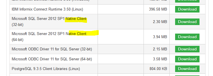

RebeccaStrauch__GISP
MVP Emeritus
It might...I was going to suggest making sure you have the correct version.  You can download from myesri downloads for ArcGIS Server....Additional Products

KathleenBrenkert
It was my native server client - I was using 10.0 and we upgraded to 11.0 and problem is fixed.  Just a note to anyone else who comes across this, we are using SQL 2008 R2.  I had to find the right files to do the upgrade from microsoft - I never did find the right ones from myesri (I gave up quickly).
