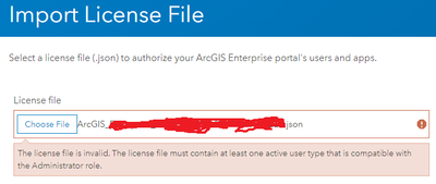

Hi dears,
i'm try to create Portal and when I import license the following error appears, so any suggestions?
Tags (1)
Suleyman-Arslan
Your license file should contains at least one of the following user types which are compatible with the Administrator role. (Assuming your ArcGIS Portal version is10.7 or above.)
- Advanced
- Creator
Insights Analyst
- Standard
https://enterprise.arcgis.com/en/portal/10.8/administer/windows/obtain-portal-license.htm
