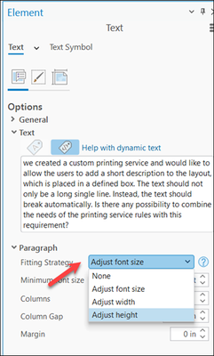

@FriederikeKafka1
ArcGIS Pro introduced the fitting strategy in 3.3. Therefore you need to author your layout template in ArcGIS Pro 3.3. And to take advantage of this with print service, you need to publish/use your template with a print service off a 11.3 enterprise/server
Please let me know if you have any question.
