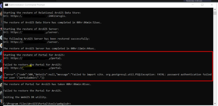

I try to restore portal through webgisdr but encounter error
Failed to import site. org.postgresql.util.PSQLException: FATAL: password authentication failed for user "portaladmin"

@LorenzMeyer1 makesure to use same initial password for portaladmin when installing the new portal

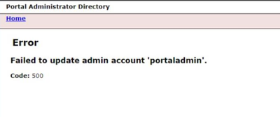

@Izzat It's true that updating the Update Admin Account ends in an error "Failed to update admin account 'portaladmin'", but when you check the portal logs (debug level) you will see, that the password for the account has been changed. At least in my case it worked now. I could verify that with the pgAdmin Tool and connecting with the new portaladmin password to the postgresql database of portal.

@LorenzMeyer1 that means the portaladmin password already change even you got an error "Failed to update admin account 'portaladmin'"?
