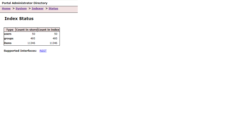

2. I checked indexer status and reindex all. Seems like it is OK:

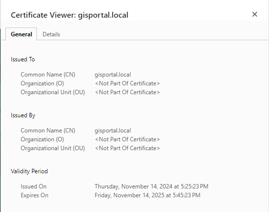

Only one thing I do not really understand is IWA or PKI question. As I mentioned earliar account that I use is created in the portal built-in storage. The FQDN domain SSL certificate is the only thing I can connect to the PKI so:
Certificate is self-signed with valid CN
