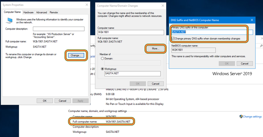

Edgar_W_Iparraguirre
The same issue was occurring on one of my virtual machines, configured with Windows Server 2019 and AGE 10.9.1. To be clear, the issue was only when going to /portal/home or /portal/sharing/rest. The remaining one (/portal/portaladmin) was not being redirected to 7443.
Being that the machine is not part of an AD domain, the Full Computer Name (NOT the Full Qualified Domain Name =FQDN) was set to be the machine name (W2K1901), without a DNS domain appended to it.
The solution turned out to be defining the primary DNS suffix of this computer to be equal to the DNS domain.
