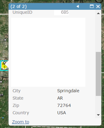

For maps on ArcGIS Online or ArcGIS Portal, is there any way to decide the display order of multiple completely overlapped points?
For example, two icons having the same Lat & Long in the same layer shown in the screenshots. It shows the point with UniqueID 684 is in the first pop-up window and the point with Unique ID 685 is in the second pop-up window, but the info in the second pop-up window is more useful for me. Is there any way to change the point with 685 to the first window (1 of 2) instead of (2 of 2) so that I don't need to tab through to get what I want?
What elements decide the pop-up order of overlapped points when esri designed the pop-up widget? The order of the data imported into the attribute table? The latest modified date of the data in the table? Or is the pop-up order decided just by random and there is no way to make a adjustment?
I tested the order of ObjectID, latest modified or uploaded date of the data but failed to find the common rule.
My former assumed logic is that pop up window of records with larger ObjectID or with the latest modified or uploaded date should be on the top.

Hi Shuhong,
No, there is no way to order the content returned in a pop-up in the ArcGIS Online/Portal for ArcGIS map viewer. The content returned is based on which data layer's content is retrieved first, so fastest data layer will appear first, then the next fastest, etc.
For overlapping data points within the SAME layer, I believe the pop-up content is returned based on object ID; so feature(s) with a lower OID will be returned first.
Hope this helps,
ShuhongYan
Hi Derek,
I had the same thought for the same layer that should be based on OBJECTID. I tested it. However, some features with a lower OID are on the top but some in other overlapped locations are on the bottom, which means OID is not the key field to decide the order of pop-up window of features.
