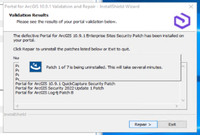

Just a warning to all portal admins looking to run the Portal for ArcGIS Validation and Repair tool. It takes a VERY long time. Ours has been running for 4 hours so far, and it's rolled back 4 of 7 patches so far. Will update once complete.

Thanks for these tips. We are running ArcGIS Enterprise 10.8.1 on Azure and we excluded these folders from the anti-virus while the patch remover tool and updates were running and then re-enabled after.
Took about 4-5 hours after hours to run the patch remover.
